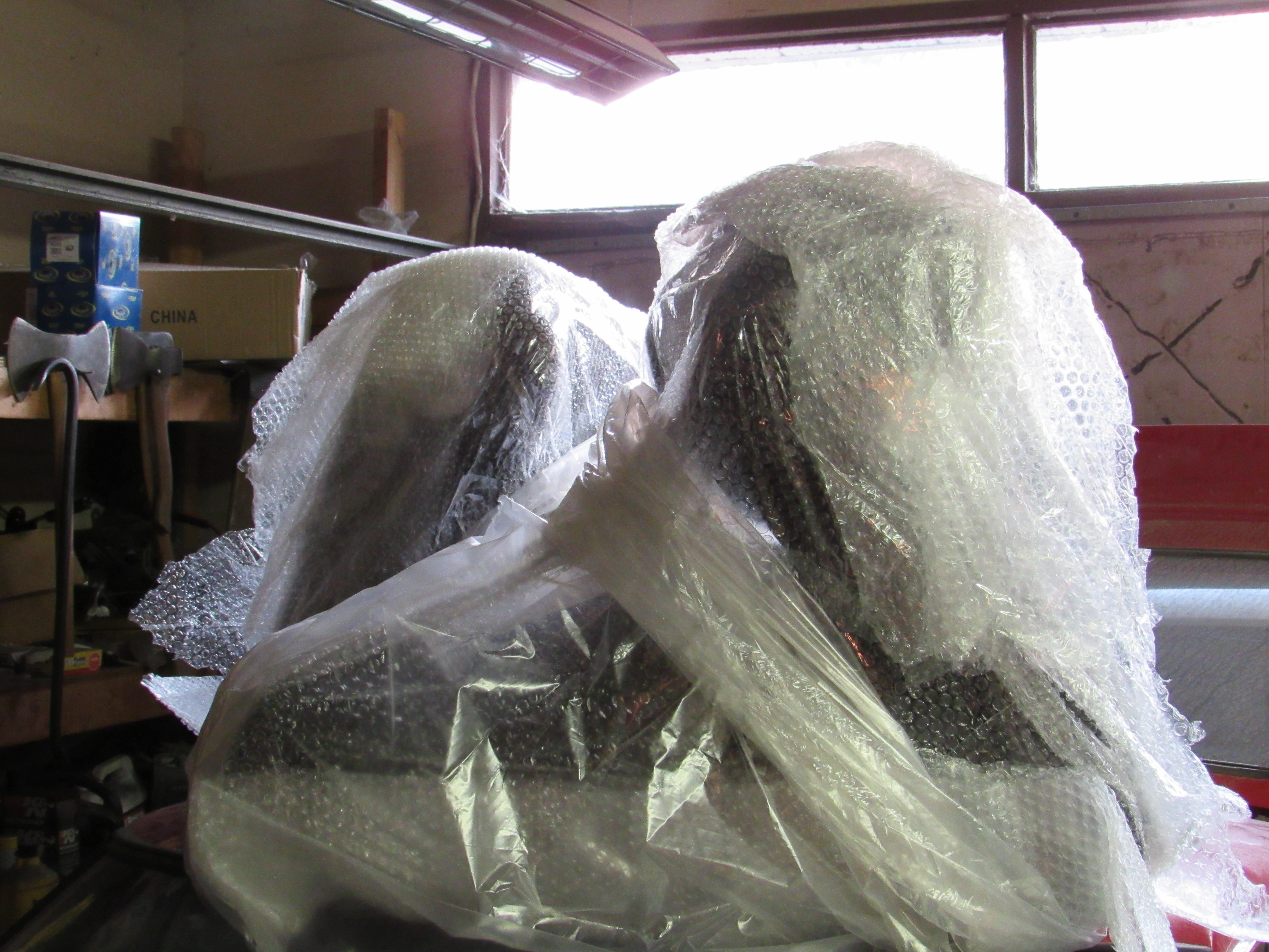

I'm really struggling to install a new pair of these seats into my 5/71 240Z.  Removed the stock seat with it's sliders.  Attached the Corbeau sliders to a seat.  Just don't see a way to install the nuts that hold the rear of the slider to the stock frame.  Have installed/tightened the nuts for the front of the slider to the frame, but having only two fastening points seems sub-optimal.
What's the install procedure, because I don't know it.
The seat is all the way back and doesn't seem to want to slide forward at all.  An issue is that due to the cross rail at the front of the seat, I can't reach under the seat to access the rear fasteners, which connect the slider to the frame.  With the seat all the way back, there is zero room to reach under the seat from the rear.
