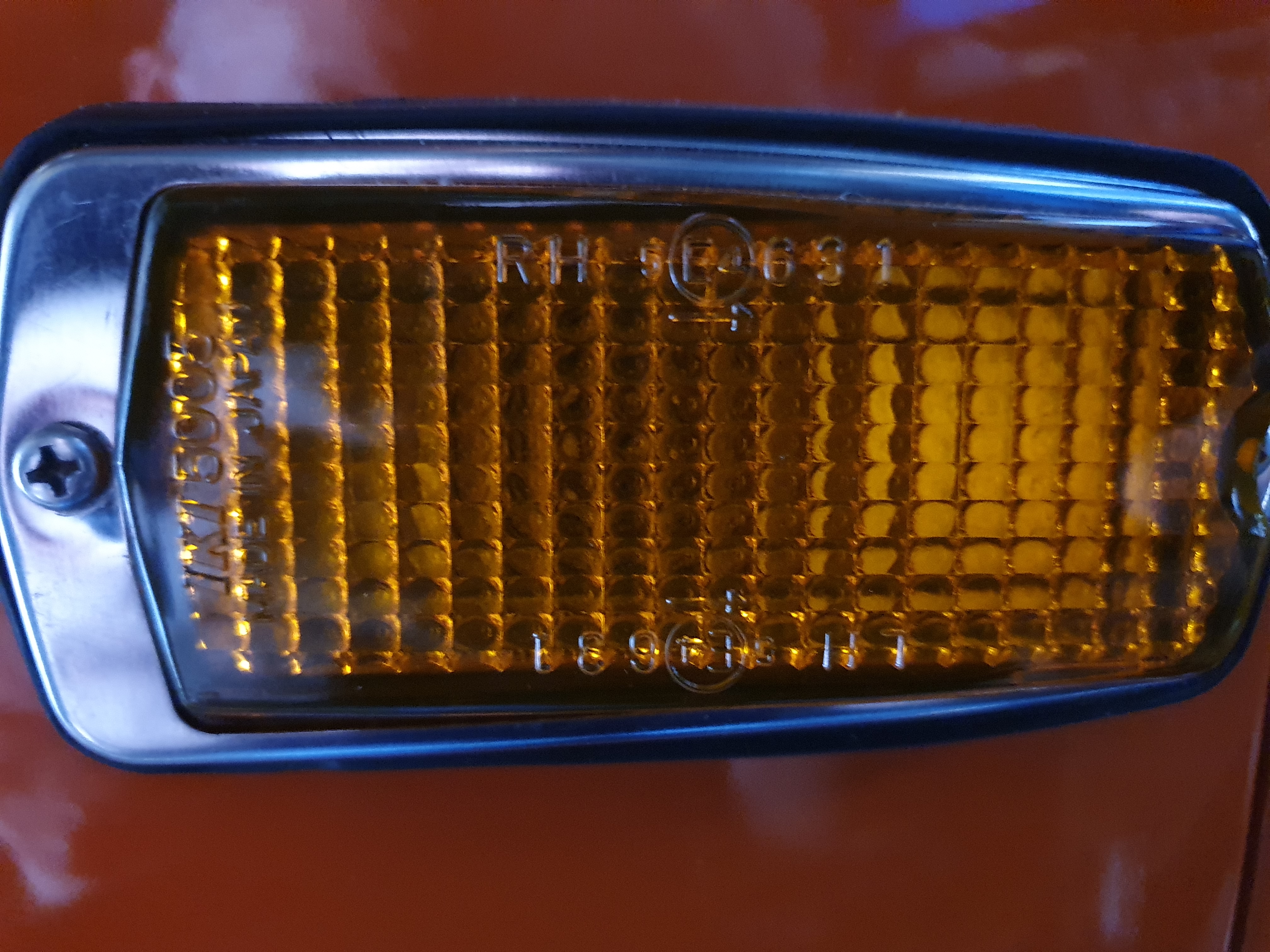

July 9, 20231 yr Popular Post comment_654958 Also, Nissan very kindly supplied us with orientation clues on the lens itself. If the lamp unit is mounted correctly, the arrow will point to the front of the car and the 'RH' or 'LH' script will be legible and not upside down. RH and LH of these cars is as viewed from the driver's seat. Simple. Link to comment https://www.classiczcars.com/forums/topic/68441-marker-light-orientation/?&page=2#findComment-654958 Share on other sites More sharing options...
July 9, 20231 yr comment_654963 5 hours ago, HS30-H said: Also, Nissan very kindly supplied us with orientation clues on the lens itself. If the lamp unit is mounted correctly, the arrow will point to the front of the car and the 'RH' or 'LH' script will be legible and not upside down. RH and LH of these cars is as viewed from the driver's seat. Simple. Very interesting. I suspect the lens you pictured is unique to the Euro export vehicles. It looks like the IKI # is 5005, all of the lenses I've worked with are IKI 5004 as are the lamp bodies. Our North American versions also specify SAE PIA69 at the other end, and some but not all have DOT just above the SAE. Ours have no other lettering on the lens surface. The orientation of the raised IKI 5004 is opposite of yours. The RH / LH designations are found on the underside of the rubber adapter. I am just getting underway on assembling some sets of refurbed markers. Edited July 9, 20231 yr by jfa.series1 Link to comment https://www.classiczcars.com/forums/topic/68441-marker-light-orientation/?&page=2#findComment-654963 Share on other sites More sharing options...

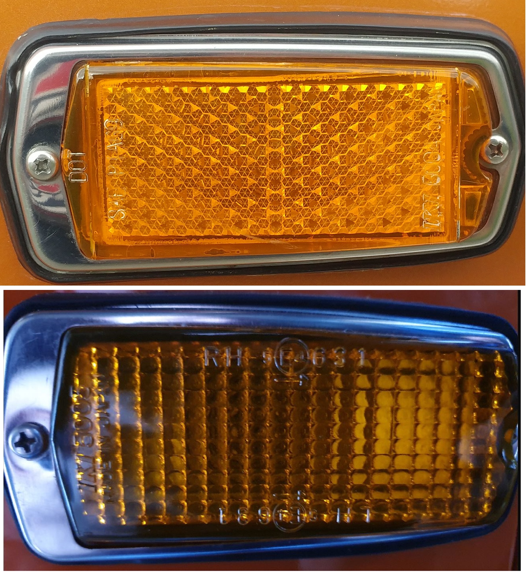

July 10, 20231 yr Popular Post comment_654964 @HS30-Hand @jfa.series1thanks for sharing this interesting info about the side marker lights. I had a quick look at the pictures I have of my 7/70 (originally delivered to Canada) and they have the IKI 5004 DOT lenses, as Jim found. It also is interesting that the IKI 5004 lenses have a different pattern for the reflective feature. IKI 5004 has a pattern that is prismatic and IKI 5005 seems to be more like a pattern of circular, possibly parabolic shapes. Link to comment https://www.classiczcars.com/forums/topic/68441-marker-light-orientation/?&page=2#findComment-654964 Share on other sites More sharing options...
