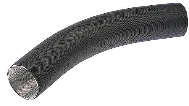

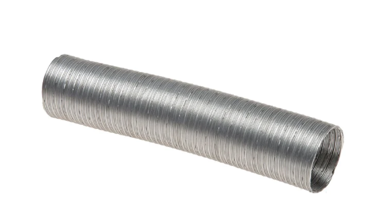

Posted July 11, 20231 yr comment_654993 My car doesn't have a hose for the wintertime connection from cleaner to manifold. I don't really need it in Sacramento, but do I want to put it on there anyway? I don't think I ever see one on most if not all of the cars that get a proper restoration on BAT, but it just feels weird to have that exhaust manifold going nowhere? A quick search here really didn't provide much other than a small thread from 05. If I do need it, is it really this from Z Car Depot as the original looking hose? Link to comment https://www.classiczcars.com/forums/topic/68442-air-cleaner-manifold-hose/ Share on other sites More sharing options...

July 11, 20231 yr Author comment_655011 OK thanks guys. So cooler air = better performance, just like cold water makes better coffee 😉 I was just curious that the manifold pipe being left wide open wasn't a "good thing", no issues just leaving it like that? We don't cap it or anything? And for looks if I do decide to place it on and off at times, is that dryer vent looking hose from Z Car really accurate? I can't imagine they used that way back when, looks so out of place with everything else. I was going to get this from Dorman to at least have it match some of the hoses aesthetically. Only $10 or so currently on Amazon https://www.amazon.com/Dorman-HELP-96034-Preheater-Hose/dp/B000C5I7VC/ref=asc_df_B000C5I7VC/?tag=hyprod-20&linkCode=df0&hvadid=241973068692&hvpos=&hvnetw=g&hvrand=17963068419572466911&hvpone=&hvptwo=&hvqmt=&hvdev=c&hvdvcmdl=&hvlocint=&hvlocphy=9032516&hvtargid=pla-570818045410&psc=1 Link to comment https://www.classiczcars.com/forums/topic/68442-air-cleaner-manifold-hose/#findComment-655011 Share on other sites More sharing options...
