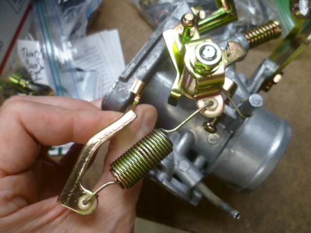

July 20, 20231 yr comment_655255 9 hours ago, Captain Obvious said: Terrapin, I think those parts look perfect for any of the 280s, including the 78. Thanks for the confirmation. The springs and collars looked right, just the lever looked a little different. Link to comment https://www.classiczcars.com/forums/topic/68452-replacement-throttle-body-linkage-return-spring/?&page=2#findComment-655255 Share on other sites More sharing options...
July 21, 20231 yr comment_655262 1 hour ago, Terrapin Z said: Thanks for the confirmation. The springs and collars looked right, just the lever looked a little different. Yeah. now that you mention it... It appears that the spring anchoring hole does not exist on the lever part you have there. The spring and washers look fine, but that lever looks like it might not be the right part. I'll look at the parts tomorrow with fresh eyes instead of digging through old pics. I hope I didn't give you guys bad advice when I said they were correct. Link to comment https://www.classiczcars.com/forums/topic/68452-replacement-throttle-body-linkage-return-spring/?&page=2#findComment-655262 Share on other sites More sharing options...
July 21, 20231 yr comment_655300 20 hours ago, Captain Obvious said: Yeah. now that you mention it... It appears that the spring anchoring hole does not exist on the lever part you have there. The spring and washers look fine, but that lever looks like it might not be the right part. I'll look at the parts tomorrow with fresh eyes instead of digging through old pics. I hope I didn't give you guys bad advice when I said they were correct. My spring mount holes are still on the TB, and still look different than ea6's I do still think the long spring and the collar parts look the same though. Link to comment https://www.classiczcars.com/forums/topic/68452-replacement-throttle-body-linkage-return-spring/?&page=2#findComment-655300 Share on other sites More sharing options...

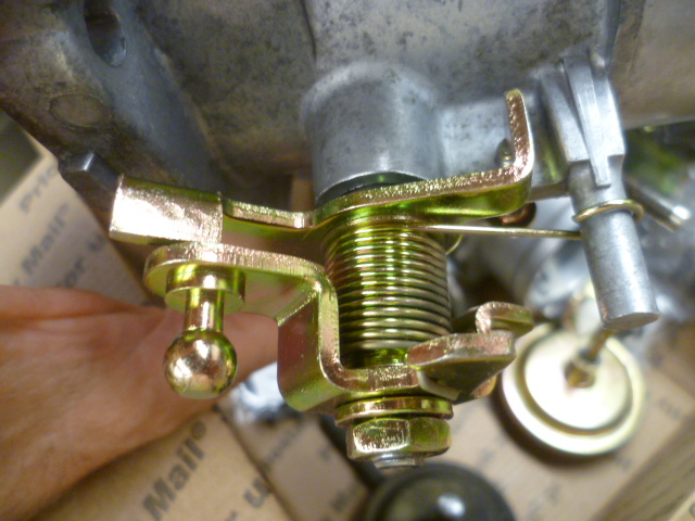

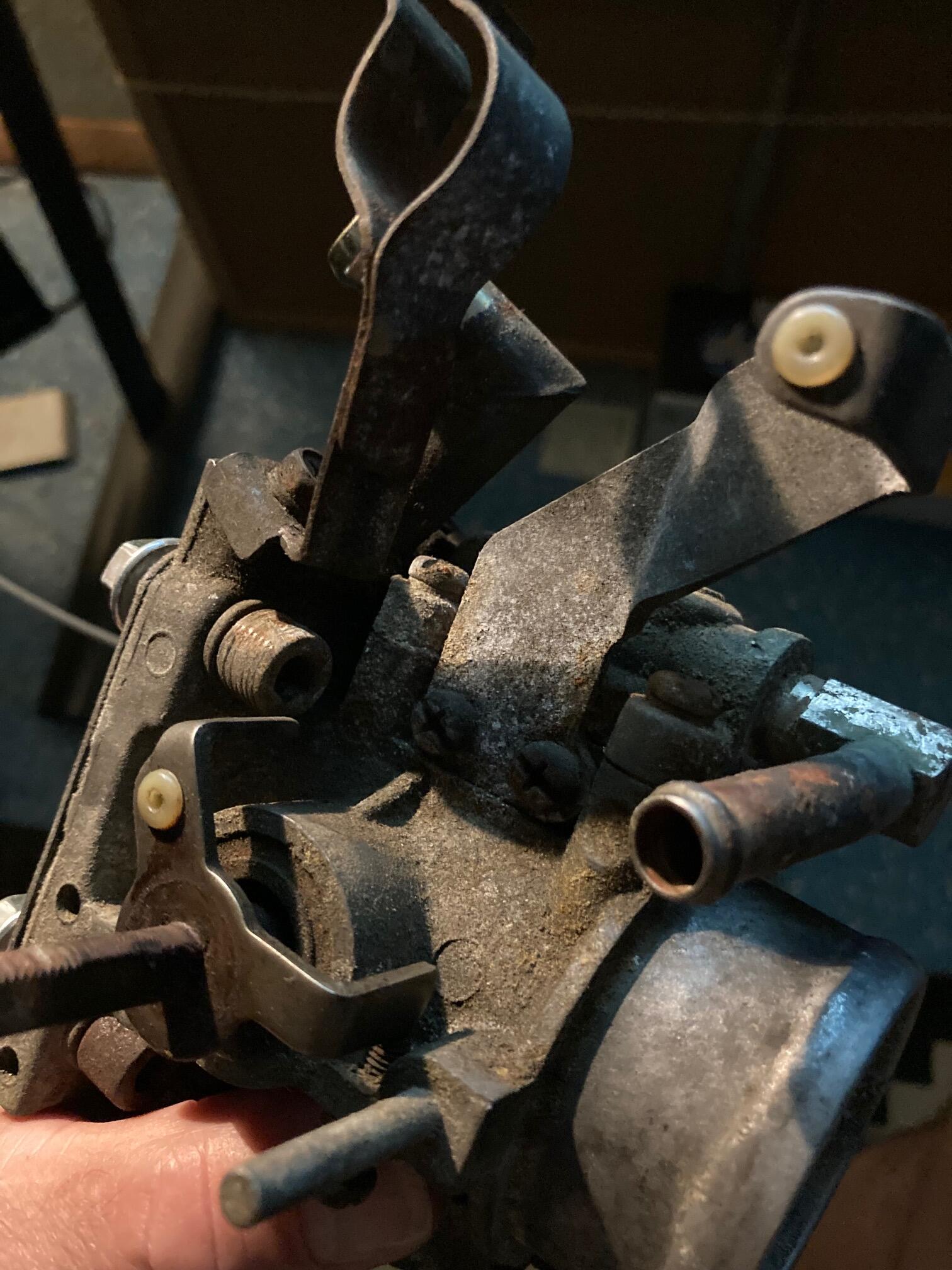

July 22, 20231 yr comment_655307 I dug into some boxes here and took some pics. Apologies to @Yarb and everyone else for the incorrect info I posted earlier. Here's the 280Z linkage. View from the top: From the bottom: And here's a close-up where you can see washers on either side of the spring: And here's a shot where I'm holding the mounting bracket with the second return spring: And since I had boxes open, I pulled out a ZX throttle body. Looks like this: So it appears (to the naked eye) that the torsion spring, washers, and center tube are the shared between the Z and the ZX, but the part where the linkage ball and socket joint attaches is different. I believe that part pictured above is from a ZX, not a Z. Link to comment https://www.classiczcars.com/forums/topic/68452-replacement-throttle-body-linkage-return-spring/?&page=2#findComment-655307 Share on other sites More sharing options...

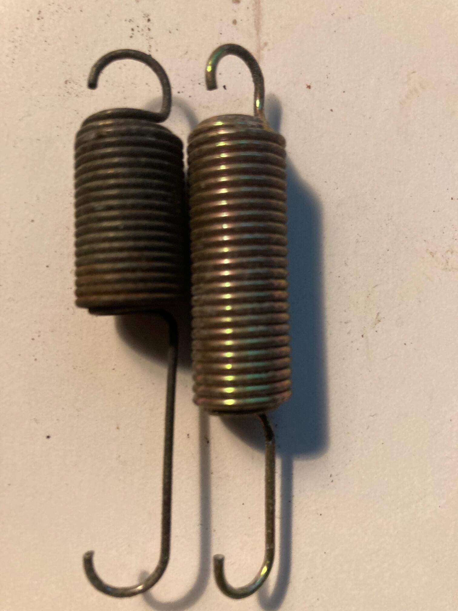

July 22, 20231 yr comment_655318 Thanks for the extra pictures CO. after putting my sunglasses on to cut the glare it looks to me like the washers and center collar pin are the same but the long spring might be a different length. I asked ea6 to measure his and see how for off they were. I still may have another TB or two laying around. I just did not have any ID from the cars they were off of. (Hoard purchase) The socket arms / brackets are most assuredly different. Link to comment https://www.classiczcars.com/forums/topic/68452-replacement-throttle-body-linkage-return-spring/?&page=2#findComment-655318 Share on other sites More sharing options...
July 22, 20231 yr comment_655328 Interestingly enough, the springs are the same length overall but the 280Z spring as a longer wound section than the ZX spring. I am sending the 280Z spring and collars to ea6 as they are all in better shape. I assume the tension on the spring is different too, with a longer wound area. Of course the English language has two definitions for wind and wound "I will wind my watch until it is wound all the way" or "The wind sent a shard into my arm and I now have a serious wound" WTF!! Link to comment https://www.classiczcars.com/forums/topic/68452-replacement-throttle-body-linkage-return-spring/?&page=2#findComment-655328 Share on other sites More sharing options...
