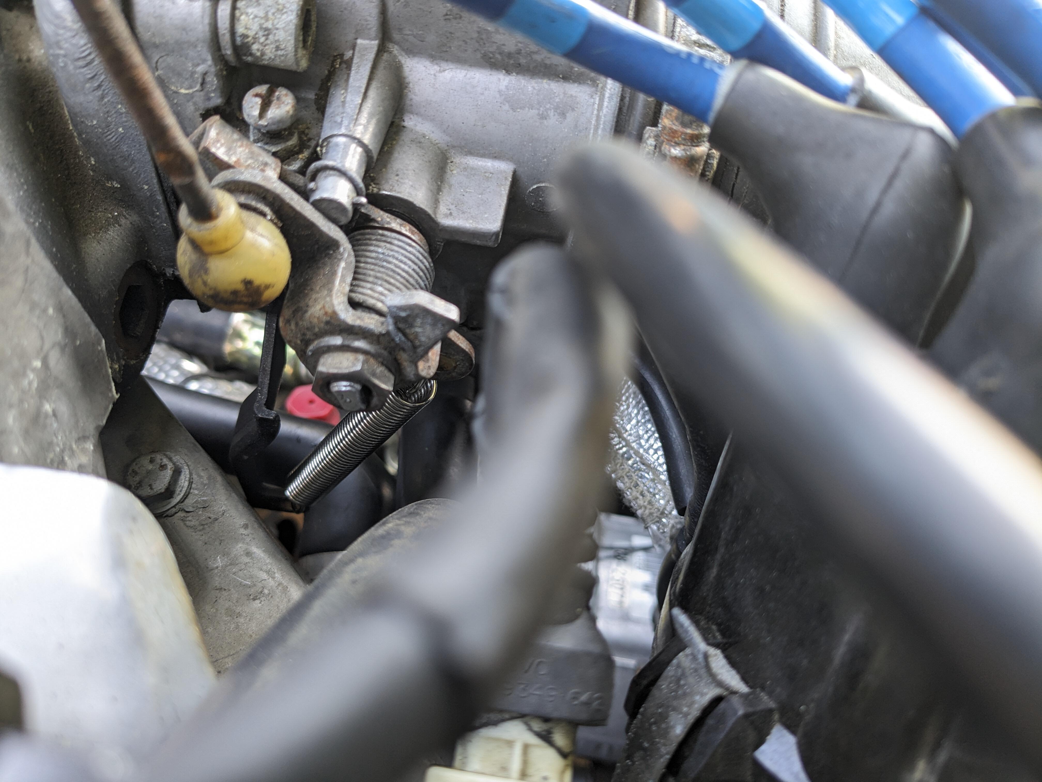

April 16, 2024Apr 16 comment_664169 So, question - has anyone determined a suitable generic replacement for the earlier (75) style external return spring? I'm looking online & of course can buy a generic set off Amazon or from Harbor Freight, I just want to make sure I get something that will be a suitable weight. I cleaned mine up when I did the TB cleaning, but the tension isn't enough - I often find the throttle not closing properly during light throttle (low speed, in town) situations TIA Edited April 16, 2024Apr 16 by HusseinHolland Link to comment https://www.classiczcars.com/forums/topic/68452-replacement-throttle-body-linkage-return-spring/?&page=3#findComment-664169 Share on other sites More sharing options...

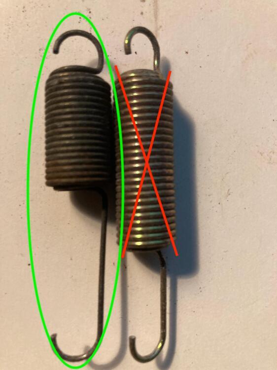

May 15, 2024May 15 comment_665496 I still have the one circled in green, The other one was sold further back in this thread. It is dirty but still feels strong, I have a 240Z so I use different springs. Edited May 15, 2024May 15 by Terrapin Z Added the pic. Link to comment https://www.classiczcars.com/forums/topic/68452-replacement-throttle-body-linkage-return-spring/?&page=3#findComment-665496 Share on other sites More sharing options...
May 17, 2024May 17 comment_665575 On 5/14/2024 at 9:58 PM, Terrapin Z said: I still have the one circled in green, The other one was sold further back in this thread. It is dirty but still feels strong, I have a 240Z so I use different springs. Understood. Mine looks the same as the heavier one on the right, so I don't think I want to put a lighter weight spring in its place. Link to comment https://www.classiczcars.com/forums/topic/68452-replacement-throttle-body-linkage-return-spring/?&page=3#findComment-665575 Share on other sites More sharing options...

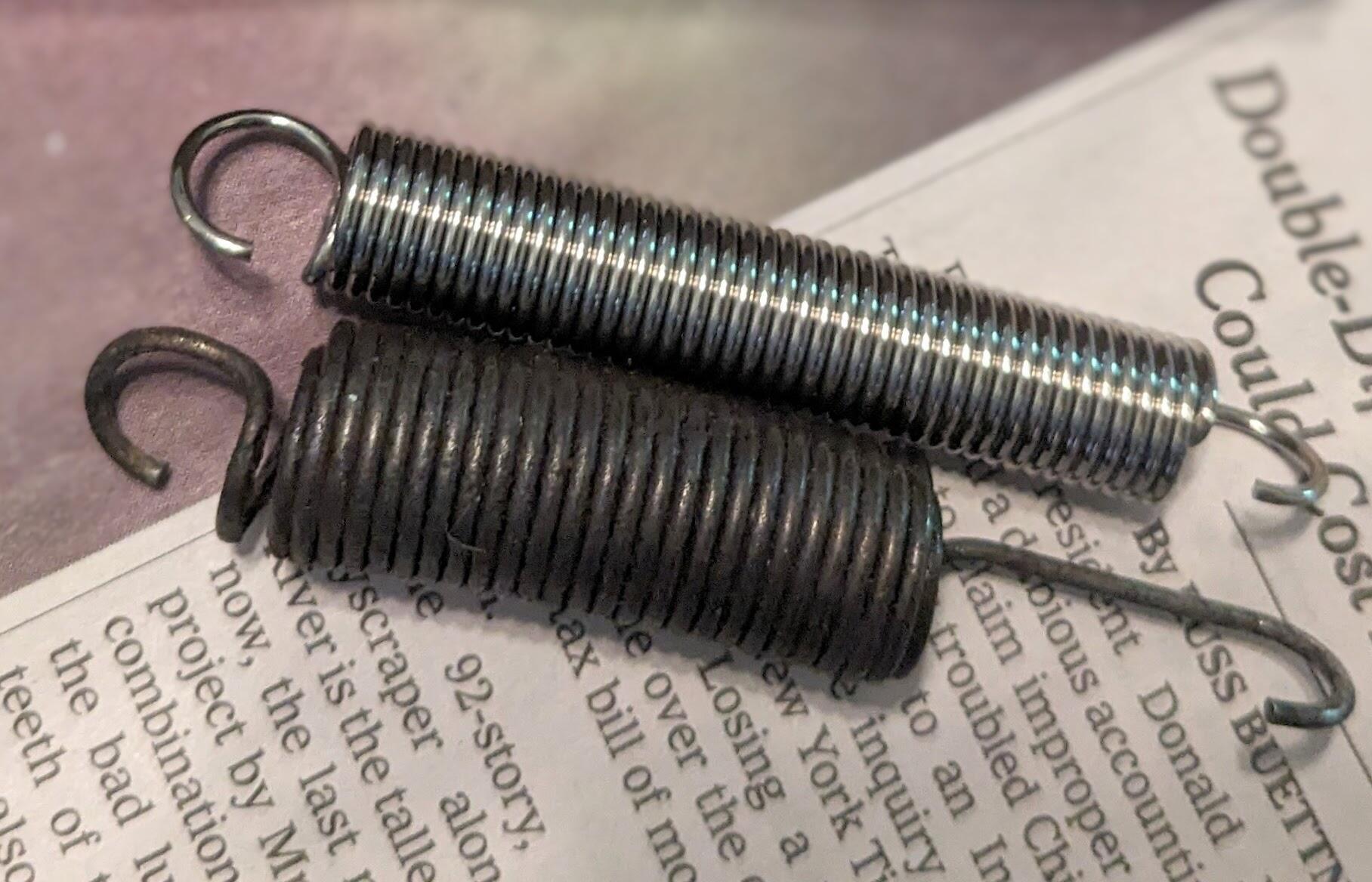

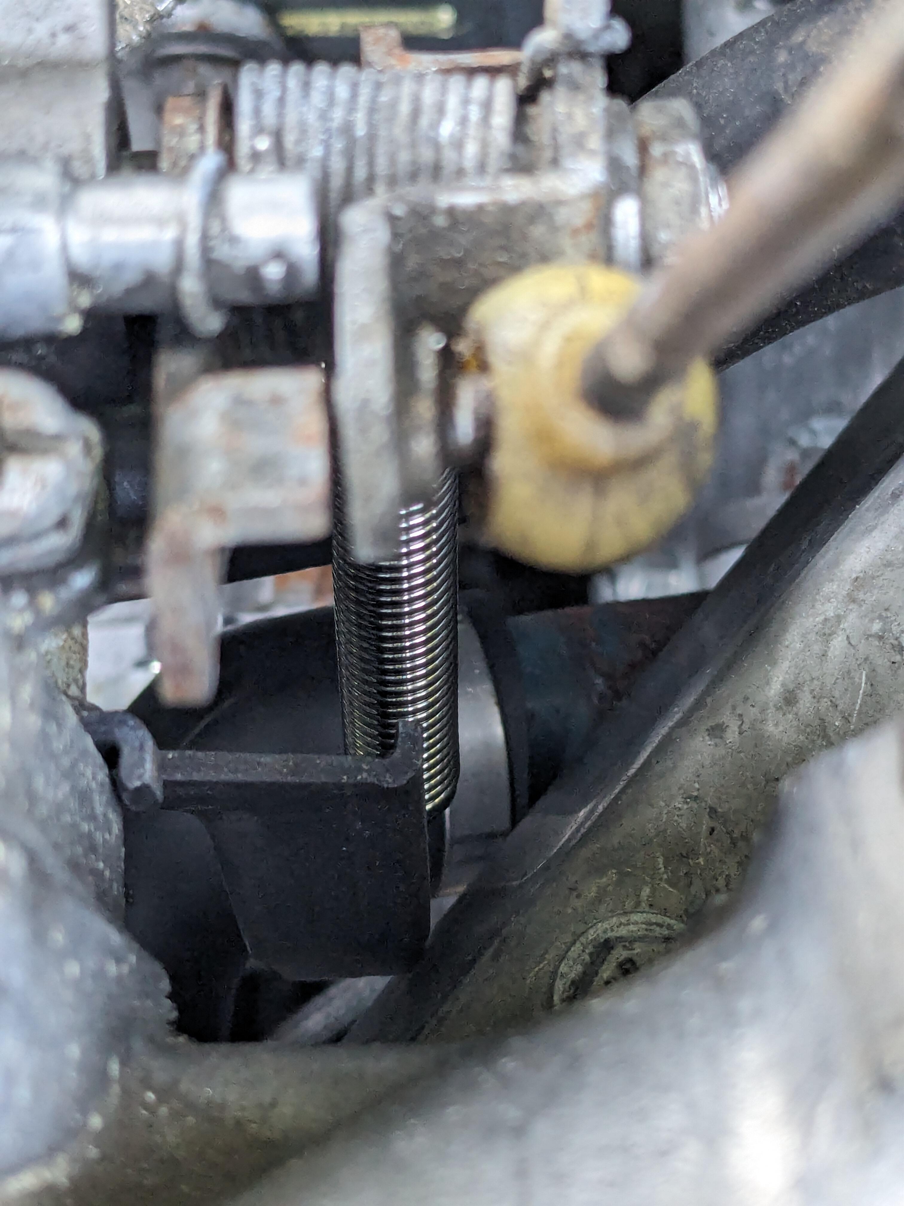

May 20, 2024May 20 comment_665704 OK - so the generic spring I got off Amazon works, and is not excessive tension, nor too difficult to install in place. We'll see how long it lasts. Since links don't last particularly long dimensions to look for are: 0.047"x0.39"x2.76" - "Stainless Steel Tension Spring Wire" or 'Extended Tension Spring Wire" comparison: Link to comment https://www.classiczcars.com/forums/topic/68452-replacement-throttle-body-linkage-return-spring/?&page=3#findComment-665704 Share on other sites More sharing options...
May 21, 2024May 21 comment_665717 On 5/15/2024 at 3:58 AM, Terrapin Z said: I still have the one circled in green, The other one was sold further back in this thread. It is dirty but still feels strong, I have a 240Z so I use different springs. Btw: If the wire diameter, spring diameter and materials are the same, the spring with the less coils (green circle) will be a lot stronger, but will have less travel. Based on the law of Hooke. Hookes law: F = kx (F is force, k is spring constant and x is distance travelled.) Wire diameter: When the wire diameter increases, the spring constant also increases. A thicker wire ensures that the spring constant becomes stronger and is even more difficult to deflect. Spring diameter: An increase in the spring diameter will lead to a decrease in the spring constant. Number of turns in the spring: The higher the number of turns, the lower the spring constant. It would have been interesting to test the springs with a weight to determine the k factors. Edited May 21, 2024May 21 by EuroDat Link to comment https://www.classiczcars.com/forums/topic/68452-replacement-throttle-body-linkage-return-spring/?&page=3#findComment-665717 Share on other sites More sharing options...
