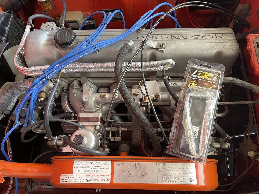

Here's another thing that didn't work.  It helped a little, but didn't completely get rid of the stumbling engine problem after idling in traffic in hot weather.
I wrapped the fuel lines in DEI's Vapor Lock Sleeve hoping to fix the problem.  Not quite the solution, still looking.  And it looks funky!
