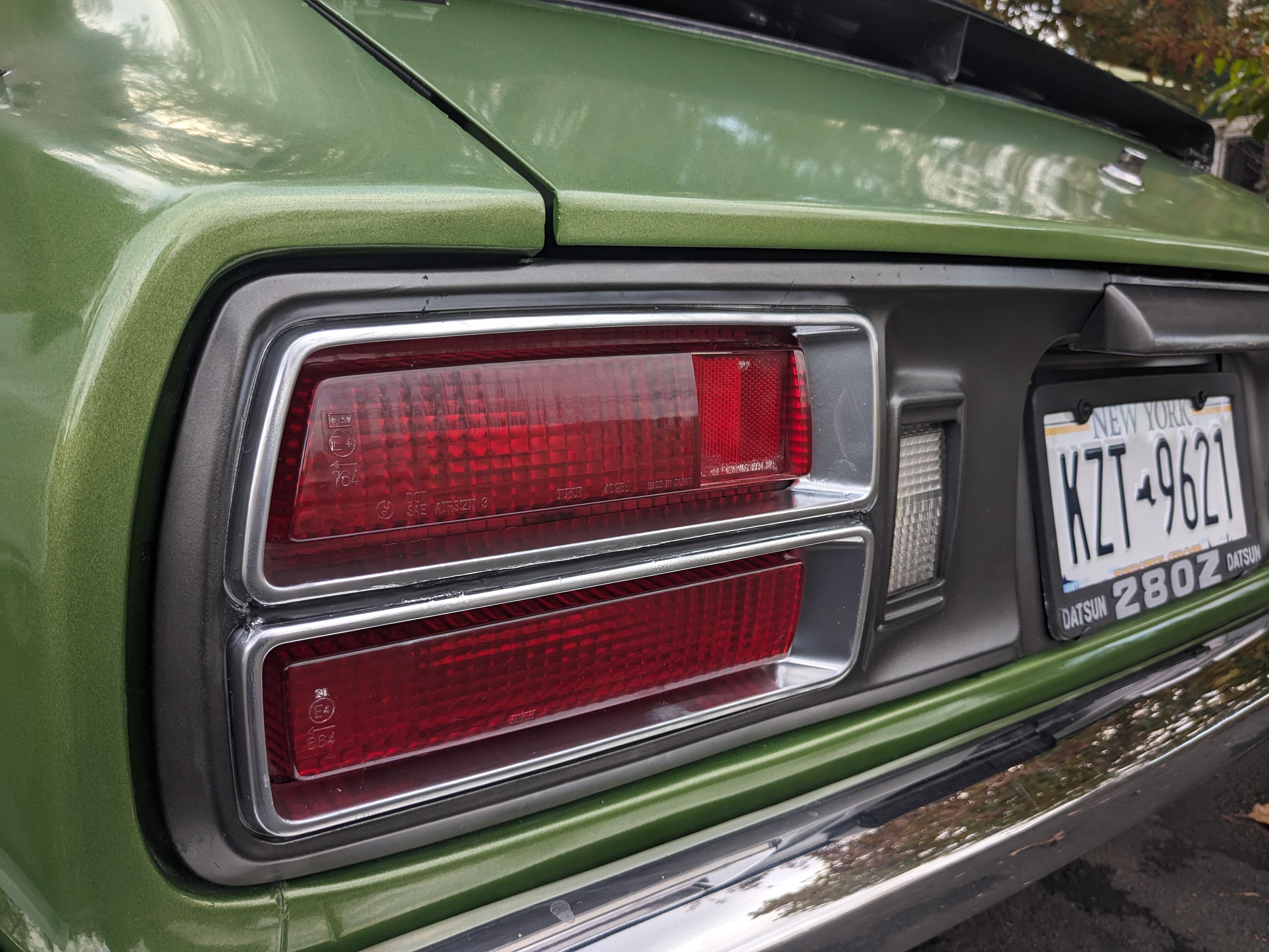

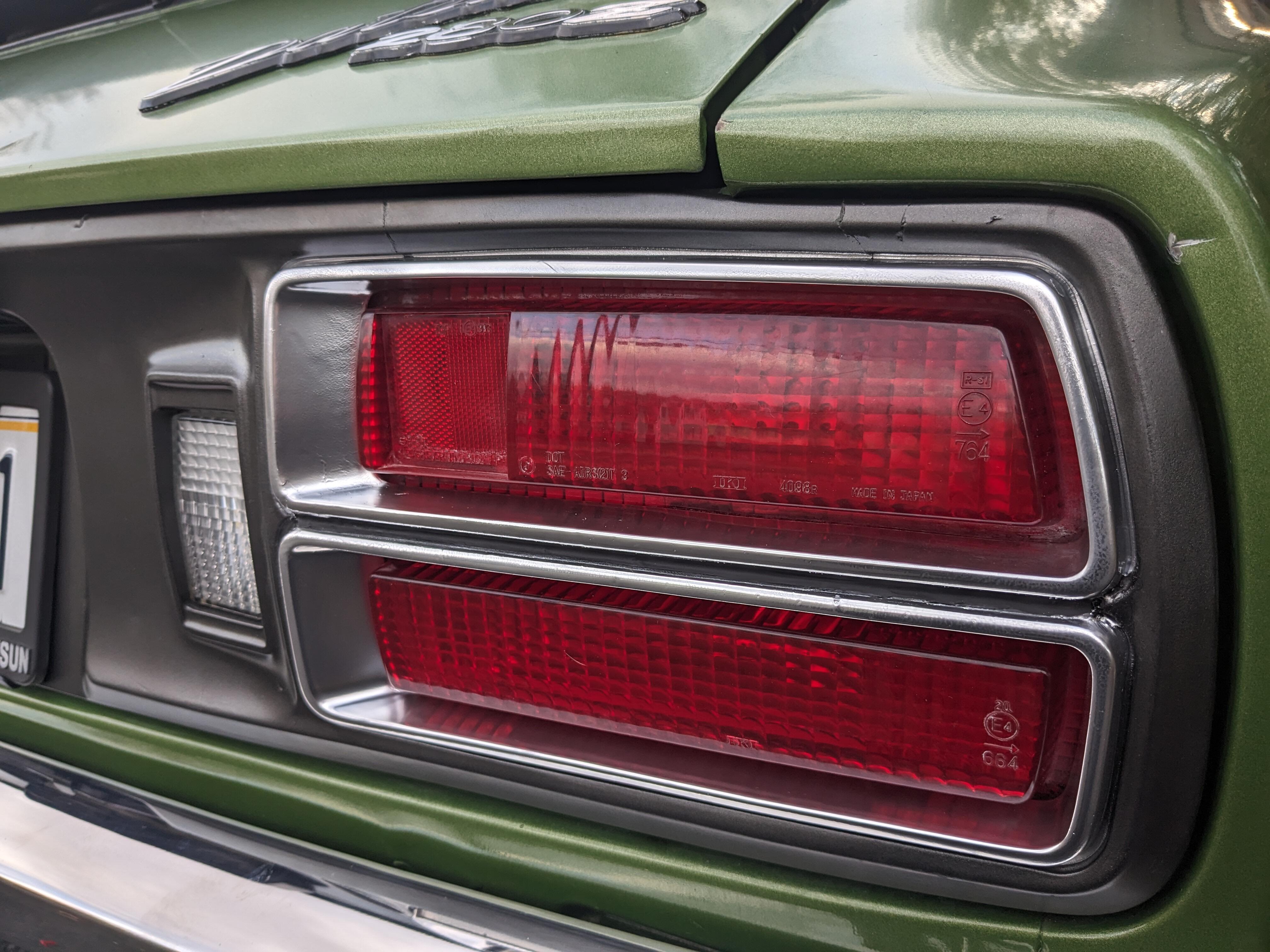

Popular Post HusseinHolland Posted October 27, 2023 Popular Post Share #19 Posted October 27, 2023 Test fitted the panels - still waiting for the gaskets before I actually install them. They (the chrome areas) look pretty rough up close. Still better than they were. 5 Link to comment Share on other sites More sharing options...

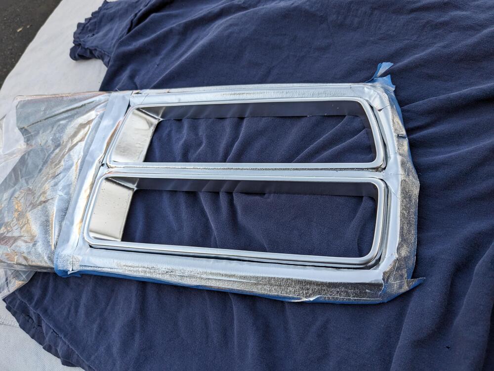

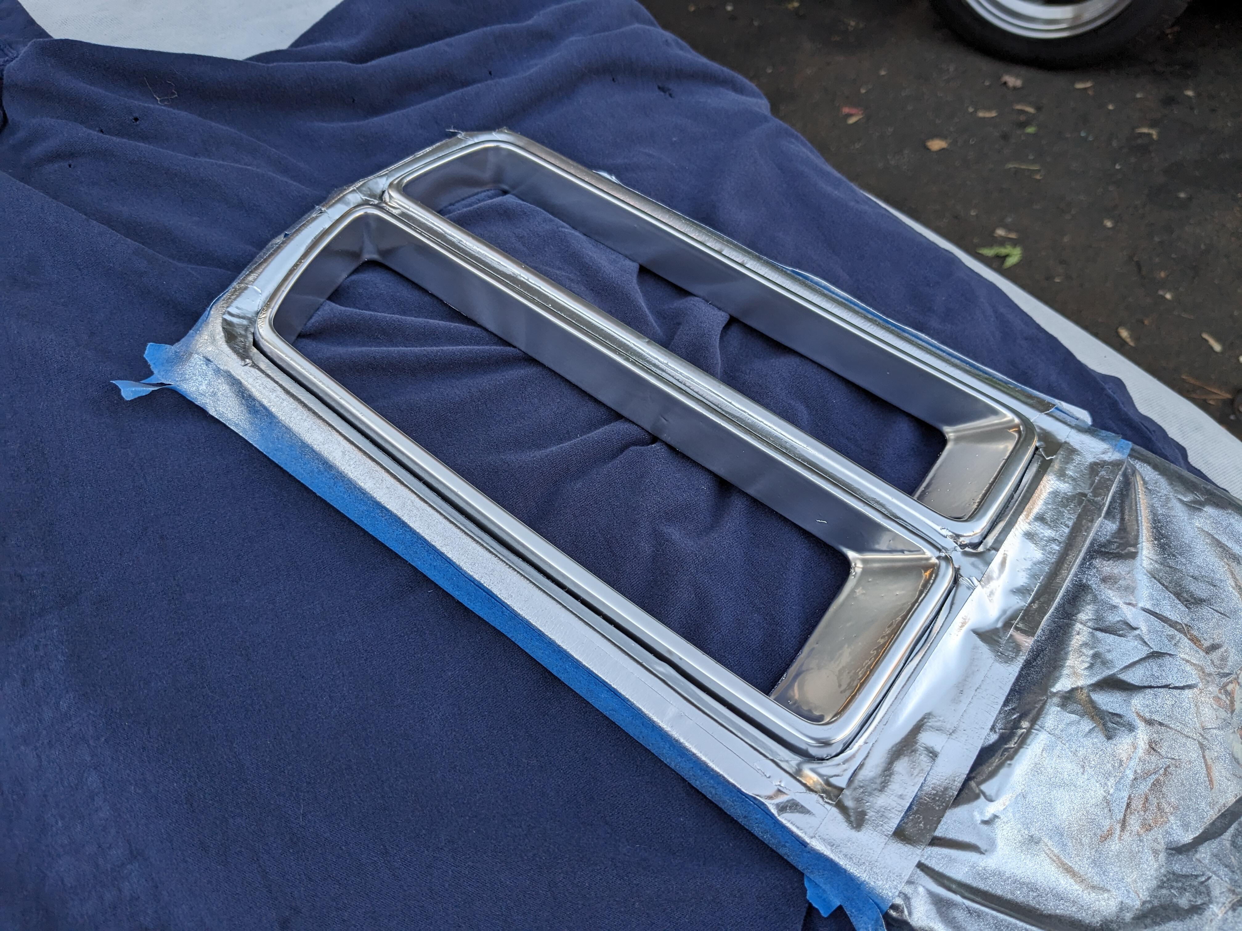

HusseinHolland Posted October 28, 2023 Share #21 Posted October 28, 2023 13 hours ago, SteveJ said: Yep, you had me looking at chrome paint the other day. I watched a YouTube video where a guy was trying different chrome paints. He said he got the best results from a chrome nail powder kit from Amazon. That's interesting - I'll have to take a look. I did have to redo the chrome - the center recess on them where the foil was peeling bothered me too much. I filled the recess yesterday's then sanded, masked & repainted the chrome today. It's still got imperfections, but better overall 2 Link to comment Share on other sites More sharing options...

HusseinHolland Posted October 28, 2023 Share #23 Posted October 28, 2023 (edited) On 10/27/2023 at 8:25 PM, SteveJ said: Here's the video: Interesting. The issue there is that surface imperfections will show right through. With the Chrome finish I used (I think it is Rustoleum, which he did not test), you can lay it on pretty heavy & it will level out cracks somewhat. The problem as I'm sure you know is that the original chrome foil separates, tears, buckles from the plastic, so unless you remove it all from the base, there will be issues with the surface finish of any product that is such a thin film. I think the nail polish version would be ideal for small details like the console & switch frame edging. Edited October 30, 2023 by HusseinHolland Link to comment Share on other sites More sharing options...
HusseinHolland Posted November 5, 2023 Share #24 Posted November 5, 2023 (edited) New lamp gaskets finally arrived, so I reinstalled my tail light panels. I will need to source new ones DTR, they are so brittle, they keep cracking when I handle them. Also had to use 3M VHB tape to glue the panels the lamps, as most of the screw mount posts are so brittle they snapped & crumbled when I tried to reinstall them. with those installed, I was able to put the rear panel back in. I added closed cell foam to give some more density . Edited November 6, 2023 by HusseinHolland 1 Link to comment Share on other sites More sharing options...
