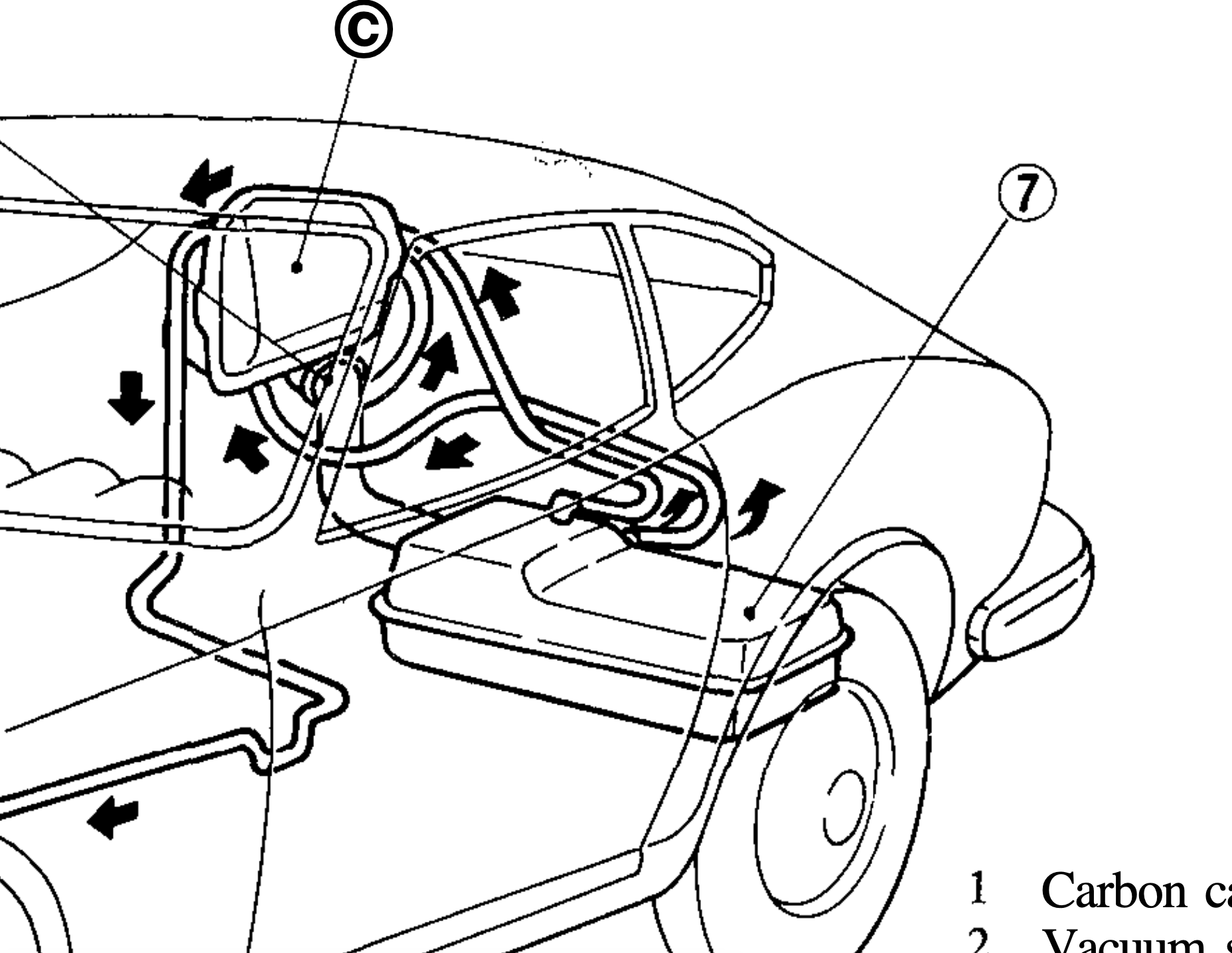

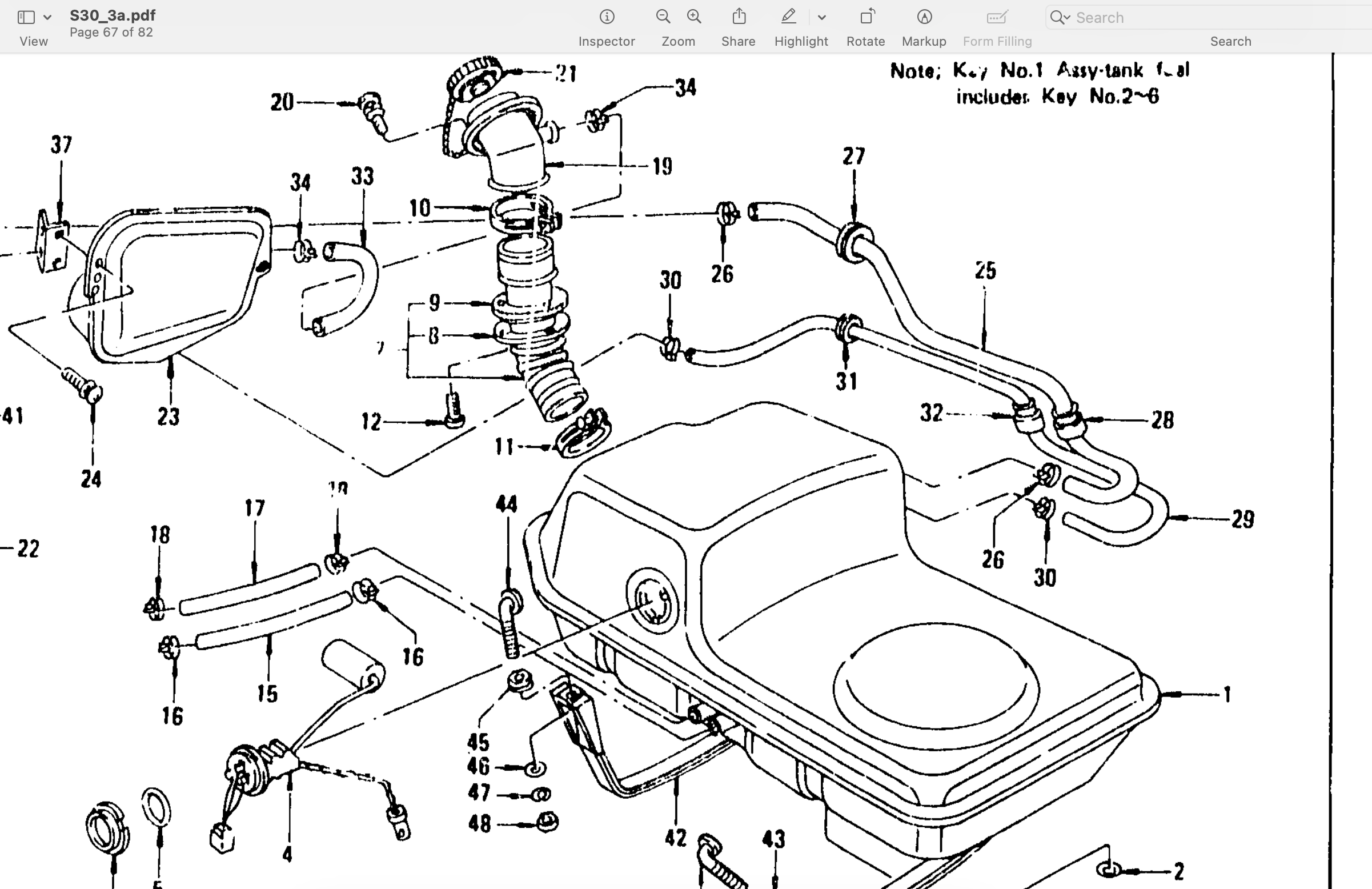

In any event, looking in the manuals there are two EVAP lines on the top of the tank. So, I'm assuming the leak is either an aged hose (#28 or 29) that has ruptured, and/or one of the necks is leaking at the tank. I don't know if that's a thing with these though, so I'm hoping it's just the hoses.
Looking online, dropping the tank doesn't appear to be a major deal. Any pointers or catches I should be aware of?

On 8/6/2023 at 6:36 PM, HusseinHolland said:
... So, I'm assuming the leak is either an aged hose (#28 or 29) that has ruptured, and/or one of the necks is leaking at the tank. I don't know if that's a thing with these though, so I'm hoping it's just the hoses.
We've had a couple of fuel tanks with leaks on the solder joints at the hose fittings so you can't totally discount that. Hoses are more likely.
Dropping the tank is fairly easy even with the myriad of hoses. Just disconnect the ones you can see and bring it down slowly until you can get to all of them.
