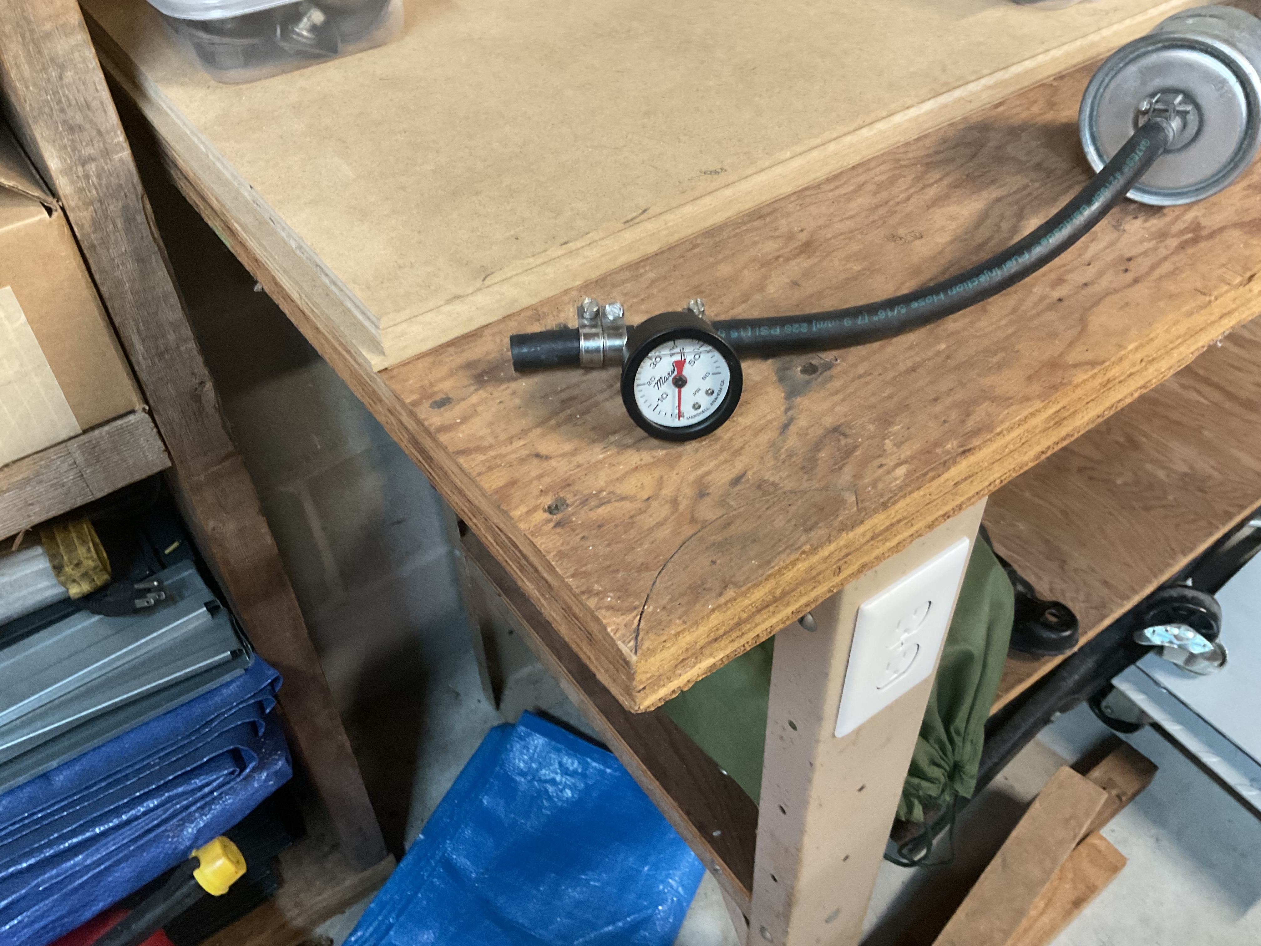

August 15, 20231 yr comment_655972 That's just a random 280Z I pulled up. As for clamps, here's a starter set for you that won't break the bank. https://www.amazon.com/30pcs-Assortment-Automotive-Agriculture-Construction/dp/B07NPDMXM5 Link to comment https://www.classiczcars.com/forums/topic/68503-efi-upgrade/?&page=2#findComment-655972 Share on other sites More sharing options...

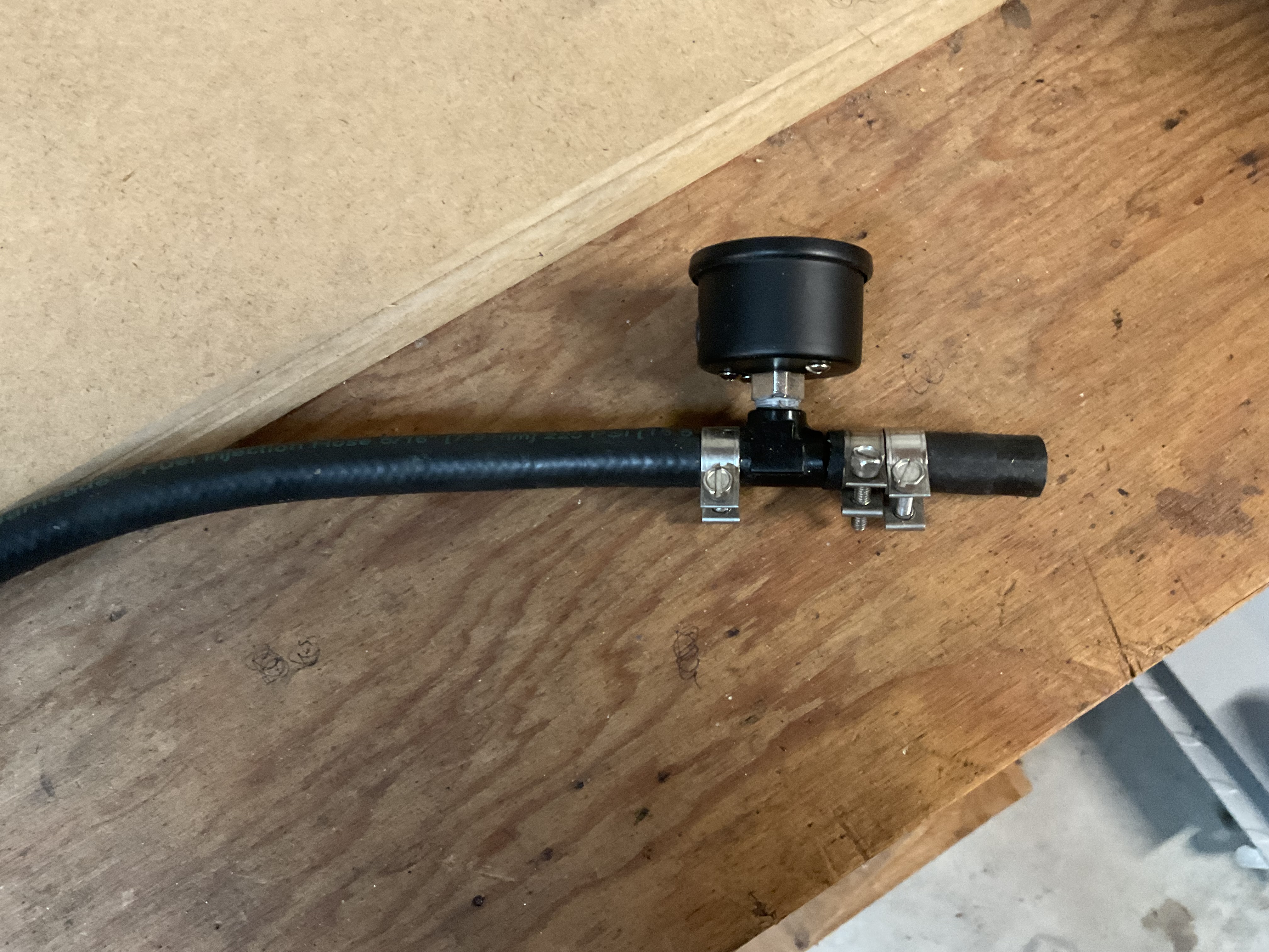

August 15, 20231 yr comment_655973 By the way when you install it, Please leave it in there. It’s the heart of the system. Marshall on Amazon sells a nice gauge. Edited August 15, 20231 yr by Yarb Pics added Link to comment https://www.classiczcars.com/forums/topic/68503-efi-upgrade/?&page=2#findComment-655973 Share on other sites More sharing options...
