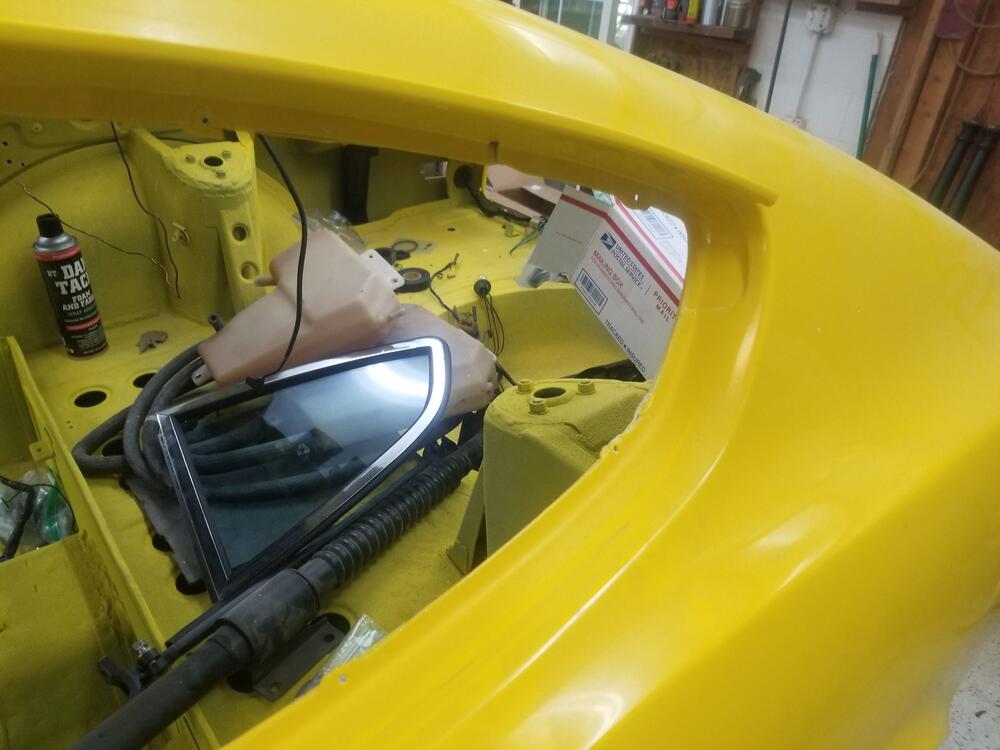

Posted August 16, 20231 yr comment_656002 So I know there were a number of areas that the factory applied black paint to improve the look or finish. Where are all of these areas? What is the extent of the application? What finish was the paint? Flat, semi or gloss? These are some of the areas that I can remember Some of this area behind the qtr glass Some portion of this edge on the window Behind the speaker holes Some portion of the front radiator support I also believe there was some down near the foot well or the kick panel?? Link to comment https://www.classiczcars.com/forums/topic/68505-black-out-areas/ Share on other sites More sharing options...

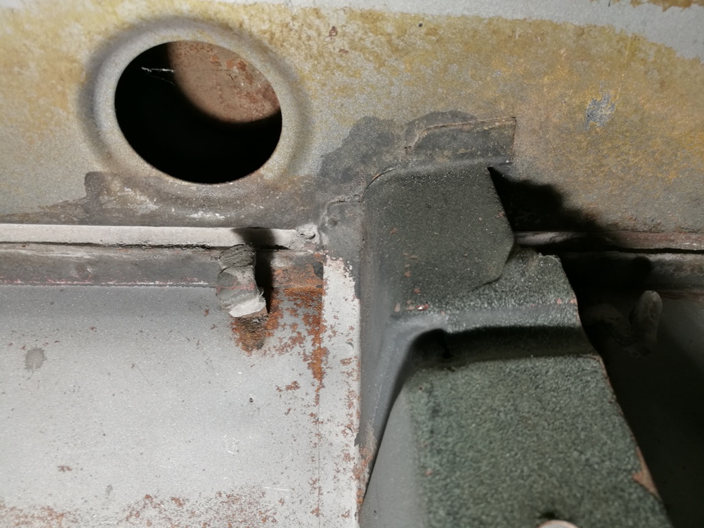

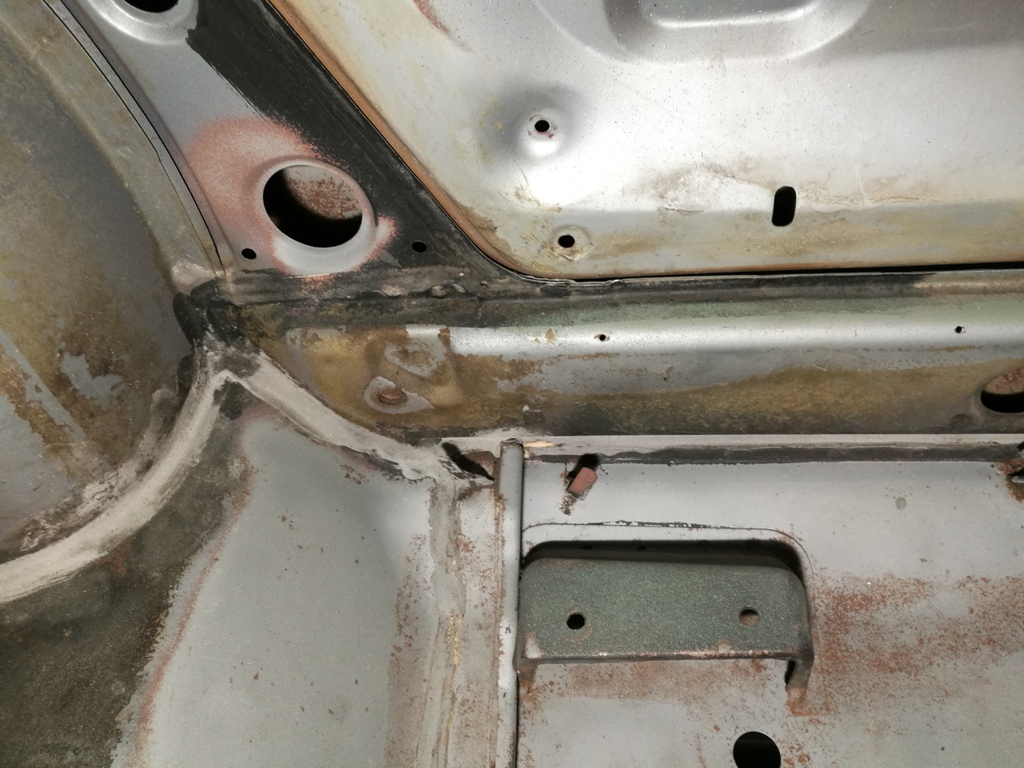

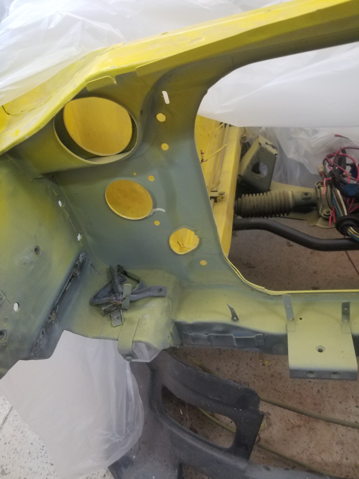

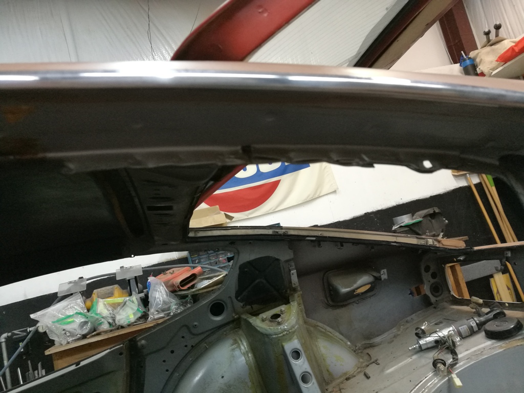

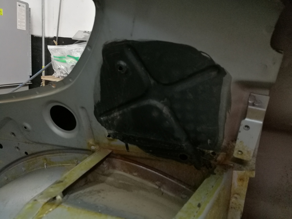

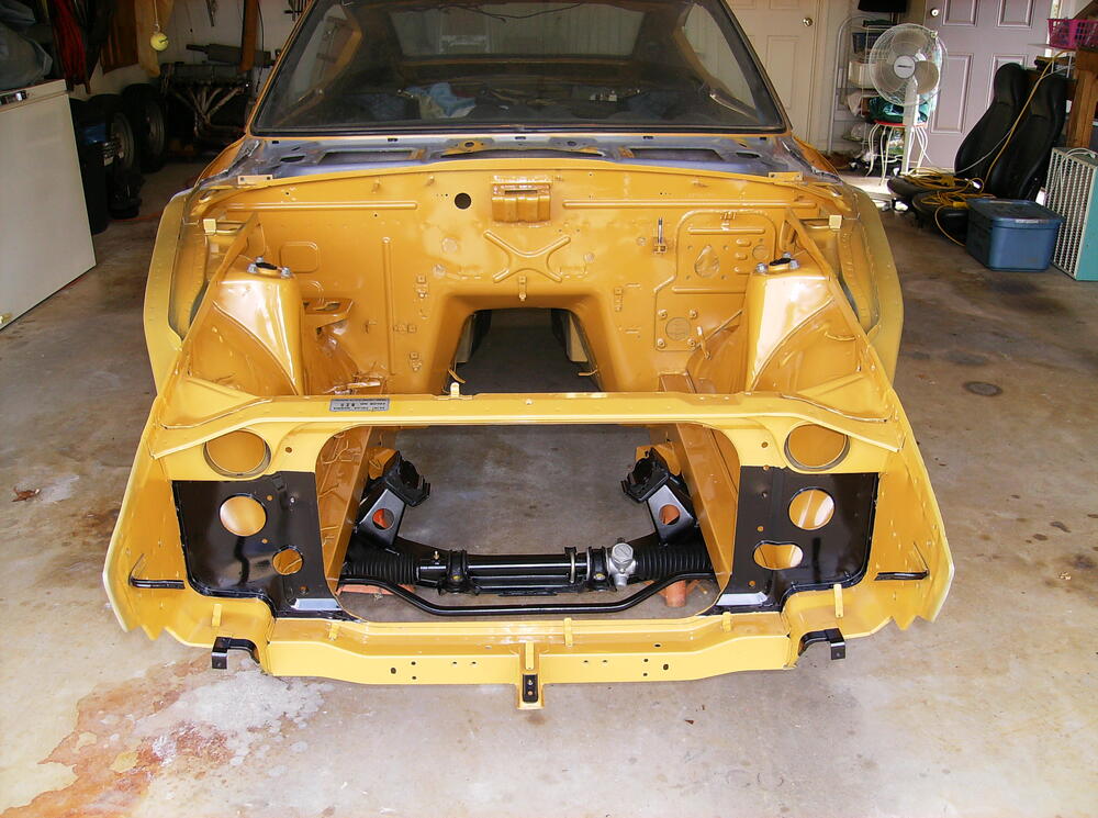

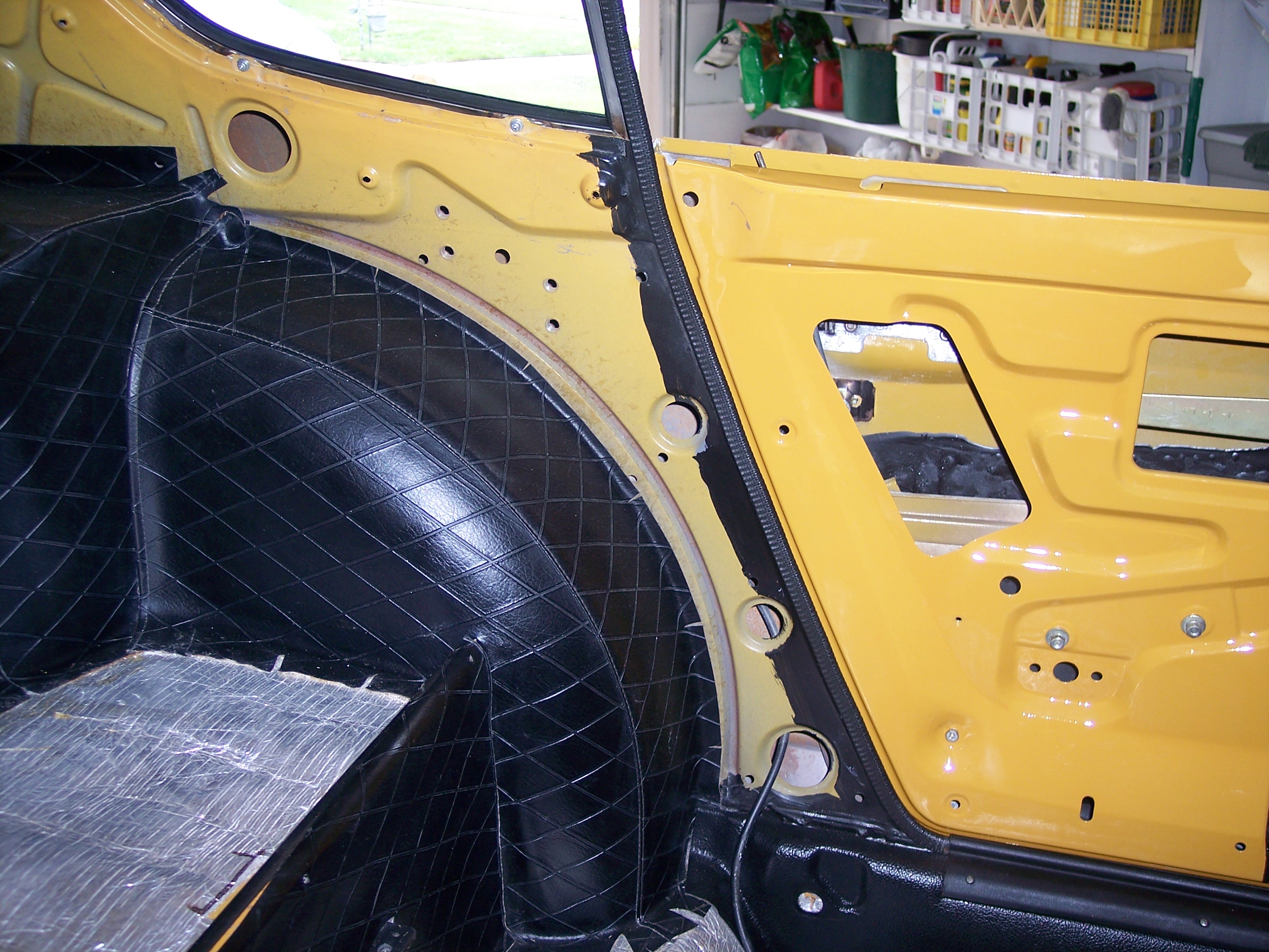

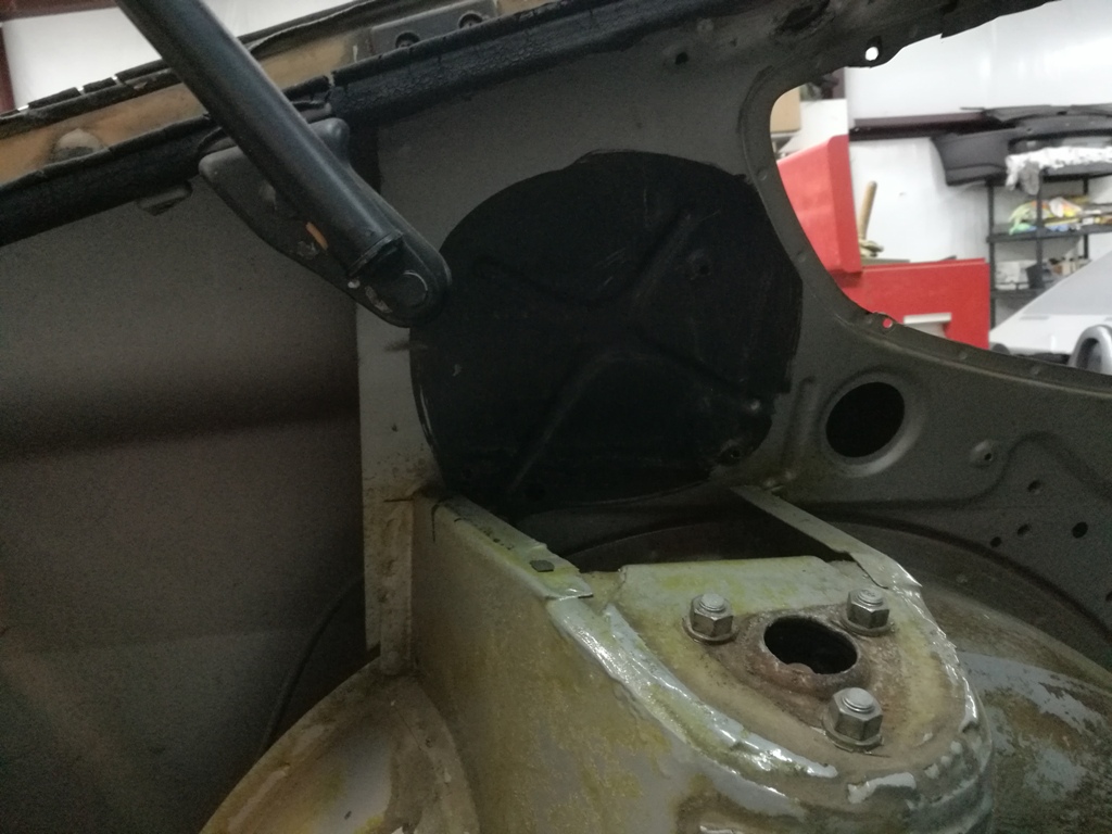

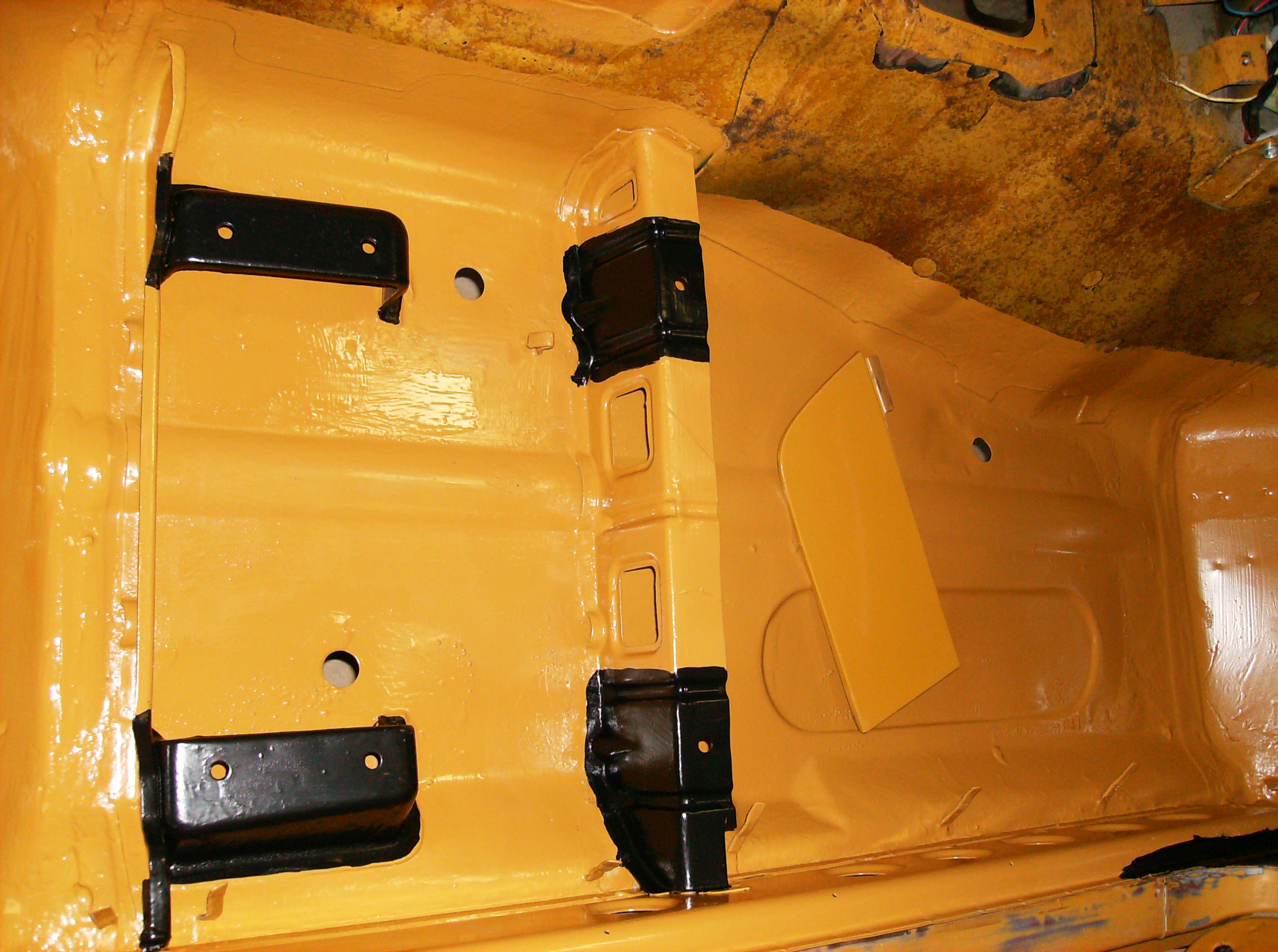

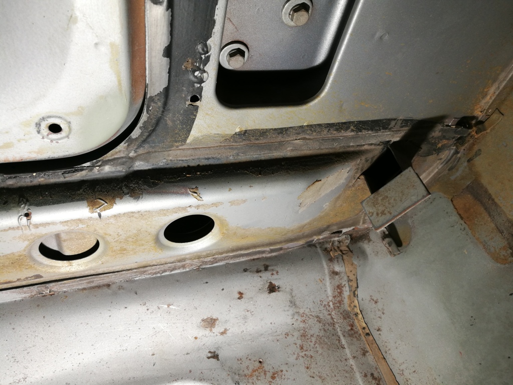

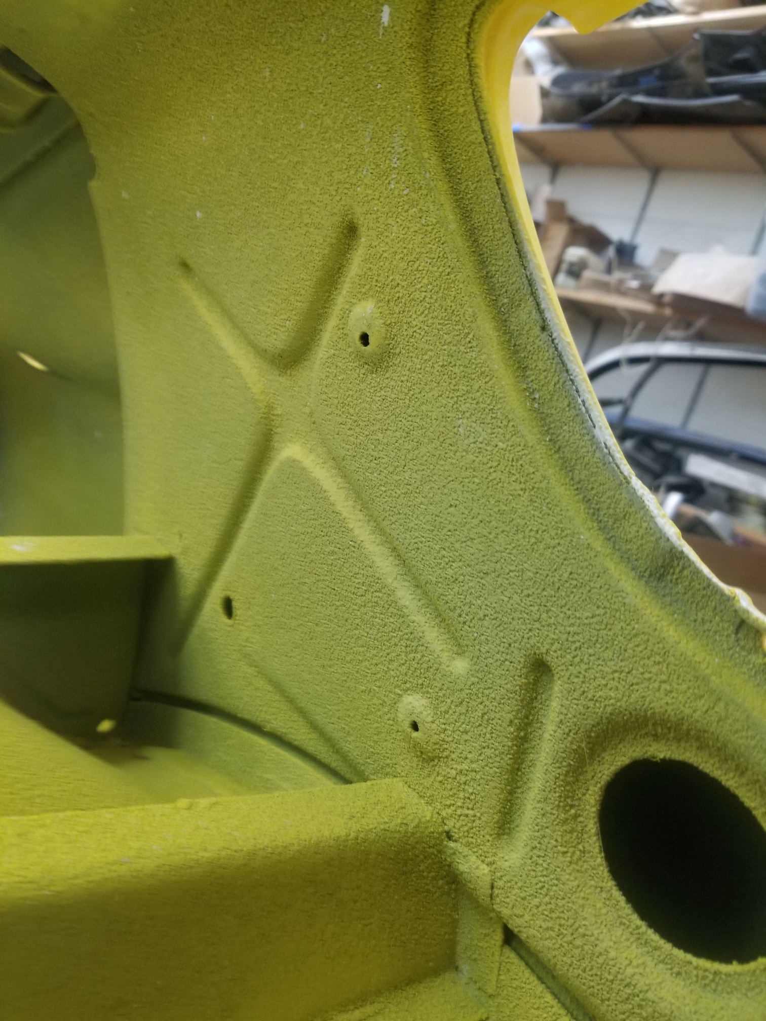

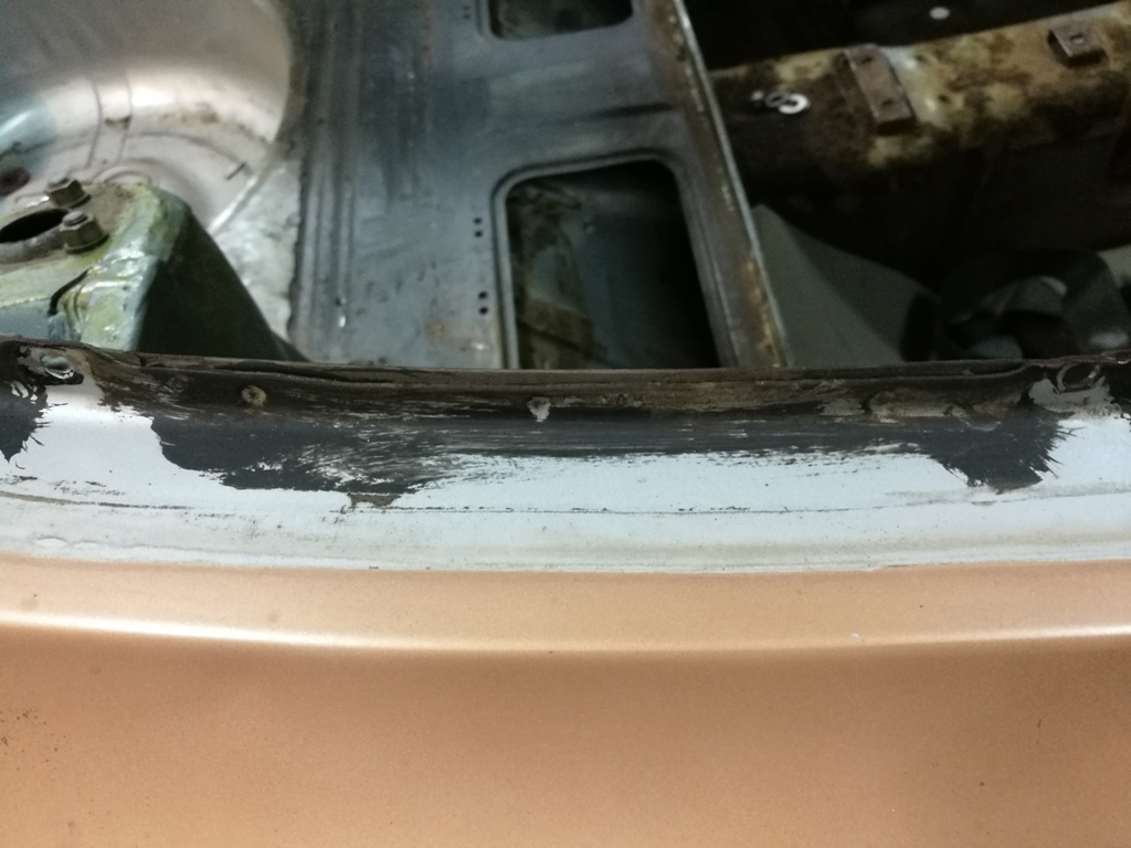

August 16, 20231 yr comment_656004 Here are some pics from my project, just a few VINs younger than Lily. No blackout around the quarter windows as the weather strip seal will cover everything. Blackout on the interior B-pillar at the leading edge of the dogleg panel: Blackout along the A-pillar and frame rail at the kick panel edges: Blackout on the front of the radiator support and the five mounting points for the grill: Also the seat mounting brackets: No blackout behind the speaker holes in the rear interior panel. Hope this helps. Link to comment https://www.classiczcars.com/forums/topic/68505-black-out-areas/#findComment-656004 Share on other sites More sharing options...

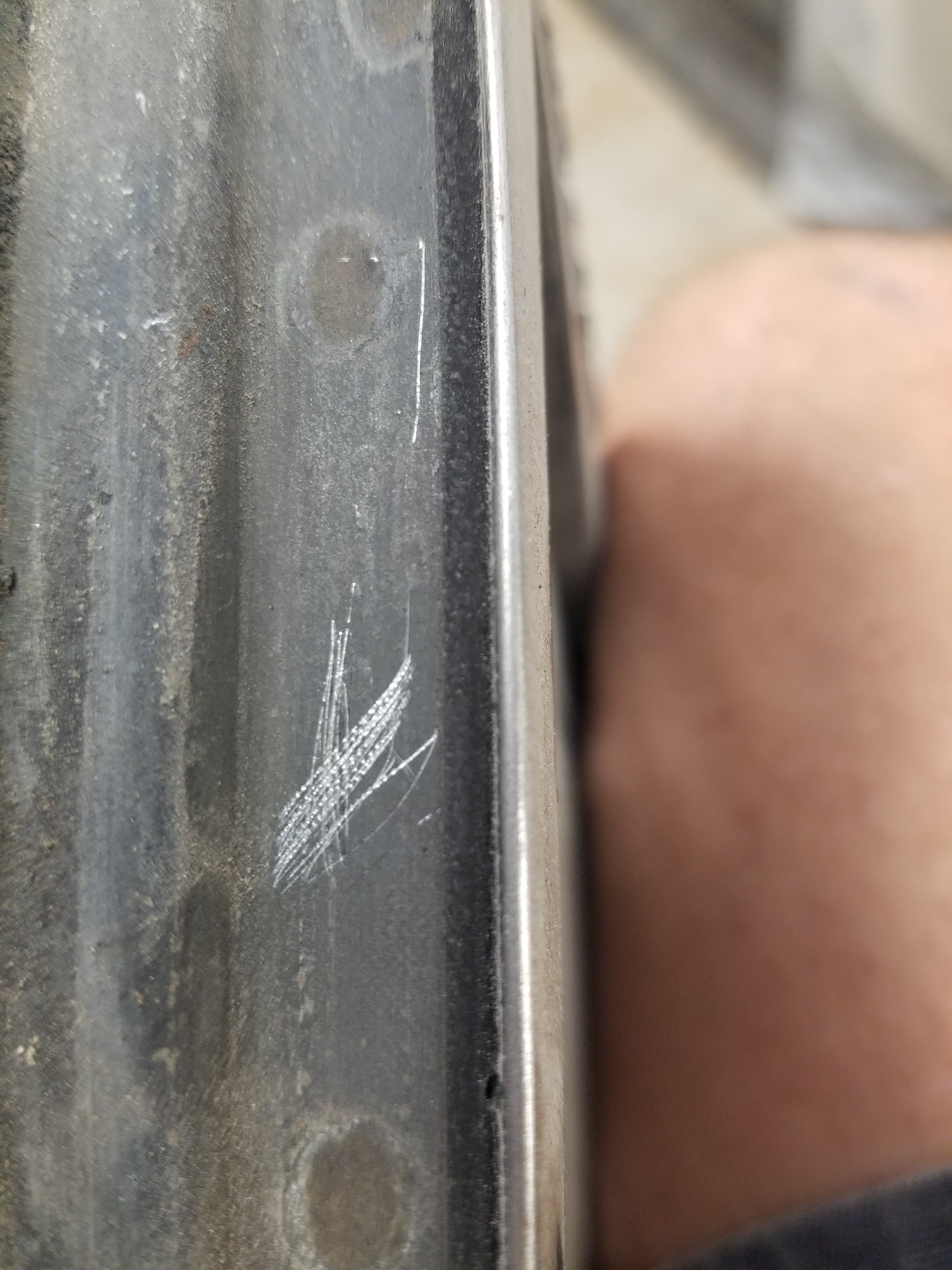

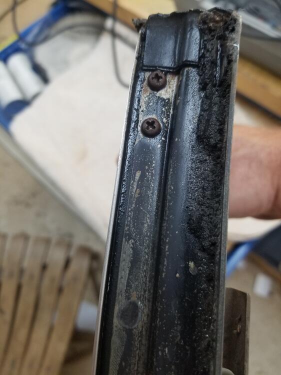

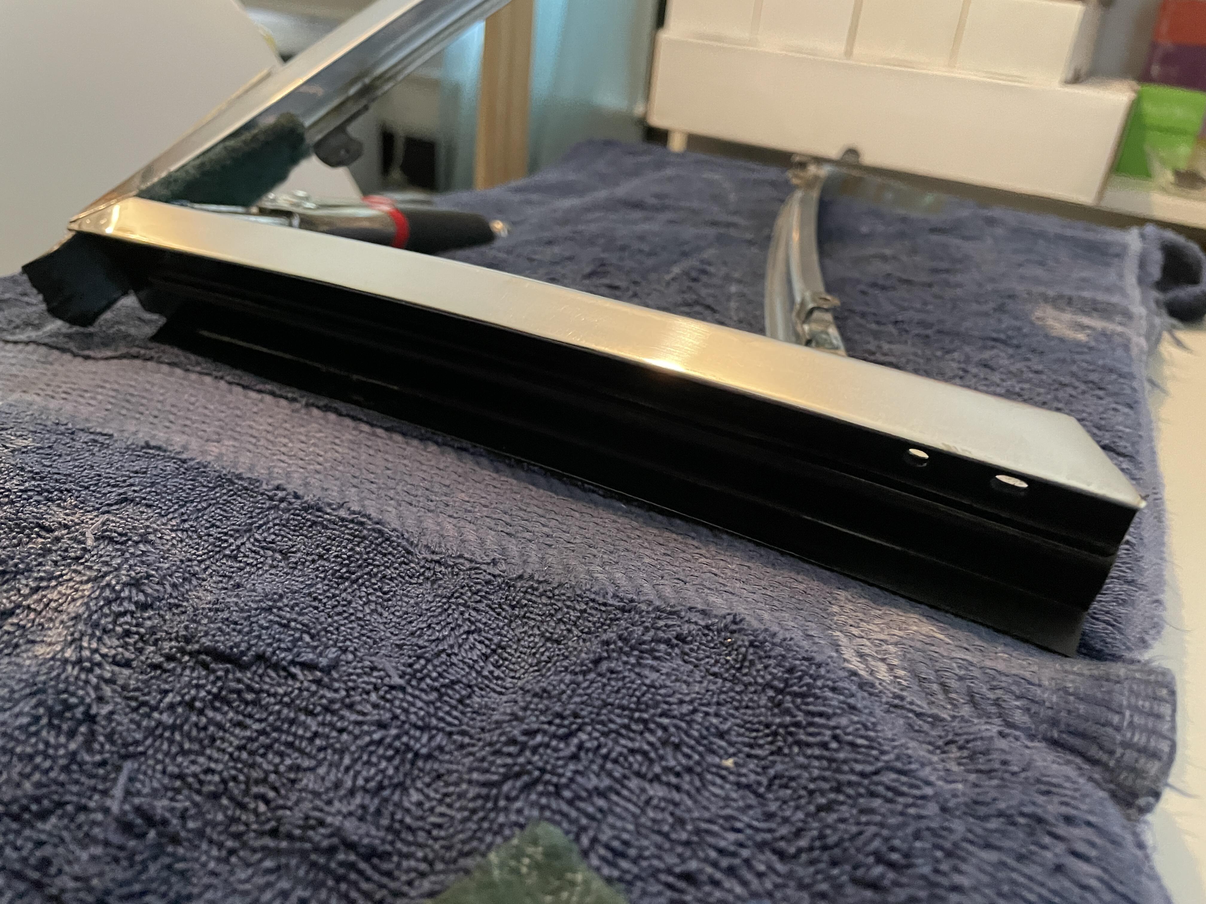

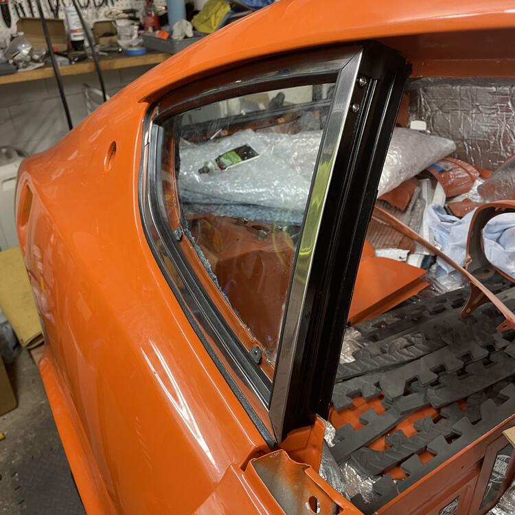

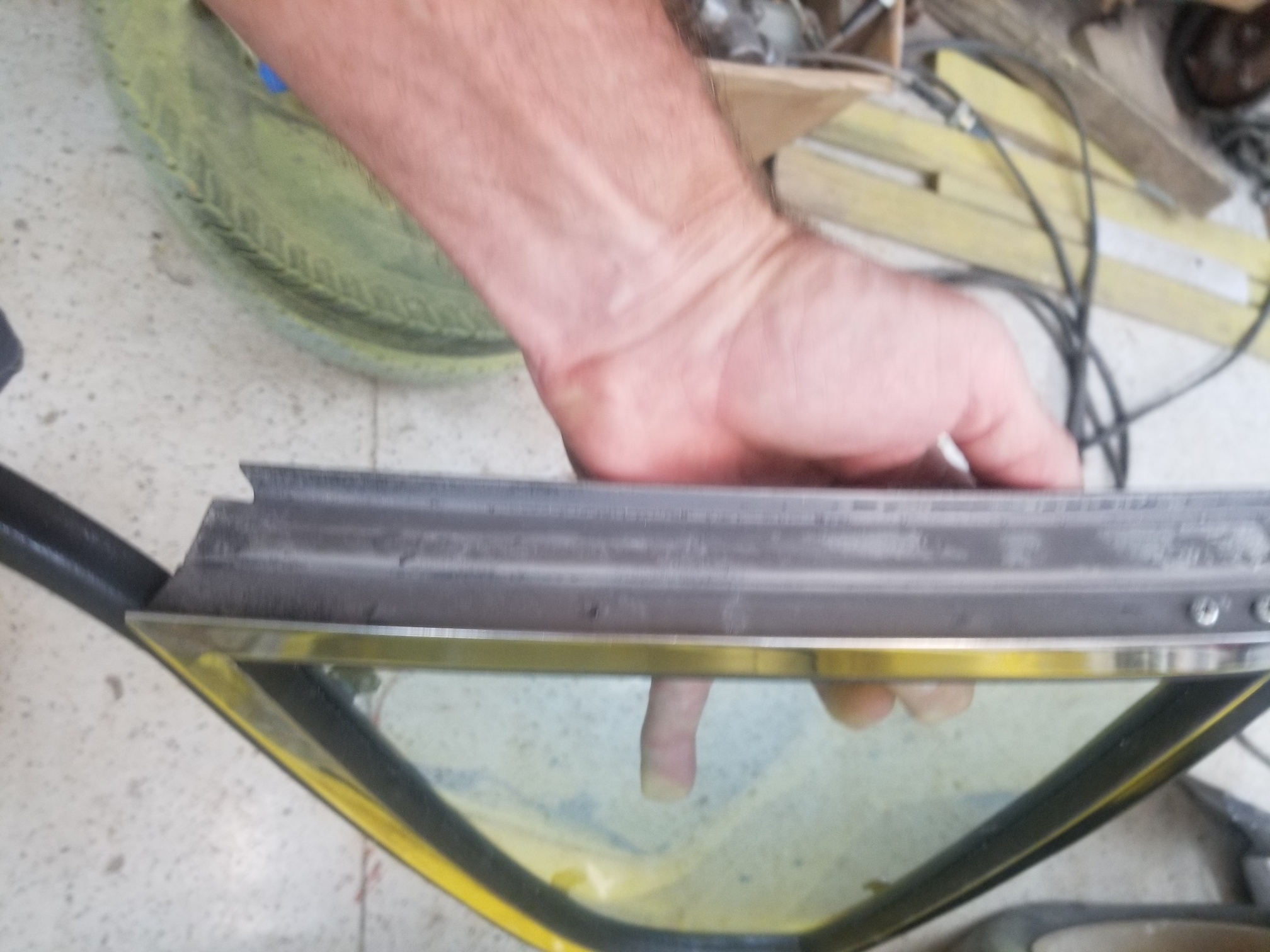

August 24, 20231 yr Author comment_656265 I was looking at some of my spare quarter windows. I'm still not sure this wasn't painted black It scratches off, like a coating Link to comment https://www.classiczcars.com/forums/topic/68505-black-out-areas/#findComment-656265 Share on other sites More sharing options...
August 24, 20231 yr comment_656267 Mine is black. I stripped them and repainted them before putting new seals on. Link to comment https://www.classiczcars.com/forums/topic/68505-black-out-areas/#findComment-656267 Share on other sites More sharing options...

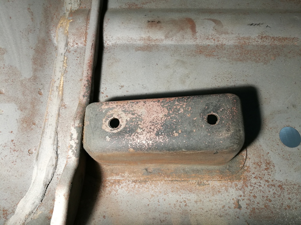

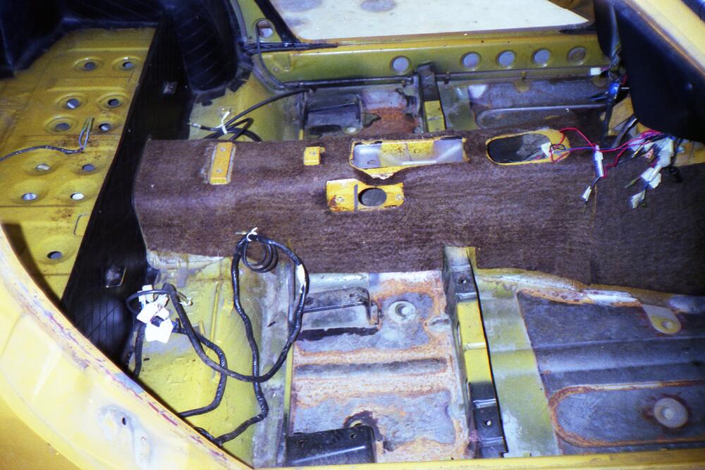

August 29, 20231 yr comment_656443 Some of the areas painted depended on the year of the car. I have a 5/71 with the seat brackets painted with spray paint. I also have a later 71 painted with spray paint. Each of the 4 areas with seat mounting holes were painted. I have a 6/70 with only 3 of the 4 brackets painted. On that car, they used a brush. Curiously also on the 6/70, they painted the floor behind the seat where the tool box is mounted. But just on the driver side. Every indication was it was factory paint on the inside of the car. I skipped painting that section on my restore. I assumed my car was used to train in a new guy. 🙂 Link to comment https://www.classiczcars.com/forums/topic/68505-black-out-areas/#findComment-656443 Share on other sites More sharing options...
August 29, 20231 yr comment_656459 4 hours ago, 87mj said: Some of the areas painted depended on the year of the car. I have a 5/71 with the seat brackets painted with spray paint. I also have a later 71 painted with spray paint. Each of the 4 areas with seat mounting holes were painted. I have a 6/70 with only 3 of the 4 brackets painted. On that car, they used a brush. Curiously also on the 6/70, they painted the floor behind the seat where the tool box is mounted. But just on the driver side. Every indication was it was factory paint on the inside of the car. I skipped painting that section on my restore. I assumed my car was used to train in a new guy. 🙂 My car when I disassembled it in 1999 - the seat mount brackets look to have been spray painted as overspray is visible on the inner rocker. Link to comment https://www.classiczcars.com/forums/topic/68505-black-out-areas/#findComment-656459 Share on other sites More sharing options...

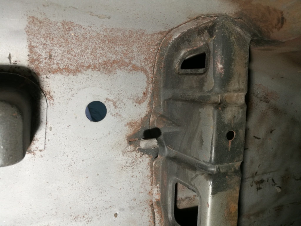

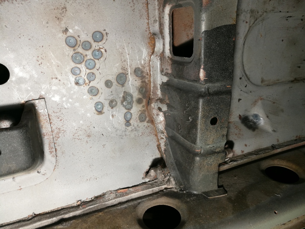

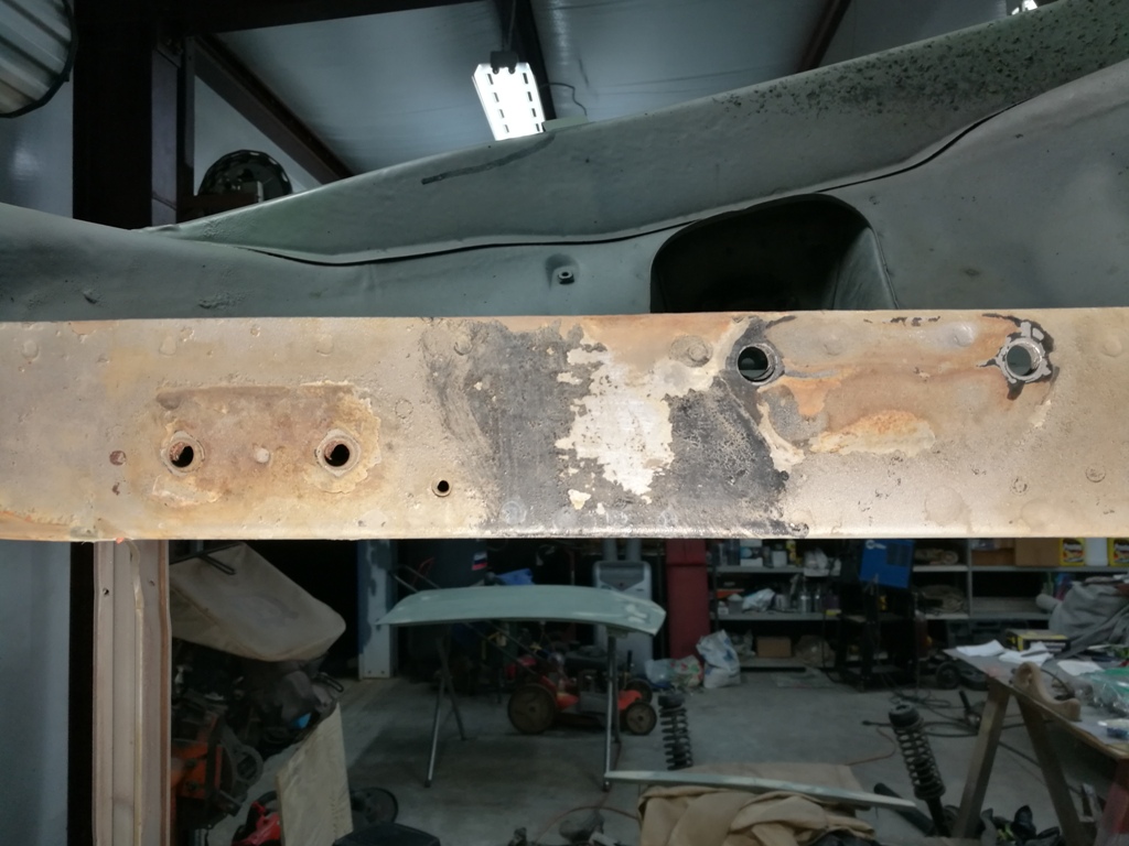

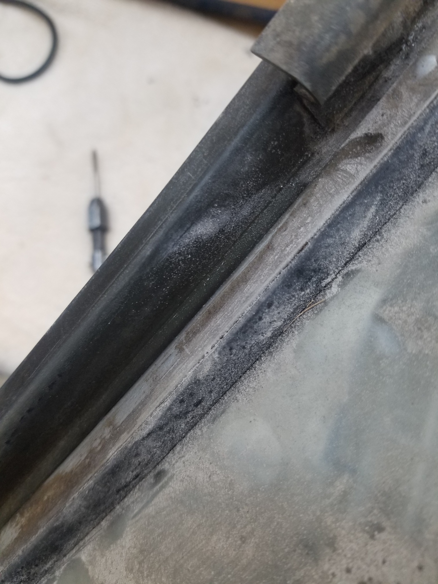

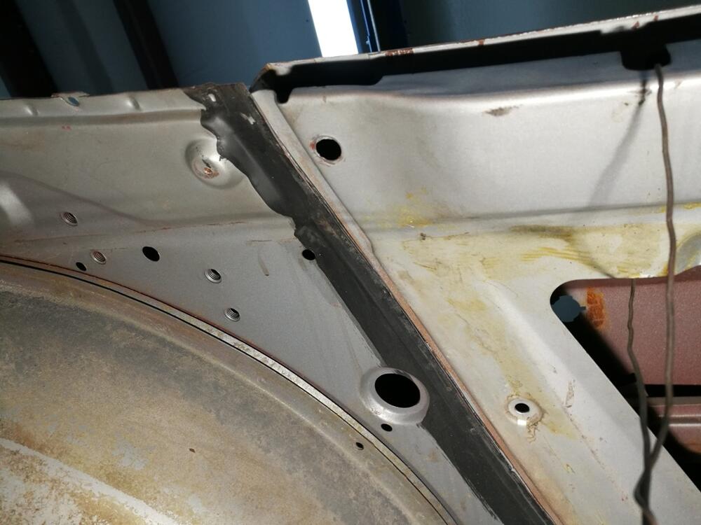

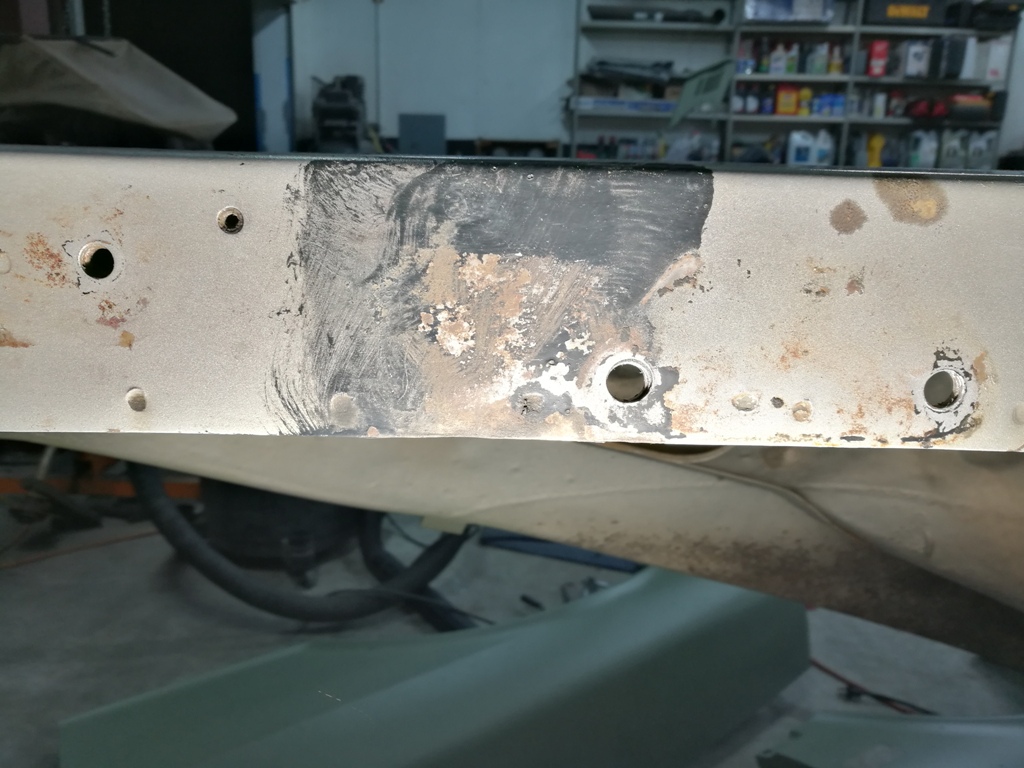

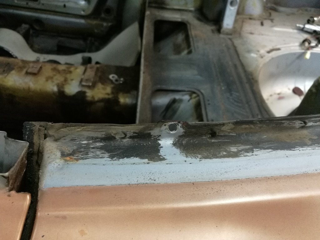

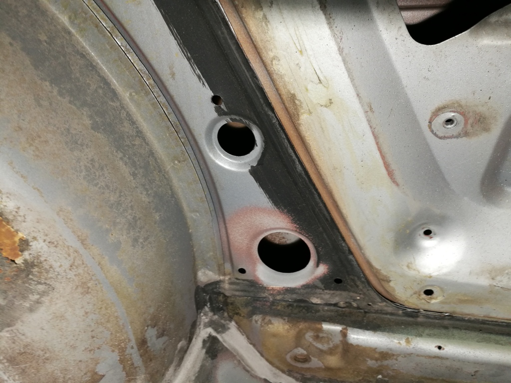

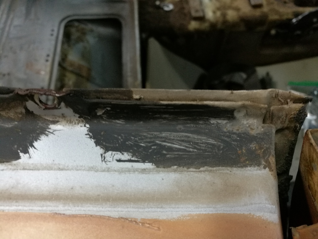

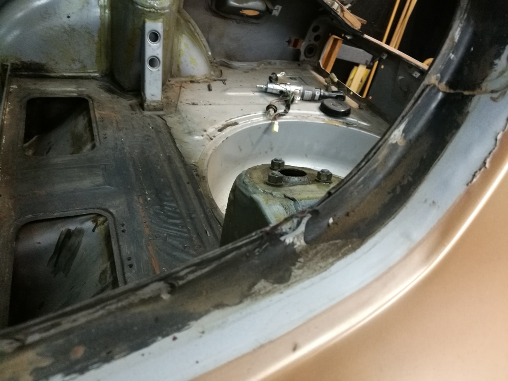

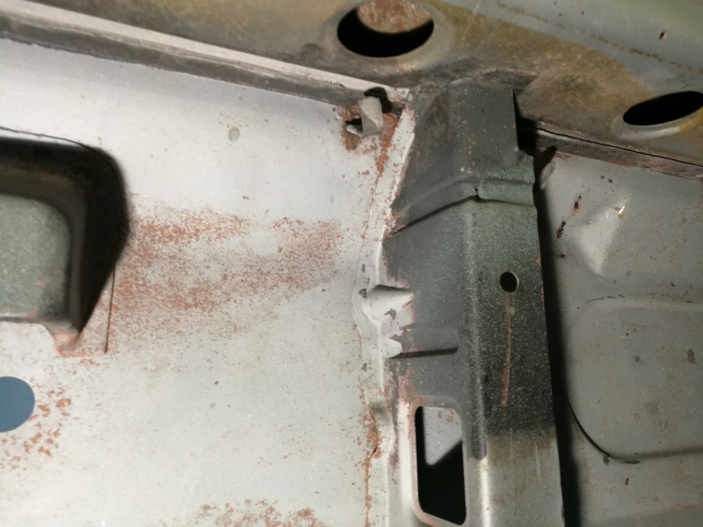

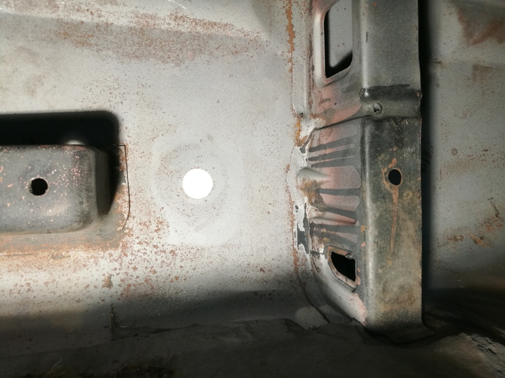

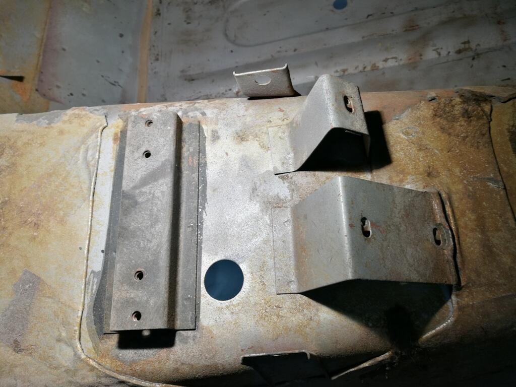

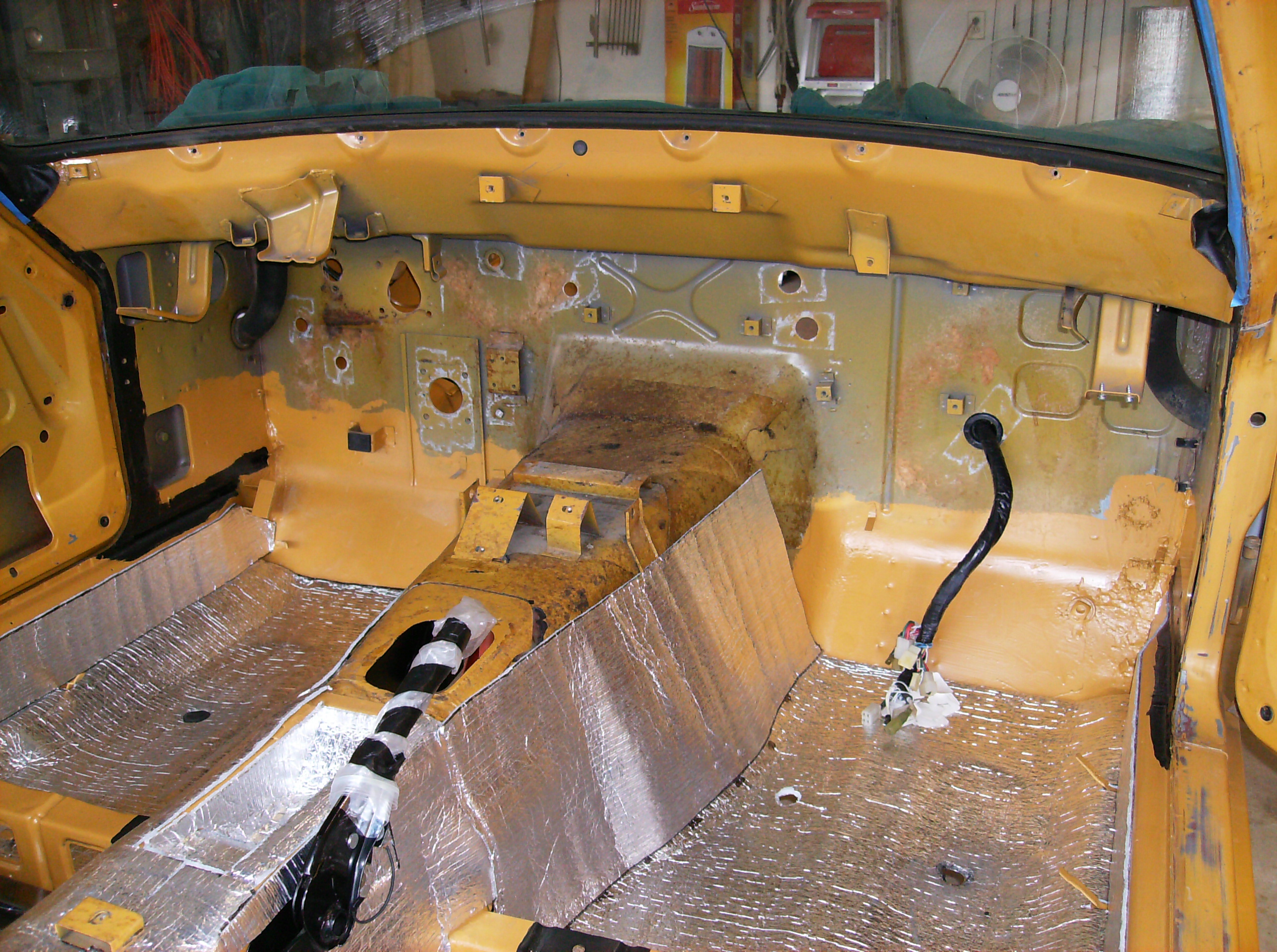

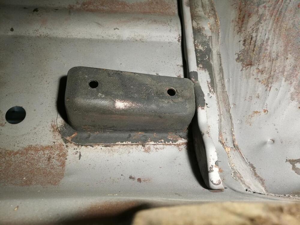

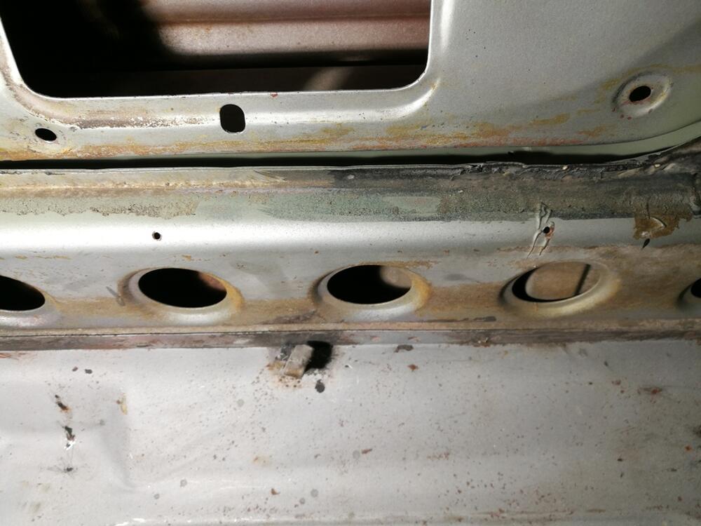

August 30, 20231 yr comment_656473 I few documentation pics from my 6/71 car: Left side front seat mount outboard, inboard: Right side front seat mount outboard, inboard: A couple of the back seat mounts: Interesting details, left side: Quarter windows - looks to have been applied after they were installed! Underside of front frame rails: Edited August 30, 20231 yr by inline6 Link to comment https://www.classiczcars.com/forums/topic/68505-black-out-areas/#findComment-656473 Share on other sites More sharing options...
