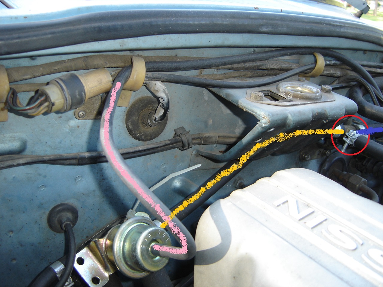

August 20, 20231 yr comment_656130 I've installed a 1978 FPR on the passenger's side firewall. The couple of aftermarket ones I tried leaked down. I ran a T out the rail end closest to the windshield, one side going to the CSV the other to the FPR. I've cleaned it up a little since this picture was made. No zip-tie. Don't use a low pressure glass fuel filter like I have at the front end of my rail. It was a temporary way of checking for trash after I relined my fuel tank Edited August 20, 20231 yr by siteunseen Link to comment https://www.classiczcars.com/forums/topic/68510-fuel-rail-upgrade/#findComment-656130 Share on other sites More sharing options...

August 20, 20231 yr Author comment_656143 I've installed a 1978 FPR on the passenger's side firewall. The couple of aftermarket ones I tried leaked down. I ran a T out the rail end closest to the windshield, one side going to the CSV the other to the FPR. I've cleaned it up a little since this picture was made. No zip-tie. Don't use a low pressure glass fuel filter like I have at the front end of my rail. It was a temporary way of checking for trash after I relined my fuel tankI see, so the FPR maintains the original set up, but you used a T fitting for it. Sent from my iPhone using Tapatalk Link to comment https://www.classiczcars.com/forums/topic/68510-fuel-rail-upgrade/#findComment-656143 Share on other sites More sharing options...
