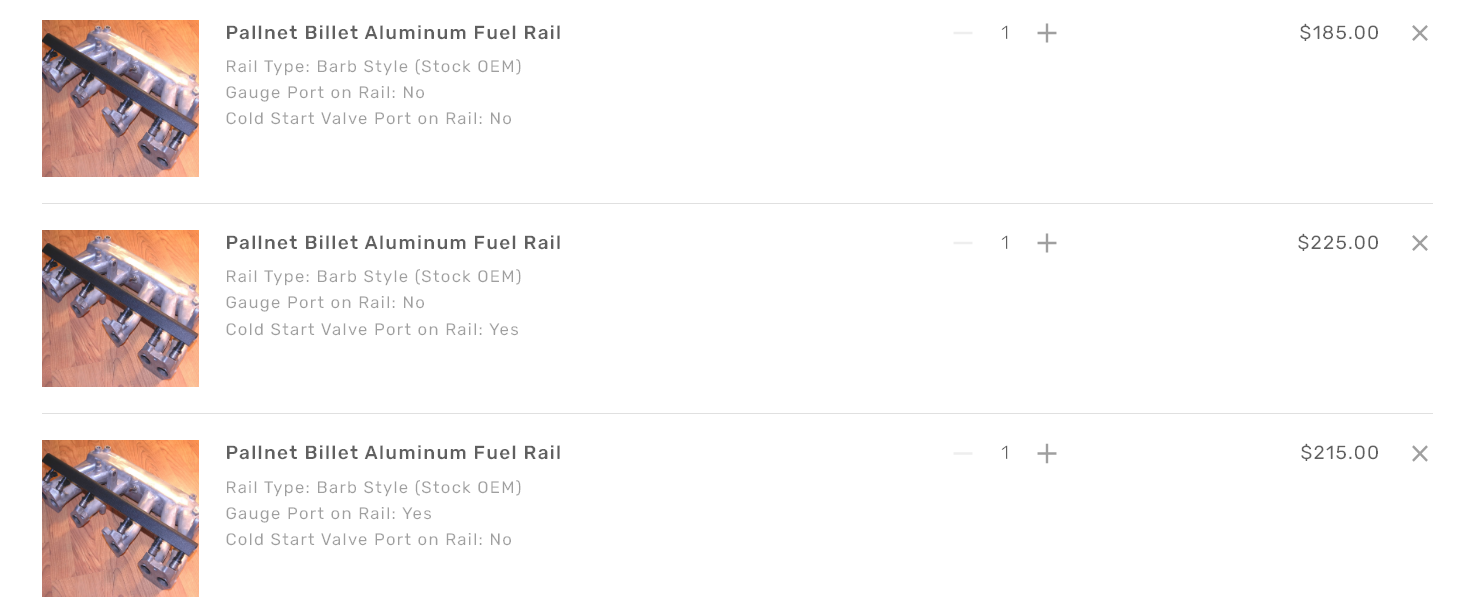

godzilla race works rail that comes with a built in gauge. But after doing some price calculations I’m looking at around 380-400 in total price.
That seems like a lot.  There's really no need for a gauge, unless you plan to change fuel pressure often.  Once you set it it doesn't change.
Looks like they're charging $30 - 40 just to drill and tap a hole.  If you're handy you can do that yourself.

I can definitely make that rail myself, I saw the last thread on making one. I think the rail is definitely an inflated item.
I made one from some inexpensive blemished bar stock.  It wasn't too hard.  I had a drill press and built a jig to hold the bar.
