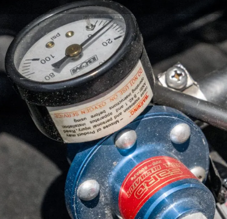

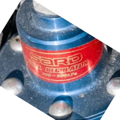

August 26, 20231 yr Author comment_656296 I was browsing pictures of a new BaT Z and found what looks like an FPR that holds pressure. Might be worth some research. Picture 114. https://www.nengun.com/oil-fuel-fuel-pressure-regulators/ https://bringatrailer.com/listing/1972-datsun-240z-290/ Going to look into this regulator. Decided I will be changing the rail for a protunerz rail. When on sale their usually 90 dollars and come with all fittings. Sent from my iPhone using Tapatalk Link to comment https://www.classiczcars.com/forums/topic/68510-fuel-rail-upgrade/?&page=3#findComment-656296 Share on other sites More sharing options...
August 26, 20231 yr comment_656299 RHD Japan has it. https://www.rhdjapan.com/search/category/fuel-system_fuel-pressure-regulators/brands/sard/ Link to comment https://www.classiczcars.com/forums/topic/68510-fuel-rail-upgrade/?&page=3#findComment-656299 Share on other sites More sharing options...
August 26, 20231 yr Author comment_656301 RHD Japan has it. https://www.rhdjapan.com/search/category/fuel-system_fuel-pressure-regulators/brands/sard/Which one of those do you recommend? Im going to stick with barb rubber hose lines.Sent from my iPhone using Tapatalk Link to comment https://www.classiczcars.com/forums/topic/68510-fuel-rail-upgrade/?&page=3#findComment-656301 Share on other sites More sharing options...
August 26, 20231 yr comment_656302 Weird that that link is dead now. It should have opened to a page with a couple of SARD FPRs. Google shows them on eBay too. I'd search around first and see if you can find any internet comments about leak-down. Just because one didn't doesn't mean that they all don't. https://www.google.com/search?q=sard+fuel+pressure+regulators Link to comment https://www.classiczcars.com/forums/topic/68510-fuel-rail-upgrade/?&page=3#findComment-656302 Share on other sites More sharing options...
August 26, 20231 yr Author comment_656303 Weird that that link is dead now. It should have opened to a page with a couple of SARD FPRs. Google shows them on eBay too. I'd search around first and see if you can find any internet comments about leak-down. Just because one didn't doesn't mean that they all don't. https://www.google.com/search?q=sard+fuel+pressure+regulatorsLink works fine for me! On a form over function I like this one, looks like it’s standard fittings as well. Will do some more research on leak down.Sent from my iPhone using Tapatalk Link to comment https://www.classiczcars.com/forums/topic/68510-fuel-rail-upgrade/?&page=3#findComment-656303 Share on other sites More sharing options...
August 26, 20231 yr comment_656304 Looks like the SARD might be like others. https://www.google.com/search?q=sard+fuel+pressure+regulators+leak+down https://www.rx7club.com/new-member-rx-7-technical-256/sard-fuel-regulator-leak-injector-line-816953/ But then this guy below says his does hold pressure. I'm seeing that many people aren't real clear on things like the check valve inthe fuel pump. The guy in the link above could have a check valve problem. https://aus300zx.com/index.php?threads/holding-fuel-pressure.337928/page-2 Link to comment https://www.classiczcars.com/forums/topic/68510-fuel-rail-upgrade/?&page=3#findComment-656304 Share on other sites More sharing options...
