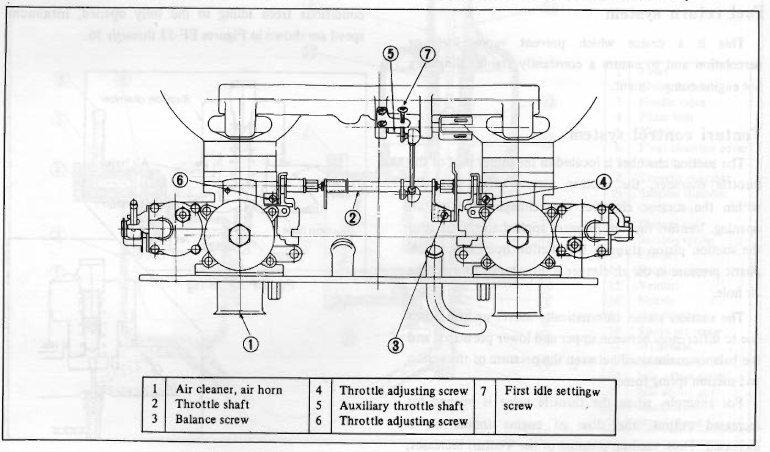

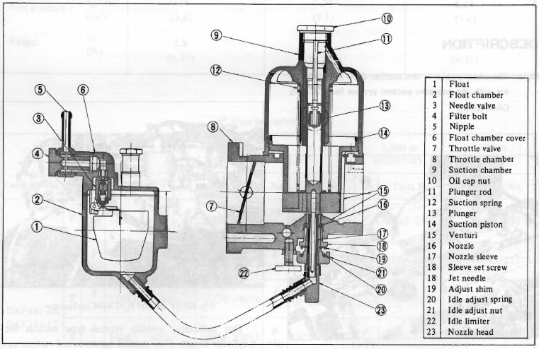

August 21, 20231 yr comment_656188 You have the carburetors biased too far to the rear carburetor. Let's assume that your jet needles are set properly and are straight. Other assumptions include your floats are set properly, the needle valves function properly, and the carburetors are jetted the same. Verify your valve lash! If you haven't adjusted your valves lately, now is the time. This removes a potential confounding factor. Turn your idle adjust nuts fully in (#21 in the first drawing). Back them out 3 turns each. (Okay, this may be a little rich, but let's do it that was for now.) Get the car up to temperature and turn it off. Make sure the first idle setting screw (#7 in second picture) is not pressing on the throttle. Ensure that the balance screw (#3 in 2d picture) is barely in contact with the linkage on the rear carburetor. If it's pushing down on the linkage, that will bias toward the rear. Try starting the car. If it won't idle, then use the first idle setting screw to get an initial idle. Check the balance, and use the throttle adjusting screws (#4 & #6 in 2d picture) to balance the carburetors. Â Link to comment https://www.classiczcars.com/forums/topic/68511-no-vacuum-on-front-carb/#findComment-656188 Share on other sites More sharing options...
August 21, 20231 yr Author comment_656190 https://youtu.be/tbbZOlJrnjw Here is a video of it running. I runs decent, but i know not enough air is getting pulled through that carb because it has old fuel in the bowl. Ive been running and driving it plenty enough with all new gas in the tank where there shouldn't be any old gas left in the system. Also it struggles to rev past 4k so I don't think the vacuum advance is working (not enough vacuum). The way I found this issue in the first place was because I tried to adjust the carbs according to the service manual. So I had set the idle nuts to the proper turns according to their chart, the first idle screw wasn't touching the linkage, the balance screw on the rear carb was barely touching the linkage, the idle was set the 650 rpm, and when I went to put an airflow meter to the front to measure it, it didn't read anything. I put the same airflow meter on the rear carb and it killed the engine. I tried it with 2 different flow meters. I have also verified valve clearances between the cam lobe and the top of the rocker. Cold it was set to .20 mm for the intake and .25 mm for the exhaust. I'm not sure if thats the same as the valve lash (if not, I've got no clue how to measure that). Link to comment https://www.classiczcars.com/forums/topic/68511-no-vacuum-on-front-carb/#findComment-656190 Share on other sites More sharing options...
