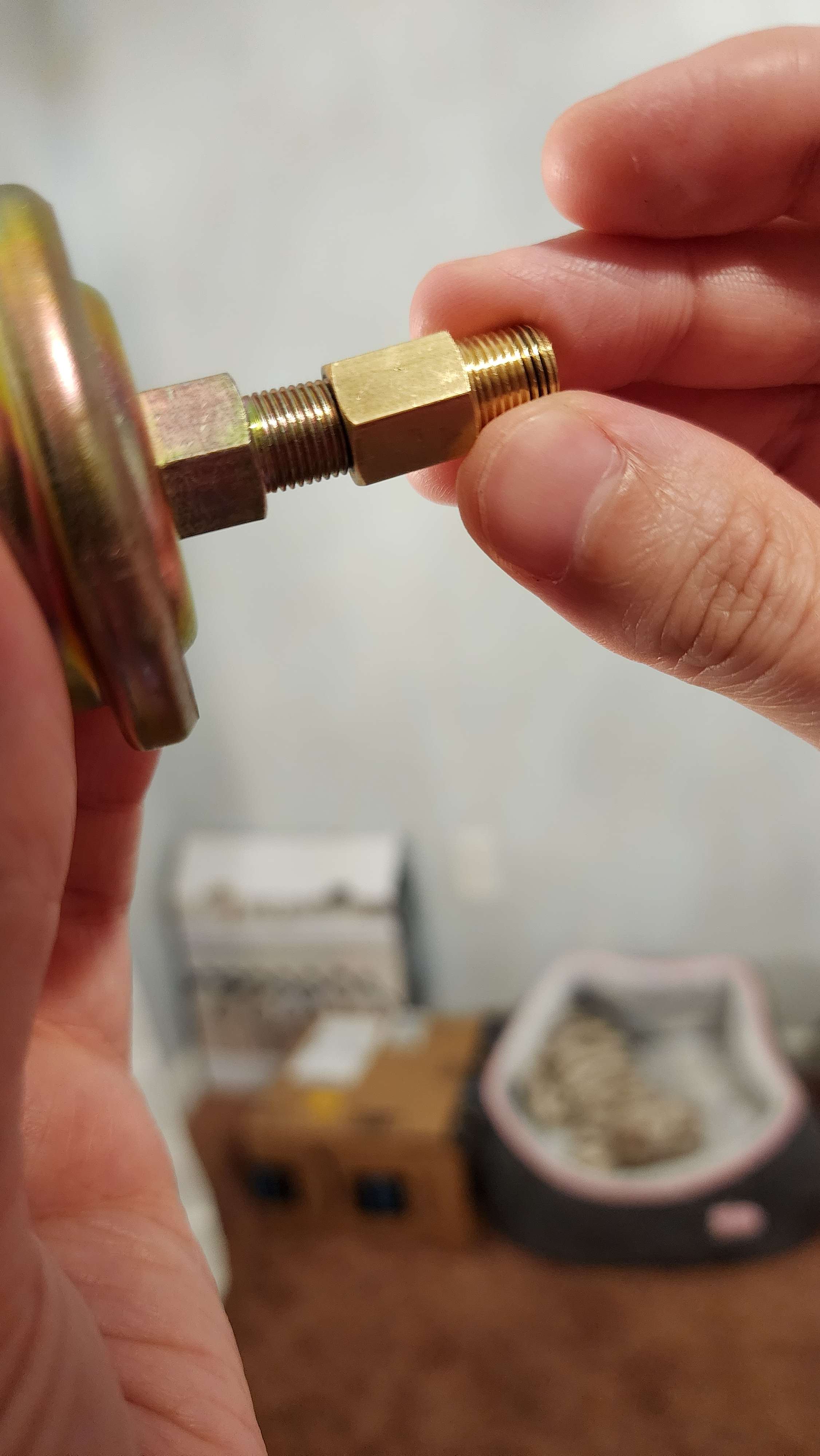

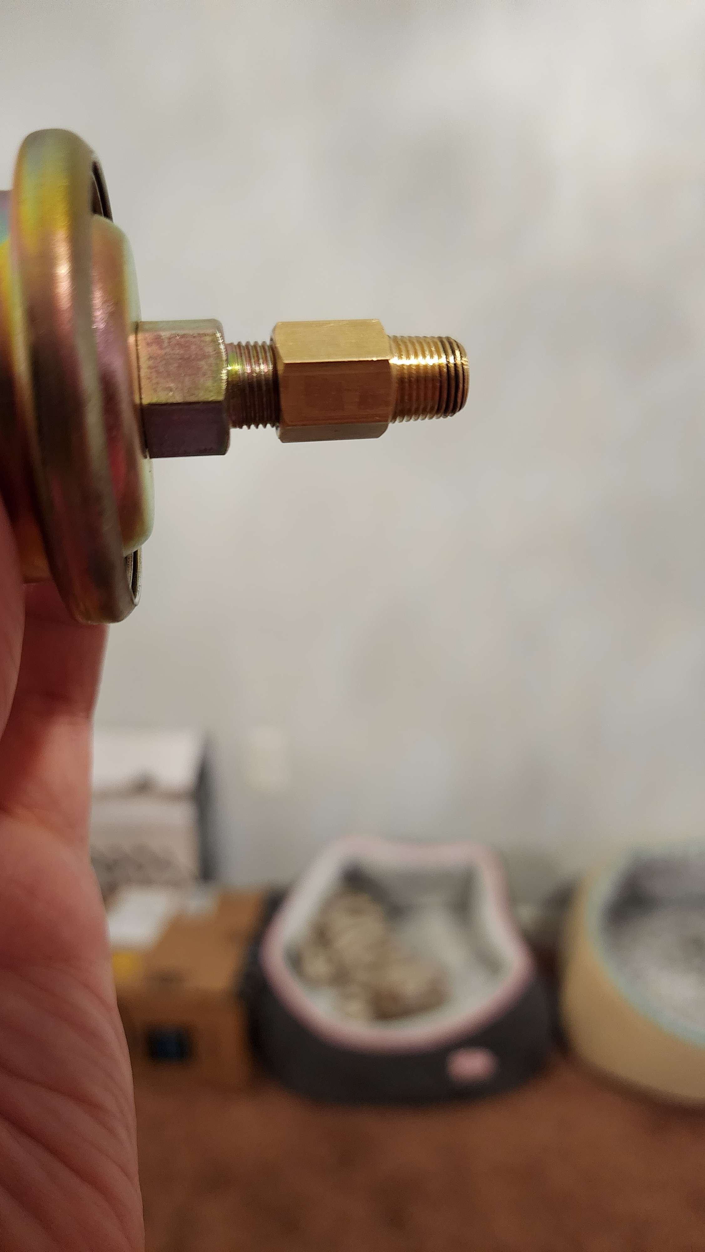

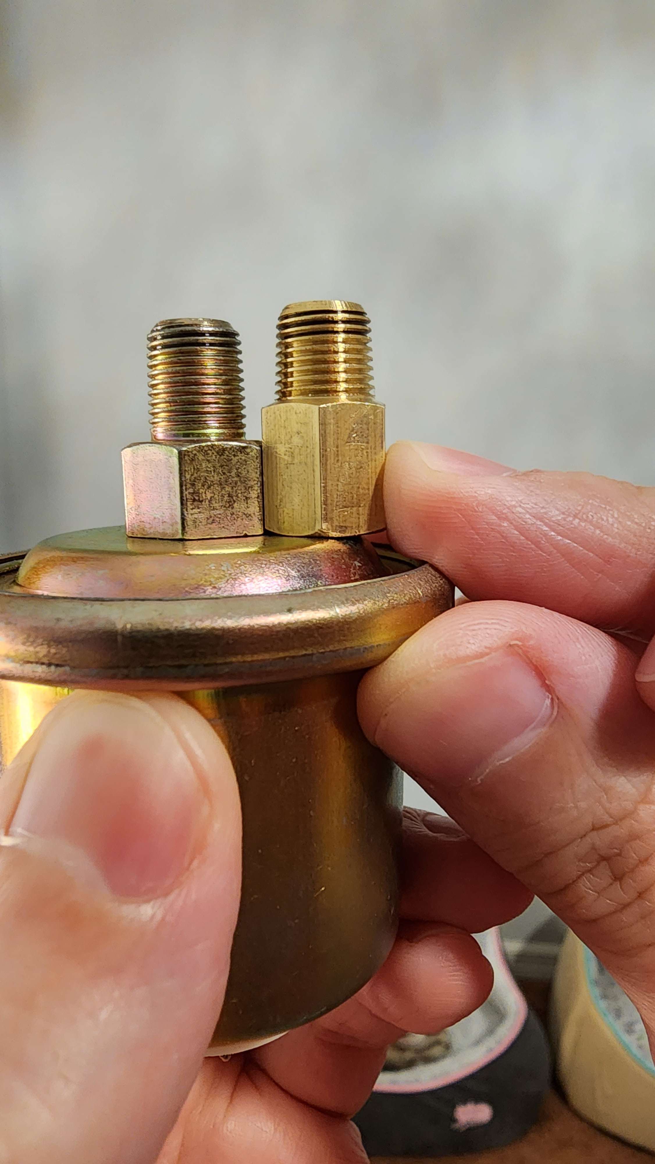

The thread size for the oil pressure sensor is 1/8" BPST based on what I've looked up and what Yarb has confirmed for me.  I have a replacement Duralast sensor (I was able to get it locally, and its a two prong for my 78) that I mentioned, but something just didn't feel right when I tried to thread it in; The sensor threaded in a few micro turns, then hit resistance. While it is tapered like @Captain Obvious mentioned, that would explain it, but something in me just couldn't shake the fact that something may be "off." (Maybe its paranoia.)
So I went online and ordered an adapter that to my understanding (if someone wants to check me feel free) goes from the 1/8" male BSPT, to 1/8" NPT female.
My reasoning here, was I wasn't sure if since its a Duralast sensor, if most cars would be NPT and not BSPT, so I wanted to check before I started threading this thing into the block.
The verdict?   The Duralast sensor will thread into that adapter probably a good 2-4 full turns before it meets resistance, so a lot.
If I try and thread the Duralast sensor into the block, it will go a few micro turns like i mentioned before it meets resistance (maybe this is because its tapered.)
I guess my end question is, how can I tell if this Duralast sensor is NPT or BSPT? it will thread into an NPT female adapter much further before it meets resistance than when I try threading it into the engine block.  Out of an abundance of caution, when i meet resistance I stop to avoid damaging threads.
Is it possible this sensor is NPT and not BSPT?
Some pics below for thought; I'll also have my report on the ignition switch replacement after I get this situated.
Adapter is supposed to be 1/8" male BSPT to 1/8" NPT female
Adapter and sensor side by side
Gauge screwed into the adapter. The point at which I stopped here is the second I started to feel slight resistance. Threads are fine on both; The sensor threaded in a good few turns fine.  If it was BSPT like its supposed to be, wouldn't it have an issue going into an NPT female thread??  I can't tell if the adapter is tapered on either side' One of the comments on amazon did say it threads into a 280z block though. So there's that.
