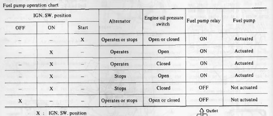

5 hours ago, Zed Head said:
1978 uses the oil pressure switch or the alternator current to power the fuel pump relay.  Or Start.
So based on that chart the fuel pump would still work even if the oil pressure switch was bad assuming the alternator was working? I figured if the oil pressure sensor was bad that would cause an issue with running when key was on.

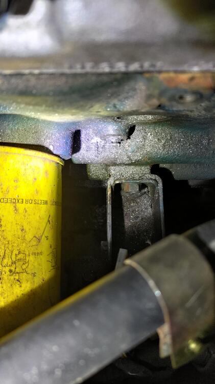

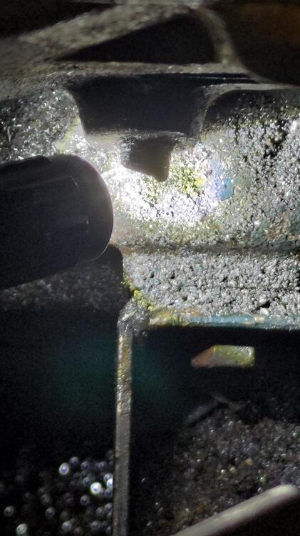

Also - I pulled the plugs to try and remove that oil pressure sensor when it was still whole.  The plugs (that have maybe fifteen minutes of runtime) are black, so somethings making it run rich.
Also @SteveJ Pictures as promised...It's not pretty. I'm not sure if I can get the drill bits or tap wrenches in there with any kind of accuracy. I did see a stud extractor socket that Performance Tool has (available at advance auto parts, depending on your location) that I was going to consider, but I honestly don't know if there is enough stud left sticking out of the block for that to work.
Here's what I was considering - https://shop.advanceautoparts.com/p/performance-tool-stud-extractor-w83203/11931907-P?searchTerm=stud+extractor
It's a bit hard to see in the first picture, so I held a light up to the block, you can see the silhouette of what is left remaining of the stud.
