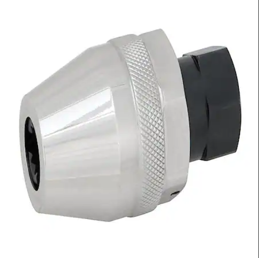

I'm really hoping I don't have to pull the engine (wouldn't be the first time I've removed an engine by a long shot.) Just because of clearance issues I'm wondering if it might be better to rent a welder and weld a nut to that stud.  Or I could try that socket stud extractor first, but I honestly don't think there's enough stud left that it could really grab onto to turn.

The consensus, based on the comments above, is that the stub of material remaining in the block will come out easily if you could just get a hold of it, either on the inside or the outside.
I, however, disagree with that consensus.
That things is tapered threads and it's in there tight enough to snap itself off when you twisted the oil pressure sensor with a pair of vice-grips. It's not gonna come out without a fight. That thing was threaded in there tight enough to seal the pipe threads and snap off the sender unit. I don't think it's going to turn easy. It's certainly worth a try to use an extractor into the center hole, but I'm not confident that will work. Just don't snap off the extractor inside the remaining stub.

Use an extractor and a adjustable wrench. Use a mirror or the selfie options on your phone to get a good look at it. Put the extractor  in the hole and turn it to the left, ccw. If you can't get a 2" extractor in it because of access, it's gonna be really hard to weld a nut on whats left.

So assuming I were to not go the welding route initially,
would it be best to use the socket extractor that Zed mentioned above? or the one I have to hammer in? There's also the one I mentioned from advance auto parts above, I'll include a picture of it for ease of reference (but honestly I'm not sure there's enough stud protruding out of the block for it to really grab.)
There isn't much room if any to hammer anything in there, that's my main concern with using something I would have to tap in with a hammer, I don't have the room to swing to build up enough momentum, and I have no way of knowing that I'm driving it in straight.
