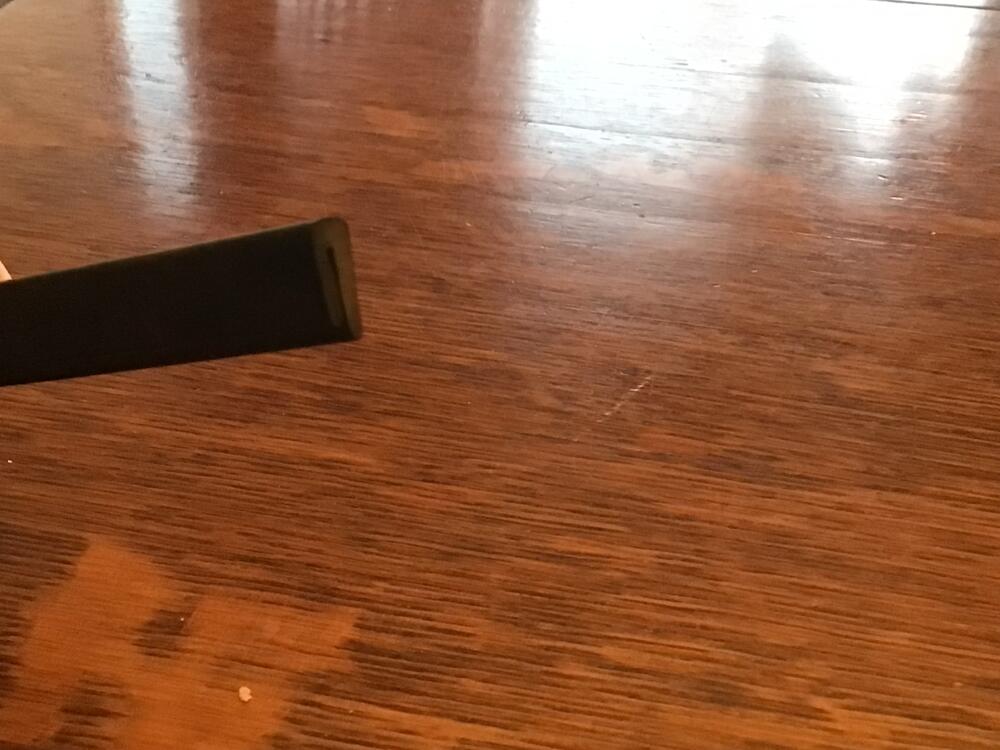

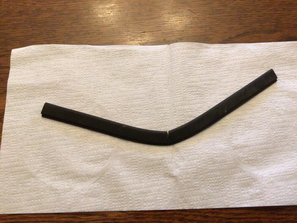

9 inches long, 1/2” wide, slit is for 1/32 sheet metal. Strangely the width of one side is slightly narrower than the other. Not likely going to find replacement material with that, but no one will notice.
They take a little wedge out of the center to help it conform to the corner

A heat gun should help with forming it around the corners.
