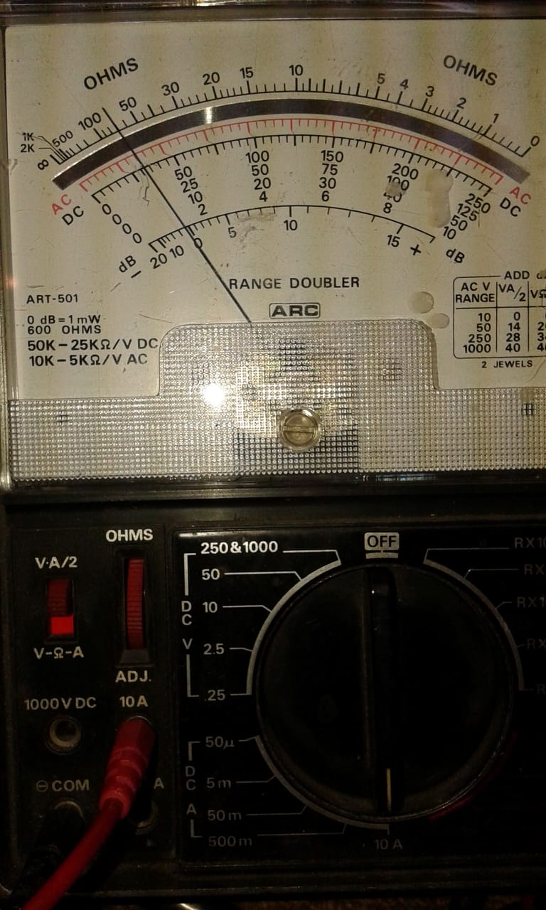

Yeah, My OTC multimeters are from the 80's. I guess it may be time to invest in newer tech. 😄

I only thought it!  Yes it's handy to have a capacitance meter..  And i realy like Fluke meters!  I got myself a Beckman many years ago, you can throw it against the deck and then in a bucket of water and measure your threefase system while in water.. haha.. never tried that!  (with it's own correct leads ofcourse..)
These days there are a lot of good measuring tools.. get yourself a quality product!  I still got my fully working analog meter of 1978!!   ANALOG! I still use it from time to time.. i sometimes use it measure capacitance with the ohms-meter.. (Can't tell the capacitance but i can see if the capacitor is dead ..)
