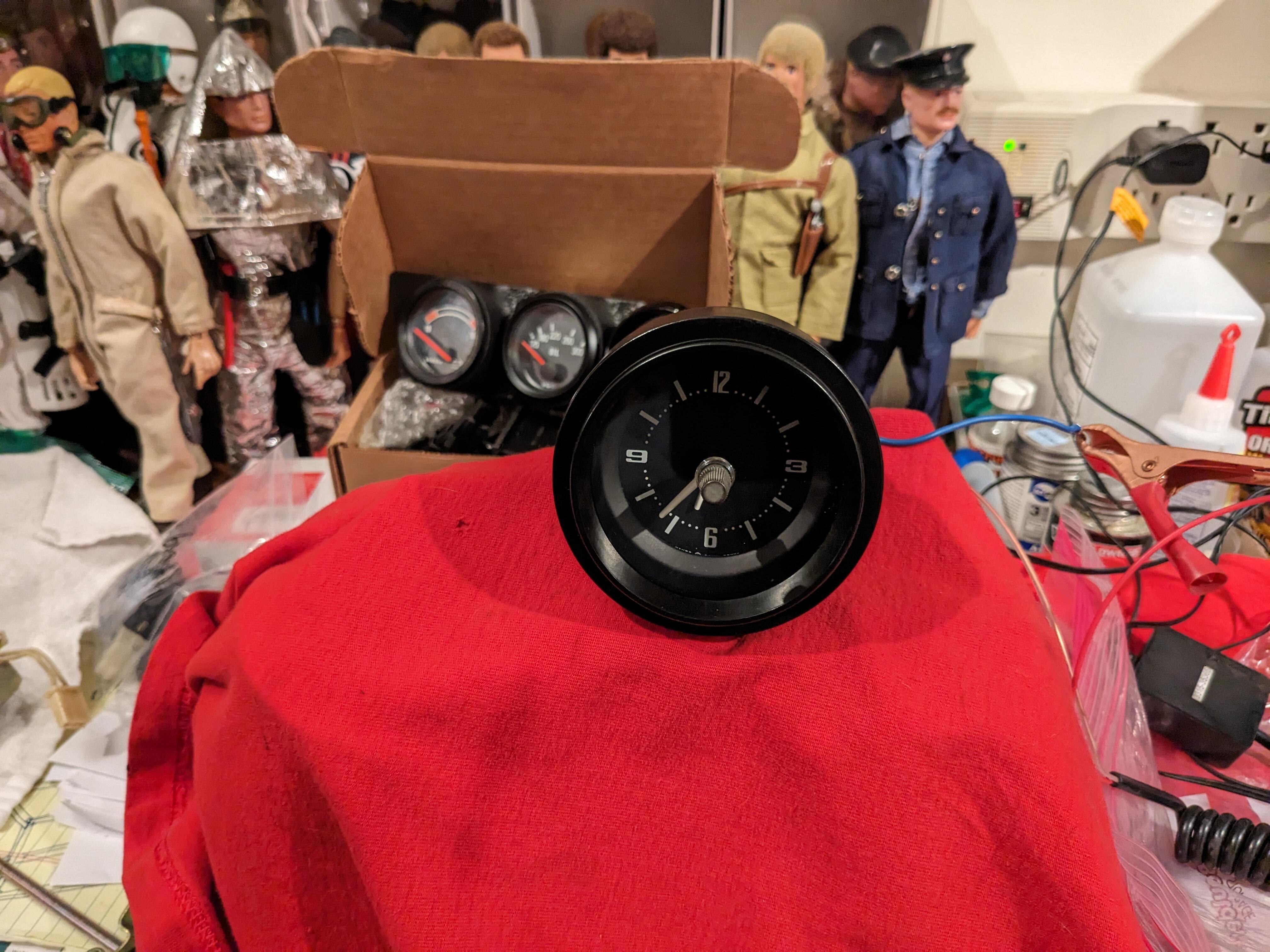

Been raining all weekend. Since I can't work outside, I got back on the clock repair.

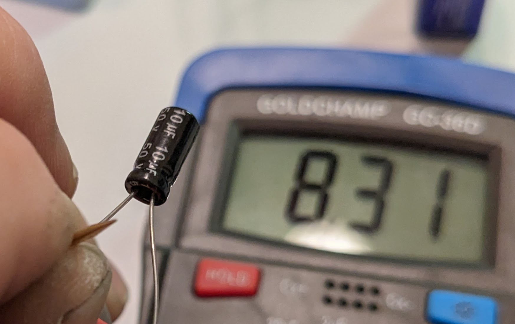

First, I checked some of the remaining caps rated at 10uf. Most of them were 8-8.3uf (!) , others were 10.5 or higher. The .22uf caps were all under 2.1, most were .2 or below.
I removed the .22uf (read as .20) and one of the 10uf (read at 10.45) from the circuit board. The other 10uf read at 10.3, which was closer than most.

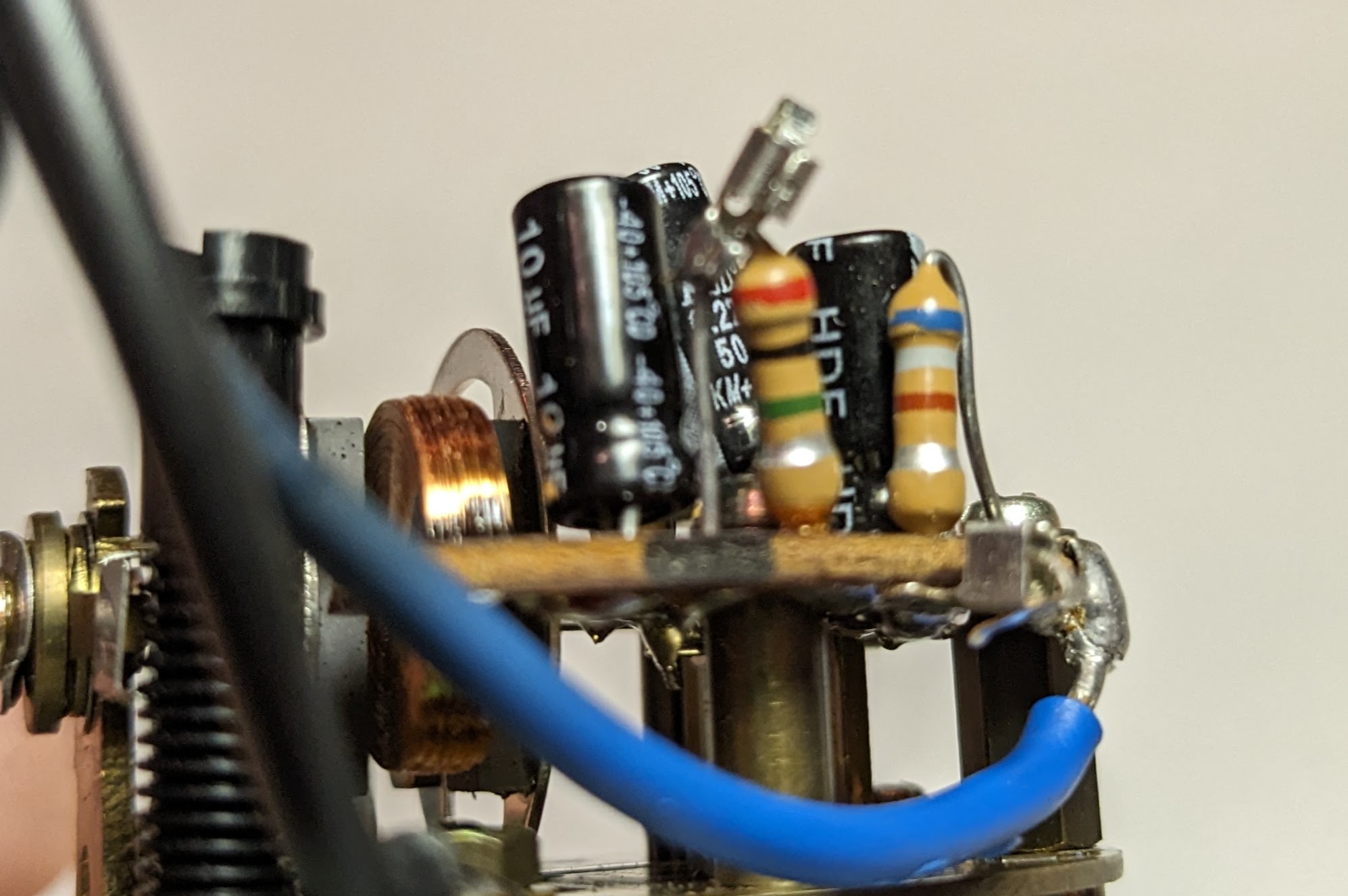

I found one .215uf and one 10.1uf cap, so I installed them.I also added 2 sockets (not in focus, sorry) to allow me to plug in various resistors if needed to adjust the resistance of the 2M resistor
Turns out, I didn't need that - with the replaced caps, the wheel was triggered & the clock runs. It's been keeping time since 2pm, so I'm hopeful that's that.

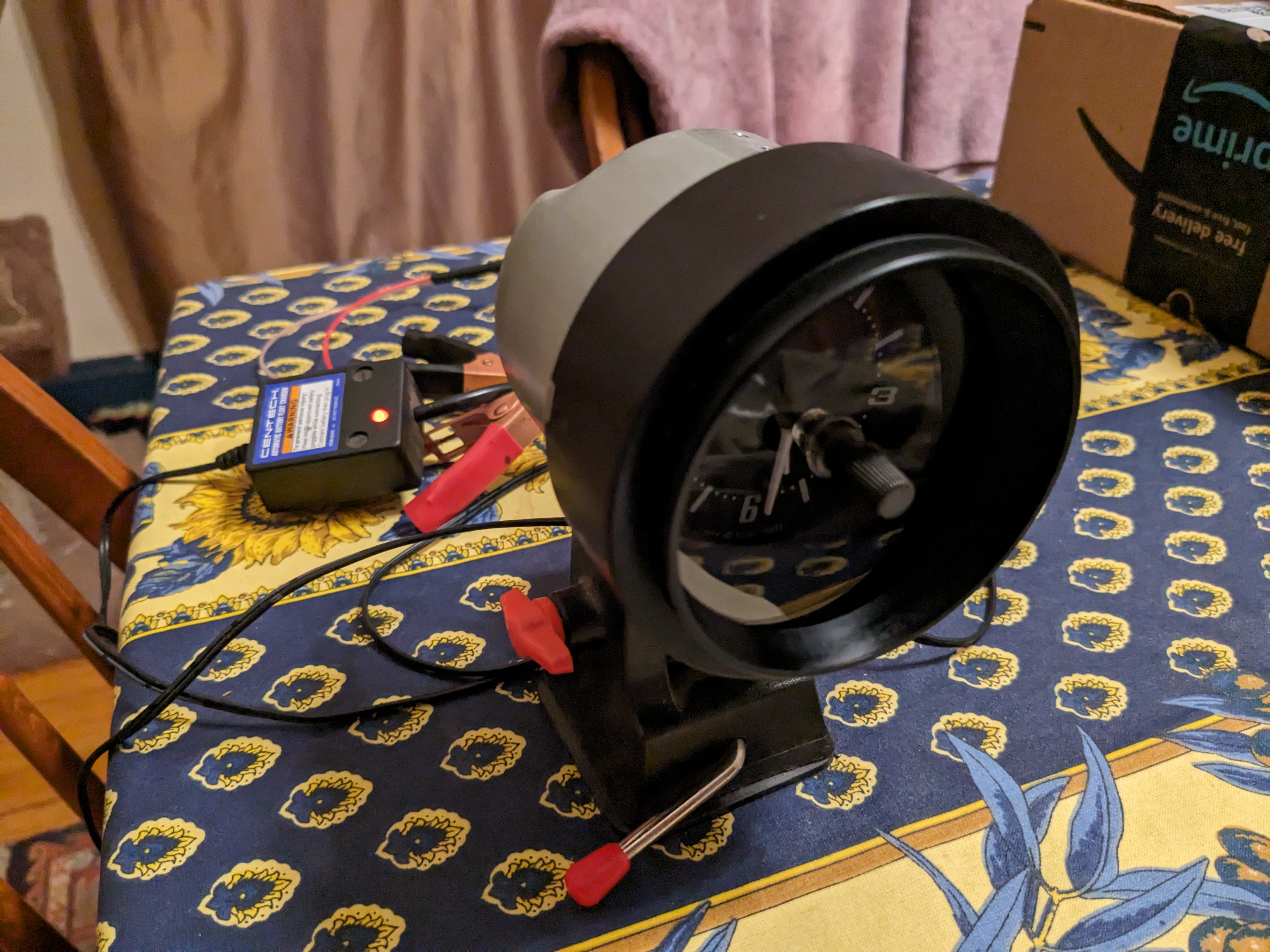

So, I have the clock sitting on a shelf running. It loses about 5min over 48 hours. There is an speed adjustment marked S & F.
Question is, doesn't that mean rotate toward S to slow it down, and toward F to speed it up,
or vice-versa?
