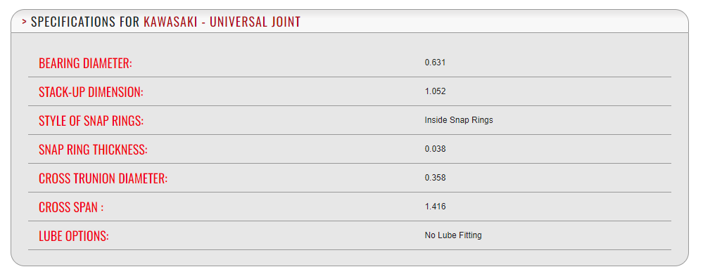

August 30, 20231 yr Author comment_656510 First the early 16mm x 40mm style with C clips Previously I could find them using the ATV700 part number. These come from this specific Kawasaki ATV Kawasaki Bayou 300 front driveshaft u-joint set 1989 - 2004 Kawasaki OEM part number : 49050-1055 Once I knew this I was able to google that part number and found plenty of suppliers BTW, this is all confirmed through a local Kawasaki ATV store here in Calgary. He can get them for $37.99 CAD each. Ebay has them too. As does Amazon.ca, $46 each, 4 day delivery They mention the model # of the ATV, KLF300C They also mention it fits "Mule 2510 4x4 1993 - 1999" Ebay mentions there manufacturer is East Lake Axle and their part number is U201.02 And the really cool thing? All these U-joints have zerks..... And some specs from http://motormasterpowersports.com/index.php/product/detail/sku/ATV700 On the generic ATV700 part Edited August 30, 20231 yr by zKars Link to comment https://www.classiczcars.com/forums/topic/68533-steering-u-joint-compilation-thread-sourcing-and-part-numbers/#findComment-656510 Share on other sites More sharing options...

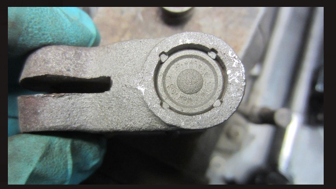

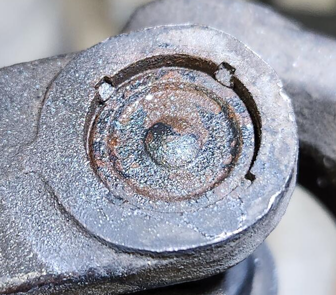

August 30, 20231 yr Author comment_656511 Now for the later PITA ujoints, 15 x 39 ujoint for staked yokes. A thread where these were discussed with a part number https://www.driveshaftparts.com/index.php?route=product/product&product_id=1100 Part Number: UJ1540SD They indicate they are out of stock as of today. They indicate a length of 1.535 which converts to just under 39mm, even though the part number suggests they are 40mm (1540SD) I have a pair of these in my hand, confirm part number and fitment. Link to comment https://www.classiczcars.com/forums/topic/68533-steering-u-joint-compilation-thread-sourcing-and-part-numbers/#findComment-656511 Share on other sites More sharing options...
