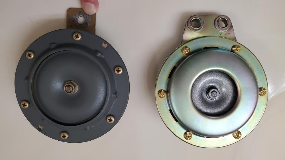

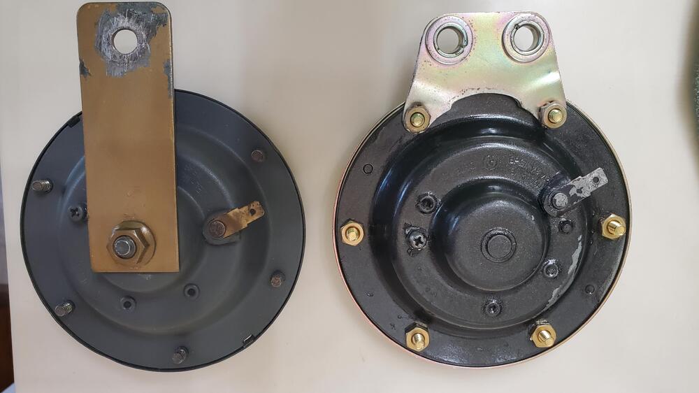

September 10, 20231 yr comment_656895 Reading this thread and it inspired me to work on my horns. I have a pair nicely plated that was going in the car when I noticed the older ones were a different style. Did a quick search but didn't really see anything leading to the difference. I'm hoping the plated ones are appropriate for the 6/71 and was wondering what the right color was for the inner front and back non plated sections. I'm assuming the plated pair is right since the frame has two holes for mounting. The PO used this straight metallic plate and single mount point. Link to comment https://www.classiczcars.com/forums/topic/68542-resurrecting-my-horn-the-sans-viagra-thread/#findComment-656895 Share on other sites More sharing options...
September 10, 20231 yr comment_656897 Yes the plated version is the 240Z version. The other one is a 280Z. I think there are 3 basic models of the S30 horns and probably more finer differences in the 3. The left horn in you photo is the later 280Z version. The single metal strip bolts to the bumper shock. The right horn is from the 240Z. There is also a variant on the 240Z version, I think it came in the 260Z and maybe the later 240Z. The have the same mounting bolt pattern as the 240Z, but the bracket connects to a single bolt on the back of the horn like the 280Z. See photo. Edited September 10, 20231 yr by EuroDat Link to comment https://www.classiczcars.com/forums/topic/68542-resurrecting-my-horn-the-sans-viagra-thread/#findComment-656897 Share on other sites More sharing options...
September 10, 20231 yr comment_656900 I think the gold plated "ring" on the front is actually supposed to be kind of an olive green. That being said, mine are like yours. BTW SteveJ has mine "tooting"...! Awesome...! Link to comment https://www.classiczcars.com/forums/topic/68542-resurrecting-my-horn-the-sans-viagra-thread/#findComment-656900 Share on other sites More sharing options...
September 10, 20231 yr comment_656901 On 9/10/2023 at 7:56 PM, EuroDat said: Yes the plated version is the 240Z version. The other one is a 280Z. I think there are 3 basic models of the S30 horns and probably more finer differences in the 3. The left horn in you photo is the later 280Z version. The single metal strip bolts to the bumper shock. The right horn is from the 240Z. Thanks so much Euro! Appreciate the guidance. Link to comment https://www.classiczcars.com/forums/topic/68542-resurrecting-my-horn-the-sans-viagra-thread/#findComment-656901 Share on other sites More sharing options...
