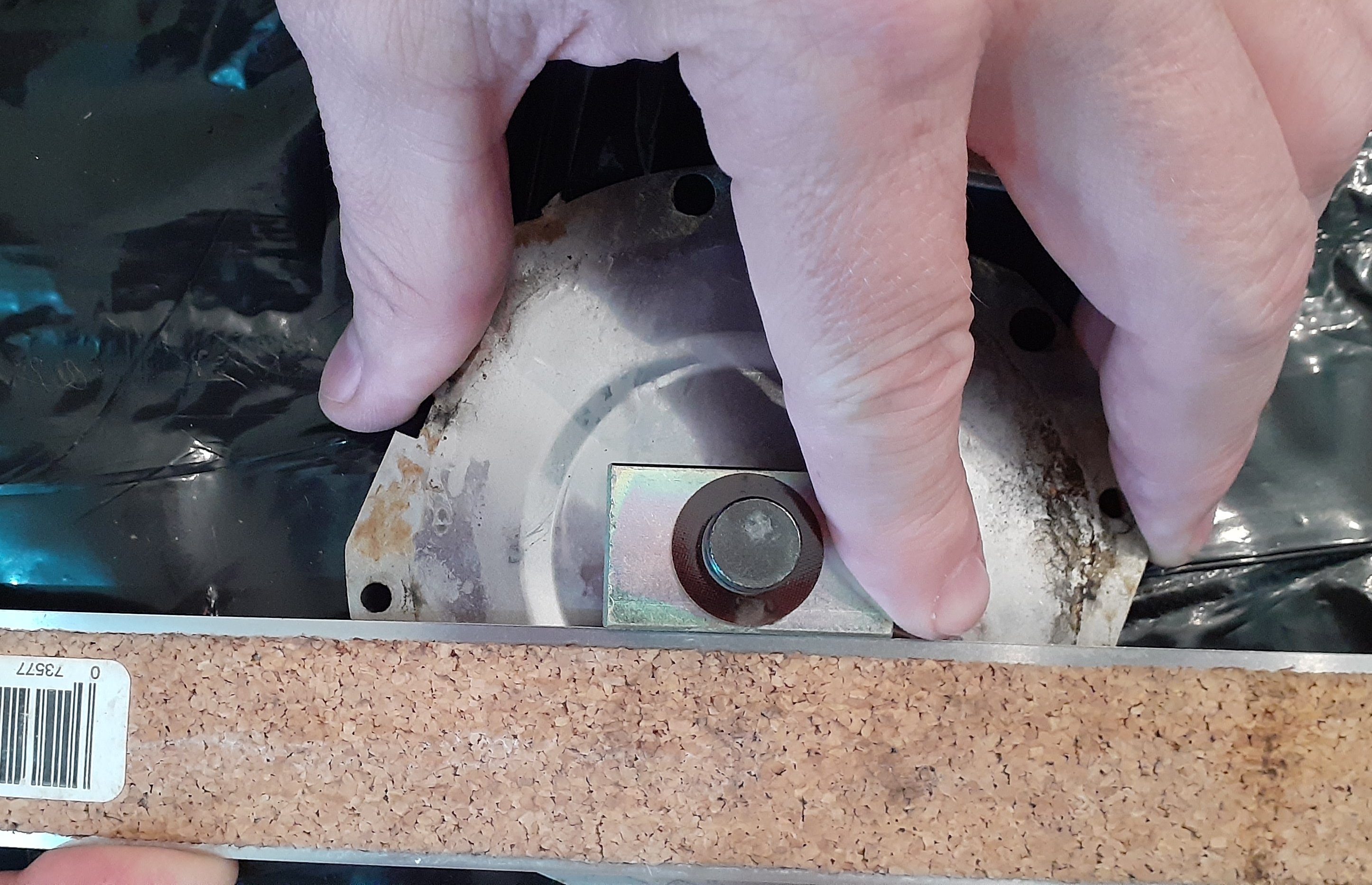

For #3, I took a straight edge and held it against the side of the bar. There are two alignment holes on the diaphragm, and I noted the distance between the straight edge and the hole. It's between 1 and 2 mm. If the bar on the horn you're working on doesn't line up that close, loosen the M6 nut and rotate the bar. Hold it in place carefully while locking now the nut.

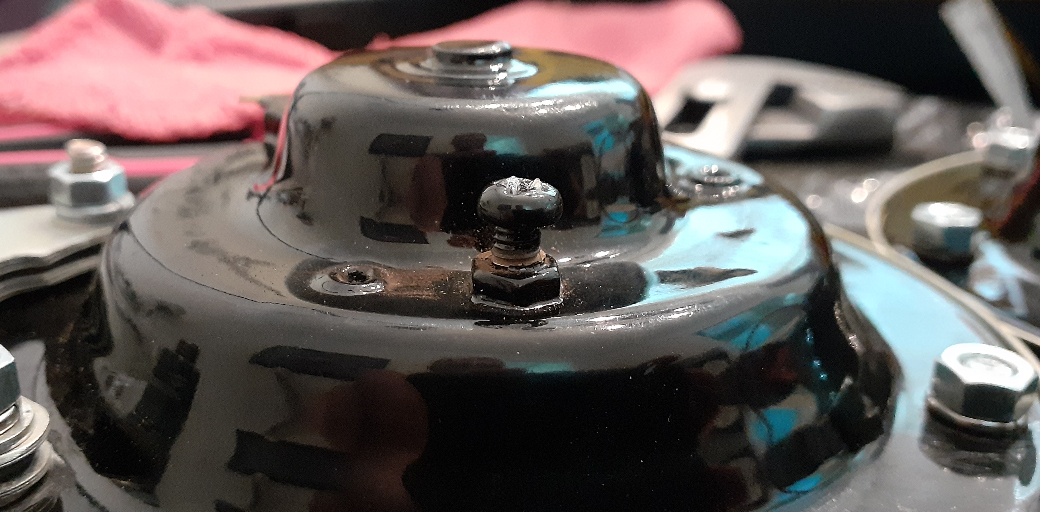

After adjusting the internals, put the horn back together. Measure resistance from the positive tab to the mounting bracket of the horn. If it's more than 20 Ohms, the tone screw is turned in too much. The tone screw is an M4 screw on the back of the horn. The screw in the photo below was powder coated onto the horn, and I had to break it loose. I got the resistance from being over 1 MOhm to around 2 ohms.
After that I used a car battery to test the horn and get a better tone. I had to work the screw in and out a few times until I was happy with the results.

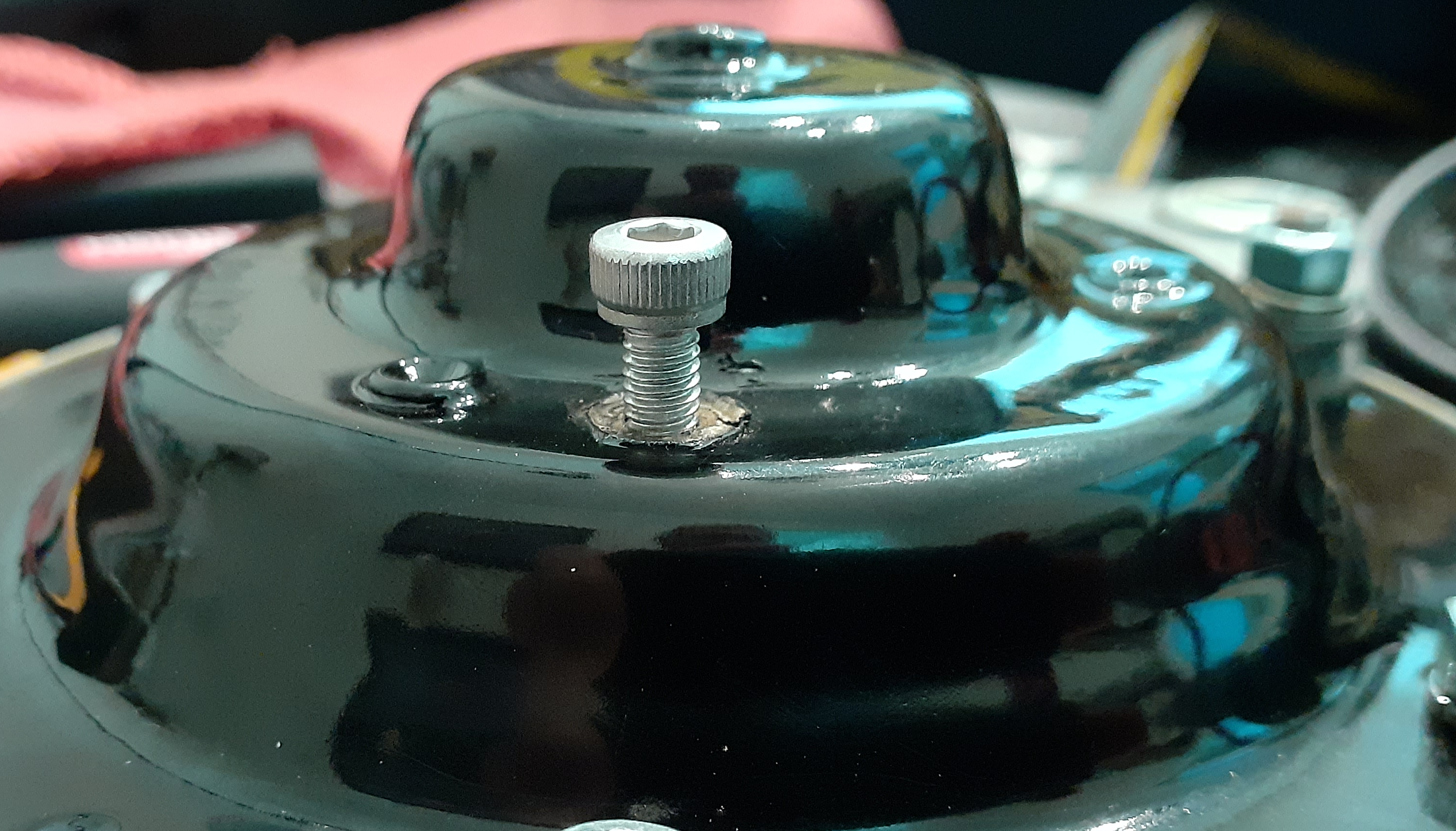

 The other horn was a little more challenging. When I tried to break the screw loose, the screwdriver chewed up the head. I had to replace it with the only screws I had available, allen head screws.
After playing around with the height of the screw, I finally got a decent volume out of it.

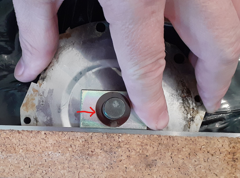

So last night I wanted to see if I could improve the sound from the horns @Tirnipgreen asked me to work on. One was nice and strong. I wasn't going to mess with success. The other wasn't working, though it worked before. I could tell it was pulling in the diaphragm, but the contacts weren't opening. This was verified by taking current measurements on that horn and one that worked. The non-working horn was pulling a lot more current. I tweaked on the parts repeatedly, but I couldn't figure out why that one horn would not work.
Finally out of frustration, I took the other horn apart to compare the diaphragms. The problem then stuck out like a sore thumb. Whoever reassembled the diaphragm on the horns didn't put the parts back together in the right order on the non-working horn. The fiber washer was on the wrong side of the bar between the diaphragm and the bar. This is how is should be.
So when the diaphragm tried to open the contacts, it was still providing a path to ground for the coil. With the coil still energized, the diaphragm wasn't moving. Once the diaphragm was assembled properly, the horn worked just fine.
