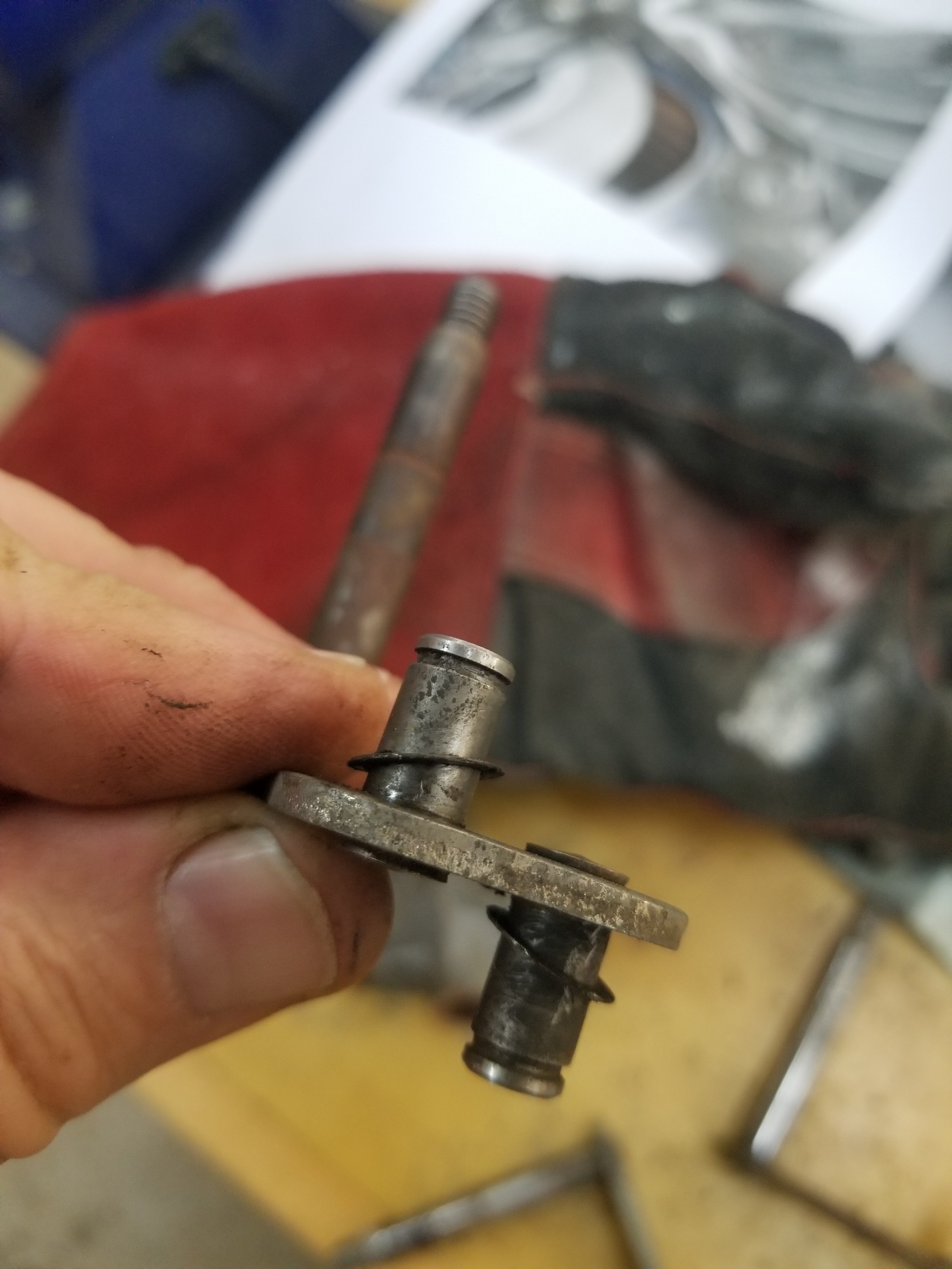

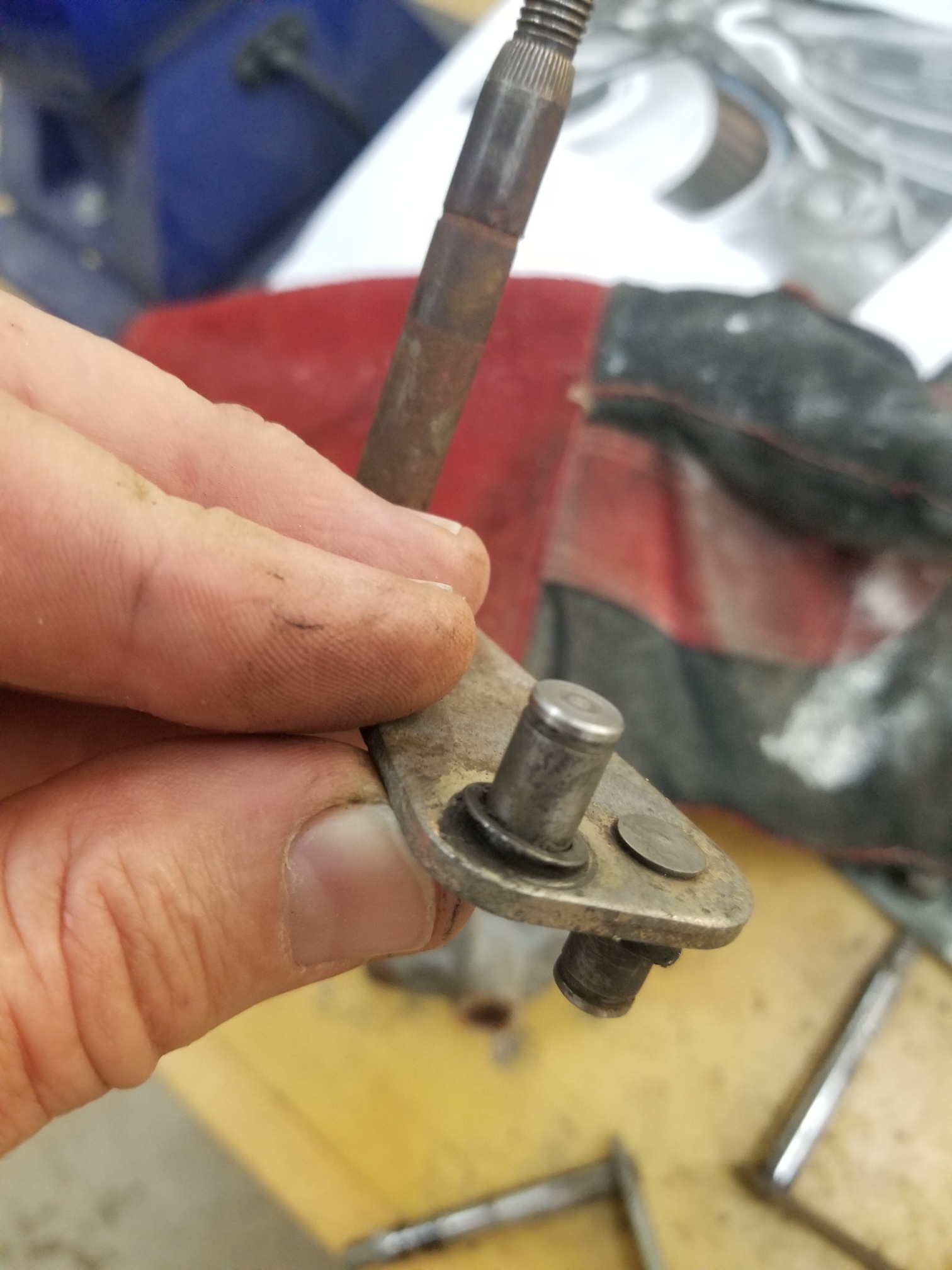

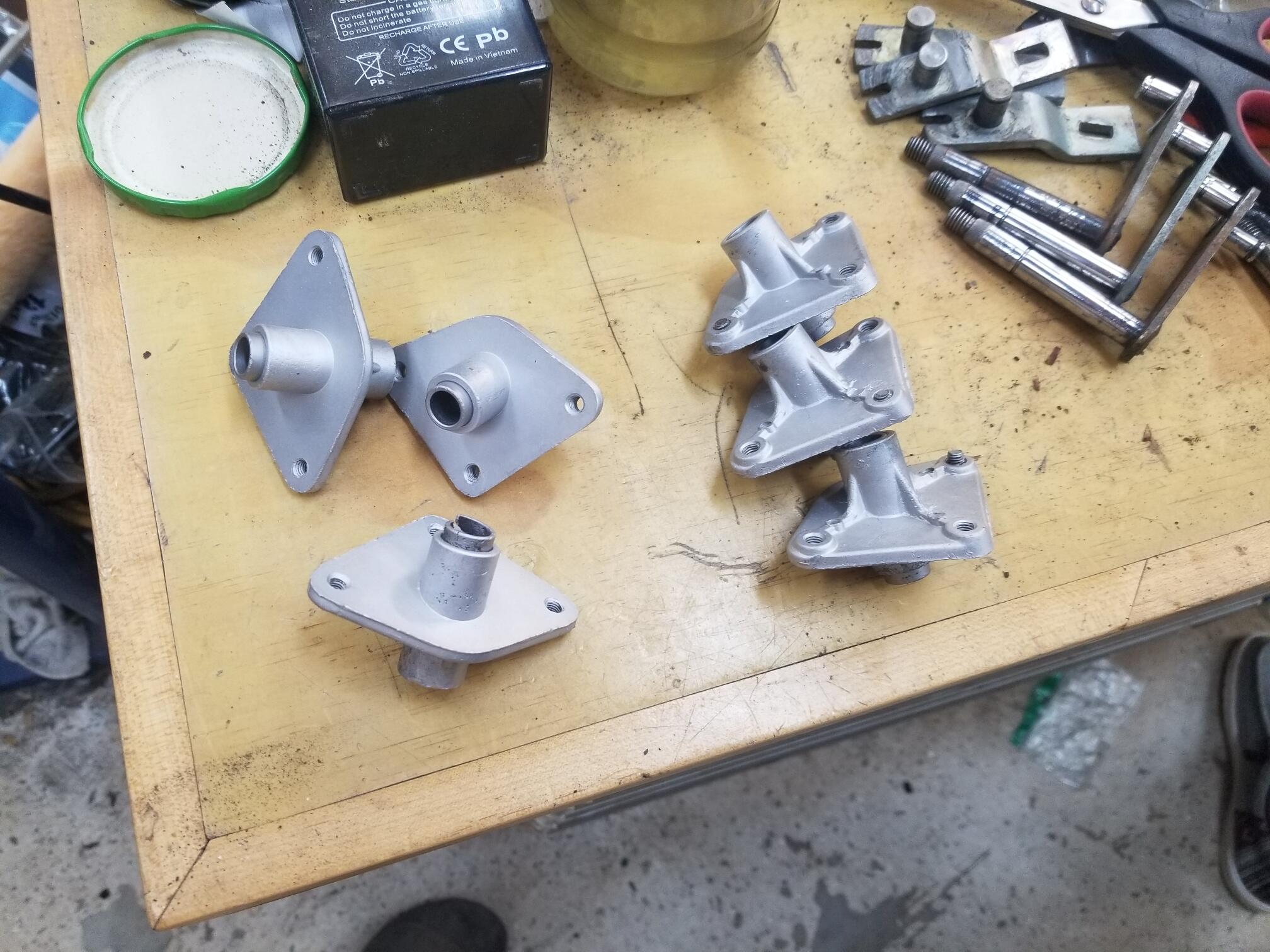

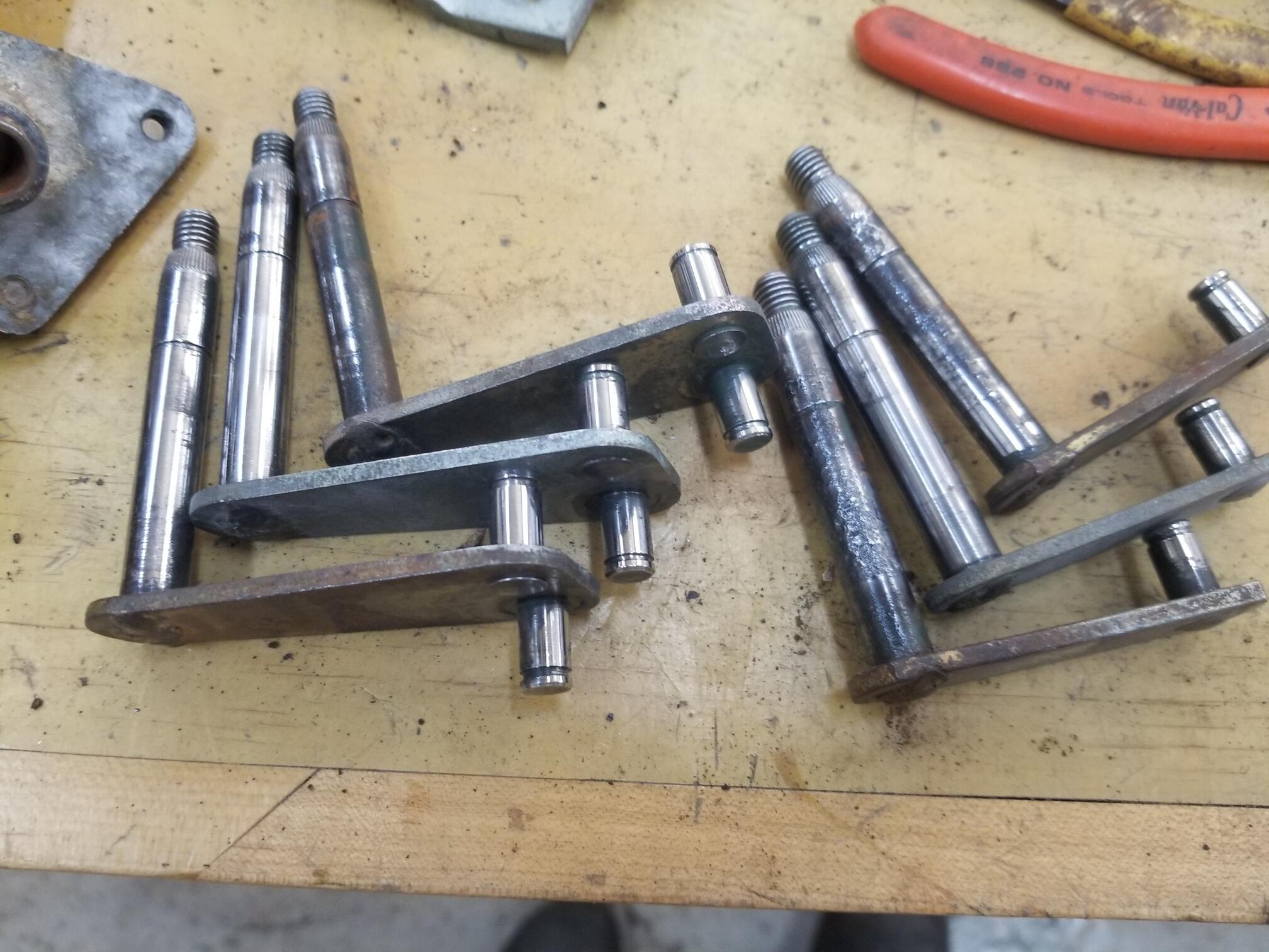

September 15, 20231 yr Author comment_657018 Polished the pivots some today and bead blasted the wiper pivots I noticed a thin hard washer on all the short pivots. Very hard to see and I had to use a knife to separate them from the pivots. Three of these pivots have a broken bolt in them Link to comment https://www.classiczcars.com/forums/topic/68548-wiper-rebuild/?&page=2#findComment-657018 Share on other sites More sharing options...
September 15, 20231 yr comment_657033 On 9/15/2023 at 12:43 AM, Patcon said: Three of these pivots have a broken bolt in them Bring them down here. We can drill, heat and extract. Link to comment https://www.classiczcars.com/forums/topic/68548-wiper-rebuild/?&page=2#findComment-657033 Share on other sites More sharing options...

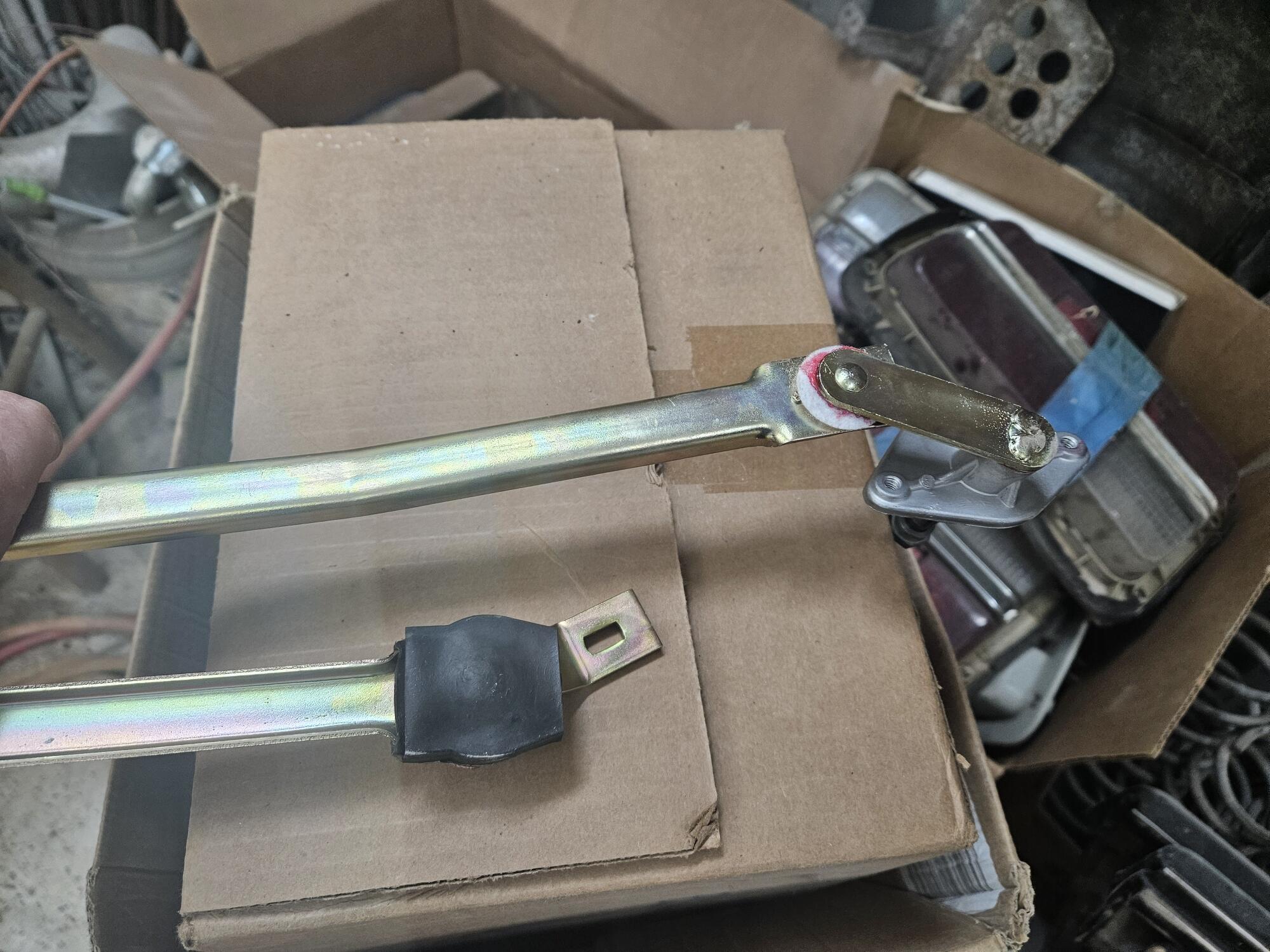

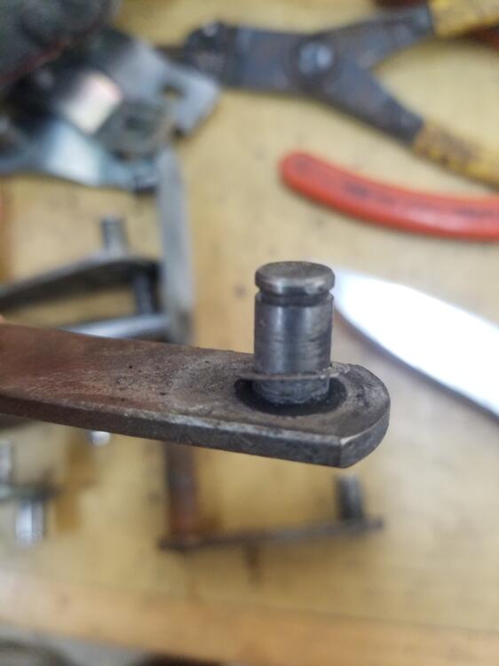

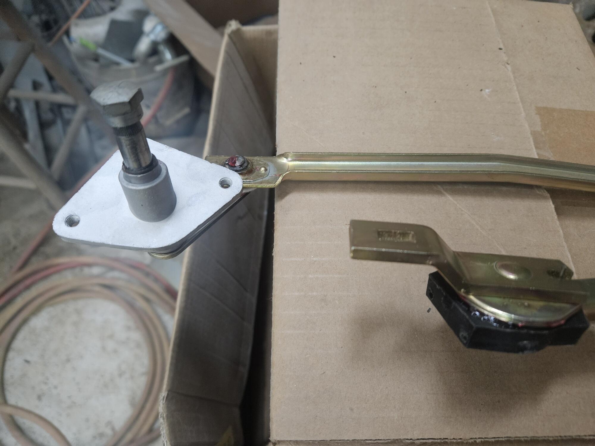

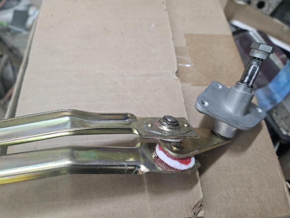

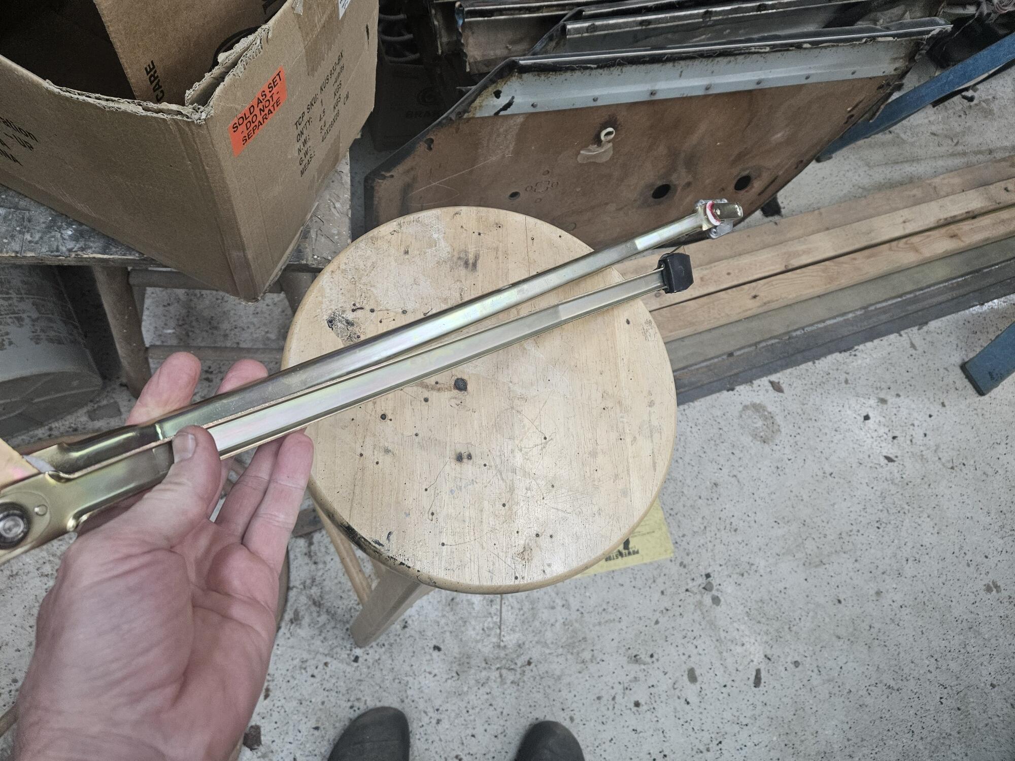

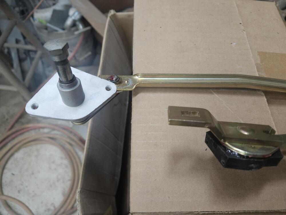

February 18, 20241 yr Author Popular Post comment_662163 I got back the plating a few months ago and assembled 3 separate wiper transmission today. One is really good, one is ok and one is serviceable but not great. I bought a box of little felts from Amazon that somebody had linked too. I didn't enlarge the ID like what came off. I figured that would happen on it's own if needed. I also bought an assortment of: Metric 15-Sizes Round Wire C-Clips External Retaining Rings Assortment Kit;Round Wire Snap Rings for Shaft(Black 5mm-28mm) I used the 10mm ones on the worst transmission but the factory rings are almost 1mm wire and the replacements are much thinner. I someone needs to source some, I would look for 10mm Dia with a 1mm wire size. Assembly was the reverse of disassembly so I didn't document that. I did grease up the ends pretty well and used new rubber from 240zrubberparts.com Link to comment https://www.classiczcars.com/forums/topic/68548-wiper-rebuild/?&page=2#findComment-662163 Share on other sites More sharing options...

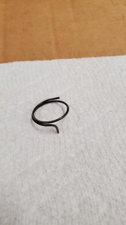

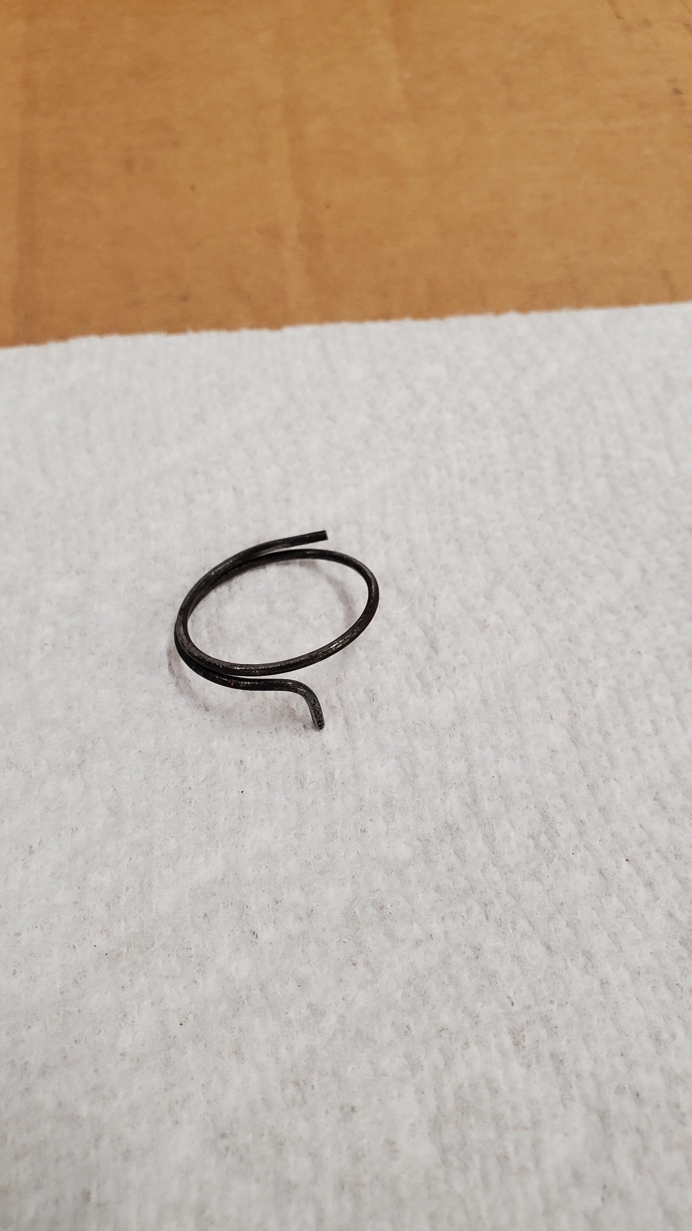

February 18, 20241 yr comment_662176 Charles, the bell crank joint with the black rubber cover, what did you do for that flat spring that is always broken? Link to comment https://www.classiczcars.com/forums/topic/68548-wiper-rebuild/?&page=2#findComment-662176 Share on other sites More sharing options...
February 18, 20241 yr Author comment_662177 On 2/18/2024 at 12:25 PM, grannyknot said: Charles, the bell crank joint with the black rubber cover, what did you do for that flat spring that is always broken? I'm not sure mine was broken. One of them was missing the 90 degree leg and I rebent one on there. The other ends on mine just stop at the end of the last coil. Link to comment https://www.classiczcars.com/forums/topic/68548-wiper-rebuild/?&page=2#findComment-662177 Share on other sites More sharing options...
February 18, 20241 yr Author comment_662178 On 2/18/2024 at 11:18 AM, Namerow said: You might find this thread from back in 2017 to be of interest... Now you tell me after I reassemble all three. 😁 Link to comment https://www.classiczcars.com/forums/topic/68548-wiper-rebuild/?&page=2#findComment-662178 Share on other sites More sharing options...
February 18, 20241 yr Author comment_662179 I believe that little spring is supposed to index in the slot at the end of the wiper motor arm and the millennium falcon. That is the it was on my better transmission Link to comment https://www.classiczcars.com/forums/topic/68548-wiper-rebuild/?&page=2#findComment-662179 Share on other sites More sharing options...
February 18, 20241 yr comment_662181 On 2/18/2024 at 4:31 PM, Patcon said: I believe that little spring is supposed to index in the slot at the end of the wiper motor arm and the millennium falcon. That is the it was on my better transmission Yes from my previous research it was part of the "parking mechanism" to put the blades back into the park position when turned off. I had the 90 part missing as well, turned it up at the end and reinstalled without an issue. Parks as it should no problems. Because of the missing 90 it ends up a little short of full revolution but seems to work just as well. Link to comment https://www.classiczcars.com/forums/topic/68548-wiper-rebuild/?&page=2#findComment-662181 Share on other sites More sharing options...
February 18, 20241 yr comment_662185 I've taken apart more than a few and they are always broken, twisted or broken and twisted, you got lucky or I'm unlucky. Link to comment https://www.classiczcars.com/forums/topic/68548-wiper-rebuild/?&page=2#findComment-662185 Share on other sites More sharing options...
