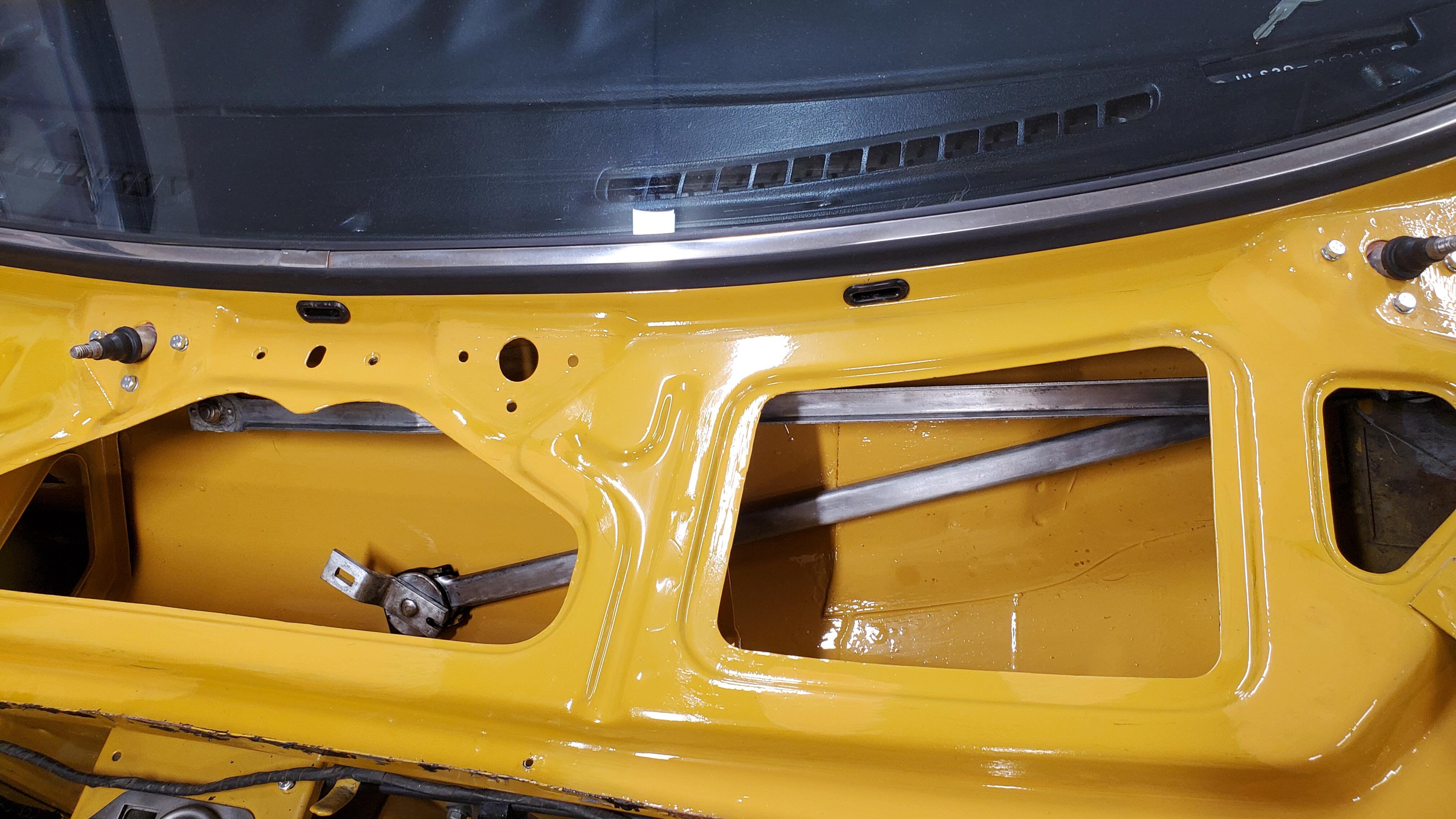

it sounds like maybe you put it back together not exactly as it came apart.  Did you take lots of pictures to see the orientation of arms and order of pivot and end assembly?  Can you move the arms at all by hand when disconnected from the motor?  If its all connected in proper order they should easily wipe by moving the pivot arm that would be connected to the motor.  They should move freely, there's nothing to prevent that once disconnected from the motor.

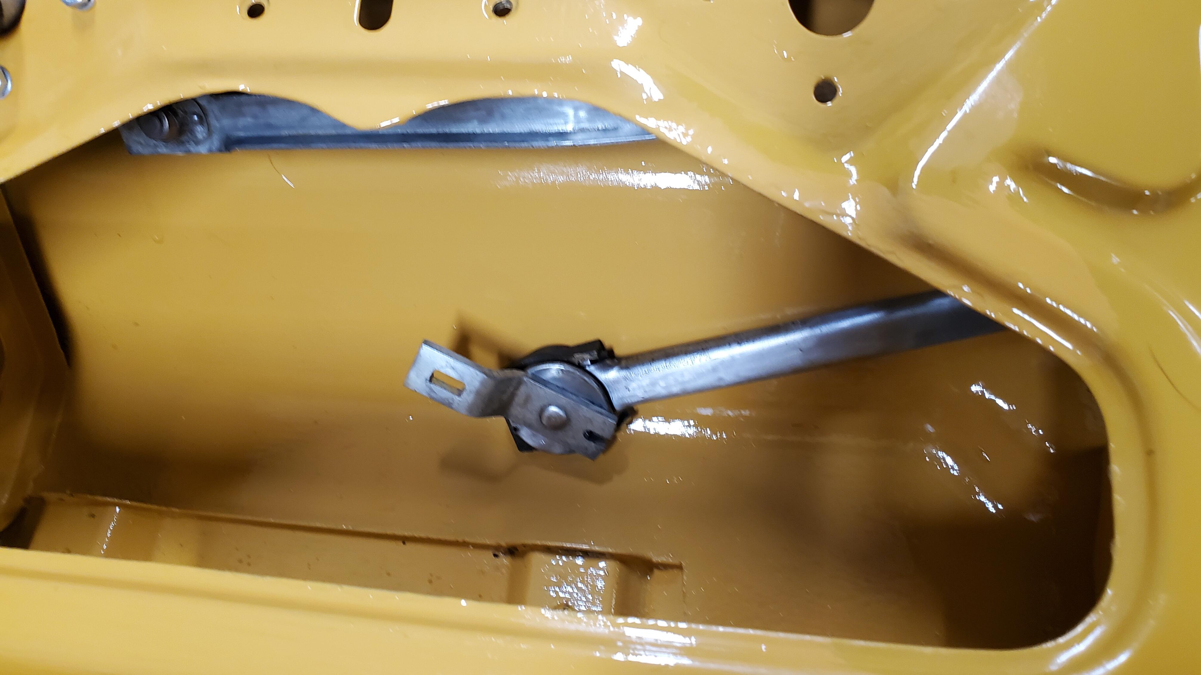

Heres a pic of what they should look like and the orientation without the motor

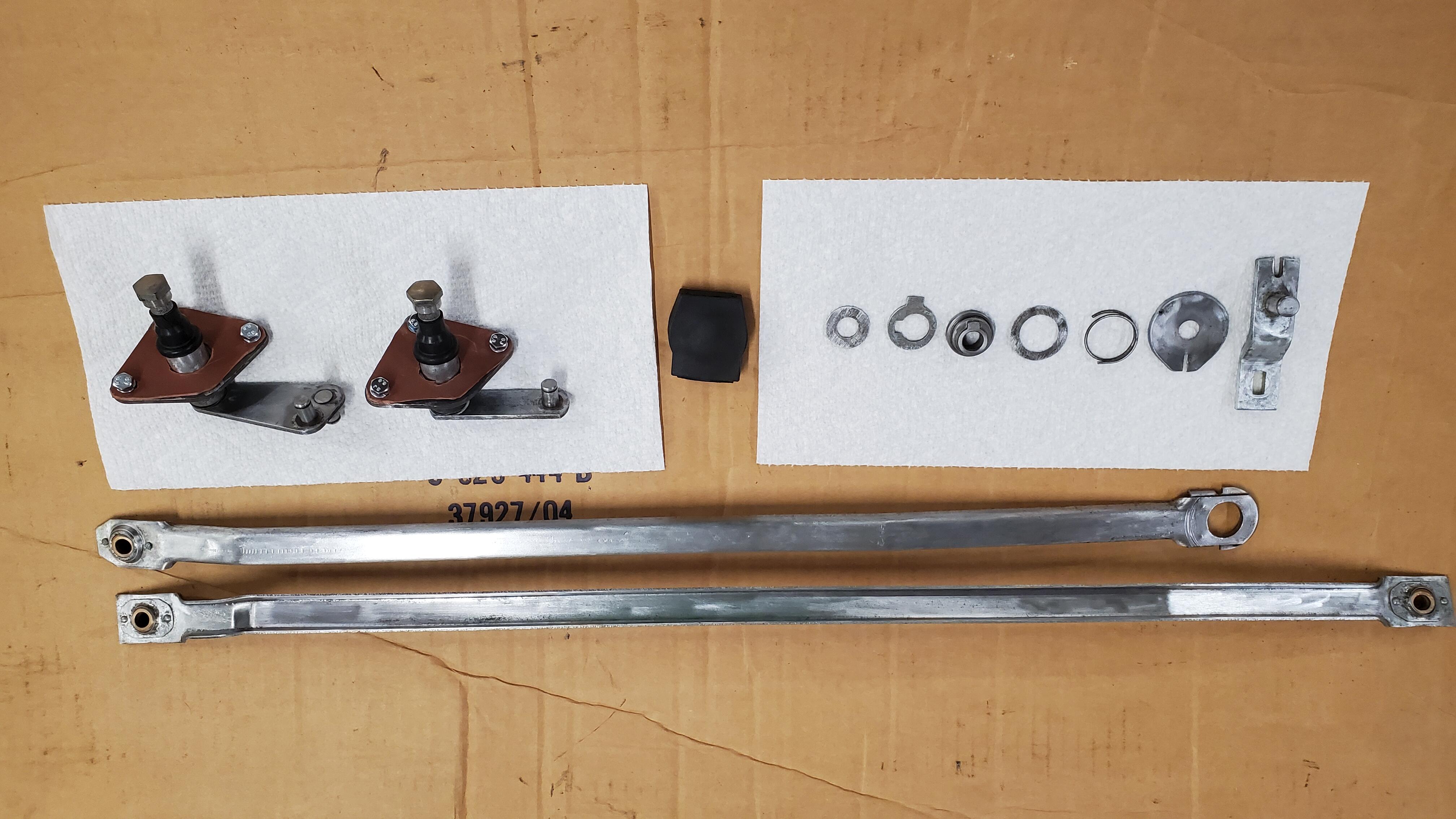

Heres the full parts from the linkage and motor arm
heres a shot of the closeup arm to the motor
I dont recall there being anything more than a nut and lock washer / flat washer to the motor conenction
After taking a second look at the closeup picture, I realized that the positioning of the passenger side linkage going to the pivot was wrong. I installed the linkage on the outboard side of the pivot, not the inboard side per the picture. Common sense should have told me that it was oriented wrong, but a picture is worth a thousand words. Once corrected, the wipers work like new. Thanks again for the pics, Richie, I'll be sure and take more before I tear anything else apart.
