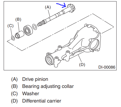

I removed the side flanges, then the one ring gear bolt, so the carrier would come out of the case, and then pressed out the pinion shaft.  Rather than removing this bearing (the one in the pic) from the pinion shaft to get access to the washer/spacer (blue arrow) which is sandwiched between the bearing and the gear, I was able to user vernier calipers to measure the washer/spacer thickness.

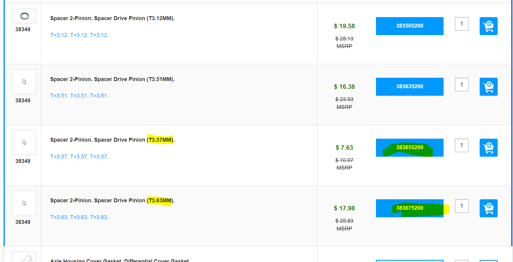

My measurement was about 0.141", (between 140 and 141 thousandths, really).  Converting to mm, 0.141" is 3.5814 mm.  Looking at what is available on a Subaru website, I found these part numbers:
Since my measurement is nearly the same as the 383655200 spacer, it would appear that I only have one spacer which is thicker as an option available. 3.57 mm is equal to 0.1405".  3.63 mm is equal to 0.1429".  So, order that one, swap it out, reassemble, and recheck gear lash?

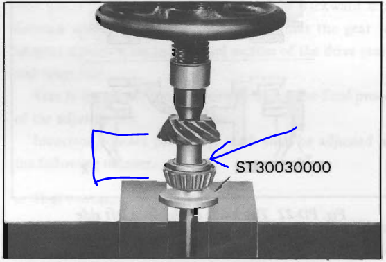

My thought is to use the existing shim I have, plus another shim or shims made from this shim material.  I would put the new shim under the existing one to change the location of the pinion gear height in the case.  For example, I would make a .003" shim from the new shim material, and then place it here on the pinion assembly:
Hmmm. I'd be reluctant to use that Amazon shim material in this application. I think I'd want a hardened washer in that application.
How high do you torque the nut on the end of the pinion gear? I'm worried that you would ooze a low carbon shim at high torque. Is the original spacer shim hardened? Does a file cut it easy, or just skate off the surface?
But you could certainly use that shim material as proof of concept. You could cut that thin stuff (.003) with scissors for the OD. Easy peasy. The ID you might be able to hack out with a razor knife. I'm thinking that the profile doesn't have to be perfect, just fit over the pinion even if the ID is a little rough.
Cut the shim, put it together and check the backlash. That will at least confirm for sure what thickness shim you really need.
