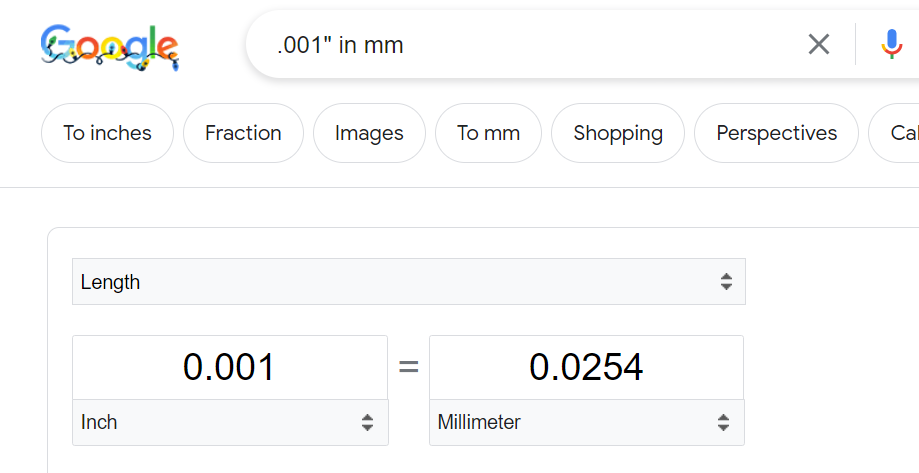

I found a comment from a machinist friend of mine about the metric system to be interesting.  He said that the tolerances typically used for machining (thousandths of an inch) did not have a good equivalent in the metric system.
Consider:
So, when working with tolerances of thousandths or "tenths" (.0001") for machined parts, how well does the metric system work?
Your machinist's comment about tolerances might explain why when I tinker around at a machine shop at the university, I'm forced to convert all my projects to inches from metric.
