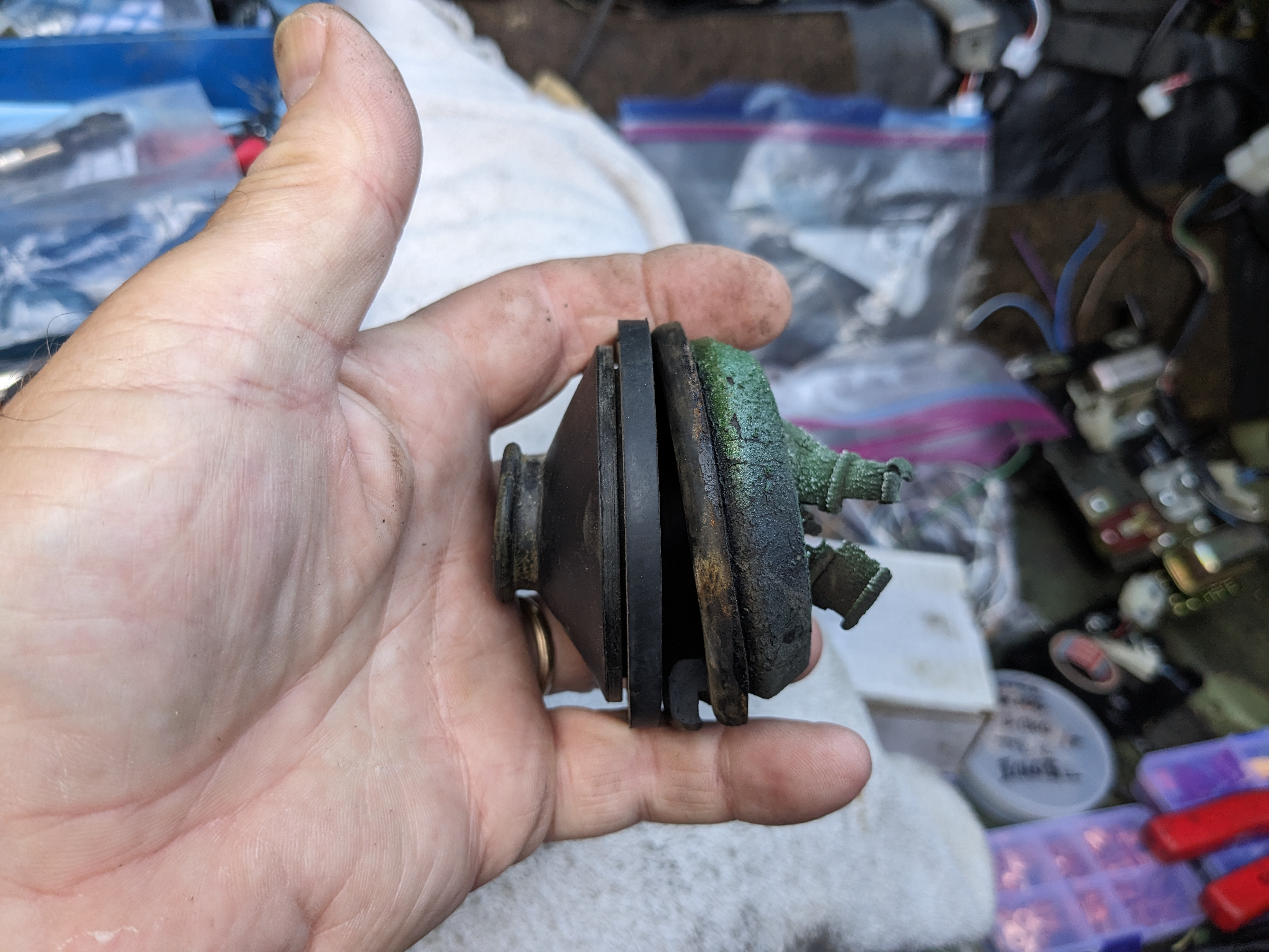

In the firewall that is. I am trying to source a grommet for my turbo harness. Went the the JY today, got something that may work, most were too large as I think it is a 2.5" hole in the fire wall based on some rather poor measurements taken with the plug installed and me on my back in the foot well....
I saw some old threads IIRC there was a 2.5" hole mentioned.
My follow up will be do you push the connectors intact thru the opening one at a time (seems like some of them would be too large), does the grommet stretch that much? if it does do you go with put the passenger side connectors thru the hole or the engine compartment connectors? The turbo may hava a slight advantage on the passenger side connectors since they are broken up into smaller chunks that the single 35 pin connector used on the NA engines.

well decided to try my JY find, a literal pick up off the ground, anyway I was able to open up the inside to a nice fit with a step drill (rubber was pretty hard, but it worked ok). then used a saw to open up so I could just fit around the harness without all the drama of trying to fit stuff thru. This will probably work to my advantage on the sizing as well since it seemed just a bit to large for the 2.5 hole, so the kerf should bring it down some. I can widen the kerf if needed. I can always glue it back up with the kerf pointed downward on the final install. There are some rubberized super glues that work well to glue it shut after test fitting. a little silicone and some harness tape should make for a fine water proof seal.

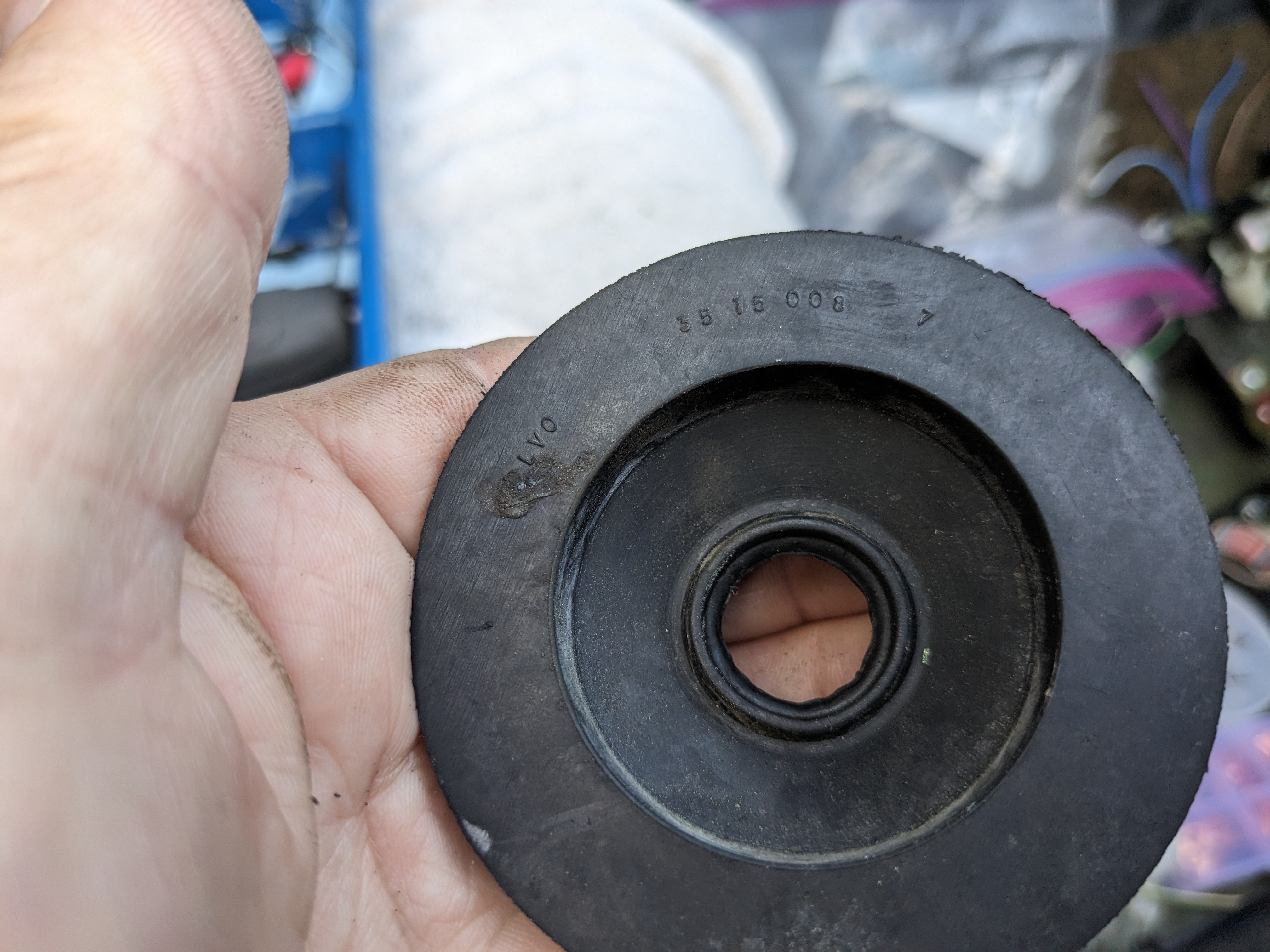

I cut mine out, after checking that the hole was 2.5" - The Volvo one measured @ 2.4" in the lip, and the original appeared to be the same, but... once cut the new one is floppy in the hole 😞
VO 3515008
I'll have to order a proper one
