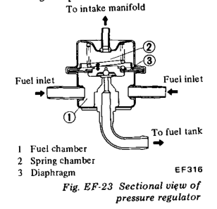

Fuel pressure regulators for these cars are getting harder to find.  The '77 and earlier EFI cars use a different design, with two regulated fuel inlets, that remains somewhat available.  But I can't find the single-inlet version for the '78-83 cars anywhere.  I'm looking because I'm considering an aftermarket fuel rail for my '77, which would eliminate the need for the dual-inlet type.  The usual sources I'm familiar with are out of stock for the later FPR.  Some owners have retrofitted aftermarket adjustable FPRs.  But only a couple use vacuum reference like OEM.  Also, most aftermarket FPRs only go down to 3.0 bar (OEM are 2.5 bar).  And they leak down during shutoff, making starting prolonged and aggravating.  I figure you '78 and ZX guys would have seen this sooner, and may have found a fix.  TIA.

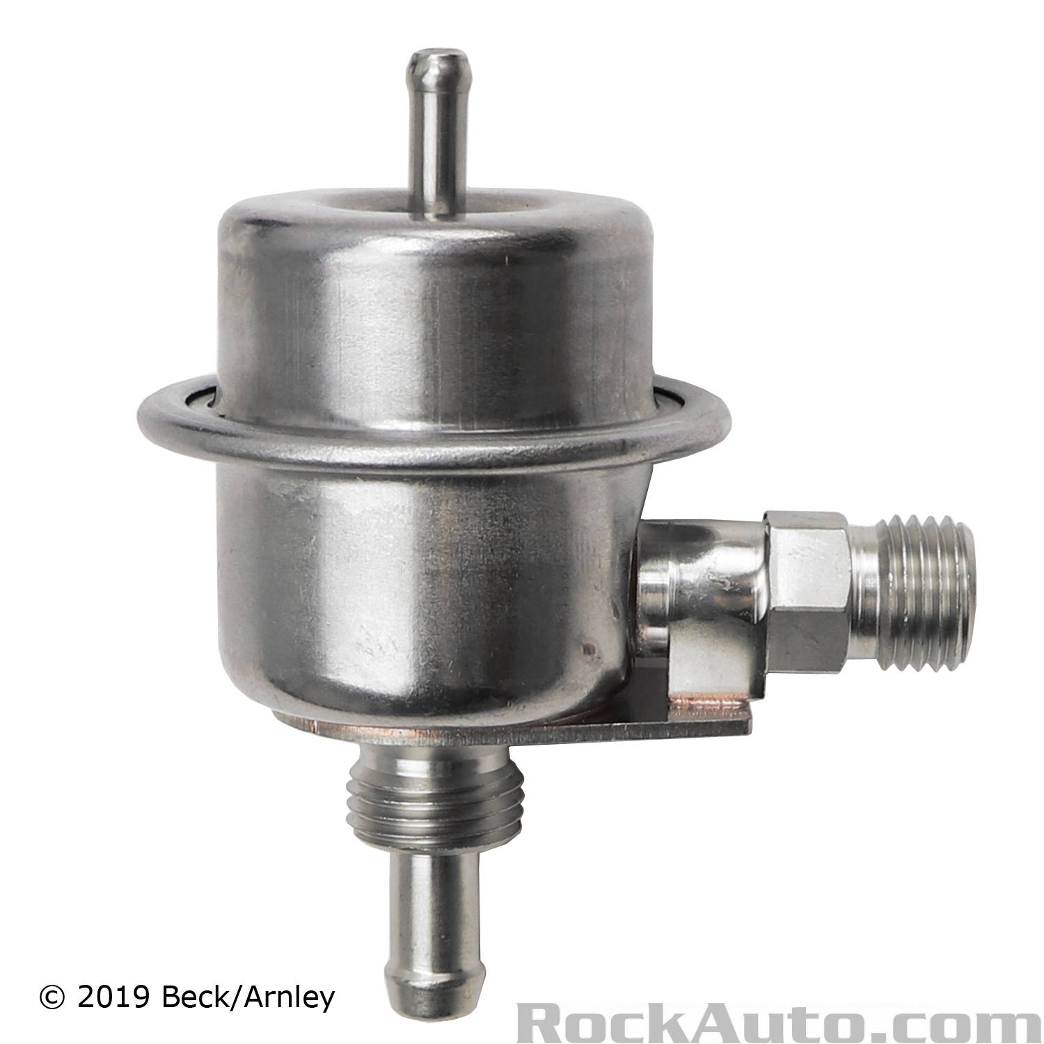

@HusseinHolland had some posts about the same problem.  In the past I had modified an adjustable regulator to be vacuum modulated.  Made me get on to Rockauto and look around.  VW's Super Beetles had 2.5 bar EFI in the seventies.  The FPR's are cheaper than the Nissan versions.  Should be able to make it work.

Thanks Zed Head.  That part number looks promising.  And it seems to be widely available, too.

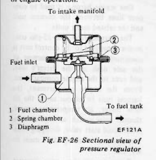

Volvo also used a 2.5bar reg on several models (1983 240 2.3l - about $50 on Rockauto)- one version has a barb return line, but uses a flare fitting for the feed. I don't know what Datsun did on the later 280's. Is it identical to the beetle version?
Here's 78.  The barbs are different but the orientation is about right.  The ZX looks about the same I think the mounting bracket might be slightly different.  I found an eBay FPR that is slightly different.  Says it's for the ZX's.

Here's a 76, for the three piece rail, just to round things out.  A person could insert a T fitting and hang the FPR off of it in a pinch.

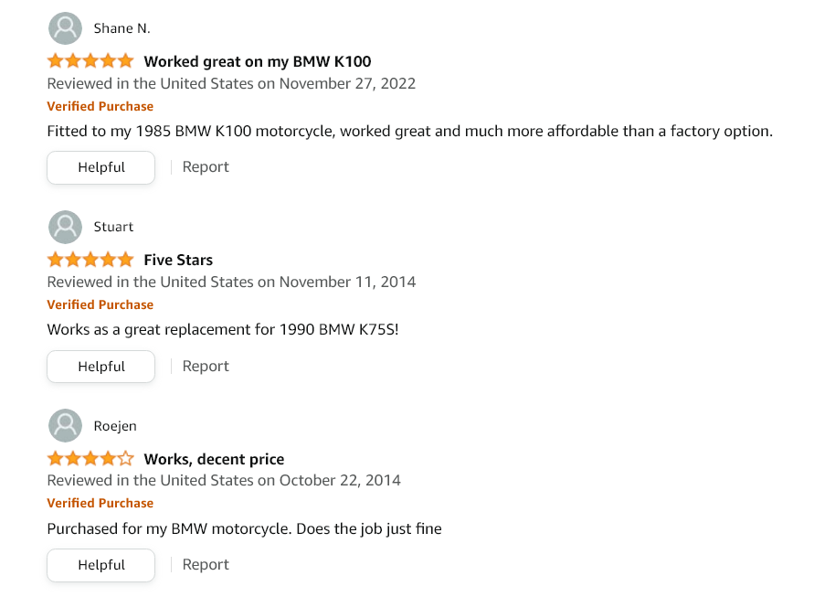

Has anybody ever looked at this Beck/Arnley 158-0073? https://www.amazon.com/Beck-Arnley-158-0073-Injection-Pressure/dp/B000CB03EA
It came up in a search for L-jetronic fuel pressure regulator. I haven't drilled down enough to see if the specs are available.

I was wondering about that one myself.  It turns out the one Zed Head linked on Rock Auto (post #2 above) crosses to that same part number.

The VW part has two flared nipples, for rubber hose and clamps.  The male threads are for fastening to a mounting bracket.  The adjustable Bosch FPR that I had used the same design.  I think that I modified an old broken Nissan FPR and used its bracket to mount the Bosch.
The 37 psi shown as the spec. is almost certainly a typo.  The Beck Arnley piece is in the same list of VW FPR's.  Circling back...
https://www.rockauto.com/en/catalog/volkswagen,1978,super+beetle,1.6l+h4,1423178,fuel+&+air,fuel+injection+pressure+regulator,6124
