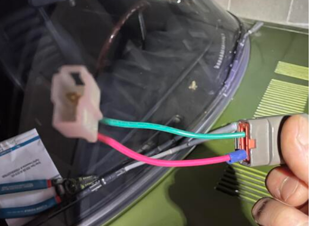

-the red wire from the starter is fused, and leads to a relay at the firewall. didn't trace further yet, can do if relevant. see pics.
-the starter solenoid wire is fully burned through in one spot.
-I am really going off memory, but I believe the 6 pin plastic cap at the voltage regulator location was bought from one of the more prominent Z car retailers, specifically for use with an internally regulated alternator.

Your alternator is connected properly, too. I just verified against my car. However, the crimped lug on the red wire is curious looking. If I can remember, I will make a video to show you how to verify the wiring.

Here's how you should check the voltage. Make sure the 6 pin connector is plugged in.
  1. Unplug the connector from the alternator. Measure voltage to ground at the red wire and green wire. The red wire should have battery voltage. The green wire should not.
  2. If the first test passes, put the key in ON. Measure voltage to ground at both wires again. This time both should have battery voltage.

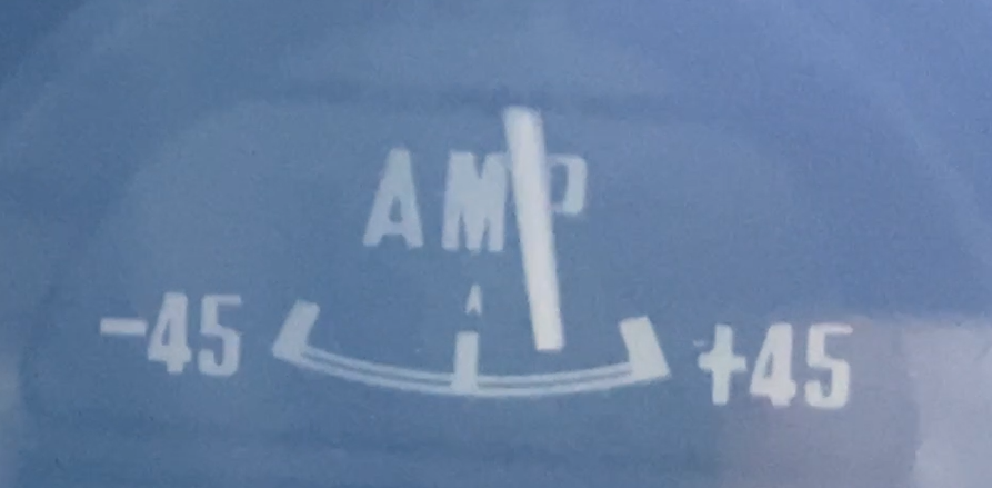

Well I think I have good news. I pulled the fuse for the red wire at the starter, and it's the fuel pump. I was able to briefly run the car without, and the ammeter definitely hovered much closer to the midpoint. the previous owner installed a fuel pump that is quite loud; I don't know if I've ever heard one this loud. There's an aftermarket cutoff switch in the car, which is actually nice from a safety POV.
I re-installed the fuse and ran the car til everything was hot and "run in".  Attached is where the ammeter needle stayed stable.This seems better, no?
That certainly explains the ammeter reading.
The reading in your latest photo seems to show the fuel pump draw if the battery was fully charged given how you say everything is wired.
What is the voltage reading with the battery topped off and car running?
