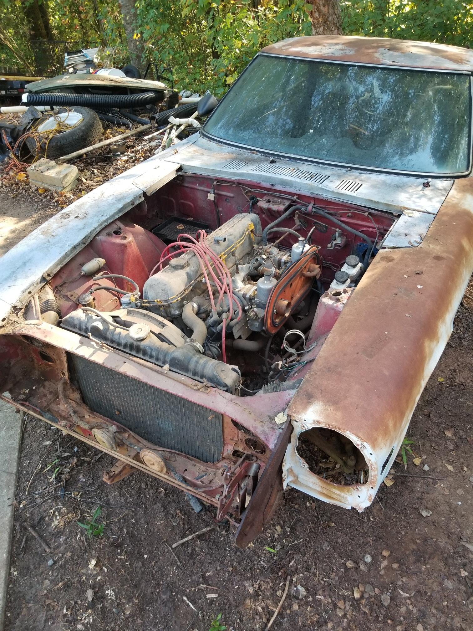

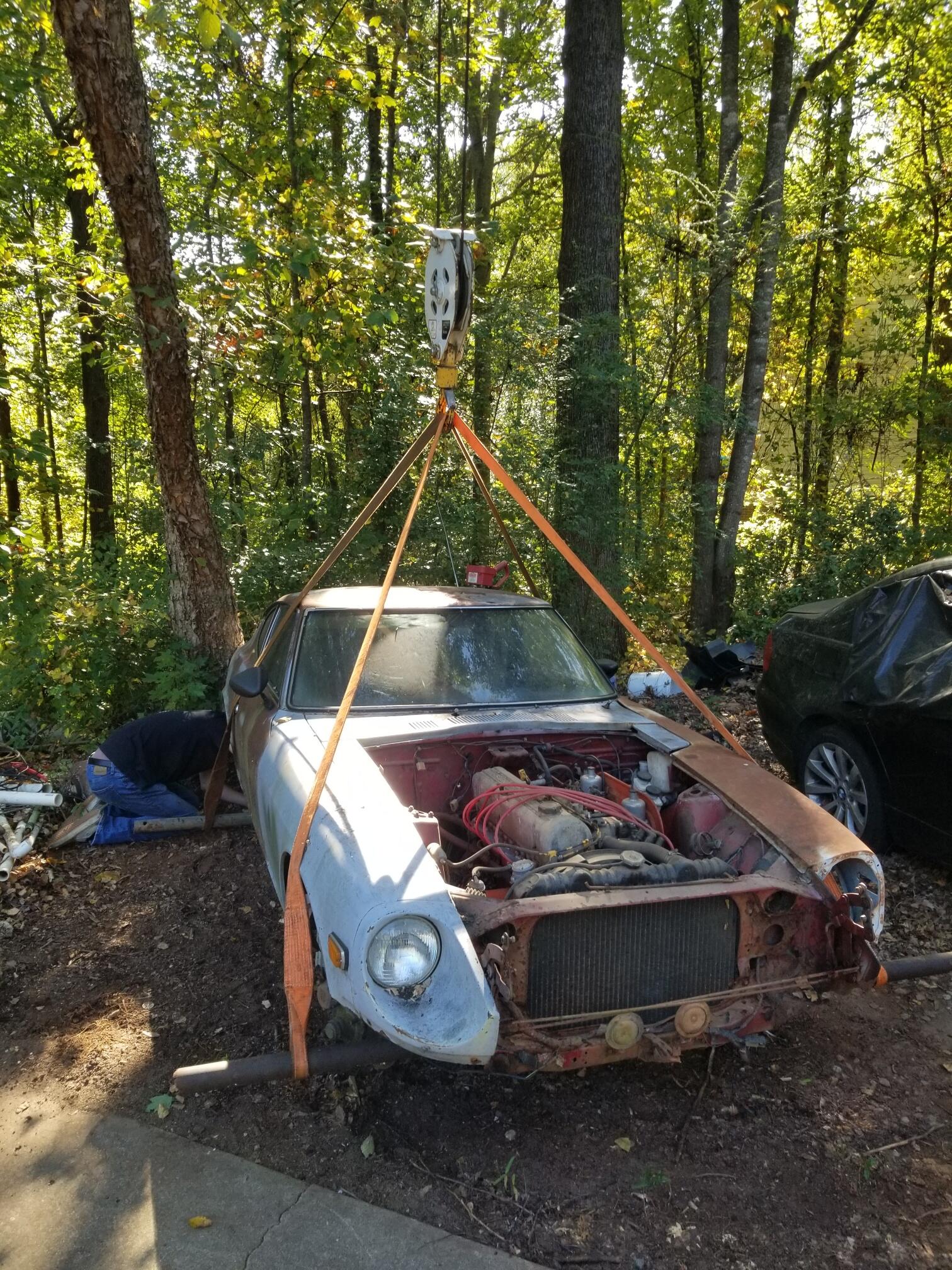

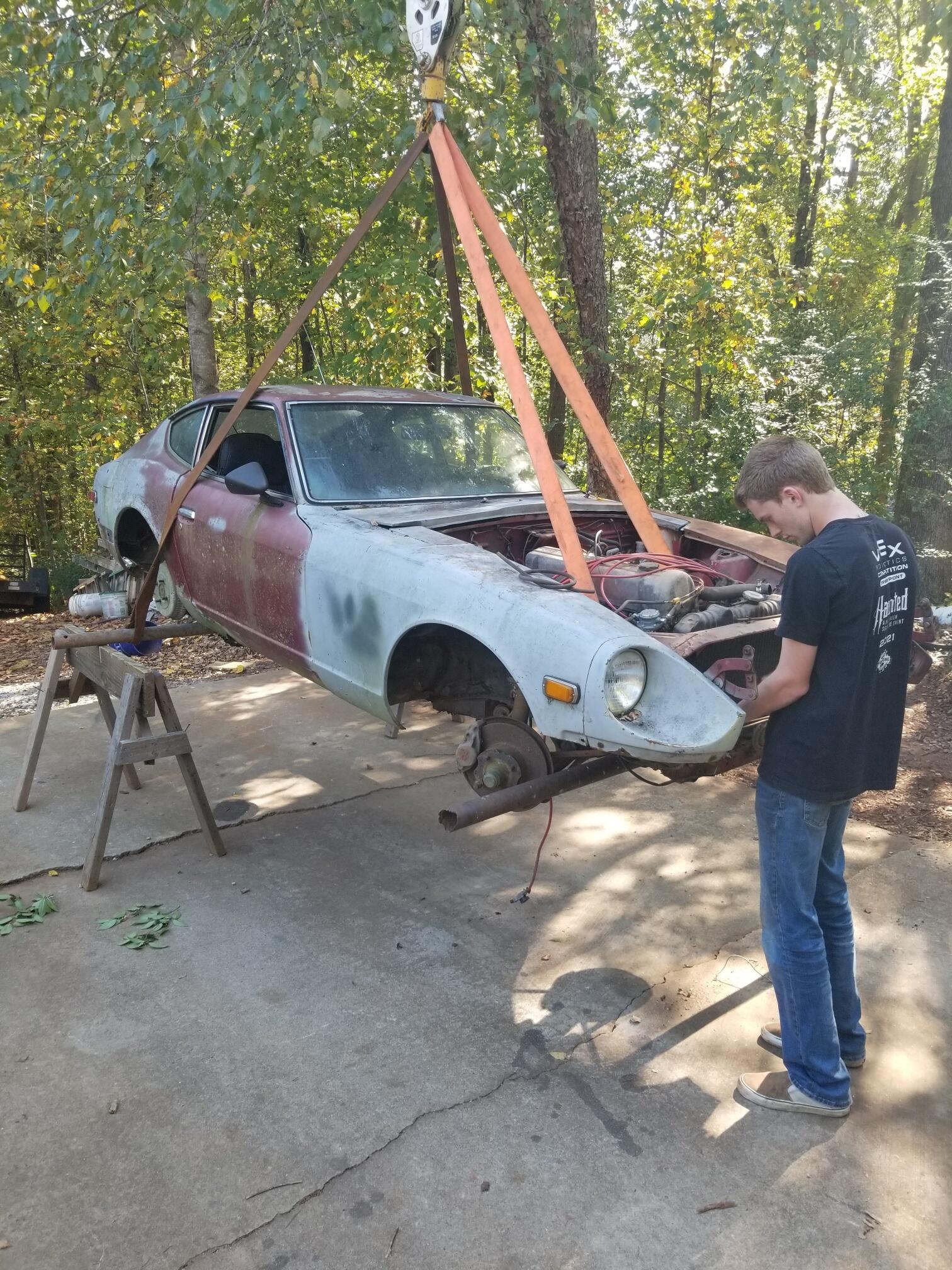

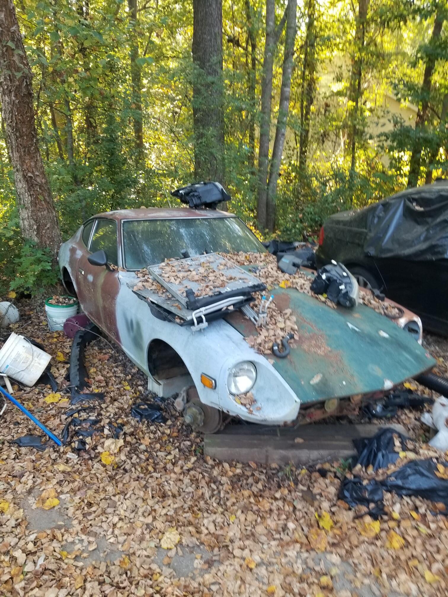

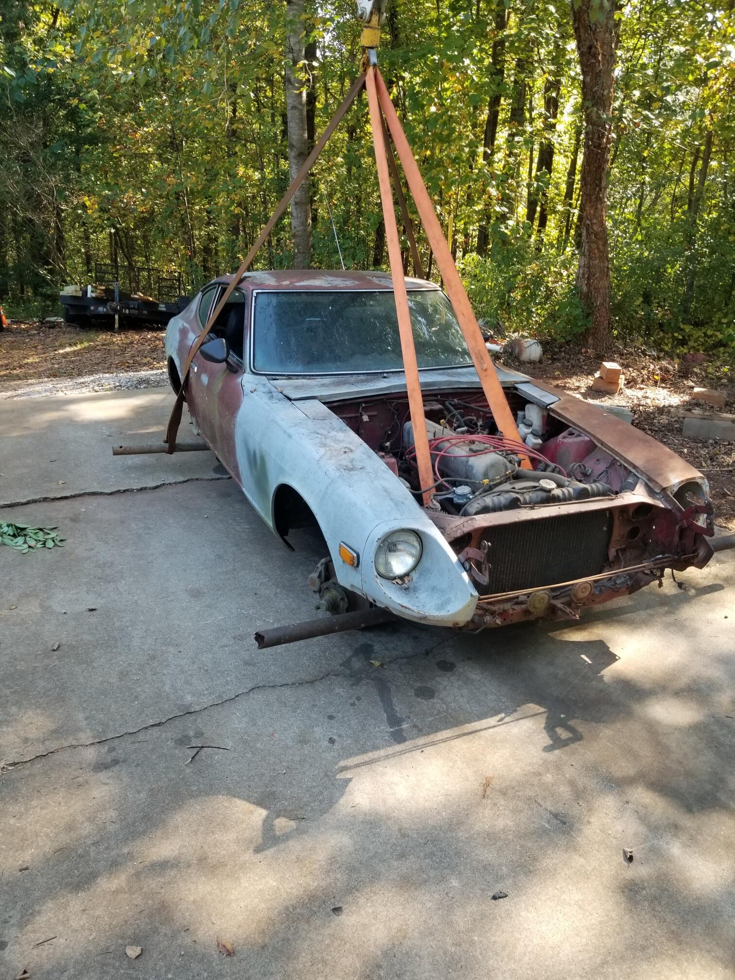

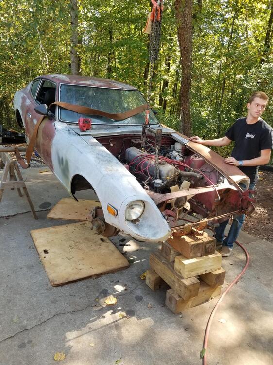

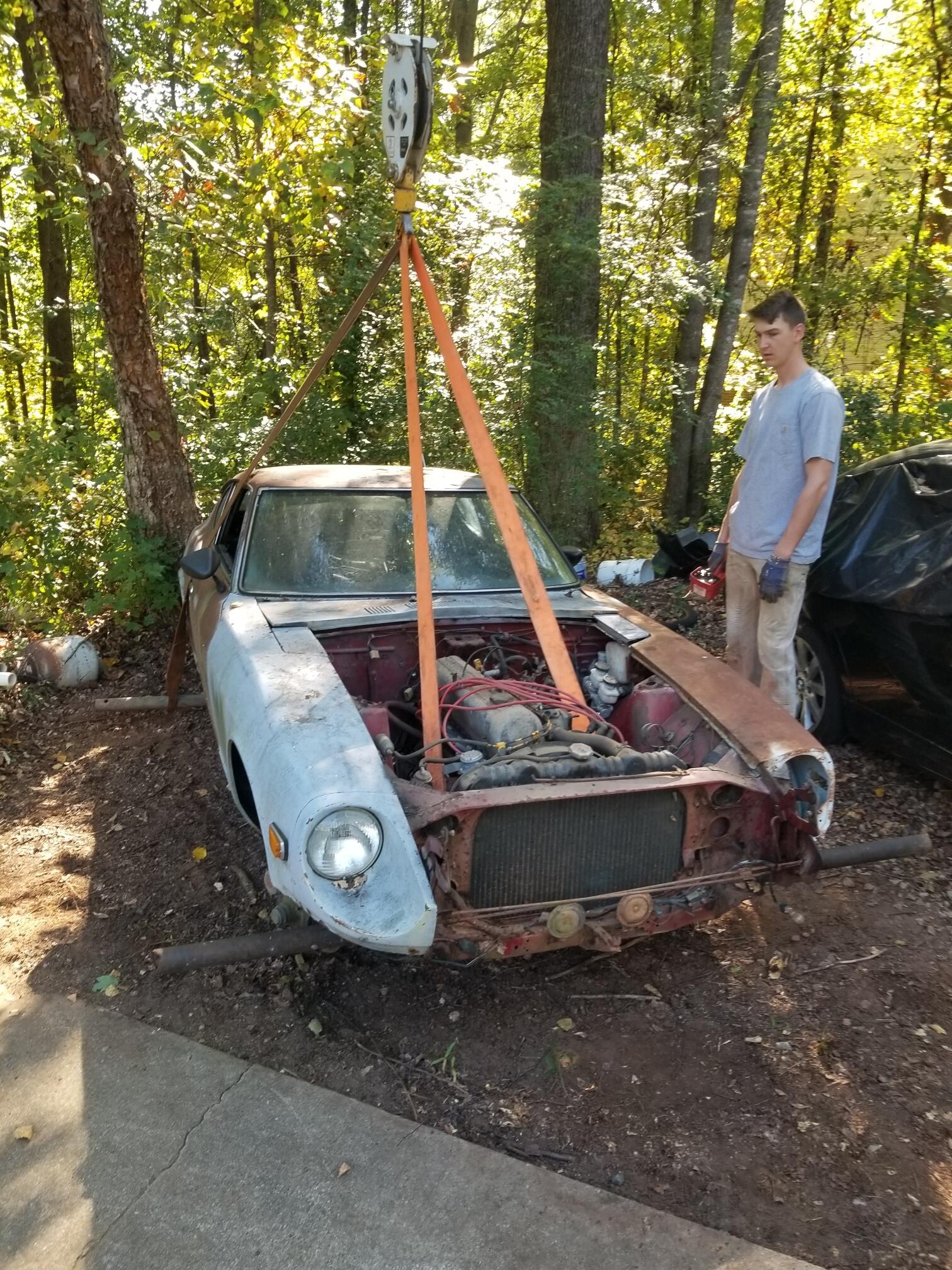

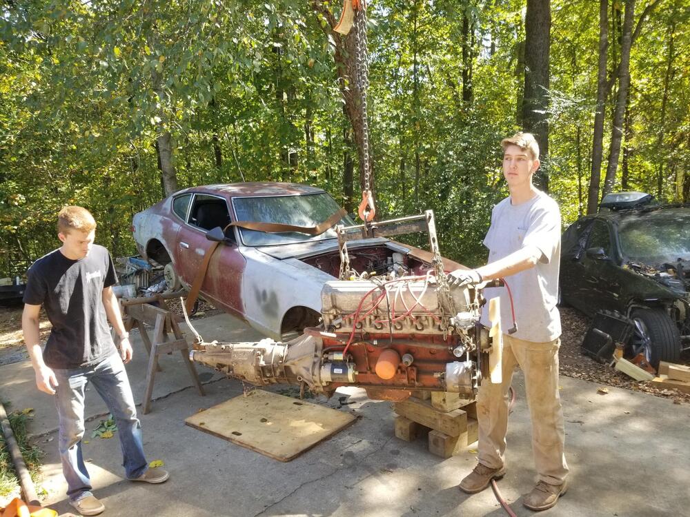

Posted October 7, 20231 yr comment_657922 So this is another car that has been sitting around at our places for decades. It was my daily driver in about 1992. I rebuilt the engine in high school and it has a five speed that I installed at some point. It has gotten very rusty over the years. I am planning on trying to save it at some point now that a great many more good body panels are available now, if I live long enough. I decided that I would pull the drive train and use it in Lily for the time being to get her running and then down the road I will probably go L28eT, but after Zcon 2024. So that is what we did today Surrounded by BMW parts and parts cars  Added some pipes underneath and some lifting straps Had to move the front straps to the inside to protect the fenders O Our engine hoist 😉 Tipped it down on some blocks and used a power ratchet on the leveler. Didn't have any issues even with the shifter still in the transmission. It was going to be a pain to get out so we just left it. Link to comment https://www.classiczcars.com/forums/topic/68602-the-brown-z-hls30-11080/ Share on other sites More sharing options...

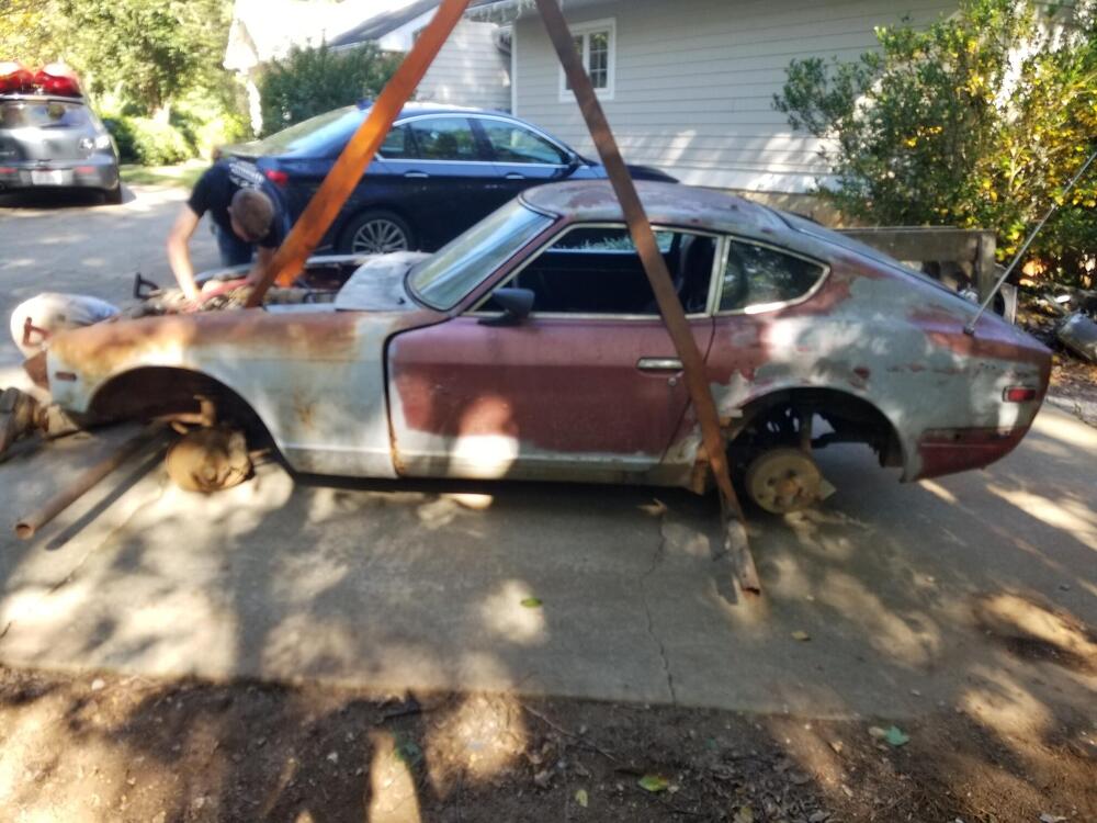

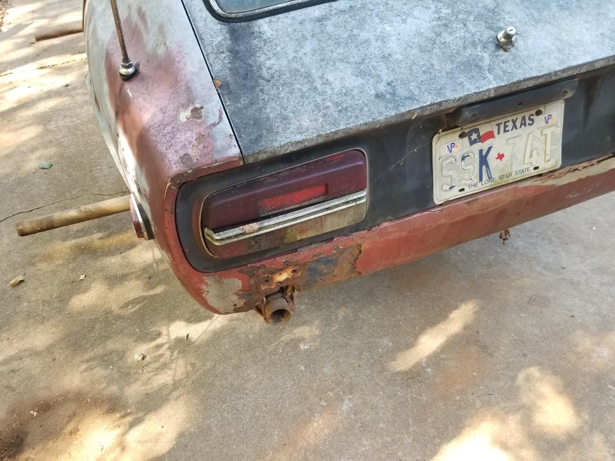

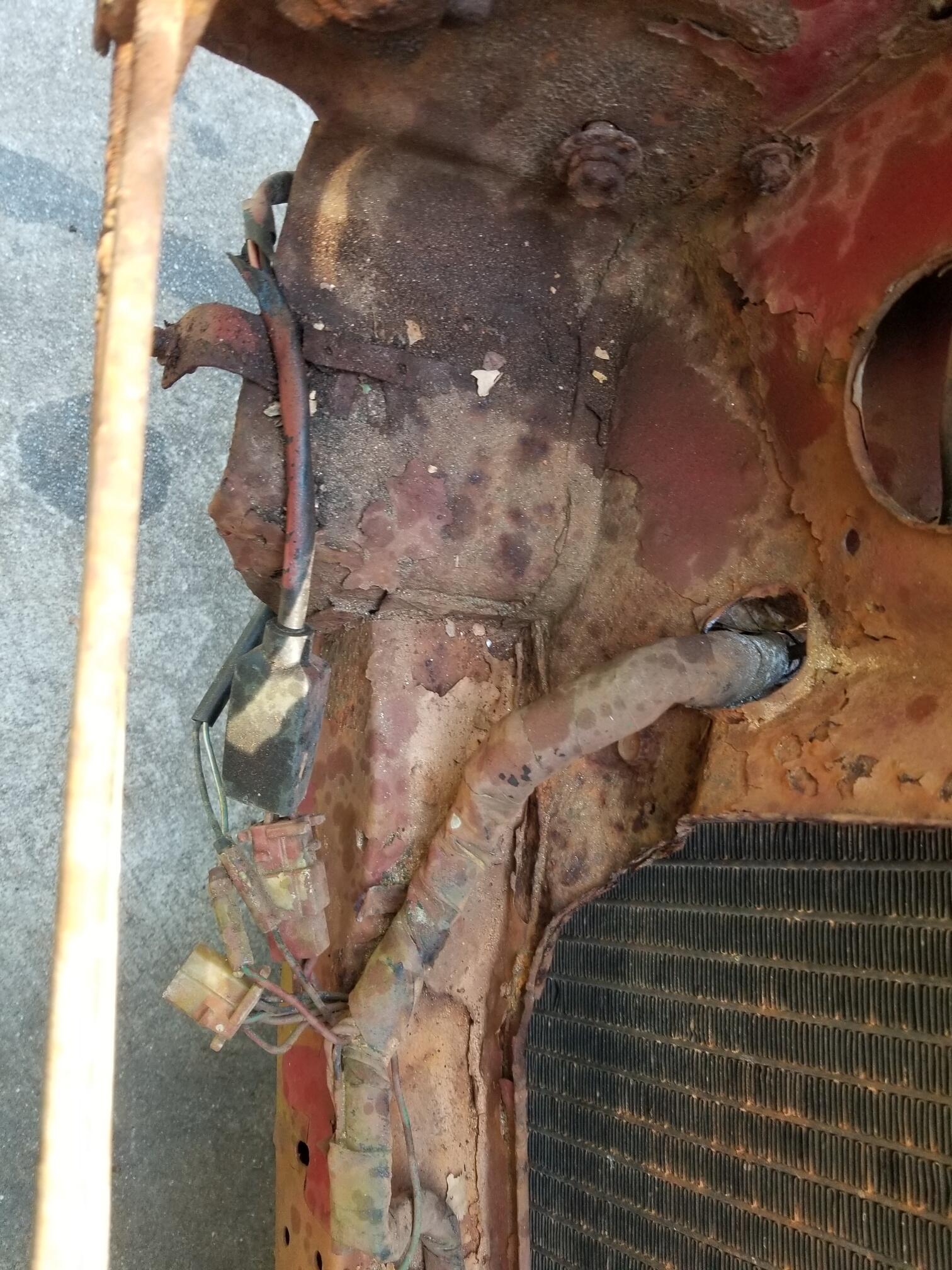

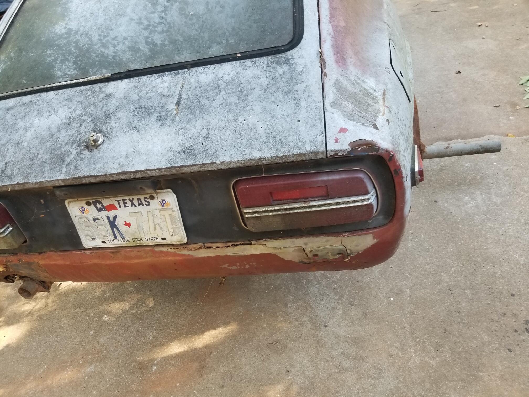

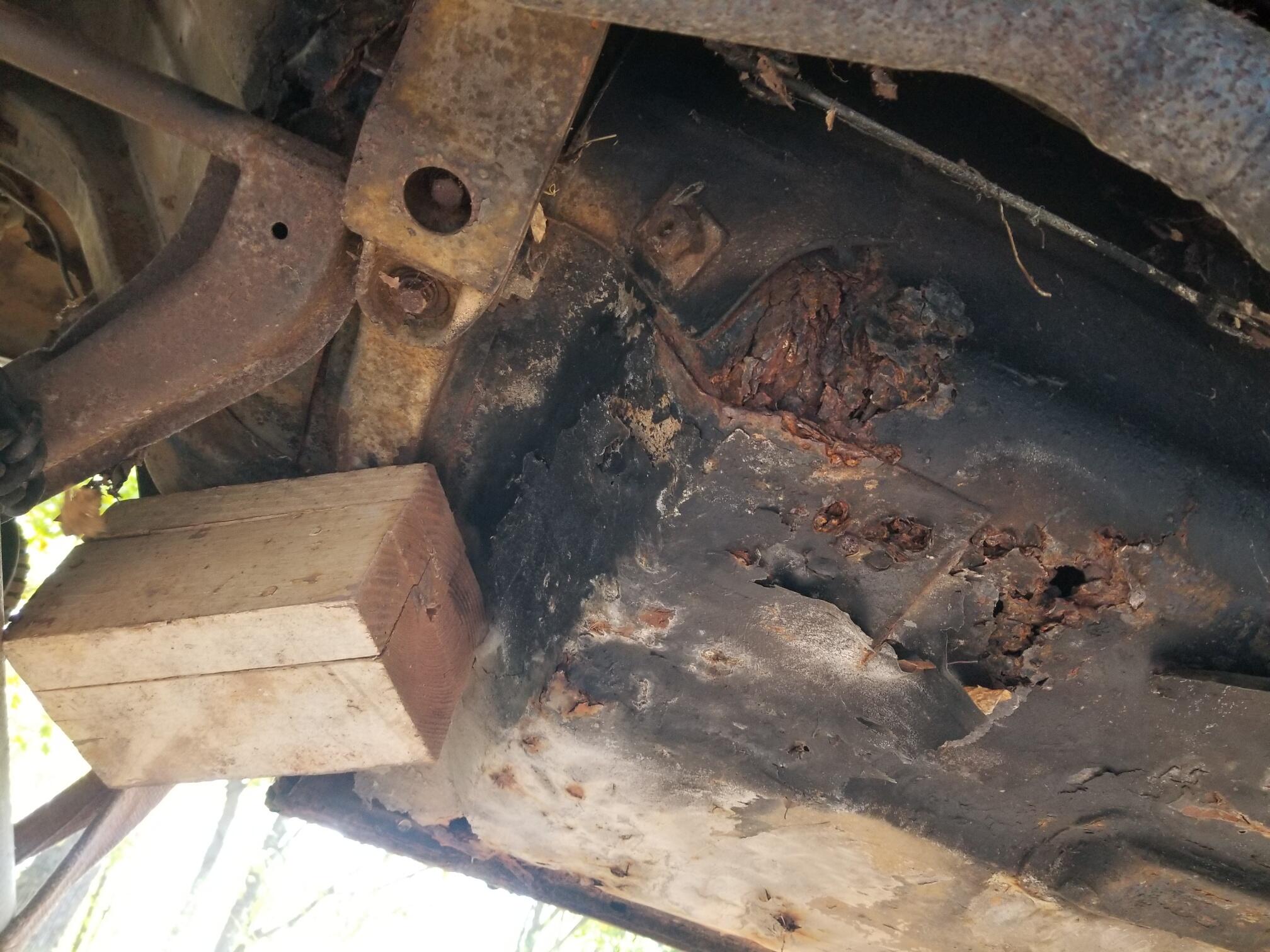

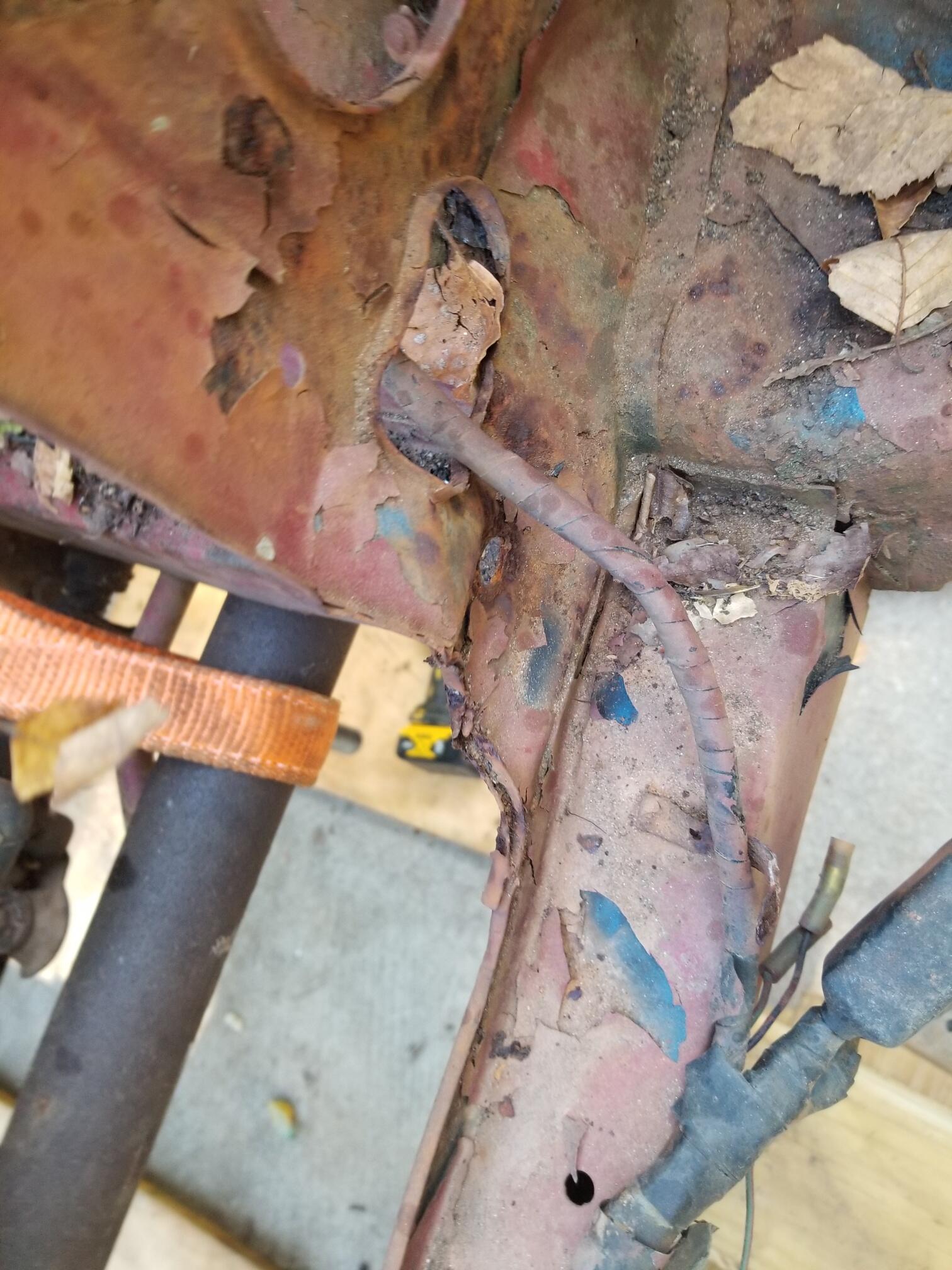

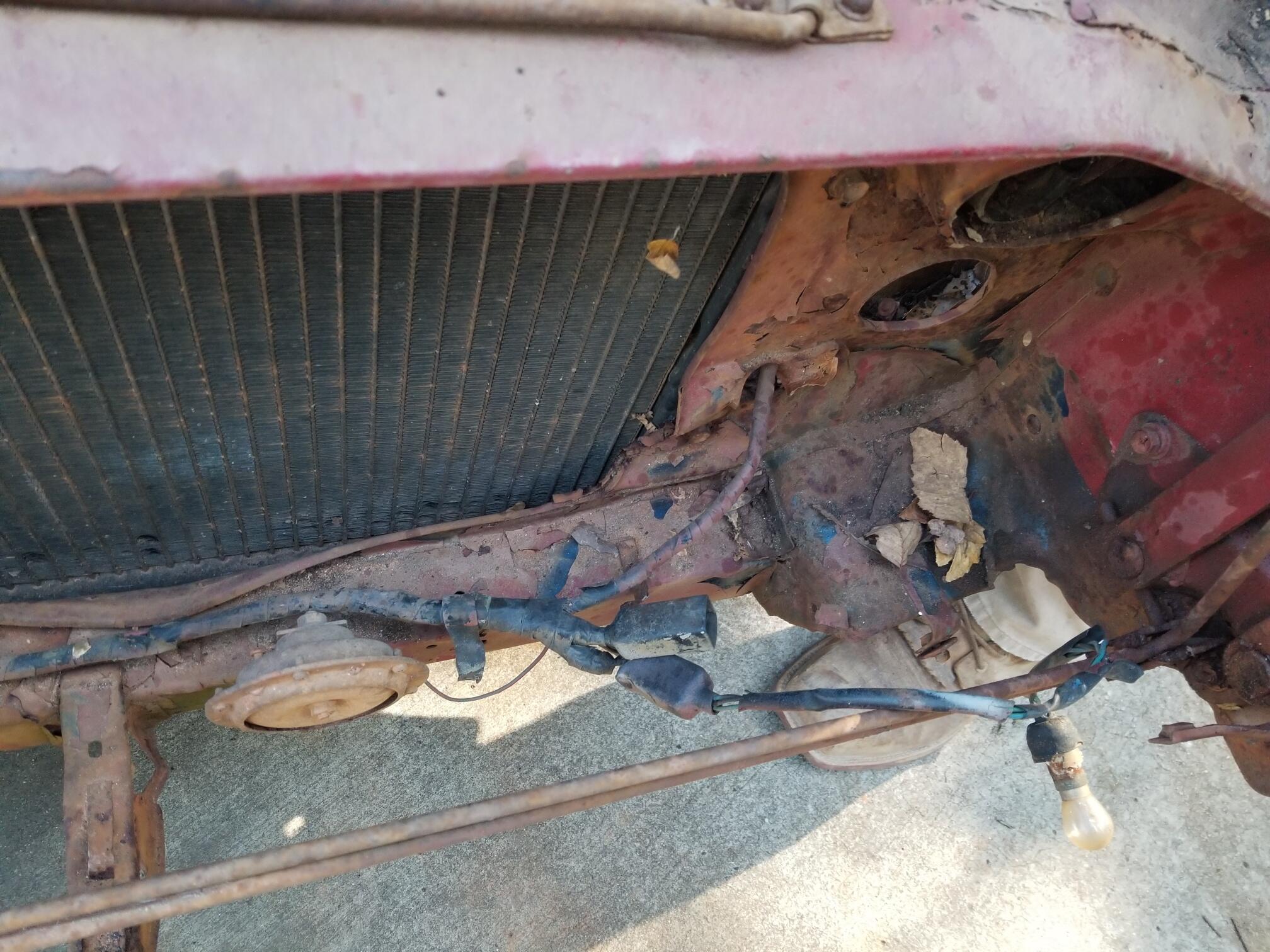

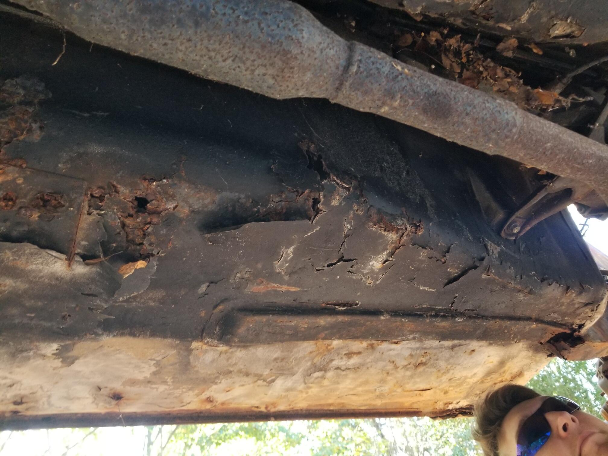

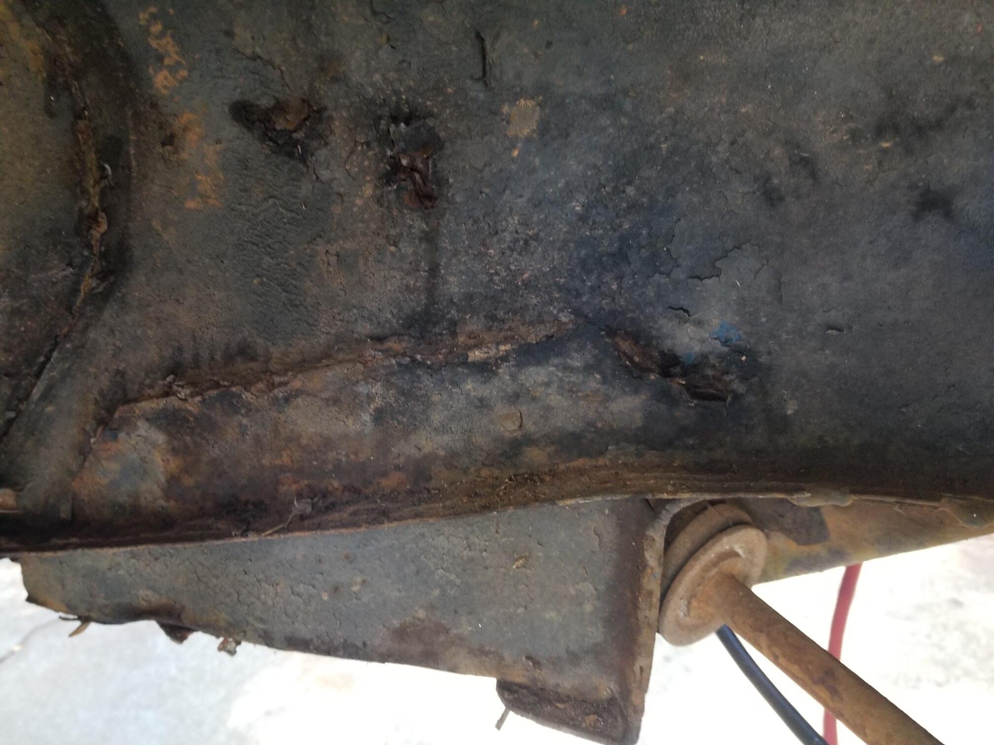

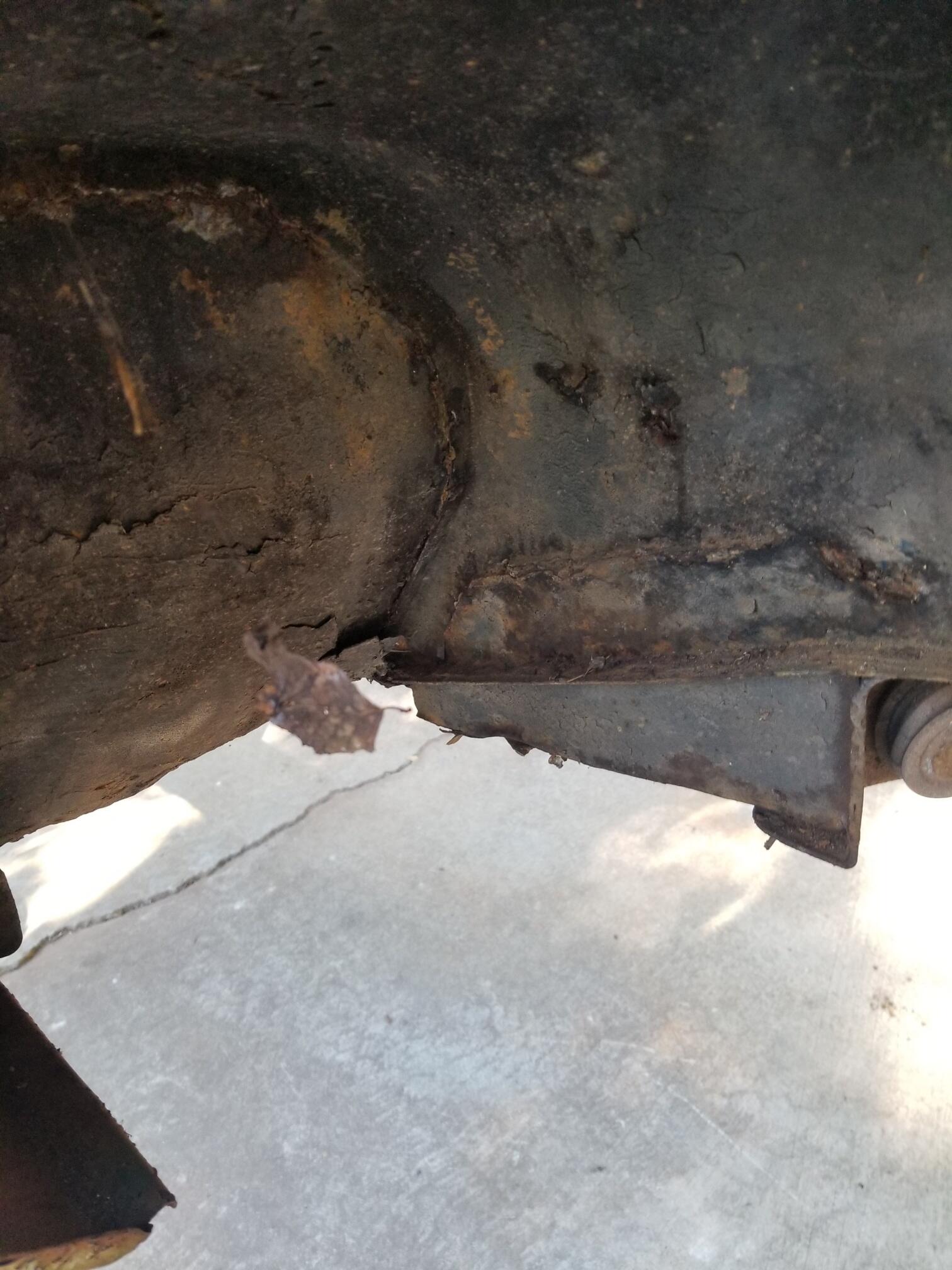

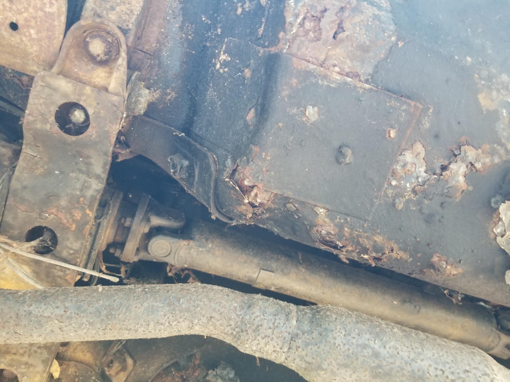

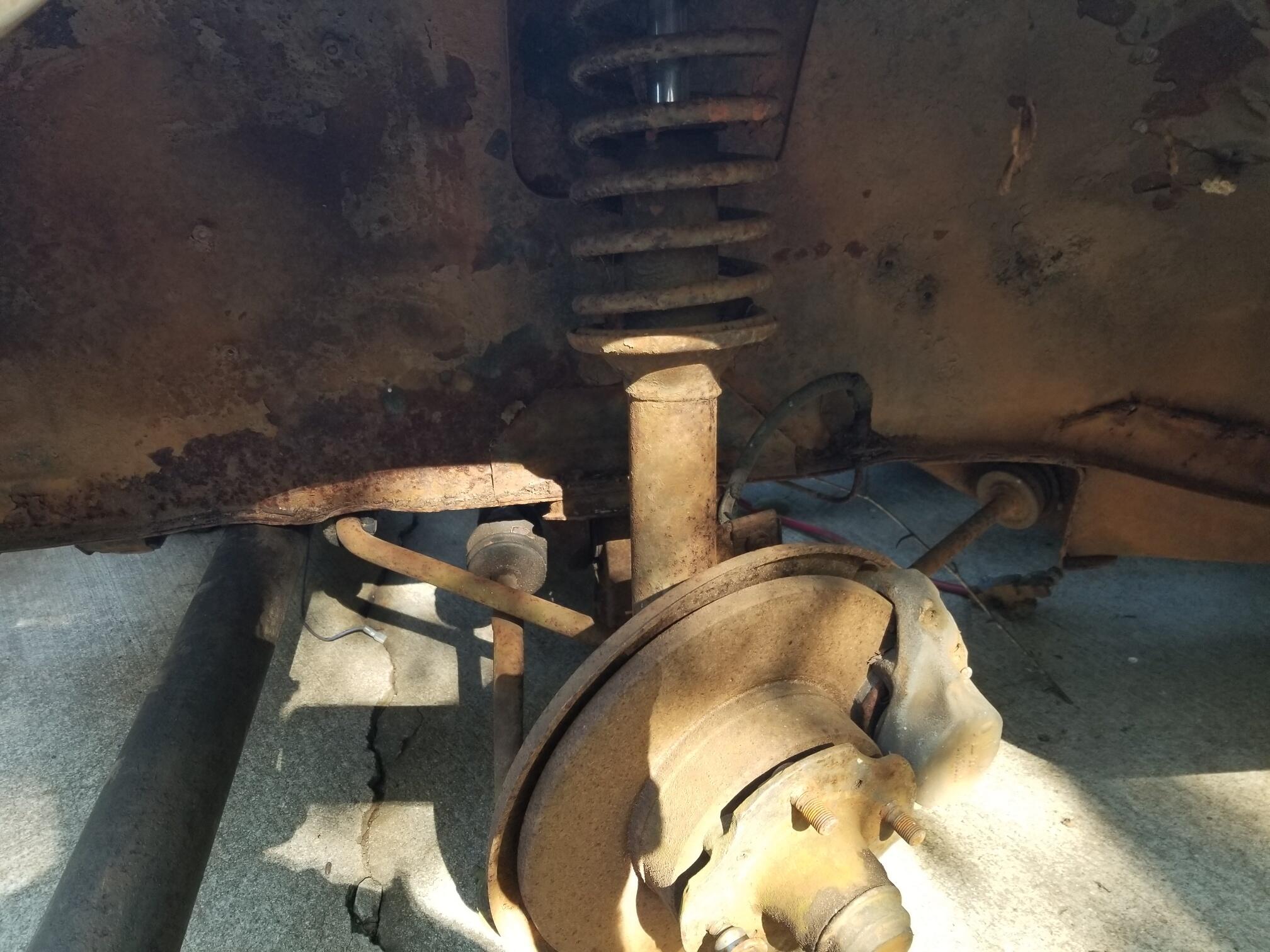

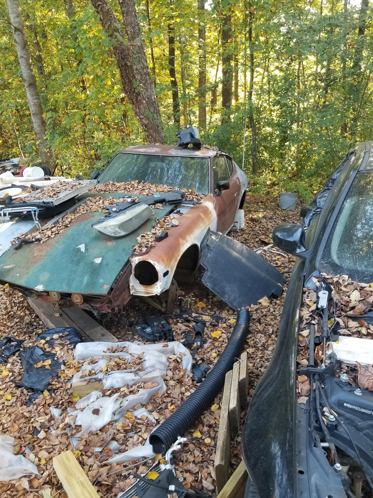

October 7, 20231 yr Author comment_657924 Here are some pictures of the general condition of the car Link to comment https://www.classiczcars.com/forums/topic/68602-the-brown-z-hls30-11080/#findComment-657924 Share on other sites More sharing options...

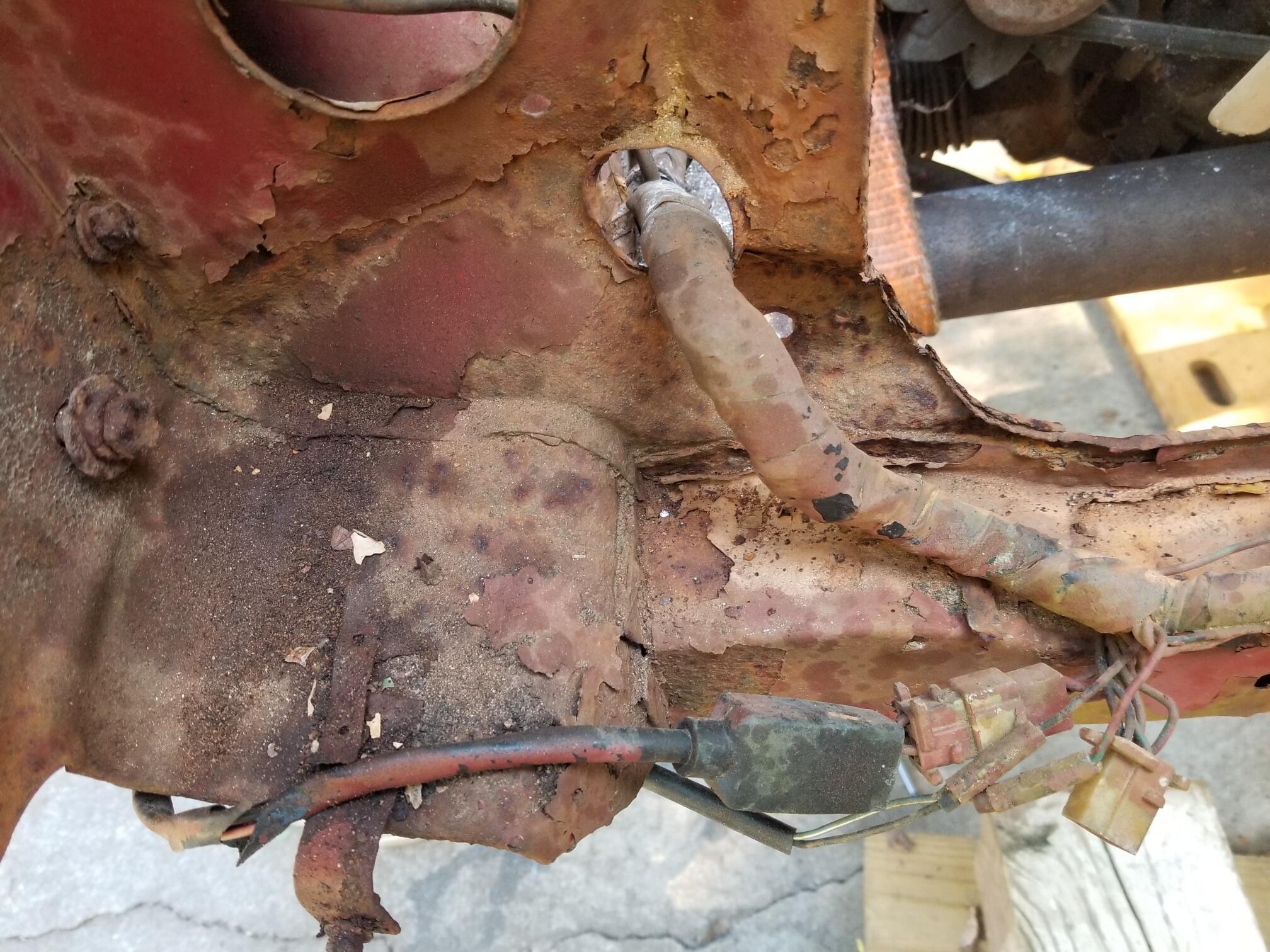

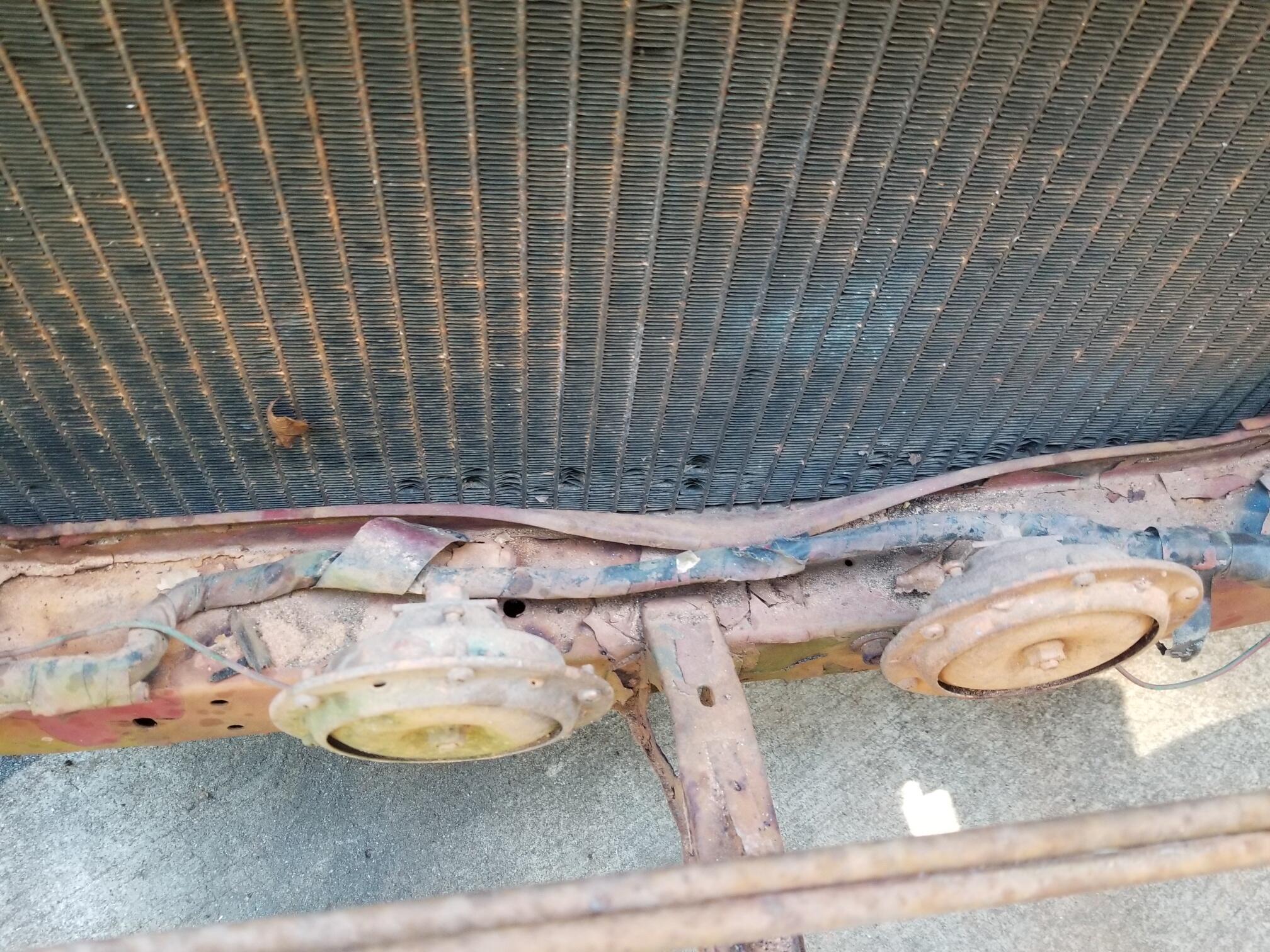

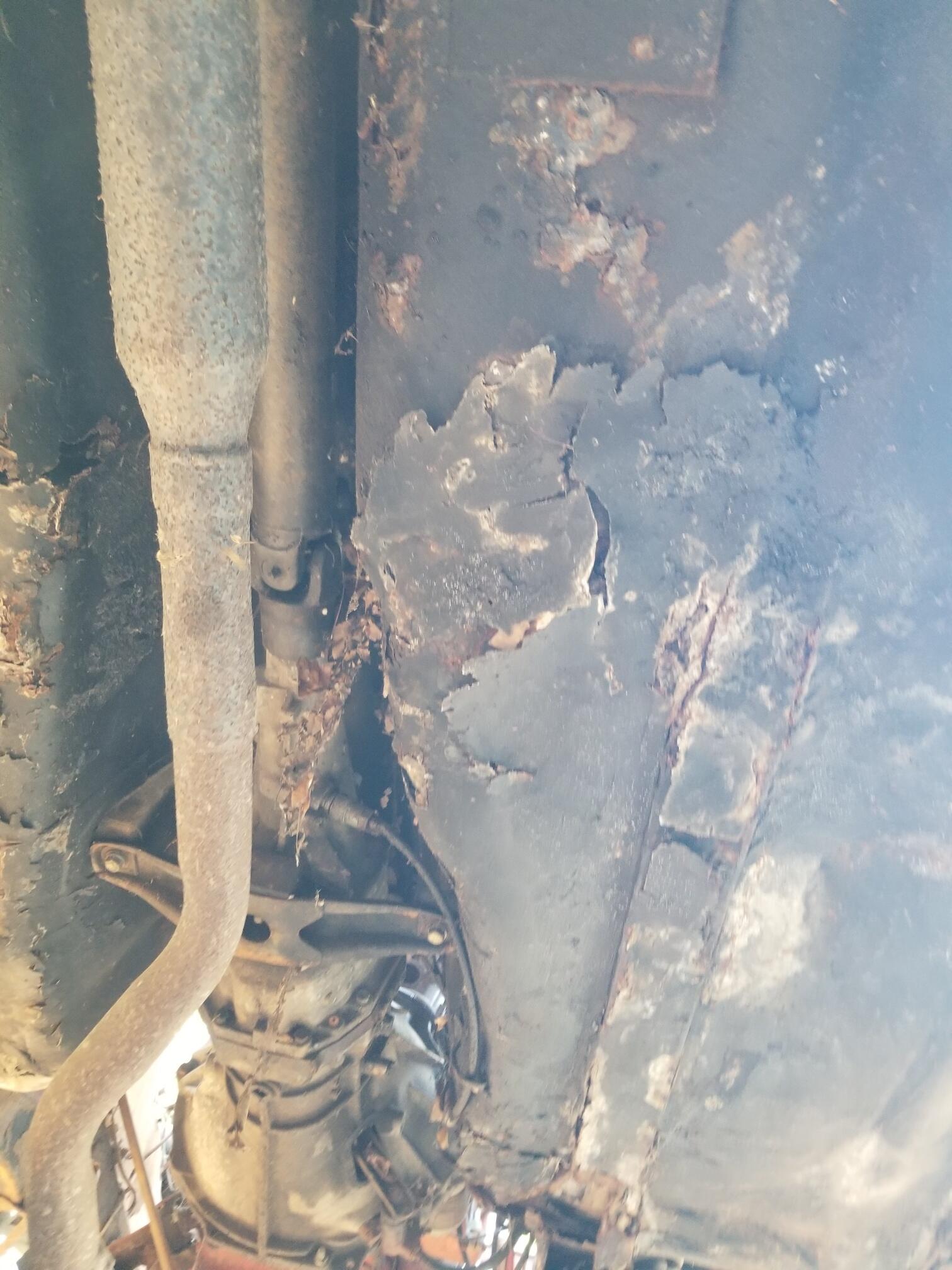

October 7, 20231 yr Author comment_657927 This car will need the "works" if I save it. Full floors, front frame rails, radiator support, quarters, rockers, doglegs, rear valance and slam panel. I would like to save it if I can but it really needs to be moved into a drier environment under a roof. Hopefully next year if I get Lily running, I can rearrange and move this under the roof near the shop Link to comment https://www.classiczcars.com/forums/topic/68602-the-brown-z-hls30-11080/#findComment-657927 Share on other sites More sharing options...
