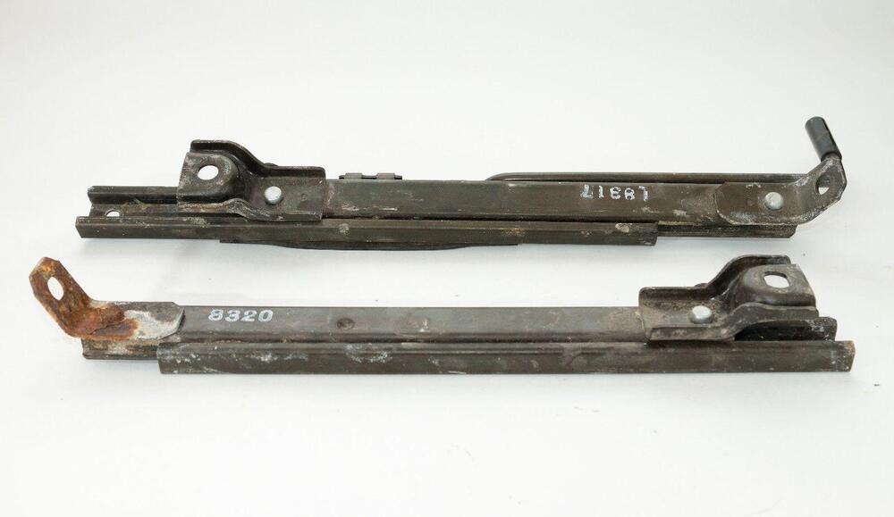

Yeah that's exactly what I've observed as well.  Here's a picture of the ones from the eBay auction:
Picture 1 of 12
It has the angled front tabs and the level-with-the-floor rear.  It does have that weird extra tang on the side of the rail with the lever, but all I really care about is whether the mounting tabs are the same distance apart as on the 280Z.

I contacted the seller and he was kind enough to take measurements of the distance between floor bolt holes on the 280ZX.  He even sent pictures.
So it looks like the 280ZX distance is a bit longer than on the 280Z.
