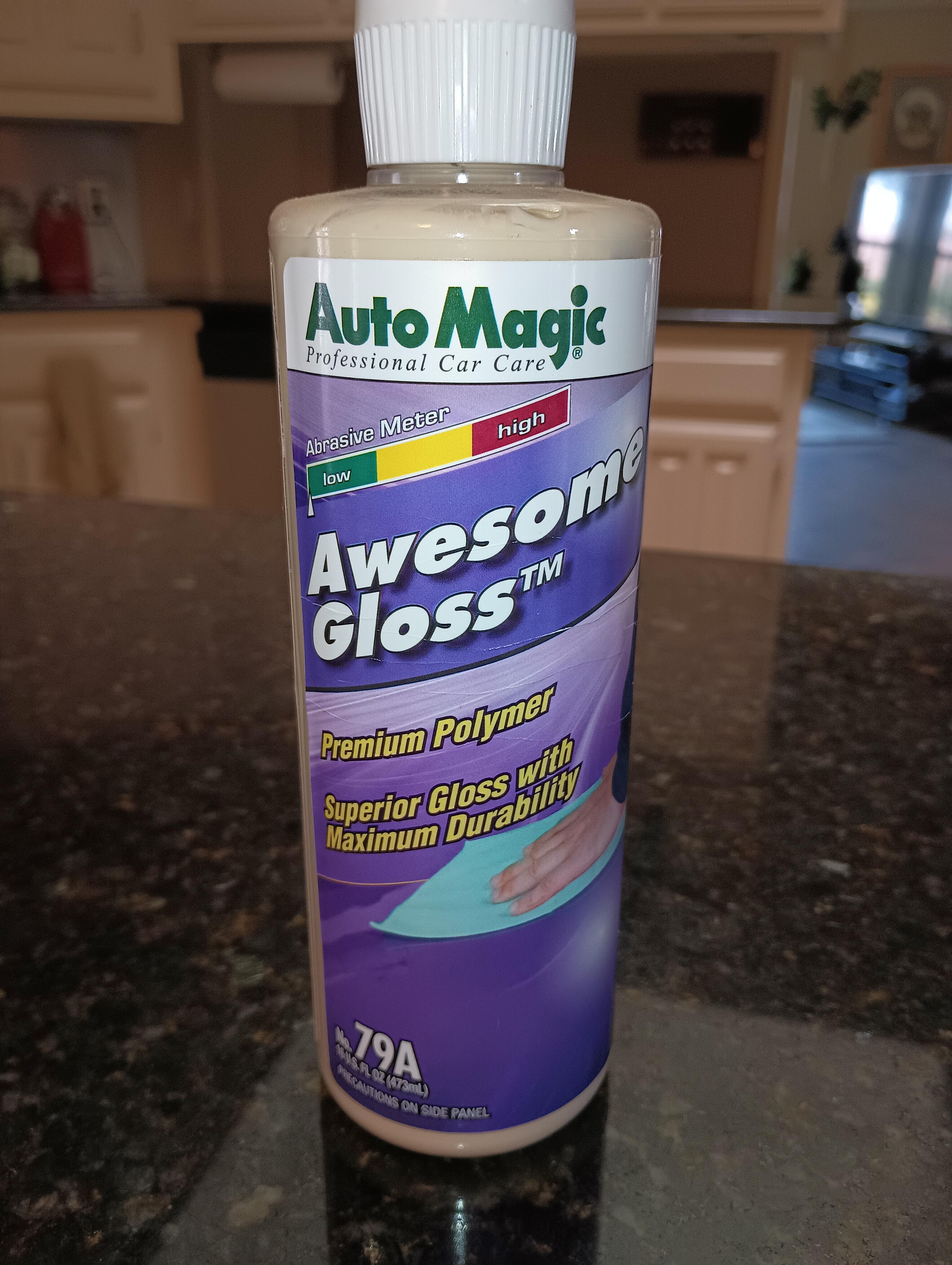

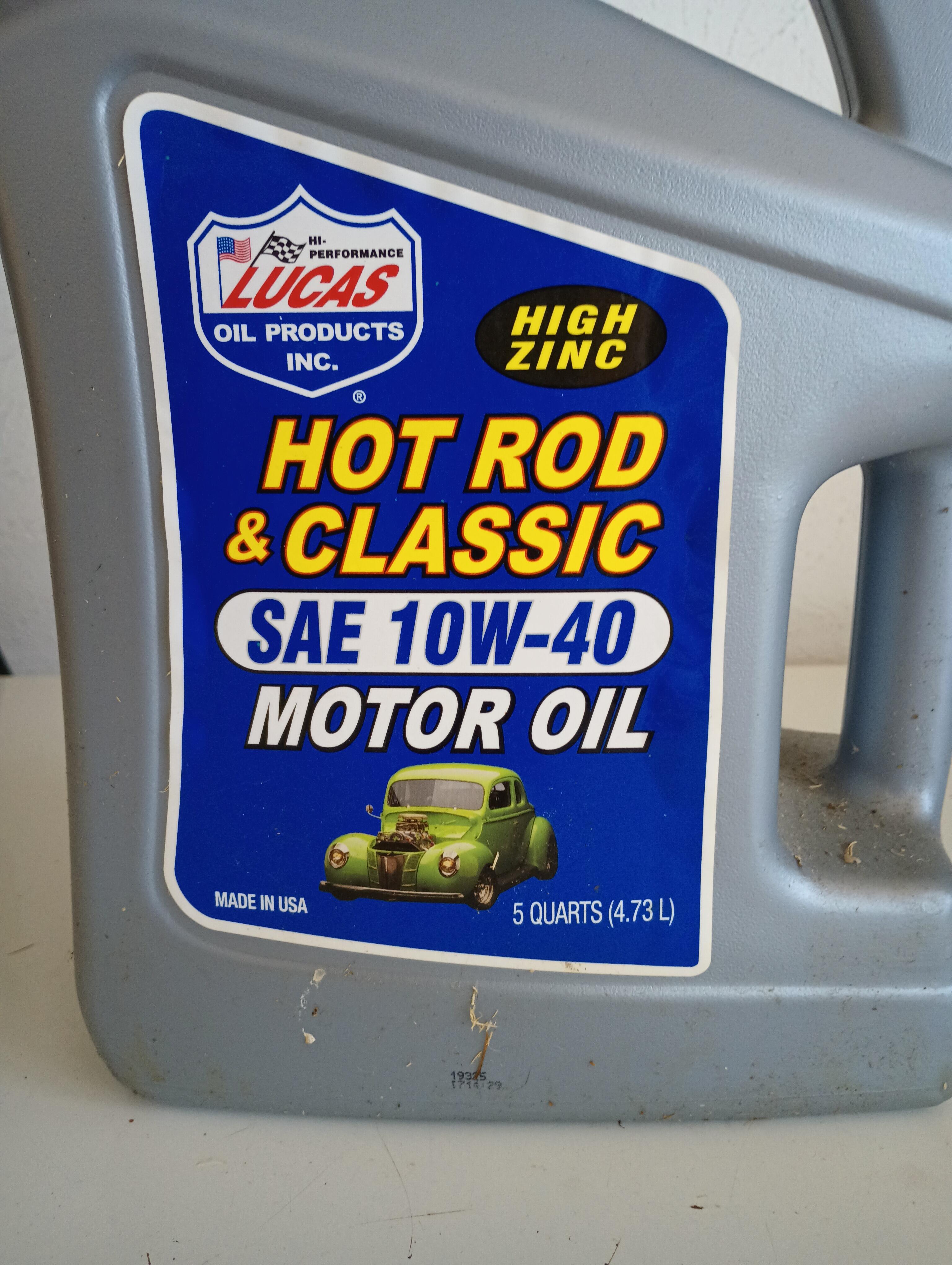

October 26, 20231 yr comment_658682 Here are a couple of good products for you - a high zinc oil and great transmission fluid for our old gearboxes. The old paint might benefit from a good clay bar treatment to get rid of old wax, dirt and other buildup, followed by a non-wax polish such as AutoMagic Awesome Gloss, topped off by the ceramic coat or wax of your choice. The clay bar process might leave a few swirl marks so the Awesome Gloss is a way to polish them out. Link to comment https://www.classiczcars.com/forums/topic/68641-general-maintenance-products-in-2023-1971-240z/#findComment-658682 Share on other sites More sharing options...

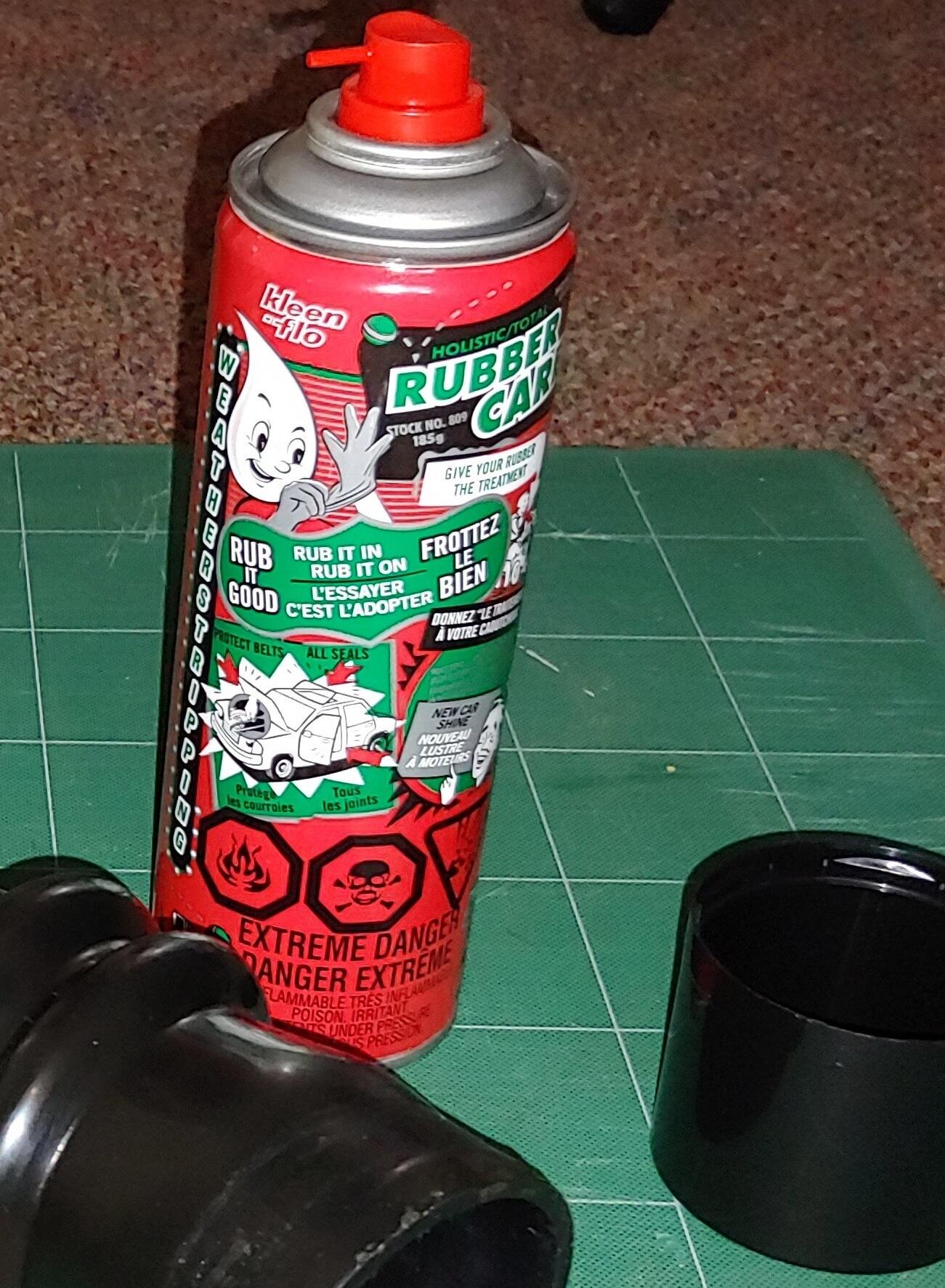

October 26, 20231 yr comment_658684 This stuff work great on old rubber items and door seals, Honey Goo Holistic Rubber Care https://www.kleenflo.com/products/809.html Strangely the website say "NEW" but its been around for years. Hopefully is not a new formula that's not as good as the original. Link to comment https://www.classiczcars.com/forums/topic/68641-general-maintenance-products-in-2023-1971-240z/#findComment-658684 Share on other sites More sharing options...
