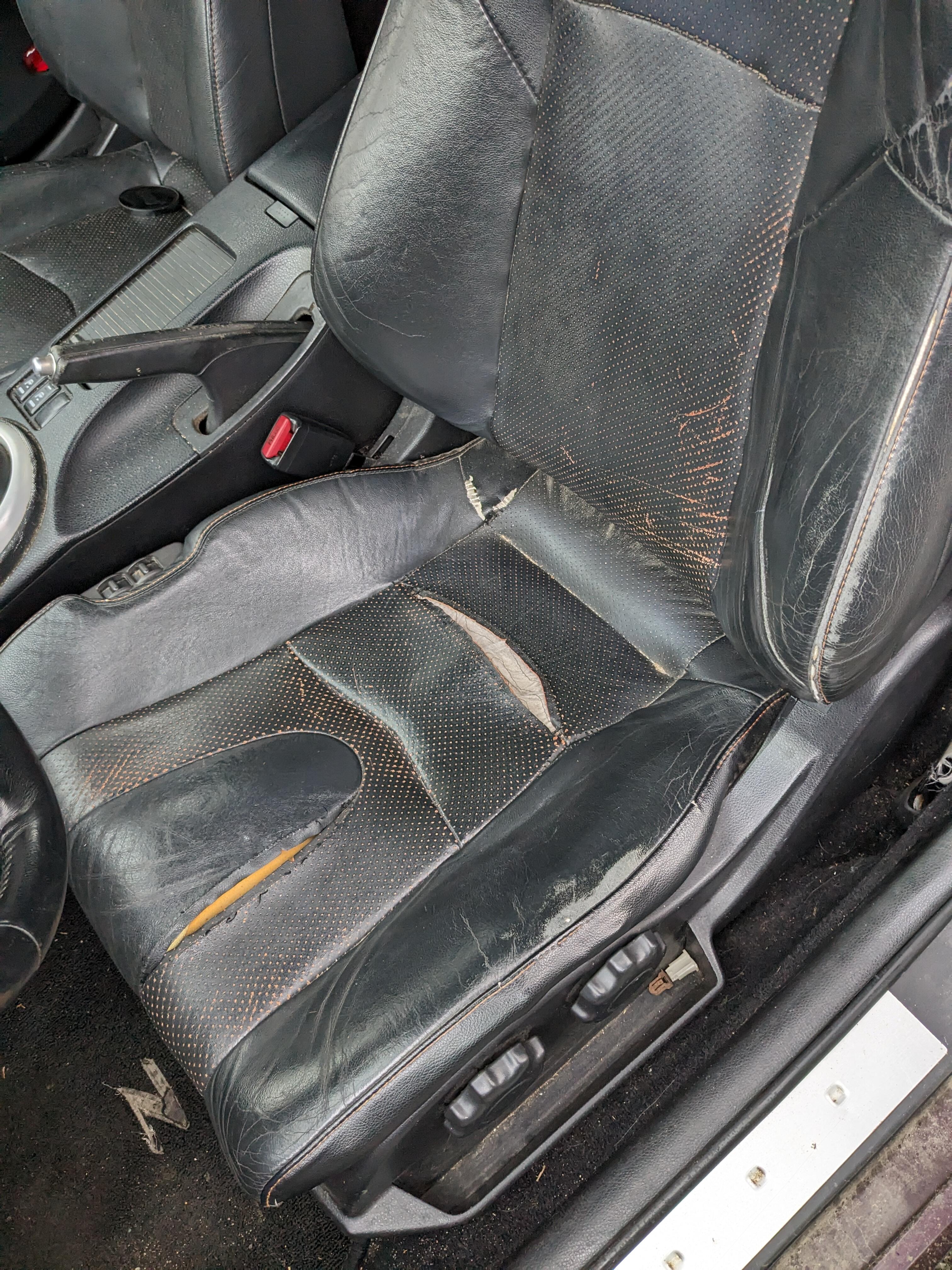

Found a helpful thread on 350Z seat fitment.

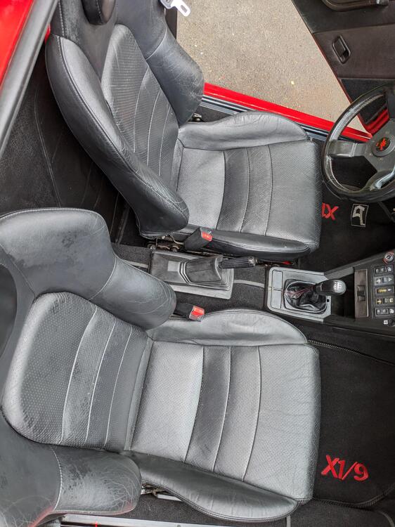

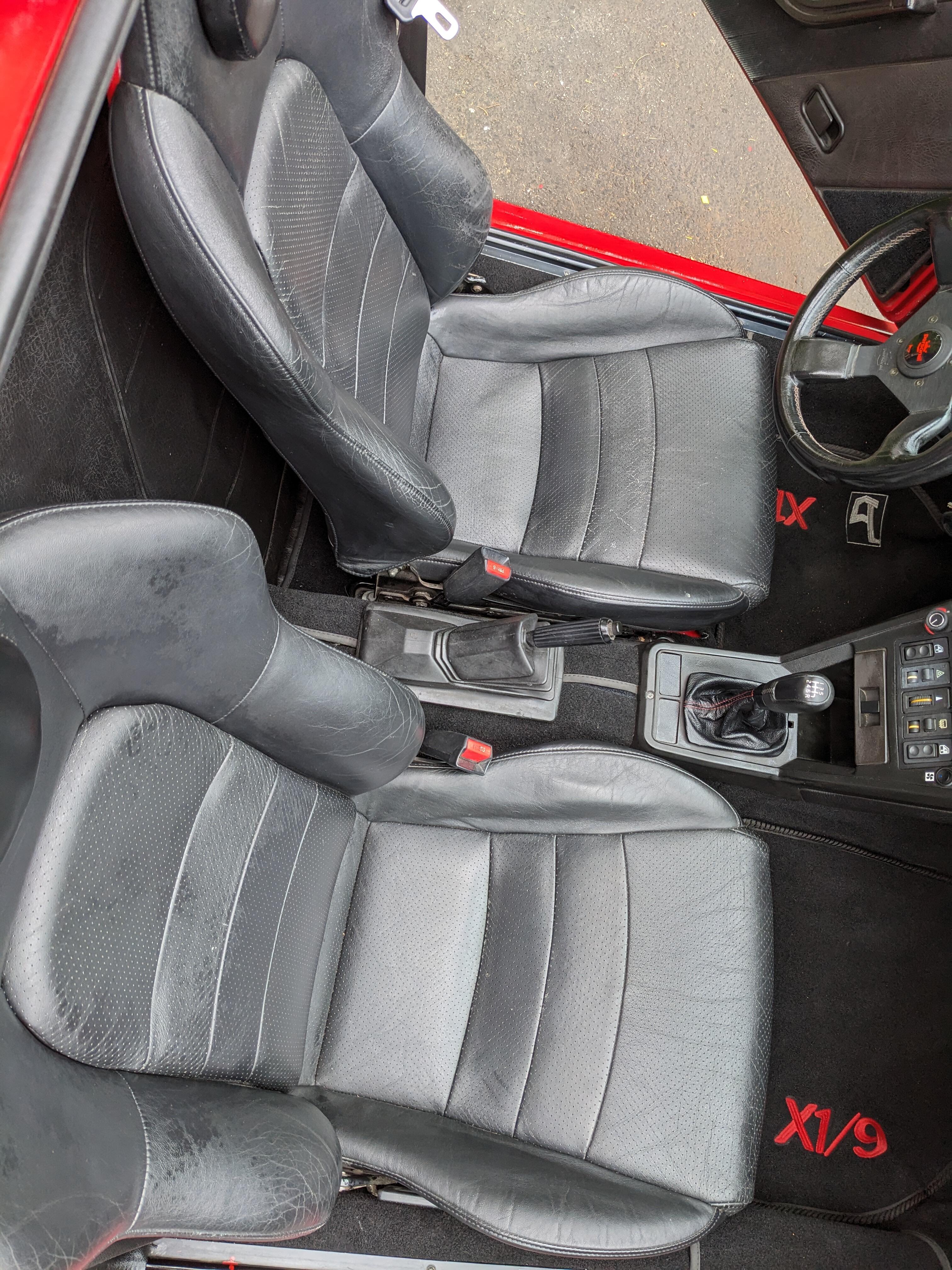

Since I've been driving the X1/9 again this past week, with the Honda S2000 seats, I really find the Datsun seats uncomfortable for my lower back issues.
My 350Z seats are rough, so while I work on fitting them, I've ordered new leather from Ridies.com. Much more price-friendly than the CanadaSeatSkins that I used for the Volvo seats, and full leather for all panels.
Going for Black w/ dk grey perforated inserts, green stitching.  All the examples on their site have more contrast, like this

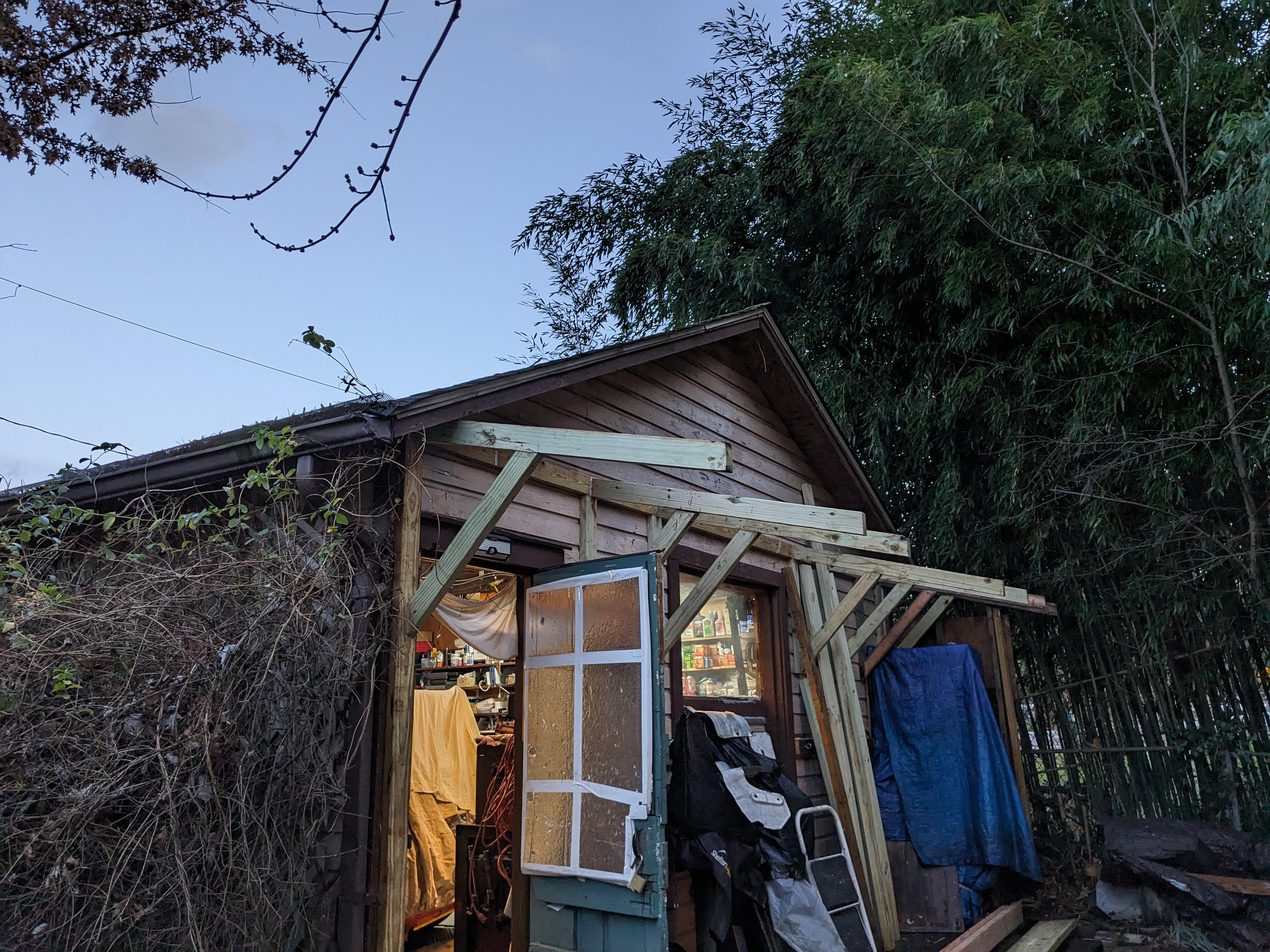

Started talking about the back of the garage in this thread  - making room for heavy equipment that I need to have outside, to make room for the 80gal compressor inside
Today I added a header, and an end rafter - looked online for a guide to appropriate pitch for the awning. Basic minimum rule seems to be 1/4" for every foot. I made the awning end rafter 50" deep, with a 6" drop - so well over minimum spec -  "looks' reasonable to me.
picked up some lumber & corrugated panels
To get the pitch, I cut 15º on the rafters, then 45º & 30º for the 3' angle section, that put the brace around 1/2 way out the rafter. It's only carrying the weight of the corrugated panels, so I think it will be fine.
The plan is to put the rafters/braces  24" on center, since that aligns with where the studs are in the garage wall. The corrugated panels are 26" W, I'm planning on about a 4" overlap
Had time to make & put up 4 supports before I had to pack up, and caulked the header at the wall, since I don't have time to do the drip rail, etc, before the rain forecast for all day tomorrow & Monday
I realized the one by the garage entry dropped when I mounted it to the stud, the pitch angle is obviously off in this pic
So I corrected that when I got home from the party we were attending, was only a couple hours, so the construction adhesive had not set yet
The problem Is I need to figure out a way to attach rafters over the window, otherwise I will not have rafters to support the central roof panels
Outside the door on the frame, I need to add a support to hold the outermost rafter & brace. Have to cut off some of the existing door overhang

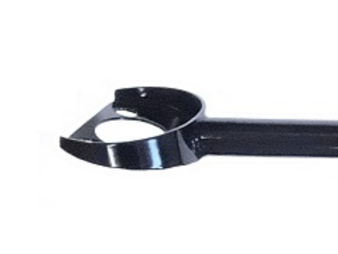

Since it's pouring rain now, I started working on the rear strut brace. Strut weld plates came from ZcarDepot
making the vertical support for the tubing from 2" x 3/16" bar stock
started curling the plate in the vice
tried to use this 4" tube to squeeze the plate around for refining the circle, doesn't work
So I used the strut plate to bring it into shape
have to contour the tube end to mate with the weld plate
1.75" x.095" tubing

Figured out a way to deal with the rafter supports in the window space . I'll add studs to provide a support. Still need to figure out the one over the door
Added two more rafter braces before the rain came in this morning, covered up my equipment
If it were me, I am a builder, I would run a sub fascia across the end of all the rafters. A 2x6 at a minimum or maybe a 2x8. I would add rafters at the window and door with out the braces. Fastened well on the building side and the sub fascia. I would then strap the top with 1x4's a 16"OC or maybe even 12"OC. Then I would run the panel on top of the 1x4s with flutes aligned with the slope. The sub fascia should help span the gap that's not braced and the 1x4's will also help. Rain is not the issue, snow load might be...
I would use screws like GRK's for assembly versus nails to try to lock it all together
Thank you for the input!  I planned on adding 1x4's across the top to support the panels.  I was only going to use a 1x6 facia for securing a gutter. With only the weight of the corrugated  panels (flutes aligned with slope), I hoped  that would suffice. I assumed the weight of a 2x6 or 2x8 sub facia would be too much weight hanging over the braces. The only place I won't have a properly supported rafter will be over the door, after I make the two stud supports in the window recess. I've used construction screws throughout w/construction adhesive on the joins (I don't have a framing nail gun, and I will want to remove this at some point DTR). I bought the panel screws w/EPDM washers for securing the panels to the rafters.
Edited by HusseinHolland
No I dont think the 2x6 or 2x8 weight would be an issue. I would prefer spruce, pine or fur. Not yellow pine or treated. It loghter and straighter and nearly as strong. Just let the panels extend 2-4 inches to keep water off the sub fascia. I wouldn't put the pieces in the window. I think that might cause other problems and obstructs the window. You're not spanning too far and it has very little weight on it. The tributory load is half on the building side and half on the fascia side. Maybe 8 sq ft total on the fascia side. A deadload of 5# a foot which is probably high would be 40#s. The subfascia is very strong in the vertical orientation. Even with snow load it might be a couple of hundred pounds. Still not a problem I don't believe
9 hours ago, Patcon said:
No I dont think the 2x6 or 2x8 weight would be an issue. I would prefer spruce, pine or fur. Not yellow pine or treated. It is lighter and straighter and nearly as strong. Just let the panels extend 2-4 inches to keep water off the sub fascia. I wouldn't put the pieces in the window. I think that might cause other problems and obstructs the window. You're not spanning too far and it has very little weight on it. The tributory load is half on the building side and half on the fascia side. Maybe 8 sq ft total on the fascia side. A deadload of 5# a foot which is probably high would be 40#s. The subfascia is very strong in the vertical orientation. Even with snow load it might be a couple of hundred pounds. Still not a problem I don't believe
OK. Thank you for your experience with construction. I'll get non-treated pine or fur to run for the sub facia. I used treated pine for the supports as there is not much sun on the backside there with all the tall bamboo & trees along the bank of the easement around that side of my property. It tends to be on the damp side. I'm not concerned about obstructing the window though, so I could always add braces for the rafters, if it turns out to be an issue.  I wasn't sure how much overhang would be appropriate - I do want a gutter along there so around 3-4" overhang would make seem to make sense, thank you.
If you're going to gutter it, you might want to be on the 3" side. You could also counter flash from under the roof panels to down inside the gutter to protect the sub fascia a little better
Worked on the rear strut brace this afternoon, then the rain stopped long enough for me to get the outer rafter up. During the week I'll try to finish it up
