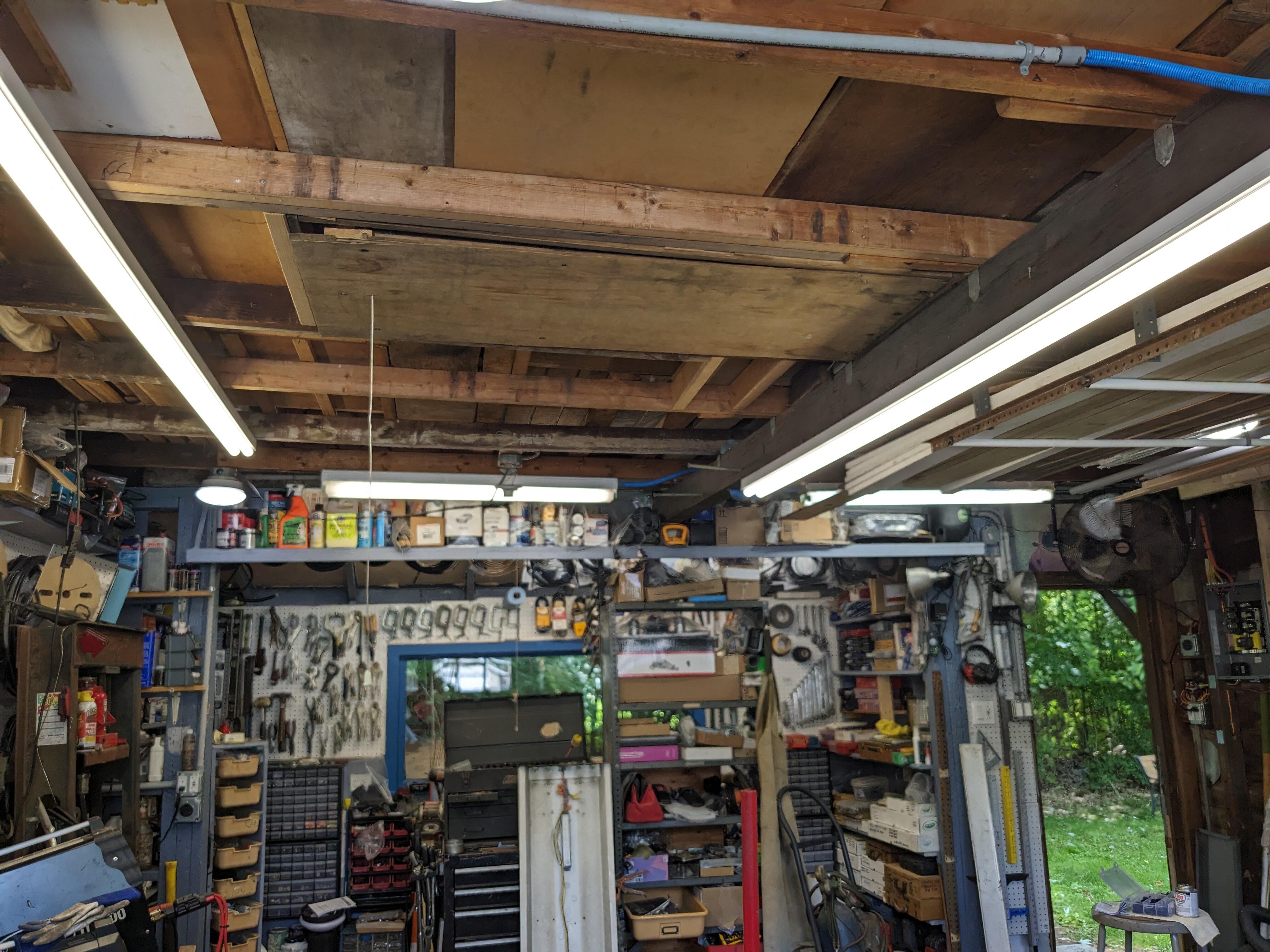

Today I added an 8' LED light on the left, 2 fluorescent units on the cross beam

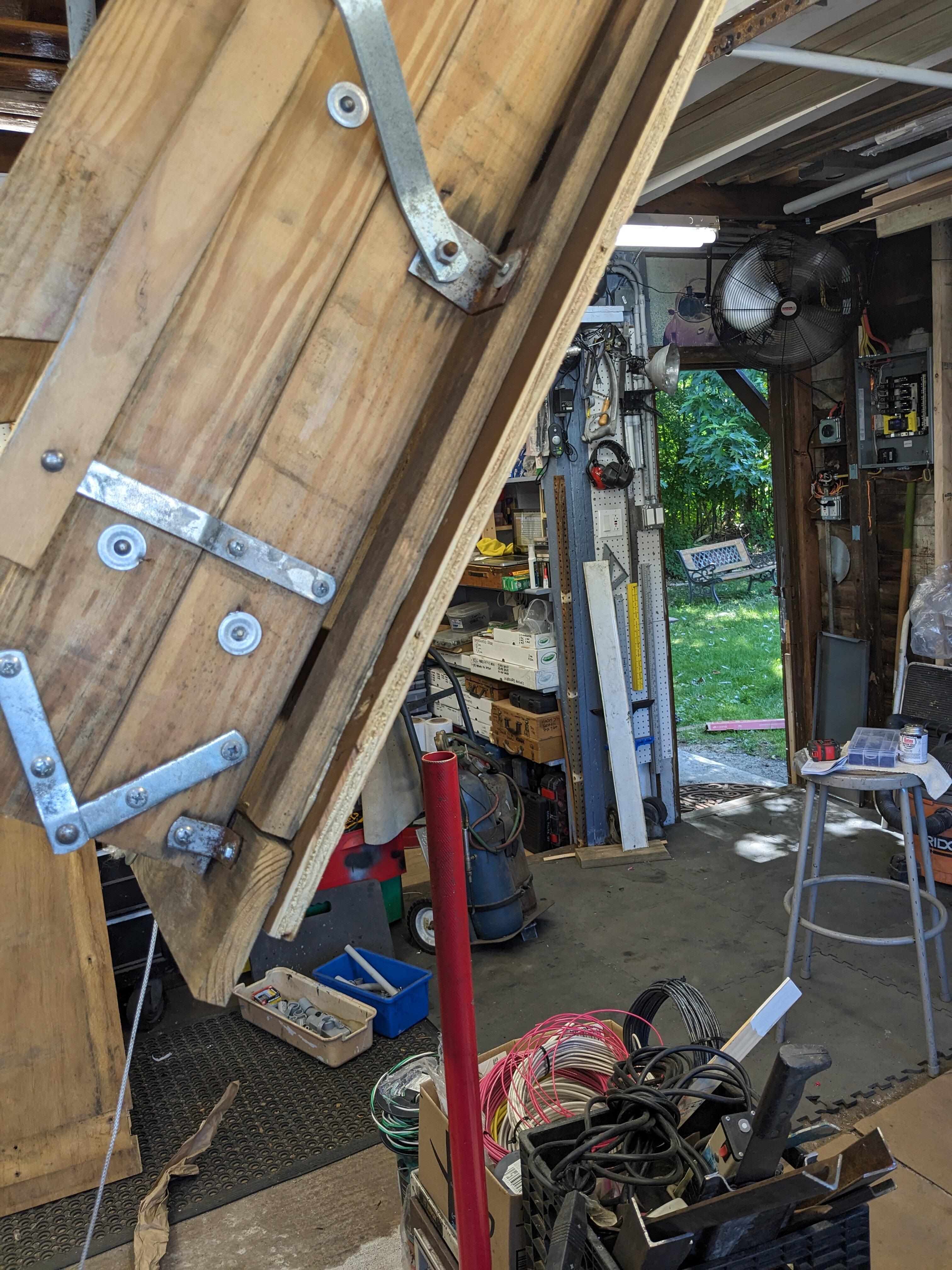

Fixed the base of the attic stairs - old base sheet was 1/4" - I changed it with 3/4" and bonded the tie plates to it. Much more rigid & secure now.

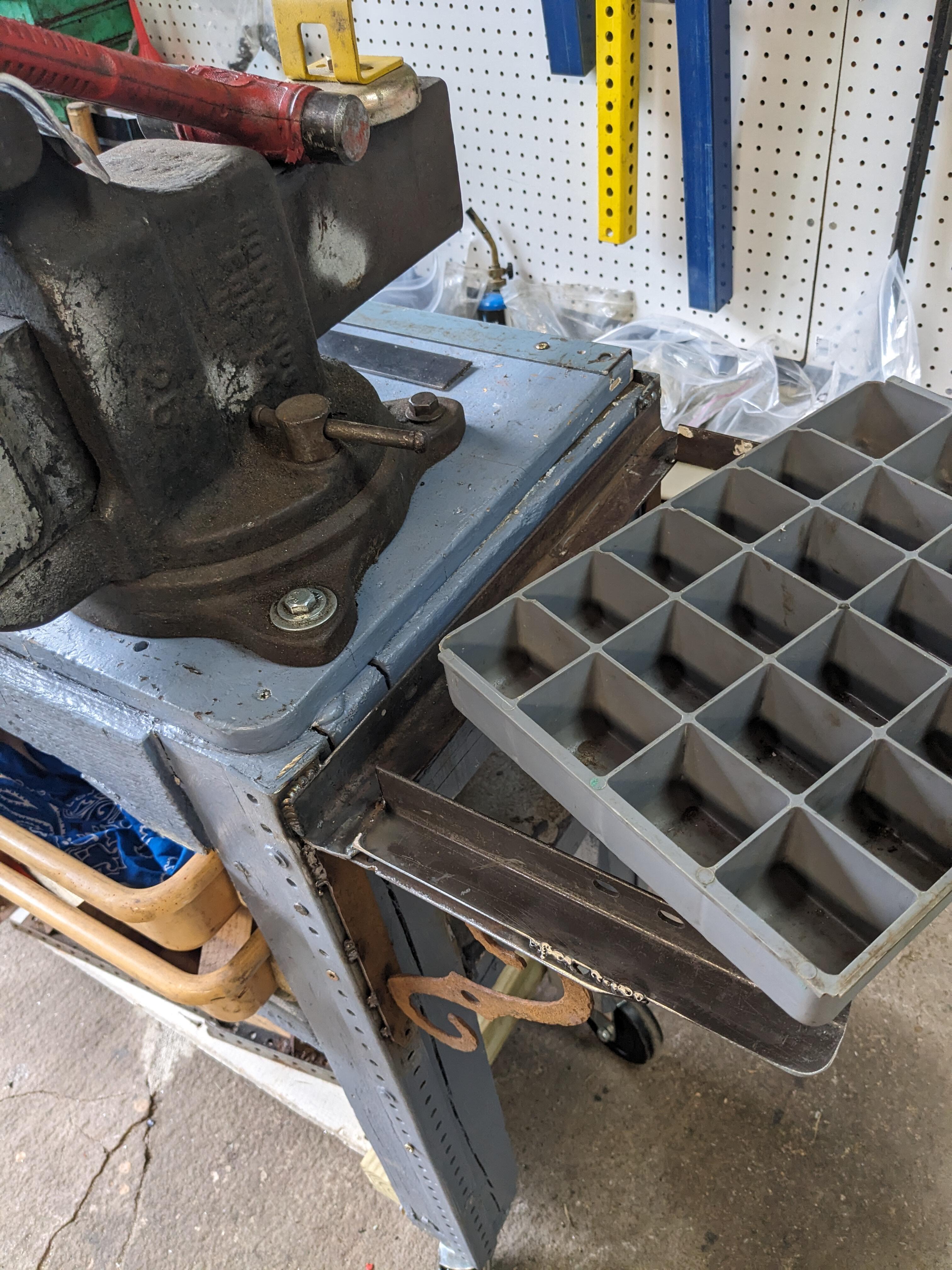

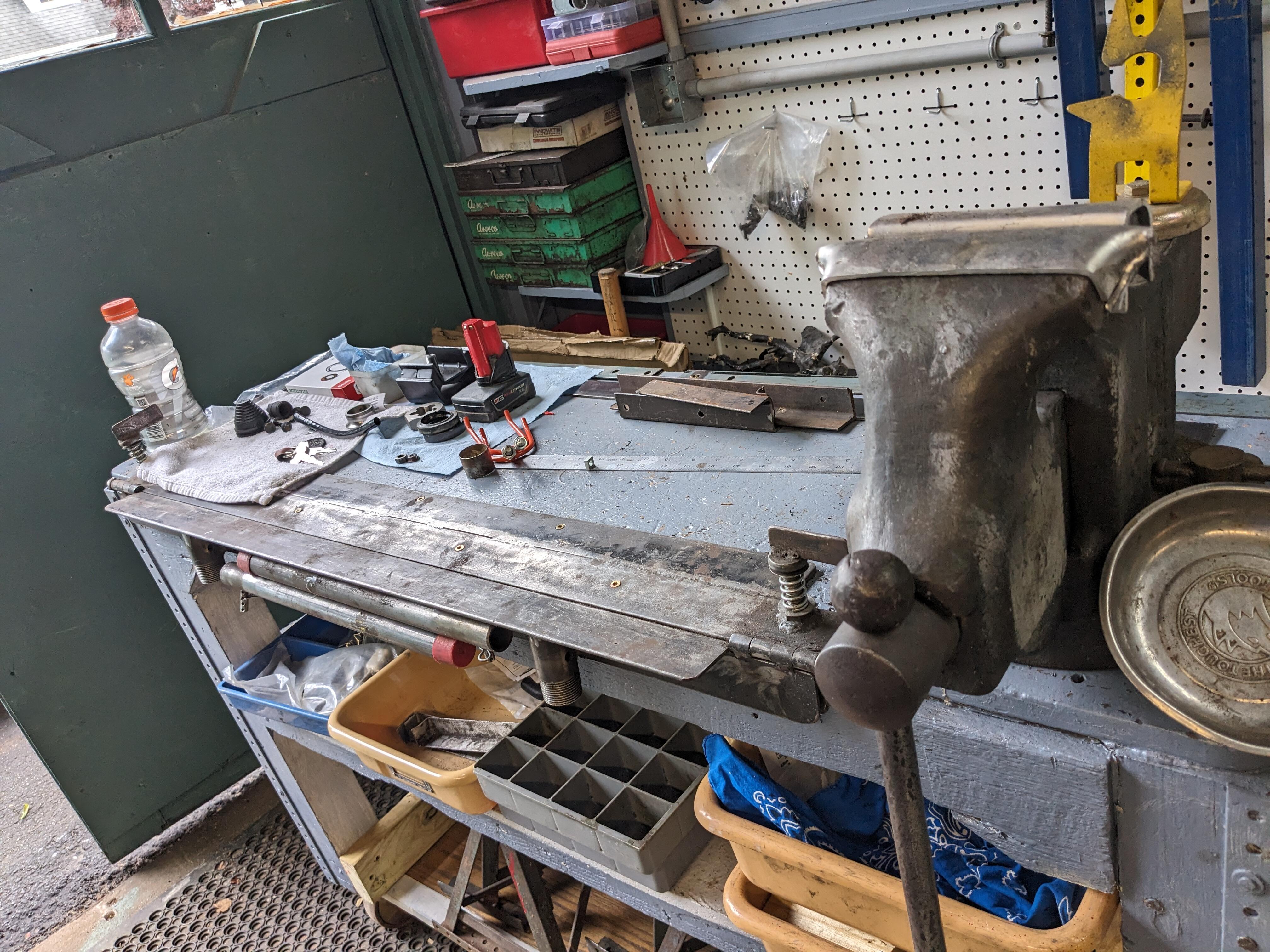

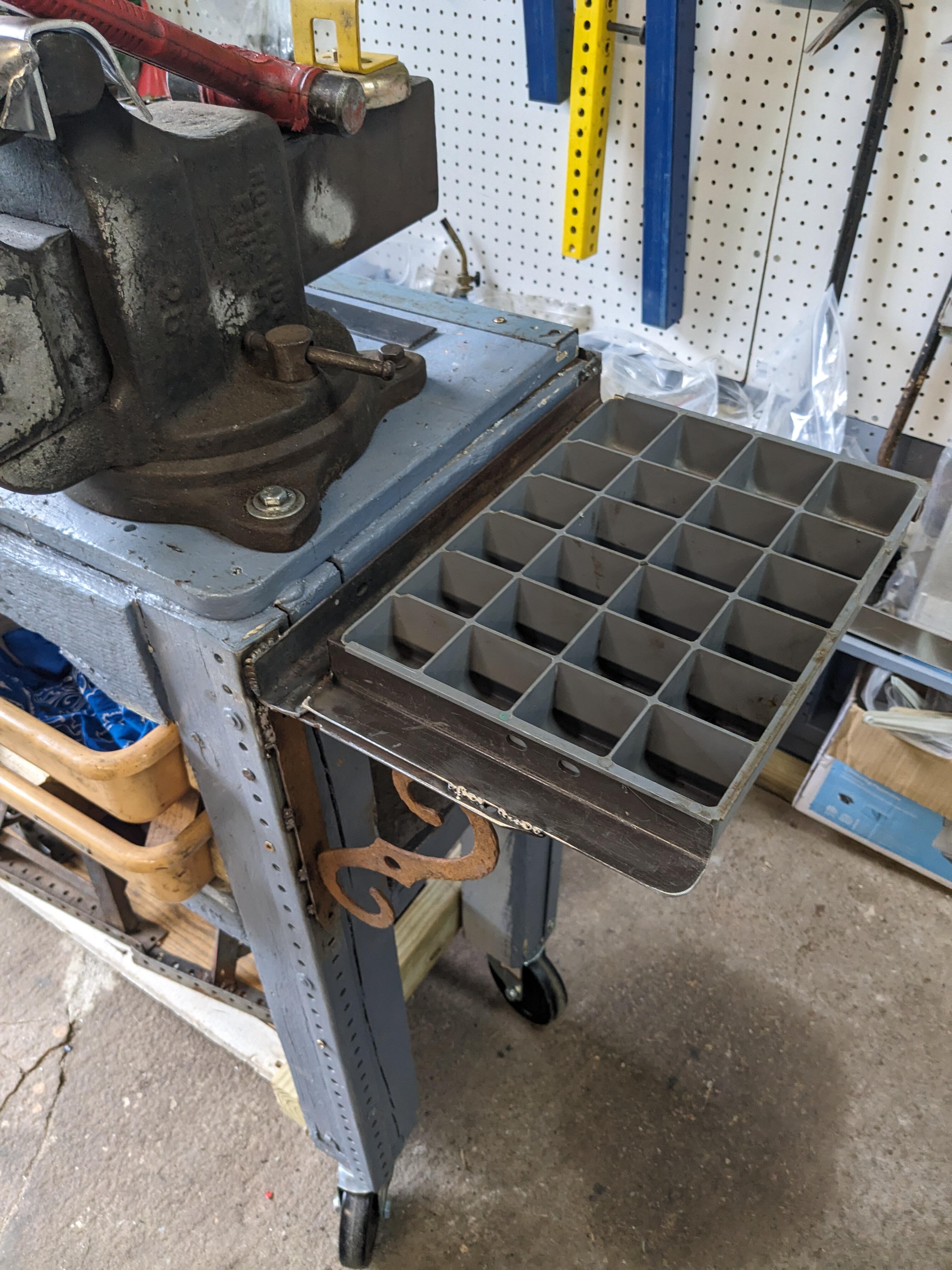

The other thing I'm always missing is a secure place to put the odds & ends I end up working with - I made a frame to retain 3 trays I have  -instead of having to have it in the way on the bench, or under

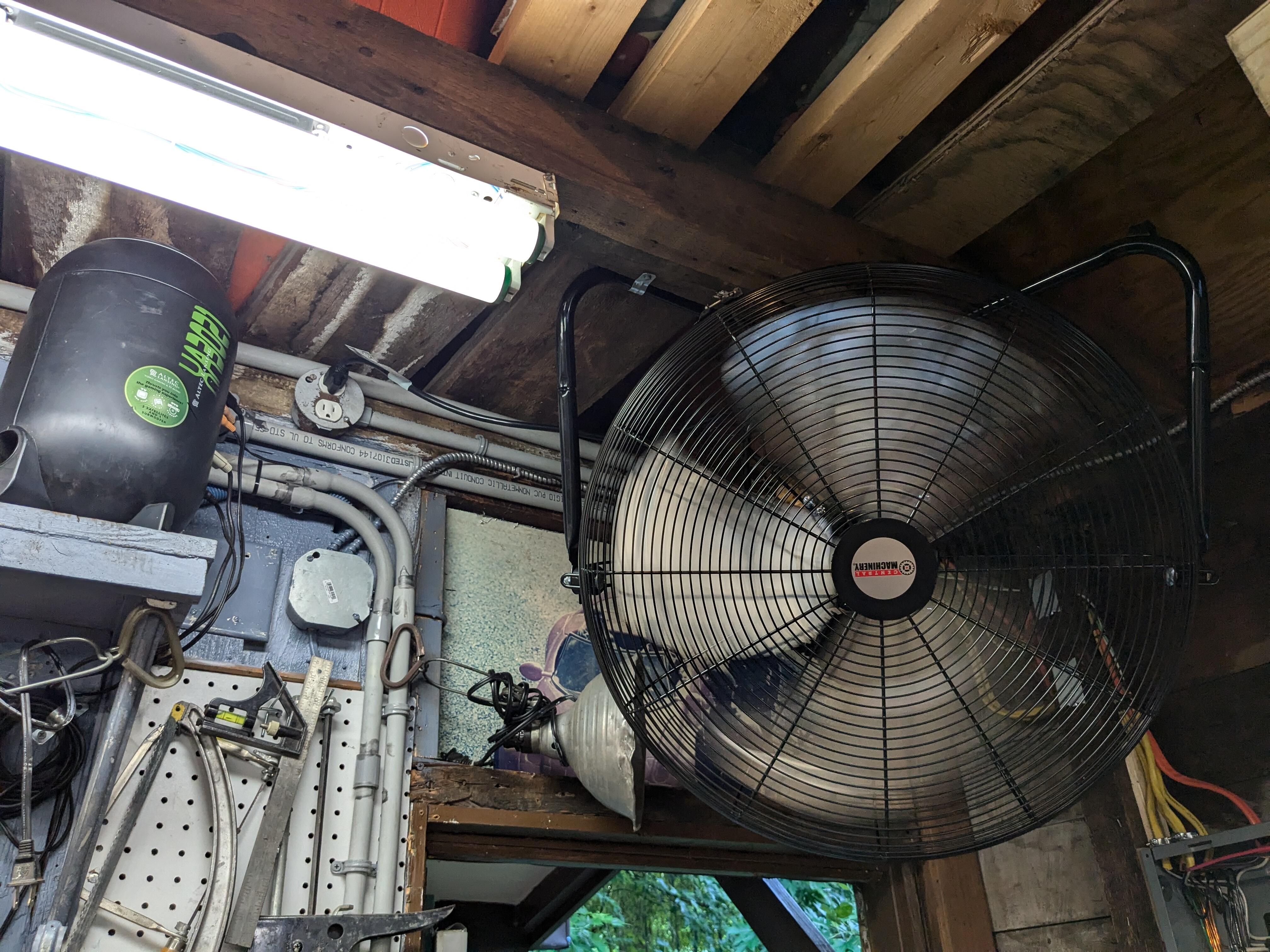

Chipping away at the wiring runs. Added an outlet up high (that I forgot earlier) to plug the fan into

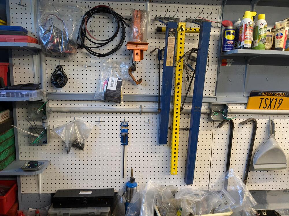

running the 10ga & 12ga in the conduit  along the south wall

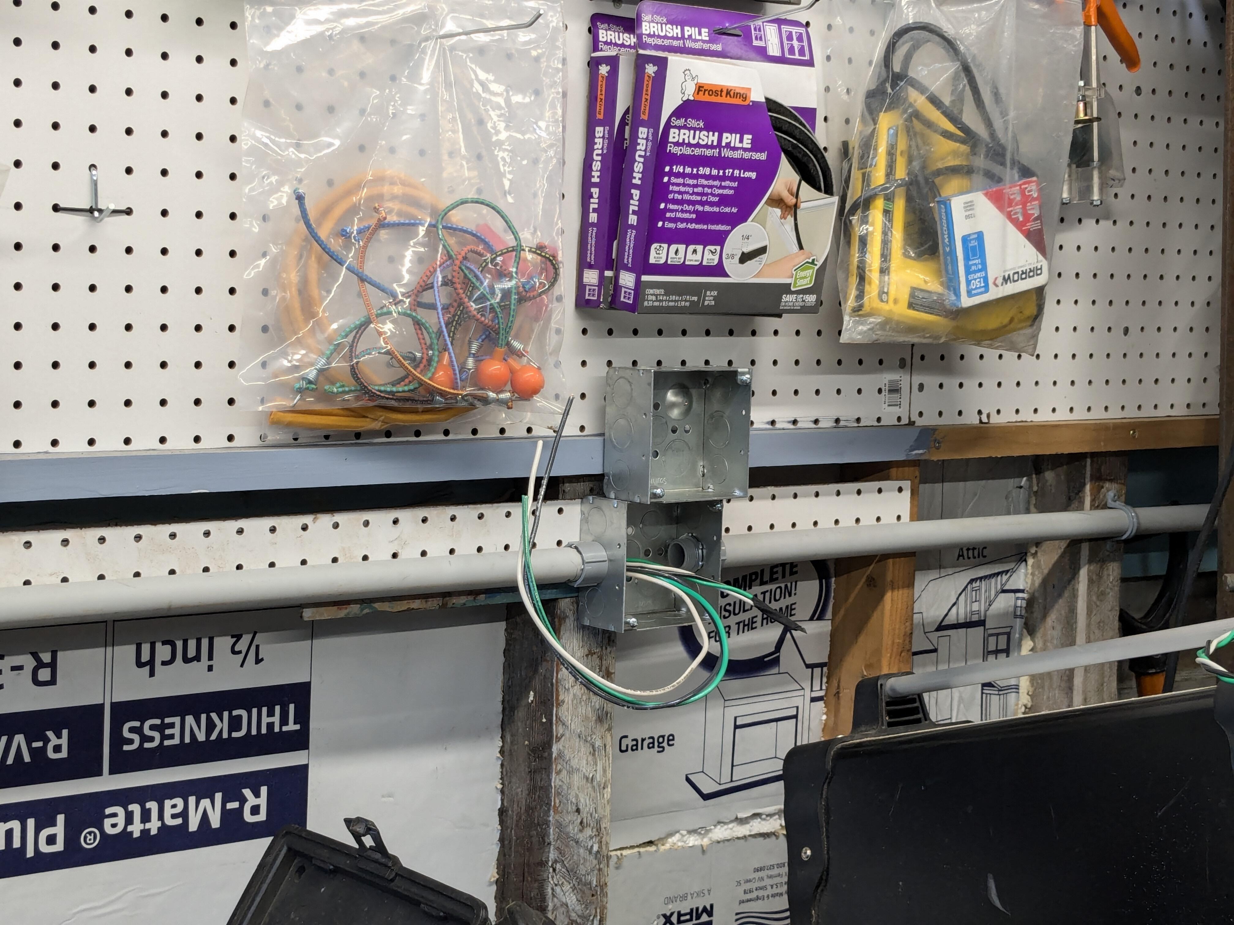

4" deep box sitting above will be mounted below existing for the 240v receptacle, like the East end boxes above, Ran out of 3/4" threaded ends
