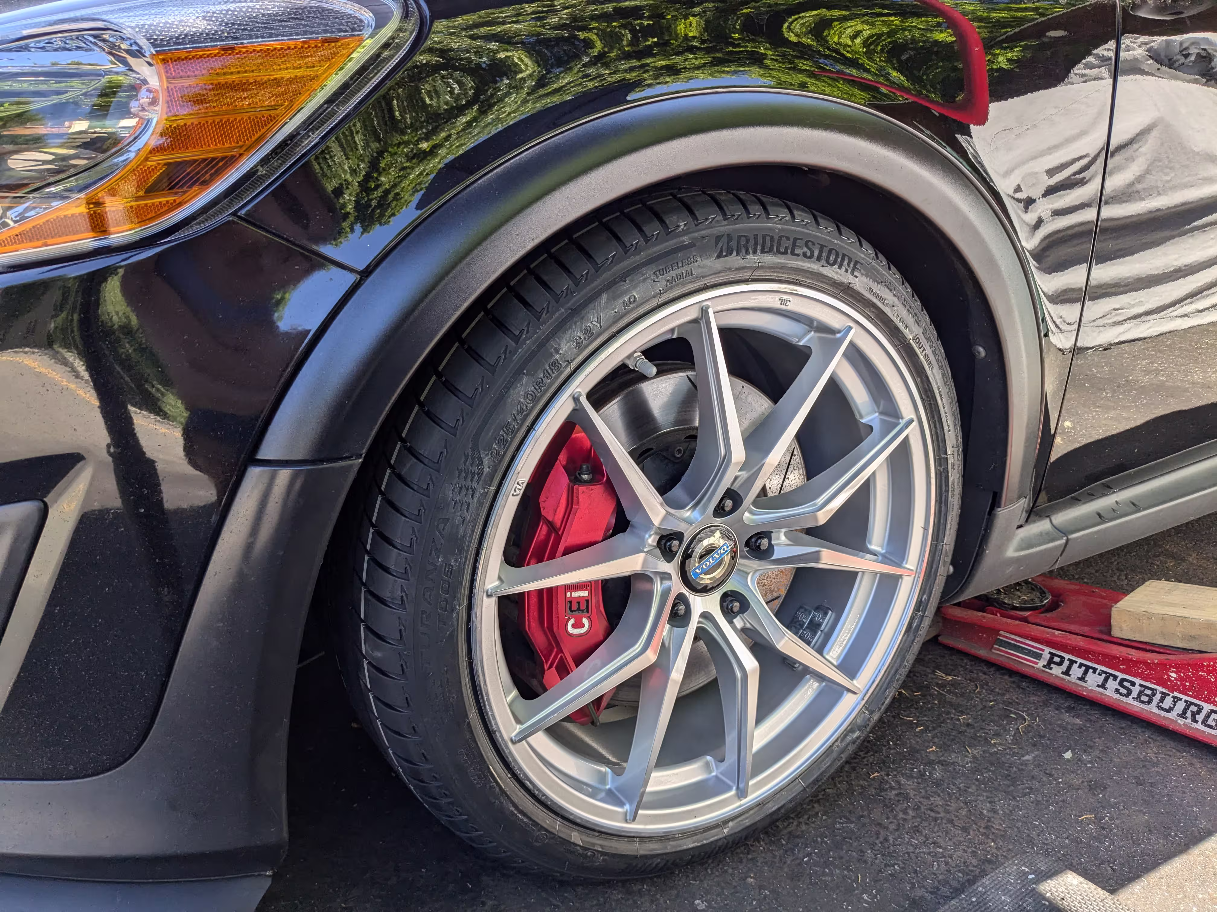

New wheels & 2 new Bridgestone Potenza T005's for the C30 came - so I got those mounted. Need to check the toe
old one
new
temp-Imagesir-QKZ.avif

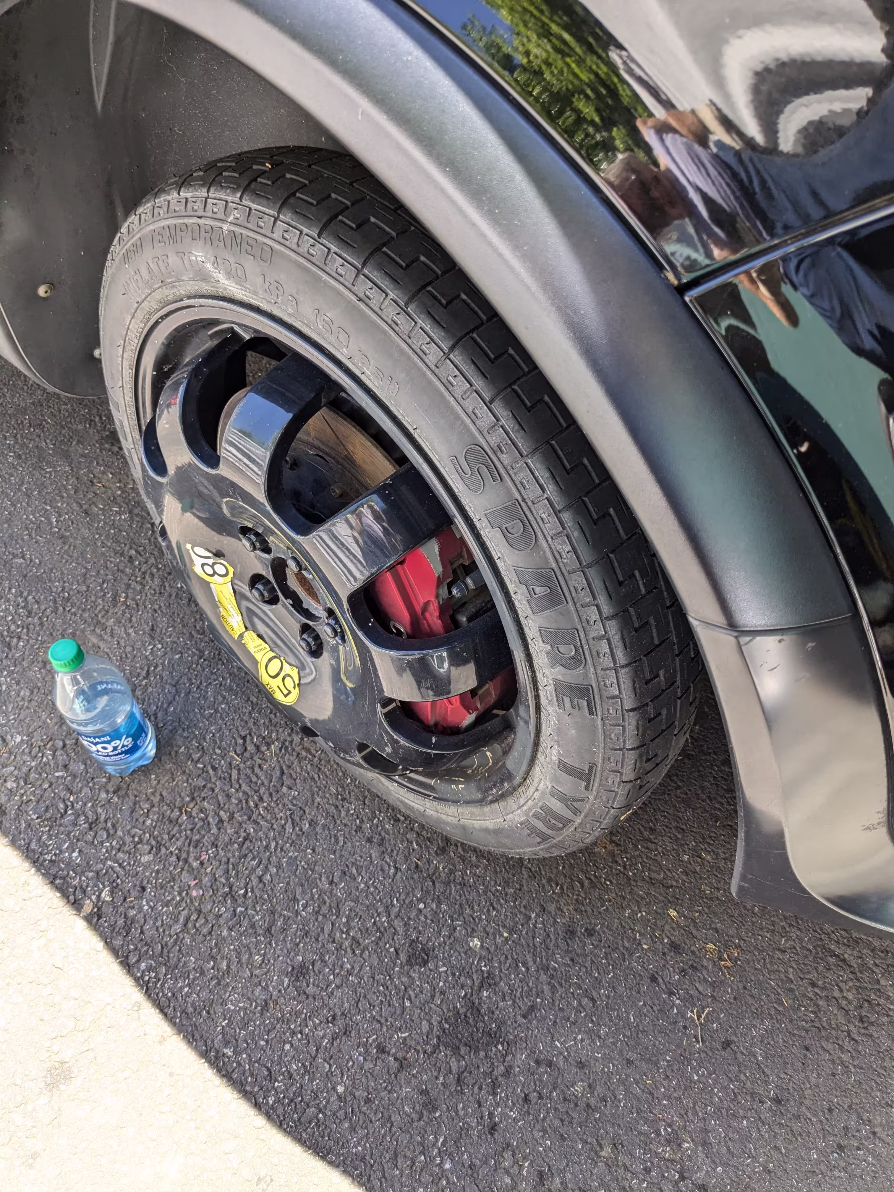

This is what I drove home on last Sunday
temp-Image-Ncrt-TG.avif
