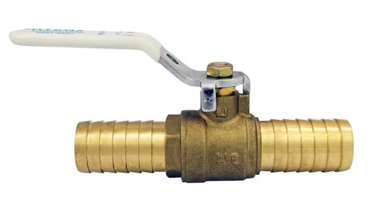

November 20, 20231 yr comment_659638 A ball valve with a cable would work. It would be, in essence, an idle speed control. https://www.homedepot.com/p/Apollo-3-4-in-Brass-Insert-Poly-Ball-Valve-POLYV34/300850934 Link to comment https://www.classiczcars.com/forums/topic/68660-running-lean-76-280z/?&page=2#findComment-659638 Share on other sites More sharing options...

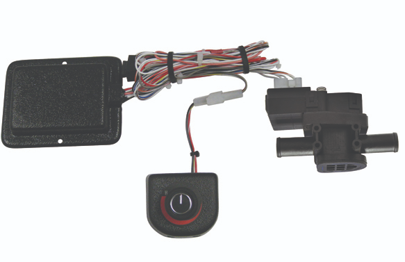

November 20, 20231 yr comment_659640 Or go all the way with a Vintage Air servo controlled heater control valve and adjust idle with a dial on the dash! https://www.vintageair.com/custom/product-pop.php?pn=50507-VUA Link to comment https://www.classiczcars.com/forums/topic/68660-running-lean-76-280z/?&page=2#findComment-659640 Share on other sites More sharing options...
