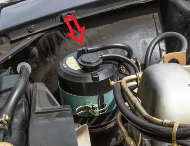

Interesting read. I didn't think my 75 (CA market) had a vented cap of any sort, but since it is described as such here, I looked at the pic I took when I changed the gasket - it does appear to have a valve in the center. I'll have to look under for the check valve - I didn't see any sign of it when I did the fuel pump work. I will be dropping my tank to take care of the vapor hoses (and probably bypass the vent tank). If there's space, I'd also like to add a later charcoal cannister in the back, to free up the bay for when I do the V6 conversion.

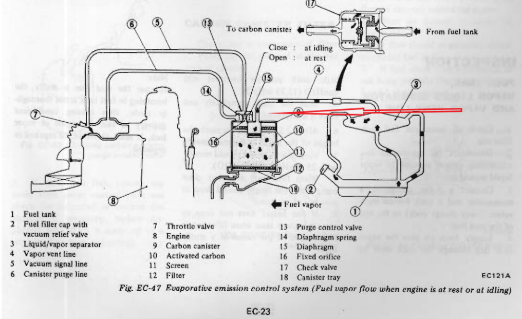

This hit me today.  Why not plug the metal line in the engine bay that comes from the vapor tank into the t-connector that the carbon canister's vacuum actuator outlet ordinarily would plug into?  The vapors would still be going into the intake manifold, just through a different opening.
Since I can't find the gasoline smell location from the vapor tank area, getting the vapor tank venting system working is the next best thing but since my carbon canister doesn't hold vacuum, that's how I came to this.

It's not the canister that holds vacuum it's the cap on the top.  The canister is completely open on the bottom.
It might be that the canister "charcoal/carbon" in the canister is saturated, coated, or clogged.  The basic concpet is that the gasoline vapors enter the pores of the carbonaceous material and stick until they are pulled off by air entering through the bottom.  But the material does not last forever.

Sorry, I should have said the top vacuum operated portion no longer holds vacuum.  Would wiring it that way work?

Go to @Dave WM post and see how he found one I believe off of an older pathfinder that worked. You may find that your issue is back at the tank. There’s a check valve in place back there as well.
I shouldn't be able to smell the gas vapors if it is the tank though since it is isolated from the cabin I'd think.  One of my hoses has to have a rip somewhere but I can't find it.
The frustrating part is the only time I can smell it is when I'm driving or if I blow hard in the charcoal canister metal line...
