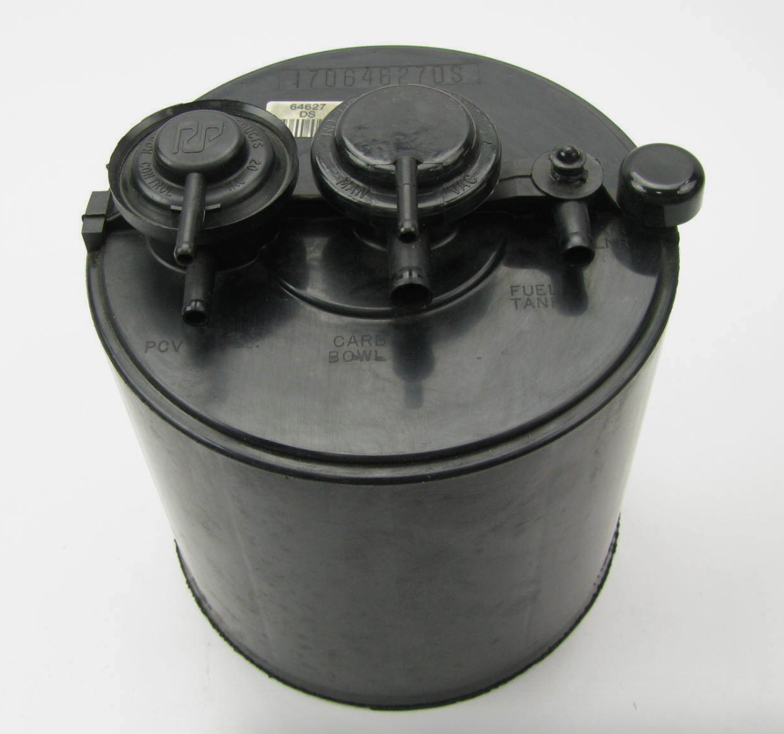

IIRC it was an early 90's pathfinder. direct replacement only difference is the bottom is sealed but for a large port that is just left open. I presume you could run a large dia hose there if you wanted to relocate but that would be totally not needed since the orig was wide open. If you go to a JY to get one just bring along a mighty vac (hand held vacuum pump for bleeding brakes) and make sure the control line will hold a vacuum. As to whether or not this will solve the gas smell I have no idea. It may solve a non funtioning canister if the canister on you car is not working. May is the operative word, as to how it works

Got it - just wish there was a part number or at least an exact year for it.

Regarding the vapor tank.  I was thinking about bypassing it like this which I believe should work.  Getting a T-fitting and plugging one end into the metal tank line, one end into the top of the carbon canister's outlet (the one shown when you pull the vacuum cap off) and plugging the third into the ported vacuum part of the throttlebody.  That is in theory what is happening with the design despite the bespoke line going into the intake manifold.

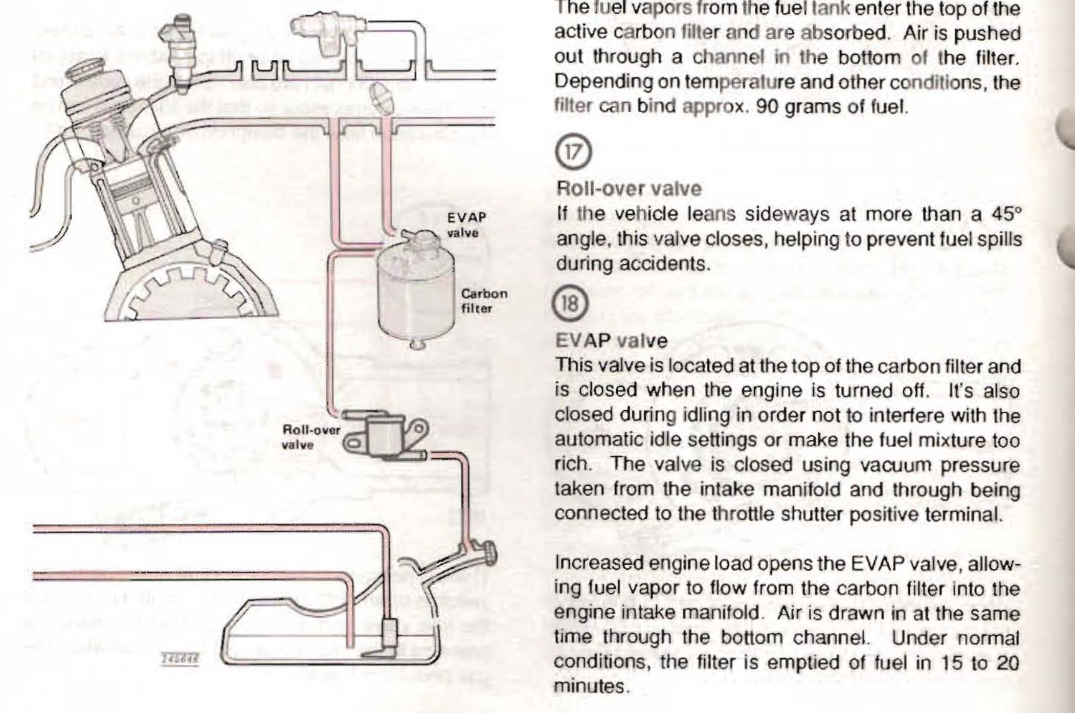

are you sure the metal line back to the tank is not plugged up? mine was rusted solid. You would need to disconnect and blow air thru to confrim. make sure you are only checking the metal line, after the check valve (17). You will see the metal line wrap up along the back of the car to a rubber hose, that is where you want to disconnect it to confrim its clear. The steel lines can rust inside and look fine on the outside, but be completely blocked. On mine I just cut out the metal line that runs along the frame rail, saving the ends (they have a lot of bends that would be hard to duplicate, and the rust was confined to just the low part of the line that runs along side the brake lines), too which I plumbed in some hard plastic line to reconnect the metal ends. works fine. Smells can also come from exhaust esp if the rubber seals around the tail lights and hatch are hard and not sealing.
On more thing IIRC there is a restriction device inside the rubber hose on the line that goes to the canister from the metal tank line. I did not see it listed on the diagram, but it most certainly was there on mine. Just a metal plug with a small bore hole drilled in it pushed down the rubber line a ways at the canister line from the metal tank vent line.

The line should be fine since I could blow through it when it tested everything.  Also in the past I was able to blow through it and have gas fumes be ejected into the cabin so that portion should be good (unless it is only somewhat blocked).

RWD Volvos from 85-98 (240, 740, 760, 940, 960, S90, V90) all use a similar charcoal canister (GM origin) with the same EVAP valve setup.
