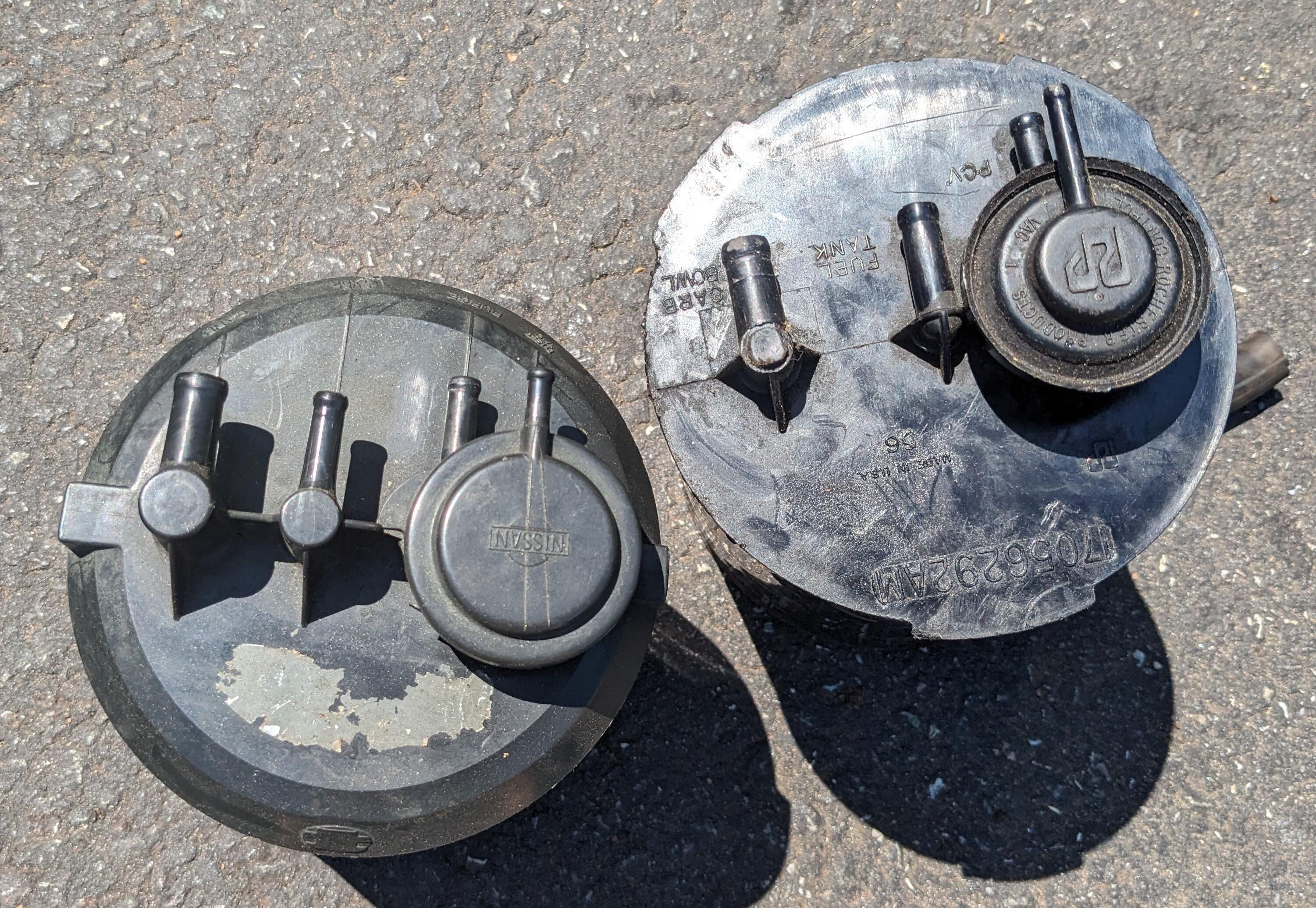

2 hours ago, HusseinHolland said:
Looking a little further online for GM 80's versions - there is this brand new old stock one which certainly could be adapted. It has 2 diaphragms instead of one
eBay listing
Whoa!  You’d adapt it by just capping off the other diaphragm right?
apologies - I didn't see the question - yes, that is what I would do there. EDIT - actually I think you would add a vacuum line. The ports are listed PCV - Carb - Tank, so I think all three would be used. I'd look at a  GM schematic for the model it's intended for.

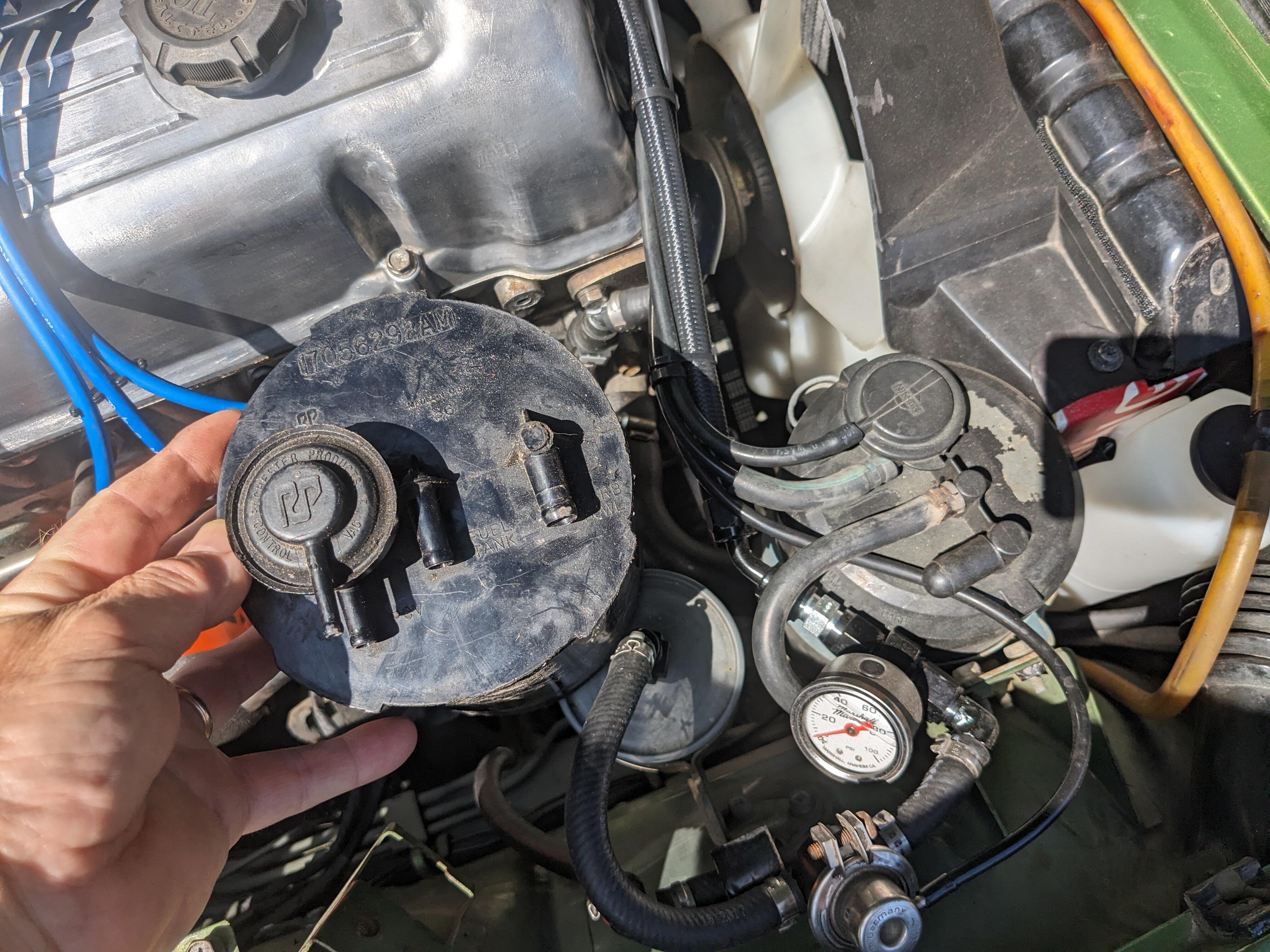

Back on this topic - I pulled out a Volvo Cannister - I was looking at the hose from the vent line on the inner fender to the Cannister, and since it seemed to me there were signs (or rather smells) of gasoline on occasion, I figured I would try the Volvo (GM) Cannister at the same time
Identical fittings on this one - from a mid 90s 960
What I wasn't expecting was actual fuel in that metal vent line coming up the inner fender. When I pulled off the hose there was fuel all the way up at the hose. I presumed fuel vapor of course, but not fuel actually spilling out of the hose. No wonder I could smell gasoline there (given that they were cracks in the hardened hose).
I removed the gas cap and blew back through that hose to the tank to make sure it was clear. It is, so now that it's cleaned out I'll see if fuel accumulates in it as time goes by. Seems odd to me.

Posted (edited)
5 hours ago, chaseincats said:
Wow, did you give it a shot?
Hmm... somehow I forgot to take the pic AFTER I installed it 🤪.  I'll drive it around some tomorrow. The main thing I'm curious about is the fuel in the tank vent line.

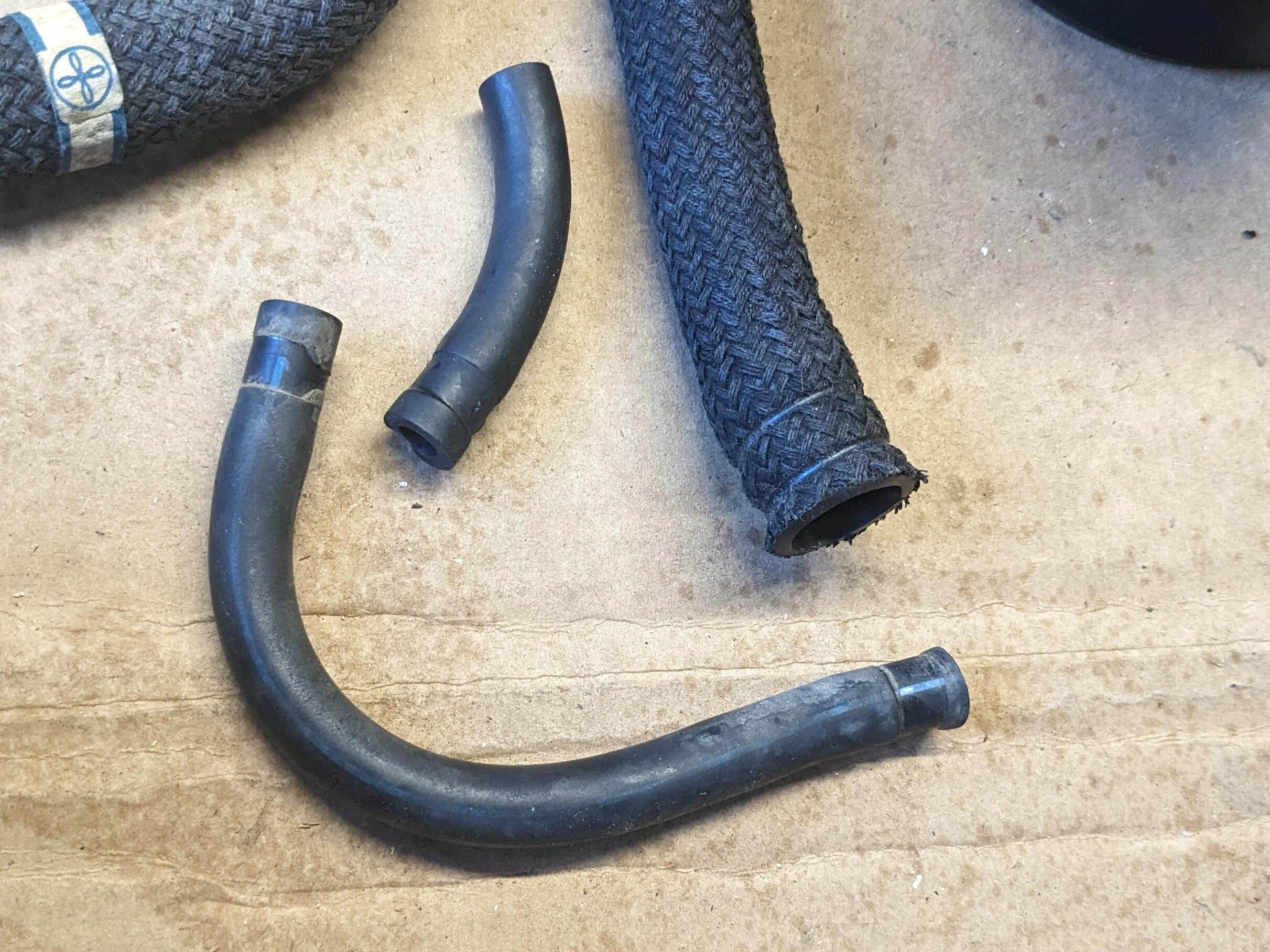

So at the end of the day, here's what I did:
- pressure tested all of the hoses/vapor tank (by taking them all off and blowing in one end while plugging the others with hands/fingers
- replaced all of the original style clamps to gates belt clamps
- replaced the short hose that makes a u-turn on the filler neck (no idea why this exists)
- cut the ends of all the hoses off so they have a new tighter fit on the vapor tank
- cut about 6 inches off the main large hose that comes out of the gas tank and bought some new hose, then joined the two with a plastic joiner (a straight piece that you cram both hoses on.  Reason being that the hose held air when straight, but when curved (needed to plug in to vapor tank) there were small cracks
