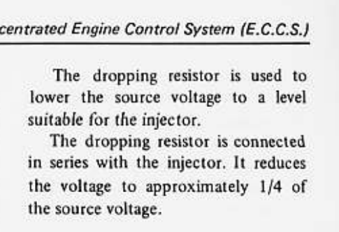

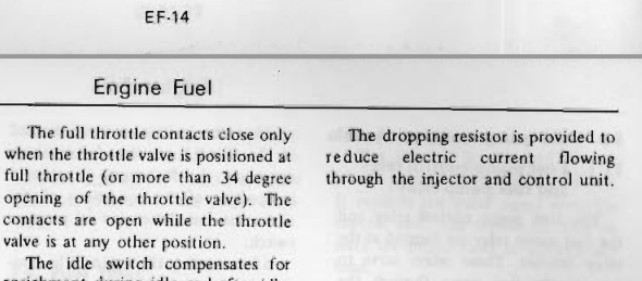

On the 280Z EFI engines Nissan stopped using the dropping resistors in 1982, for both EFI and ECCS engines, according to the FSM's.
The FSM mentions current and voltage protection, but the injector solenoid coil is essentially the same as any relay coil.  Seems like protection would be more for the ECU.  Of course, current and voltage are related.  A resistor won't lower voltage unless there is current.  So, in terms of "breakdown" voltage, it seems to be a wash.  Must be a current issue.  But the injectors are cooled by gasoline.  Just some random ramblings...
1981 Turbo Supplement
1978 EFI.  Current and ECU -
