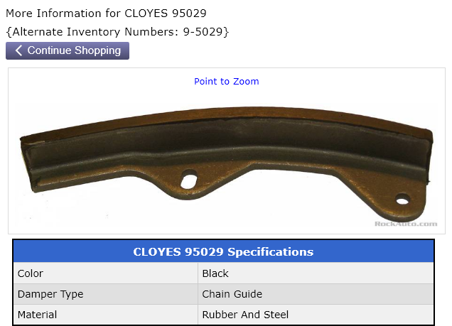

November 12, 20231 yr comment_659338 6 hours ago, Jeff G 78 said: I'm guessing that the combination of an old chain and gears, worn guides, a 1mm head gasket, and a milled head have added up to WAY too much stick out. I'm thinking the same thing. Stackup of a whole bunch of things. So I test fitted my .040 shaved head and I still had too much stickout even with a whole new timing set. Even with filing the slot longer on the slack side guide wasn't enough to bring the tensioner back to home. I'm surprised you were able to do a simple slot lengthening with your .050 off and ended up with the tensioner all the way in. With my guide, there wasn't sufficient extra meat on the edge the guide to file the slot as long as it need to be. Maybe your guide was a different brand than what I used? I eventually had to take some more extreme measures with the guide. I'll post pics when I get a chance. Link to comment https://www.classiczcars.com/forums/topic/68671-timing-chain-tensioner-extended-too-much/?&page=3#findComment-659338 Share on other sites More sharing options...
November 12, 20231 yr comment_659340 7 minutes ago, Captain Obvious said: I'm thinking the same thing. Stackup of a whole bunch of things. So I test fitted my .040 shaved head and I still had too much stickout even with a whole new timing set. Even with filing the slot longer on the slack side guide wasn't enough to bring the tensioner back to home. I'm surprised you were able to do a simple slot lengthening with your .050 off and ended up with the tensioner all the way in. With my guide, there wasn't sufficient extra meat on the edge the guide to file the slot as long as it need to be. Maybe your guide was a different brand than what I used? I eventually had to take some more extreme measures with the guide. I'll post pics when I get a chance. Here is mine after the new timing set with 0.050" milled with a FelPro head gasket. Notice the slot on the top of the guide. There was about 1/4" of stick out with the used timing set. Link to comment https://www.classiczcars.com/forums/topic/68671-timing-chain-tensioner-extended-too-much/?&page=3#findComment-659340 Share on other sites More sharing options...
November 12, 20231 yr comment_659356 10 hours ago, Jeff G 78 said: Here is mine after the new timing set with 0.050" milled with a FelPro head gasket. Yeah, that looks a whole lot better than mine did when I mocked it together. I put mine together with a used FelPro head gasket so there was a little bit of crush there, but I also had my head cut .010 less than you did. In any event, if mine looked like that after just opening up the adjustment slot, I would have been good with that. Maybe there are just differences between manufacturers of chain guides. Link to comment https://www.classiczcars.com/forums/topic/68671-timing-chain-tensioner-extended-too-much/?&page=3#findComment-659356 Share on other sites More sharing options...
