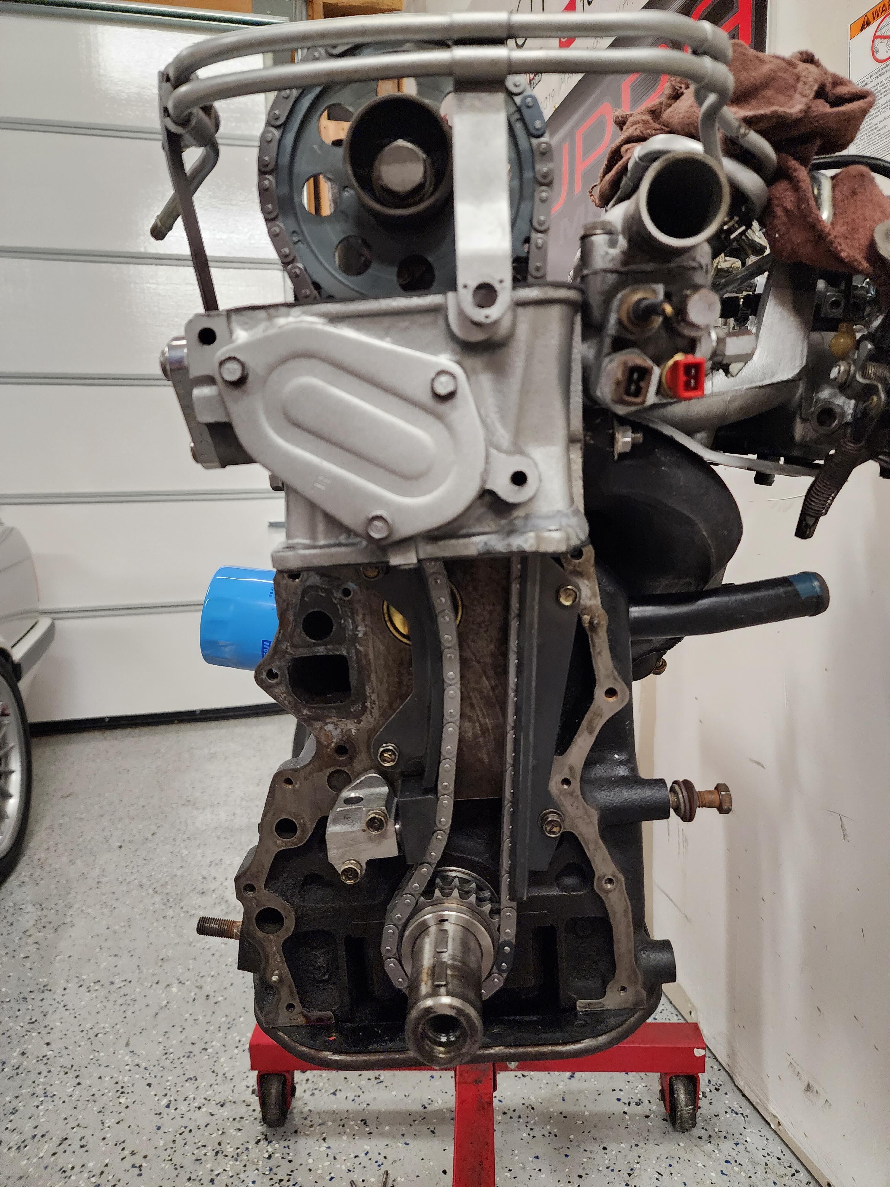

Little update, called the machine shop and they said they removed only about 0.003-0.004 inch when shaving the head since mine was relatively straight and I didn't specify how much to remove so they removed as little as possible. Gives me a little more confidence my chain is just extremely stretched and a new one should solve it
This should make you feel better.  I found the picture of mine before I installed the new chain kit.  Notice how much stick out I had.  The only change was replacing the chain, gears, guides, and tensioner.
That looks about as similar to what I have now. That brings a lot of extra relief to me haha. Thanks for sharing. Will share pictures tomorrow of my results.

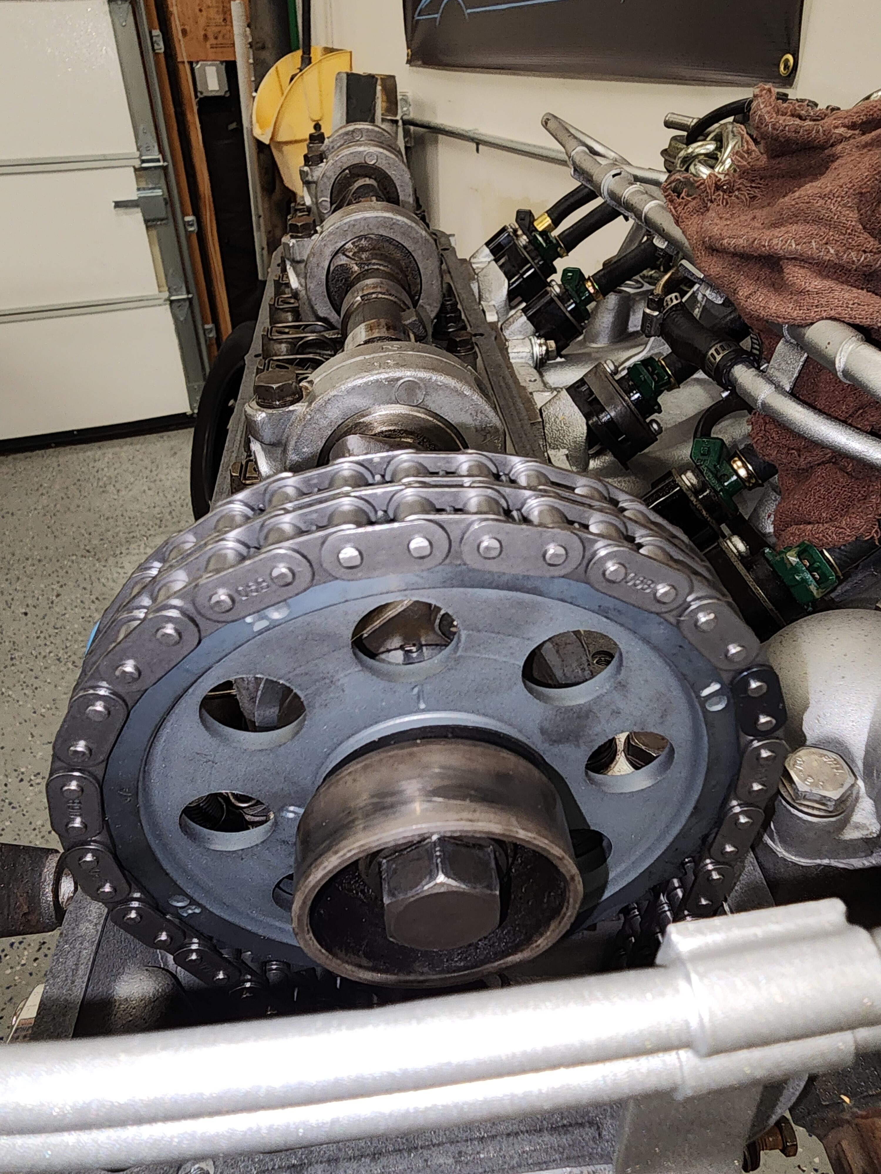

6 minutes ago, Captain Obvious said:
Looks way better!
So I can see the timing mark on the cam sprocket. Using position 1 (which makes sense with new timing components), but I can't see the mark on the crank gear. Are you positive sure you got the timing marks correct?
100% positive, the timing chain is covering the timing mark on the crank gear but I made sure it was on the mark with the darker link in this timingchains case. For the most part to my knowledge too, the crank gear dimple can only be in one general area with the engine at tdc which is where the darker link is in combination with the cam gear.
4 minutes ago, Captain Obvious said:
Perfect. Then throw the front cover on and fire that thing up!!    :excl:   Haha!
