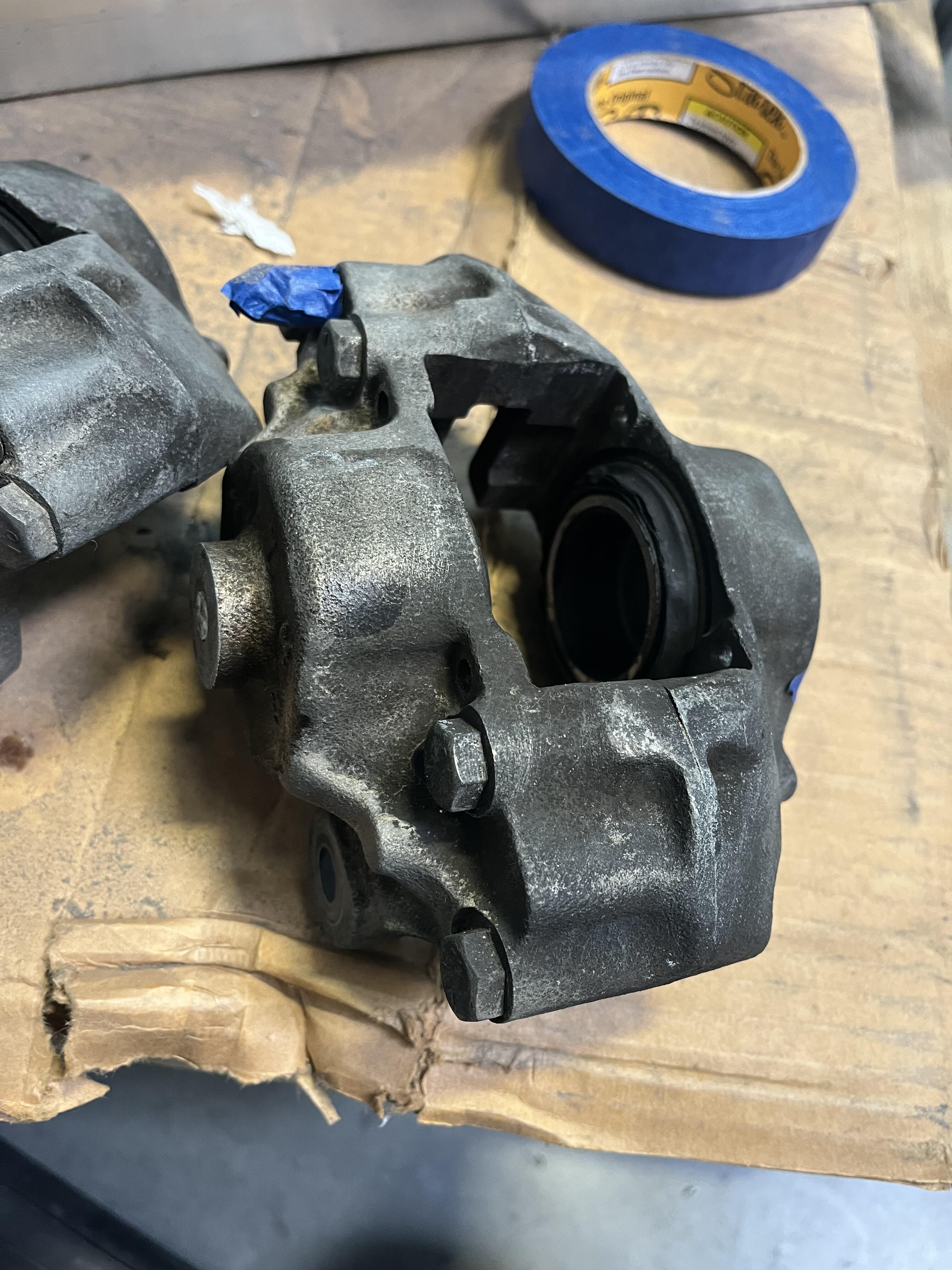

I'm rebuilding my 77 280z brake calipers and plan on blasting and painting them. What was the original color? I'm seeing both silver (or raw casting??) and black when doing a google image search.  It's not a huge deal, but I figure I'll try to make them look original if possible.

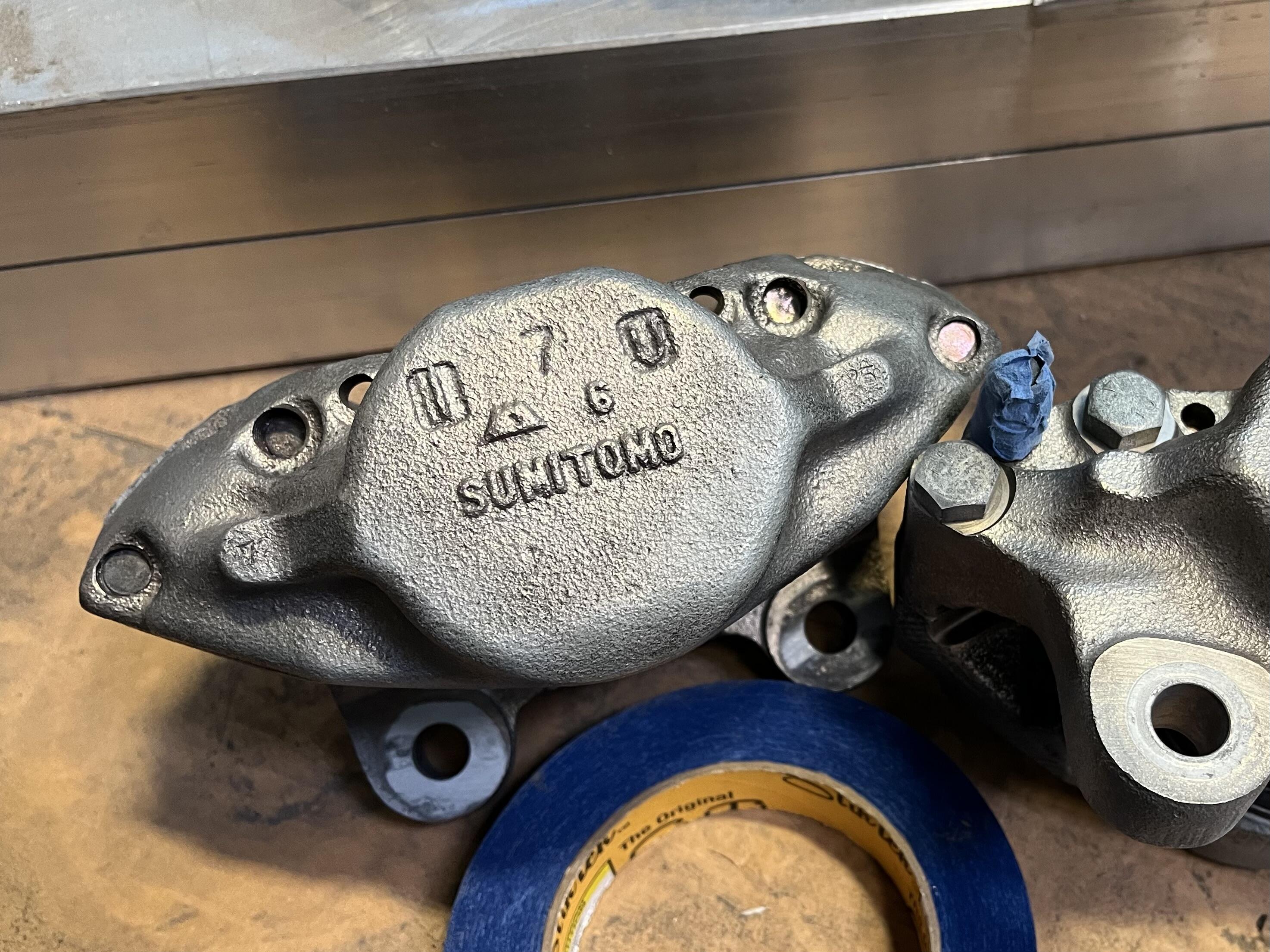

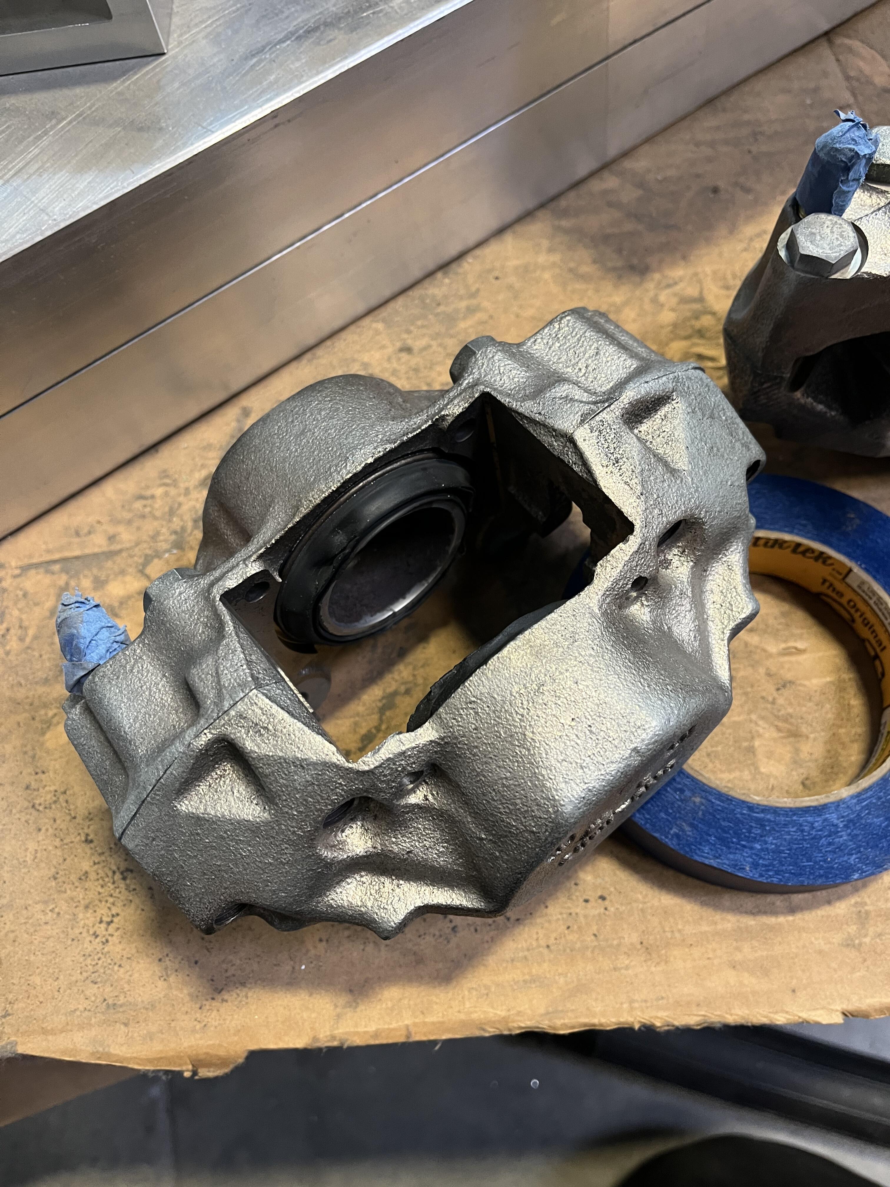

Well I blasted them and they look pretty good raw so I think I'll leave them like this. I'm attaching some before/after pics. Thanks for the quick replies everyone! I left piston/seals in place so I didn't have to mask the bores. I'll replace all that stuff tonight when I rebuild.
56 minutes ago, siteunseen said:
That looks really good. Maybe a flat or matte clear spray would keep them looking good for a long time?
Yeah they cleaned up nicely. Either a coat of clear or even some wax spray. This was just a quick and dirty blasting-- I would probably need to do a little better job blasting and then solvent clean them really well to get a good surface for paint.

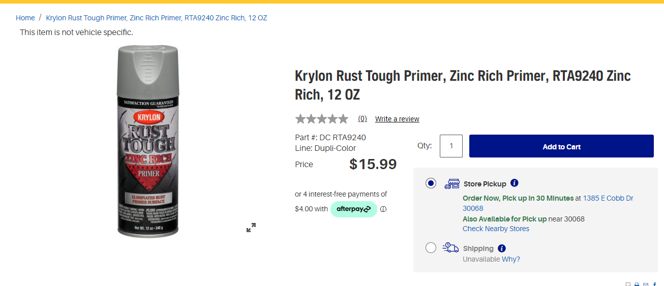

While a primer only, this would be better than bare, and to my eye, looks like the factory finish.  Maybe buy a can, and if you don't use it for the calipers, ultimately, it is a very good primer.
