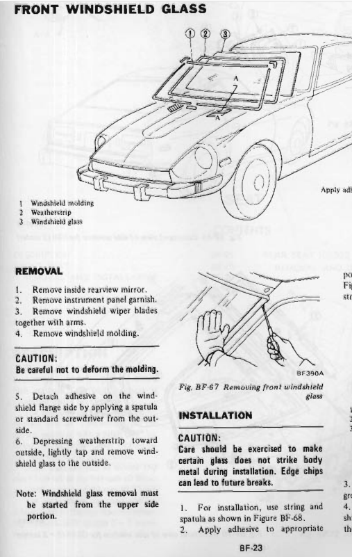

I was incorrect.  Apparently Nissan says the molding is removable separately.  I must have seen comments from the internet instead.  I'm sure it's much easier with newer still flexible rubber.
Here's 1978.  "Be careful not to deform the molding".  They knew.
Zed Head, My FSM page BF23 is completly different than the one you posted above. It only refers to interior trim and no mention of removing the windshield trim. I'm glad you found this info in your FSM. I probably would have had a problem with this new advice.

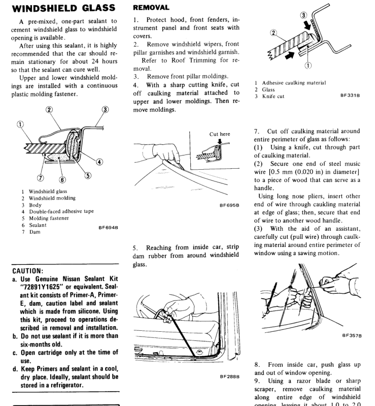

Eèèhhmm..  A 280z and a 280zx are completely different..  A 280z has a rubber all around the windshield like a 240z has.. A 280zx windshield glass is glued to the car..
It's much modern way to place the glass, it's part of the construction now.

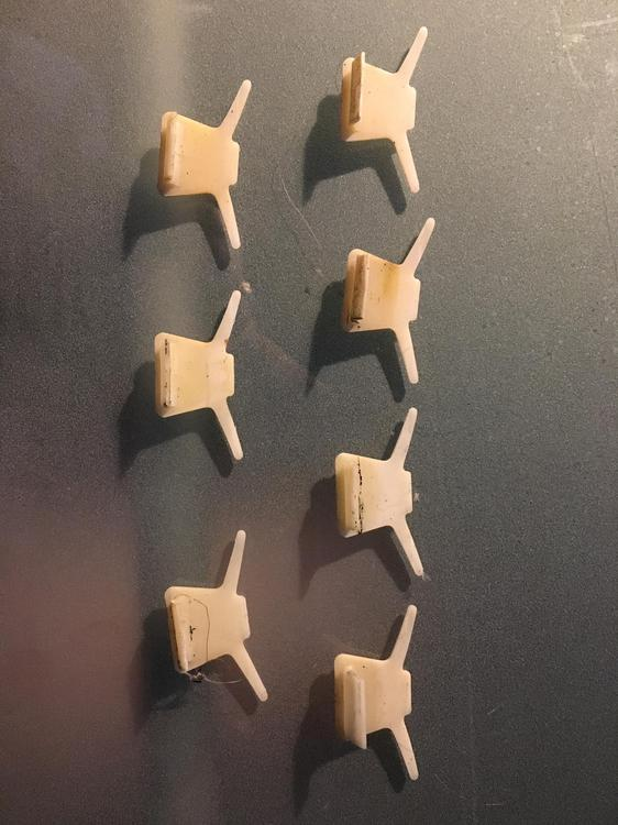

In picture BF694B You see the things you need.. As these parts are no longer available you can use the today's much better sealant. What you need to save from the old window are the parts i send you a picture of in #5 .. They hold the chrome strips on theire place. If they are broken too you can use some sealant there as well but when you need to replace such windshield it's a pain in the **** to replace..
