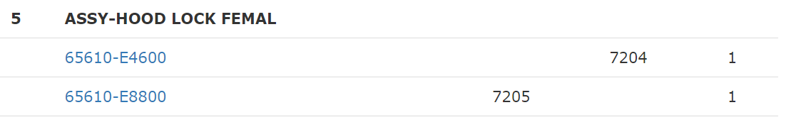

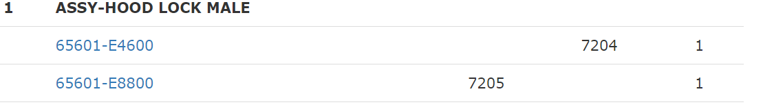

December 6, 20231 yr comment_659968 The hood latch male and female parts did change one time as of 05/72 and was the same for all following years S30's, the female receiver change is at the safety latch catch location. The male portion of the safety latch received a second spring at that time. The spacing on my car with the early latch receiver matches that of your 05/71 car. I'm still thinking through why your latch is binding when you pull the release. Link to comment https://www.classiczcars.com/forums/topic/68704-correct-hood-latch-early-74-260z/#findComment-659968 Share on other sites More sharing options...
