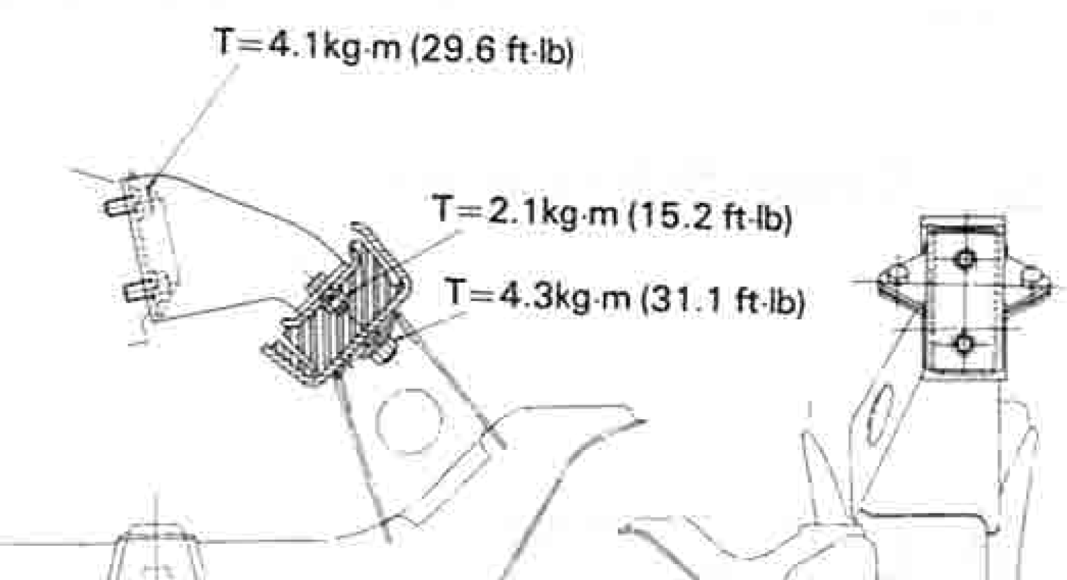

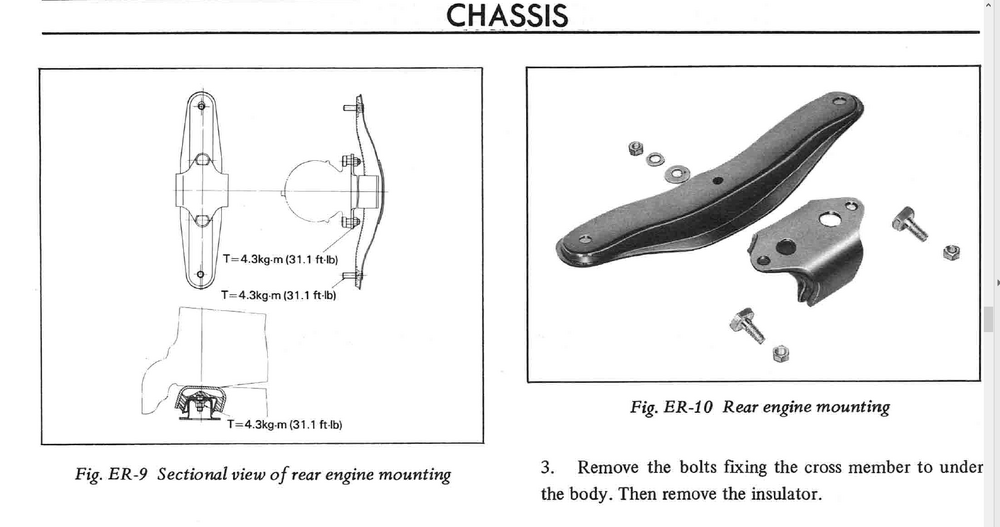

For the bolts that mount the brackets on the sides of the engine to the motor mounts, do the bolts go in from the top or the bottom?  A picture or two would be wonderful please.  My son and I are planning on putting the engine and tranny back in the car tomorrow (Sunday) morning.

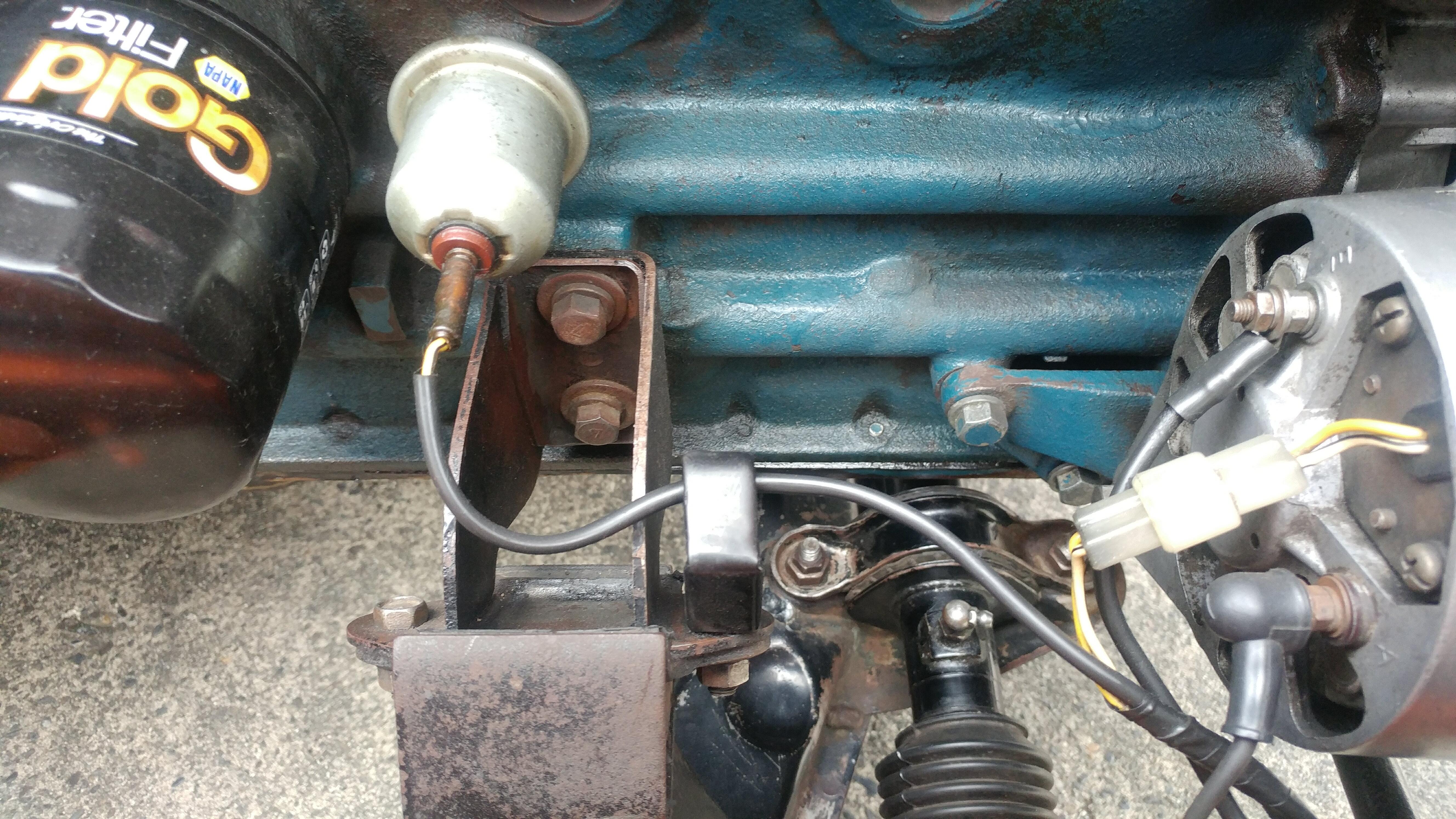

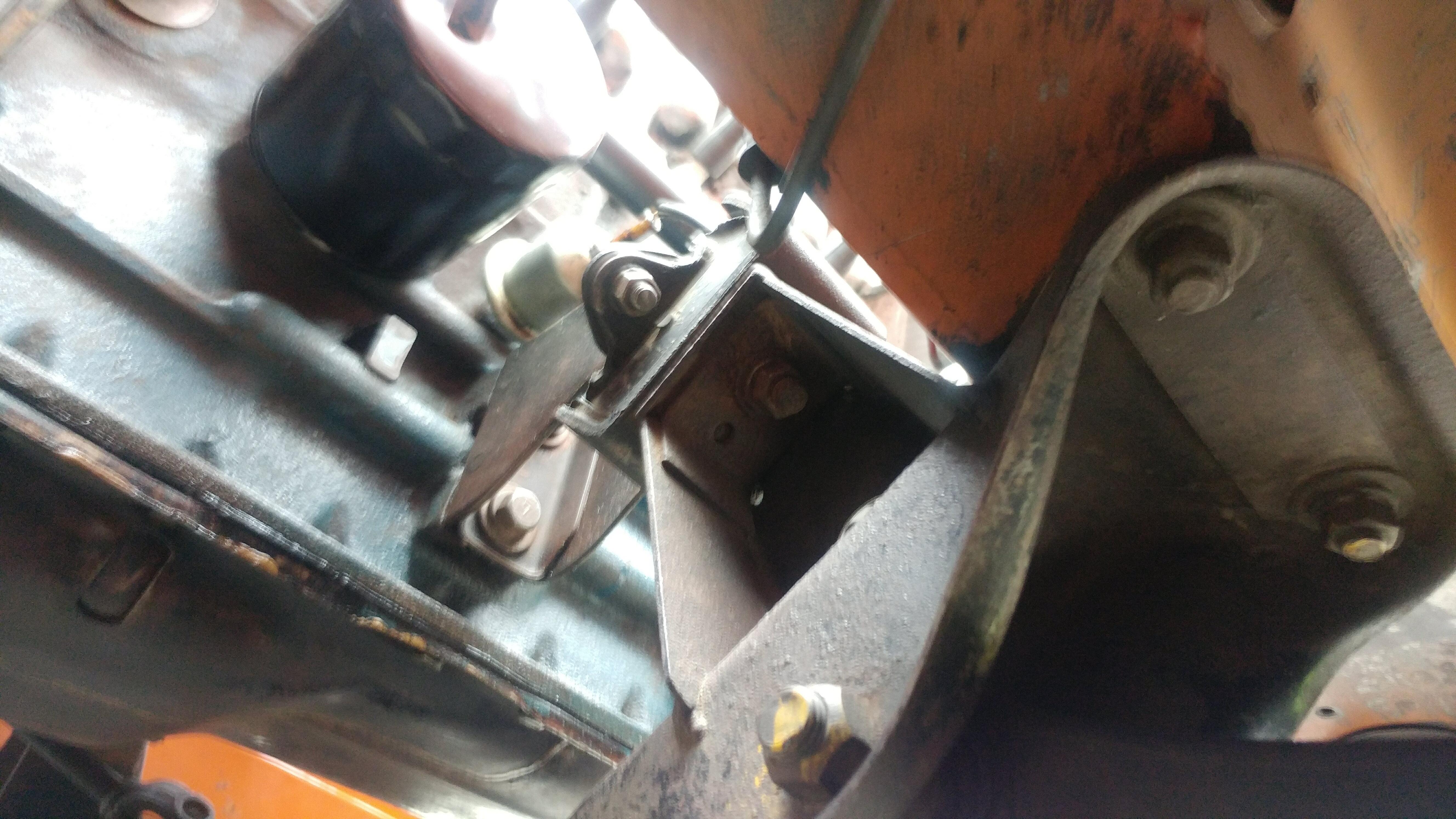

It went really well, easier than expected.  I've pulled 4 or so engines over the years, never put one in so this was the first.  All said it was under 3 hours to get it in and all fasteners cinched down.  We spend the rest of the day working on some of the smaller things like the front bumper, fan, drive shaft, etc.  Here are a few pictures.
