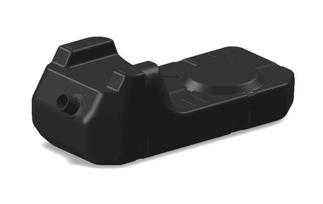

Well the 510's are easy. Lots of room above the tank. Not so much on Z's. If you want to mount the pump in the top of the tank, there is no or very little room between the floor and tank top, and you have to cut a wee hole in your deck then come up with a way to cover it. Then put up with a lump back there for ever more. Not perfect.
Well until Vintage Tanks just announced a new product.
https://www.vintagetanksolutions.com/product/1970-1976-datsun-240z-260z-280z-poly-fuel-tank-for-in-tank-retrofit-fuel-modules
This is the "right" way to do for sure. They provide you a recessed area to mount the pump and sender flange. and its still 16 US gal. Slick.
The bad news of course is the cost. $800 USD plus shipping exchange, duty etc. Usually works out to double that in CAD by the time it gets to me. Ouch.... Customer project or not.
SO.....   This crazy Canuck wants to to make a recessed area on the top of the stock tank to accomplish the same thing. Just a little fabbin' and cuttin' and weldin' and BOOMin' and screamin' and scrapping Canuck body parts off the shop wall. Right?  Though shall not weld a fuel tank, pretty basic knowledge.
