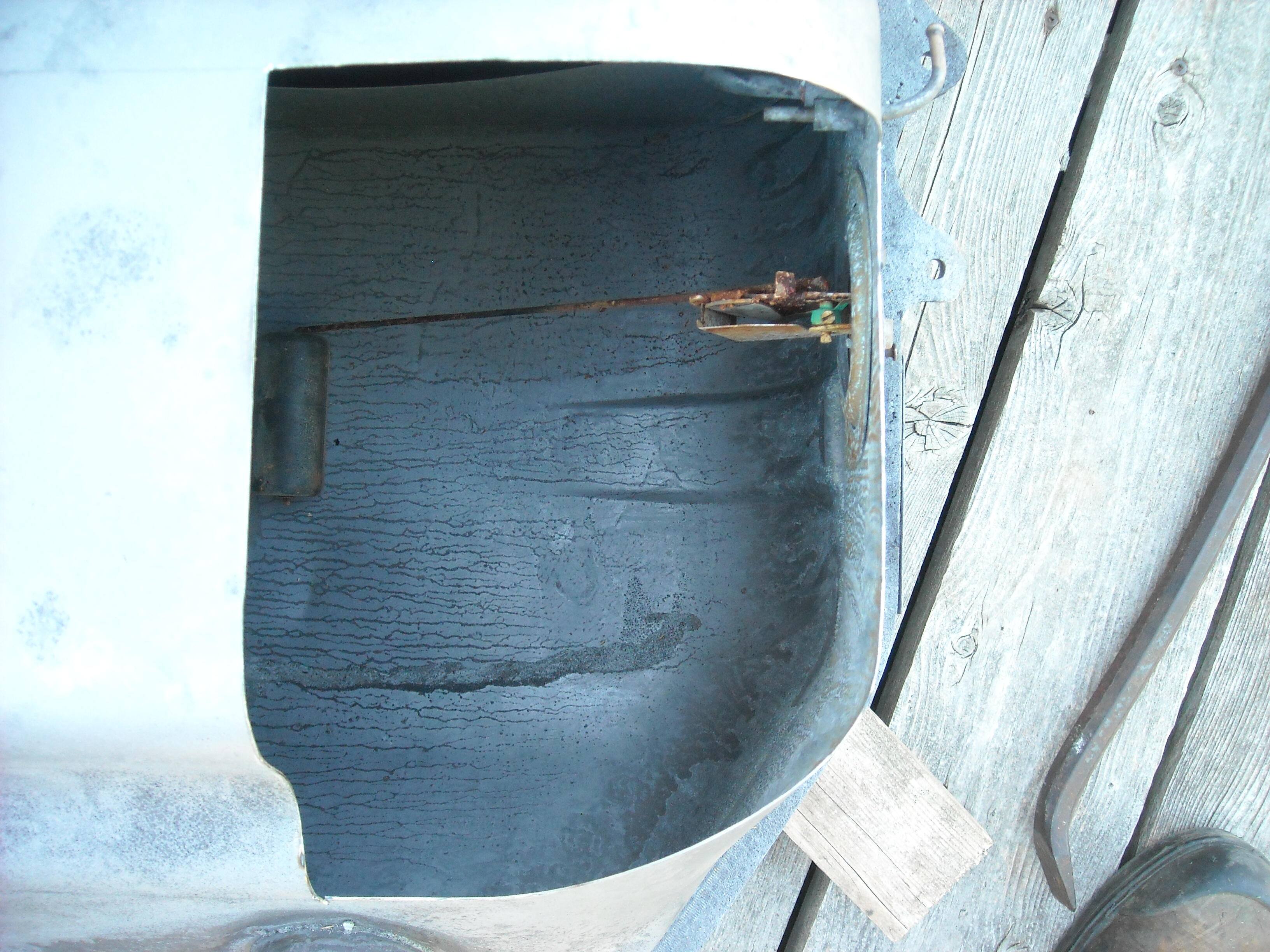

Here is how lucky I am regarding tank internal cleanliness. This one is spotless.

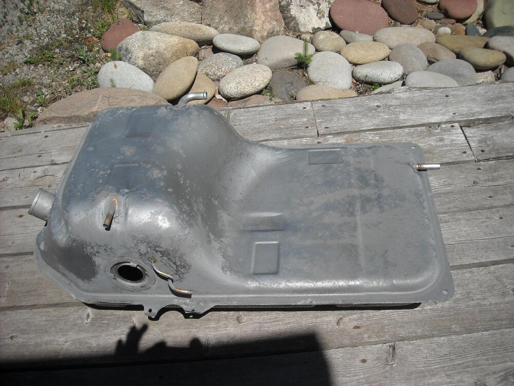

Well I took the first step. I bought a little household Bissell steamer and steamed the heck out of the tank. Put about an hours worth of steam through it. Tank is now fume free.
Did it outside on a ~+5C sunny day here. Nice cloud of steam coming out all the ports. Rotated around which hole I stuffed the steam hose into during the hour and rotated the tank around. That steam was immensely smelly but now the tank is odorless and spotless (not that it had much in the way of spots to start with).
I happily silver soldered up the stock fuel outlet tube that was rotating freely(and leaking) with nice MAP torch with no fear. And yes I even stuffed the open flame in the filler tube just to prove it was fume free. Granted I’m abandoning the stock feed and return fittings, should really just solder them shut. Guess I could use the return as a vent. We’ll see.

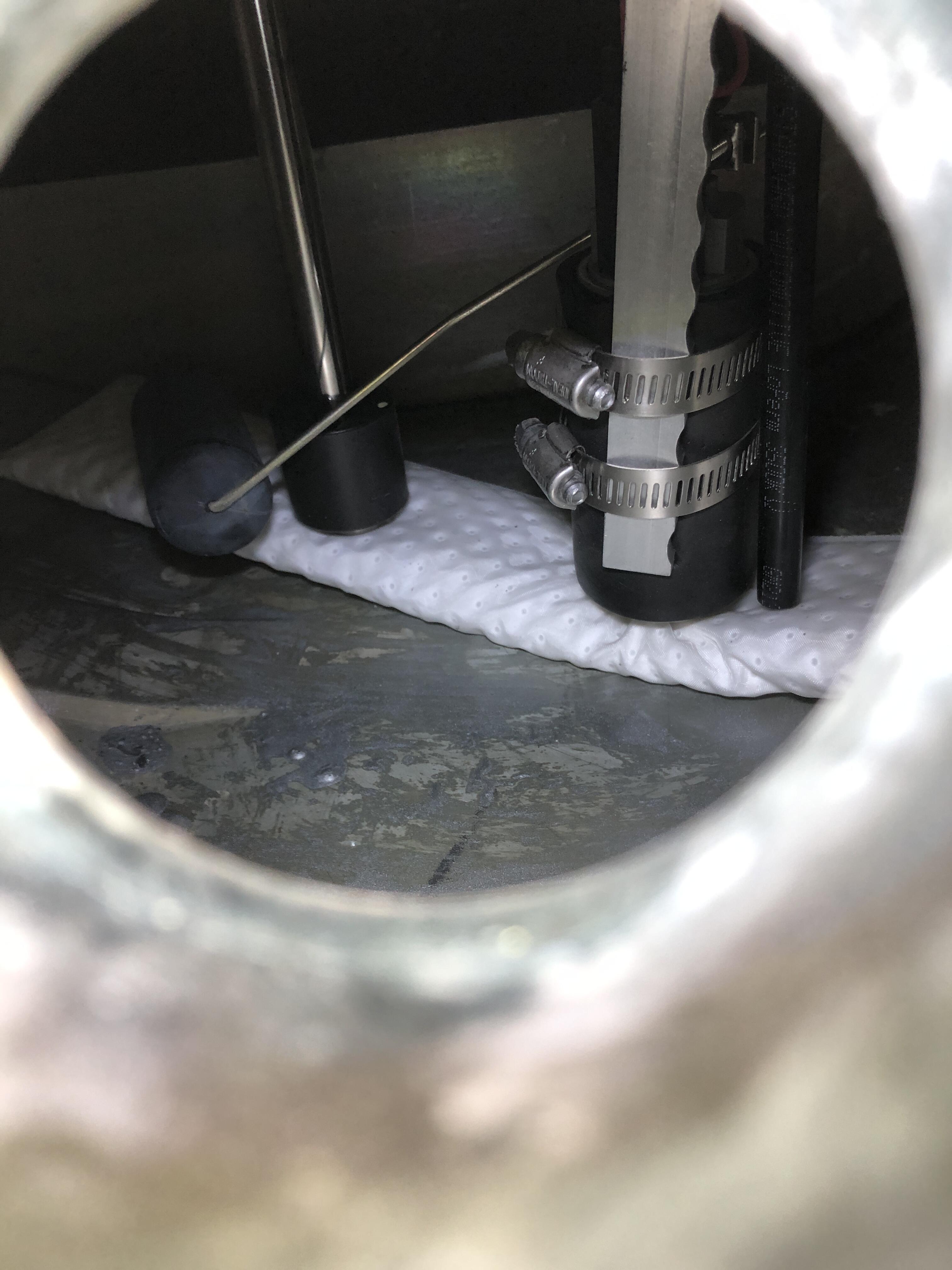

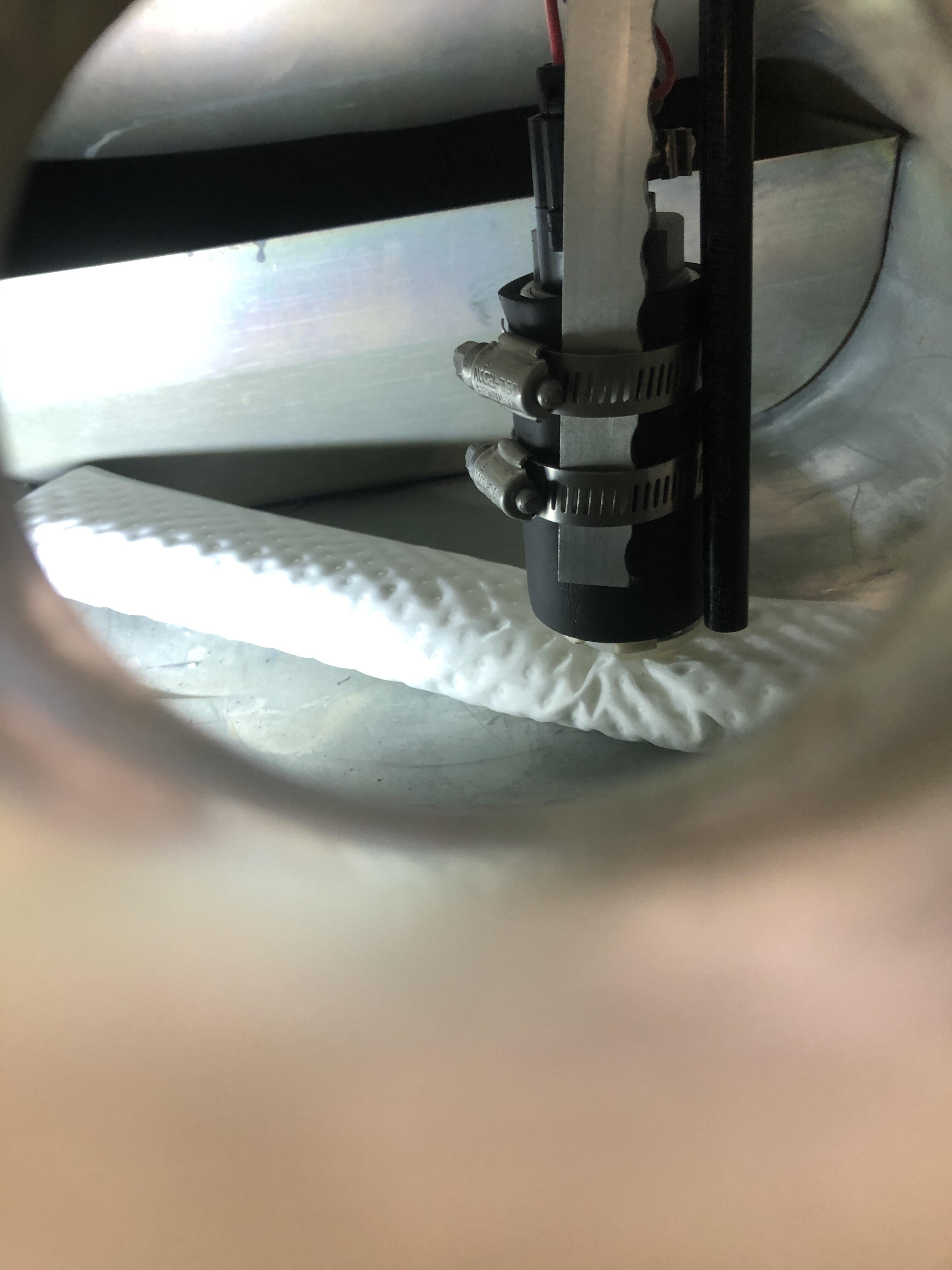

I'm guessing that is the sock filter for the in tank pump? Does it interfere with the stock float?

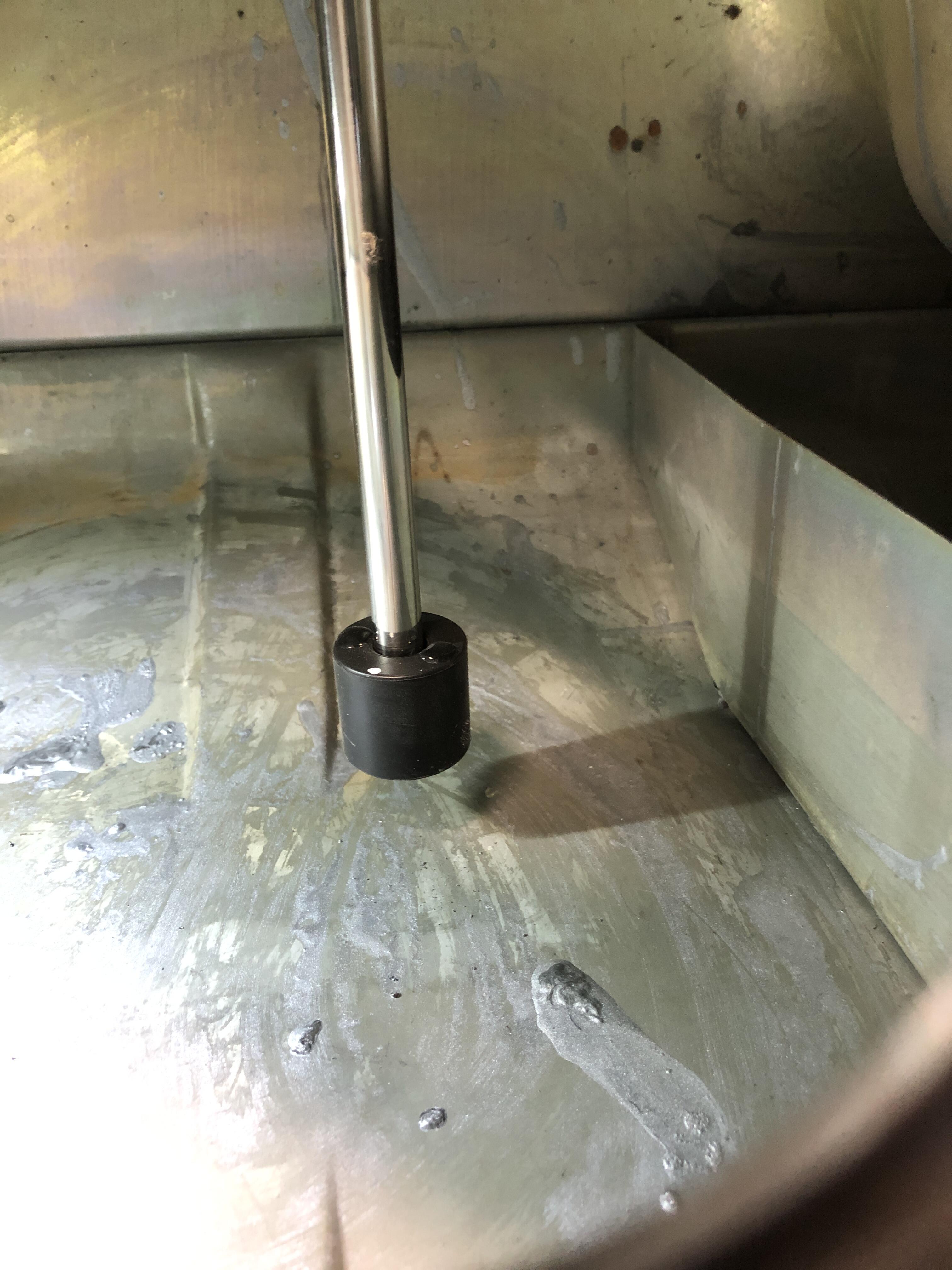

Yes the fancy long skinny sock is a Holley ”hydramat” fuel sucker sponge thingy. This is my strategy to make it slosh and low fuel proof for the EFI application.
I don’t intend to use the stock float and sender, I have a top mounted aftermarket unit to install next to the pump. I think you would have to create a new arm shape for the stock float to meander around the new pump and sender hardware, but it could work just fine I think.

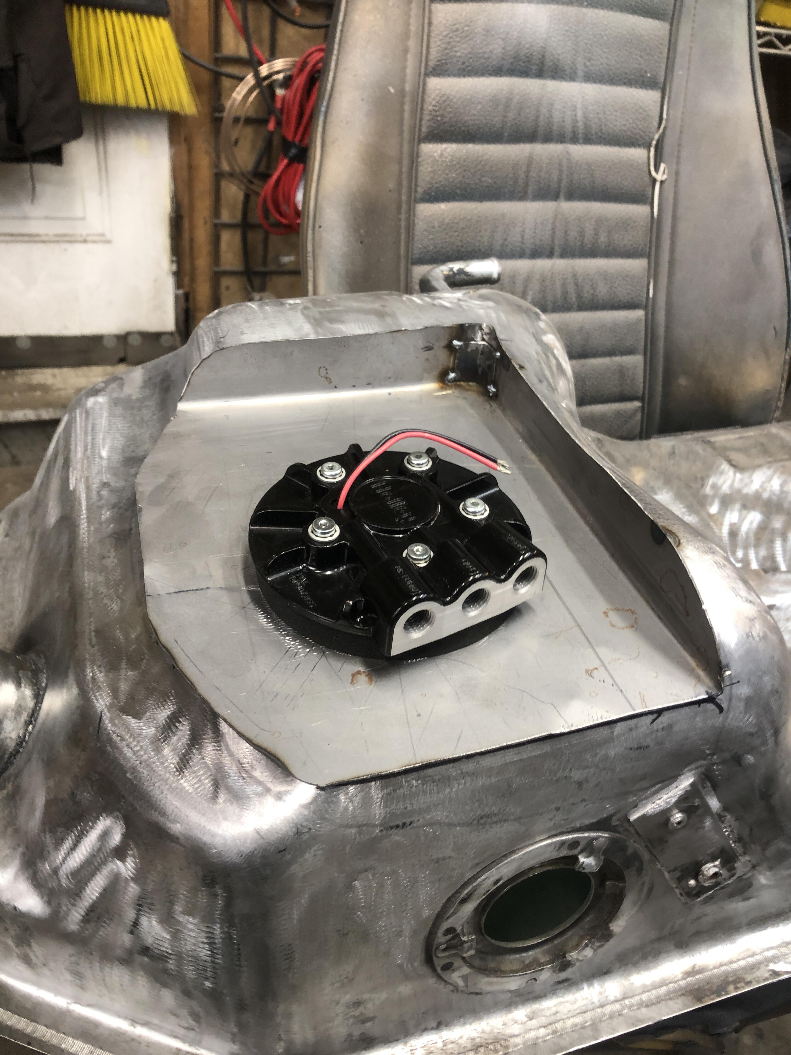

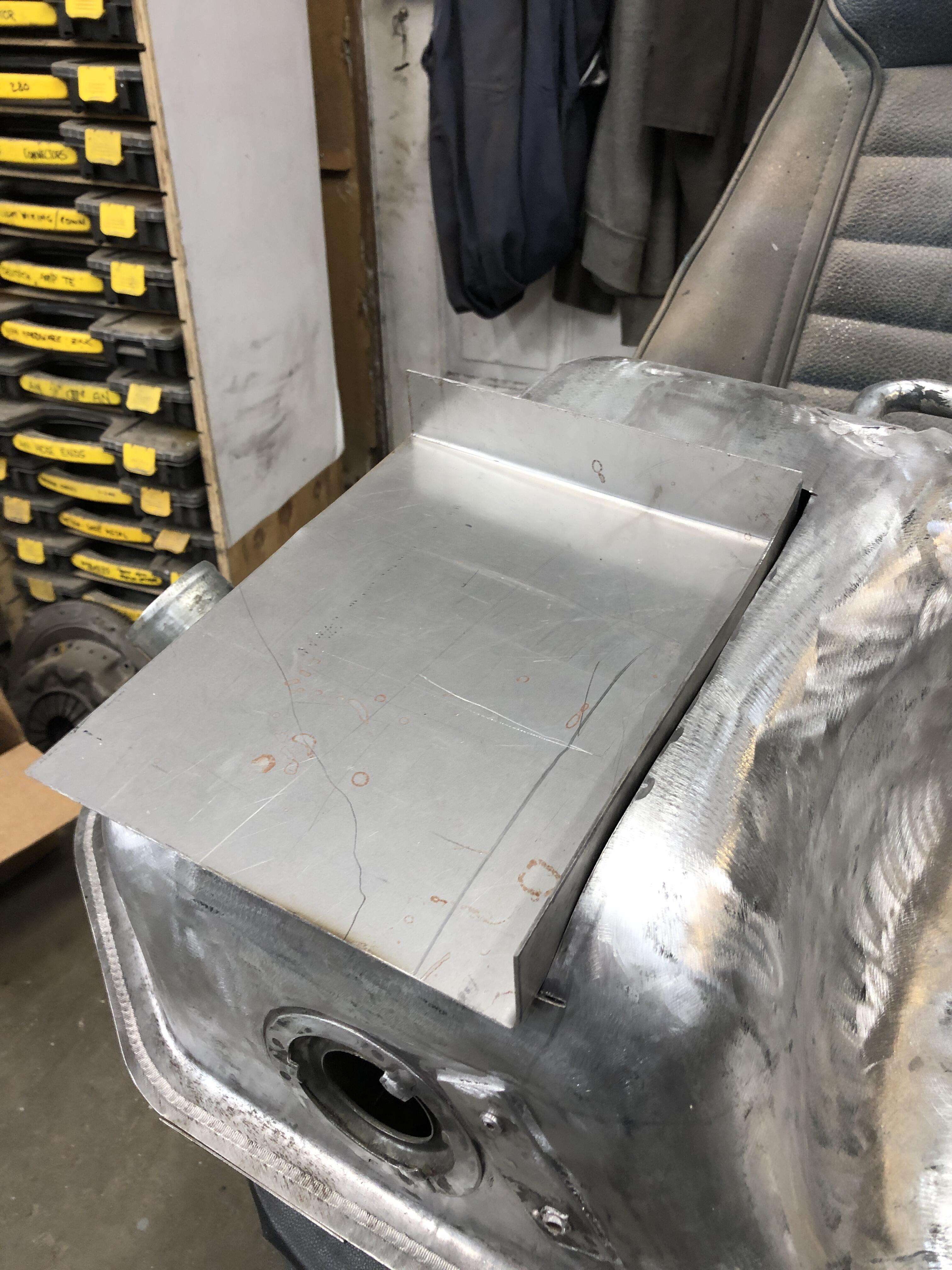

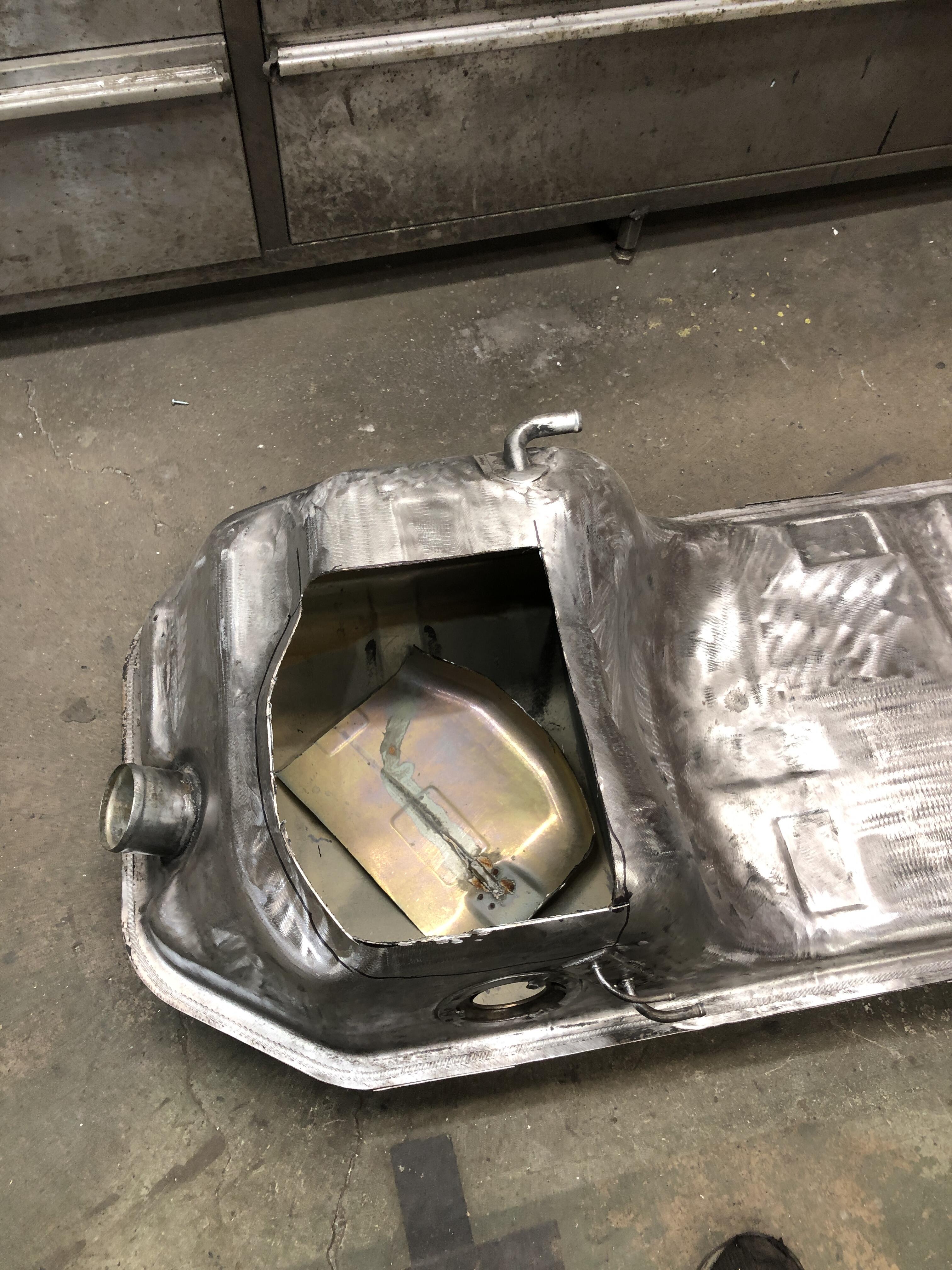

Okey Dokey, got the tank mods done and the pump and level senders installed.
After careful welding and grinding, I covered the weld inside and out with POR gas tank sealer paint. Bit fun getting your hand in the pump hole with a wire brush and/or scotchbrite to clean the backside of the weld and surrounding tank area real pretty but I managed it.

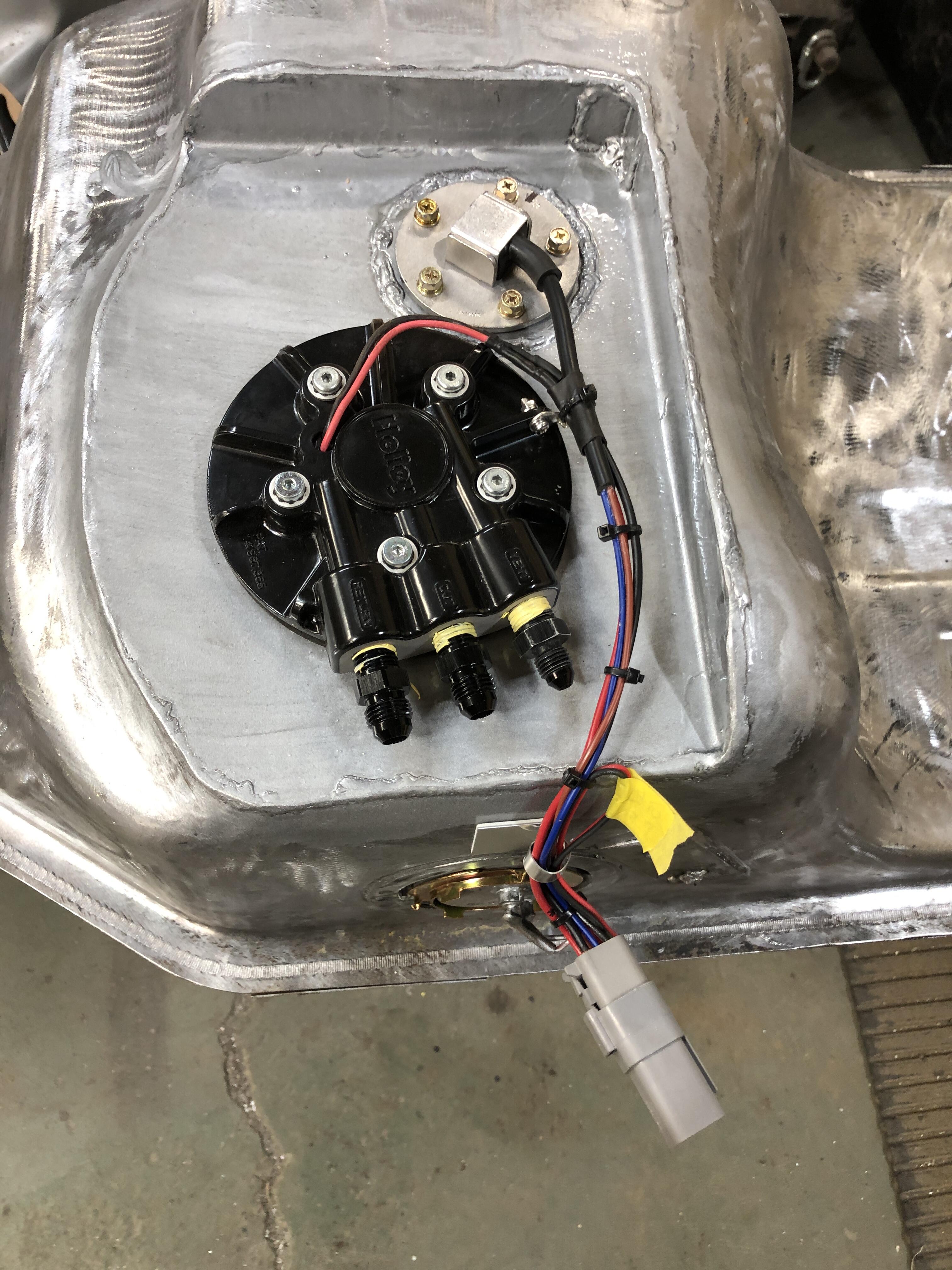

Even managed to get the stock sender arm bent to clear all the new tank occupants. Just took a small kink near the end to get it around the stalk of the new fancy sender. Figure this way you can use a stock gauge if you want to at some point, or if I’m not happy with the Amazon sender for whatever reason. AND it fills the sender hole in the tank. The resistance range is 15 to 61 ohm given the restricted movement range, vs  10-90 stock. Float hits the lower ceiling now, and sits on the fancy hydromat on the bottom. Oh well.
Notice also the nice waterproof Deutsch DT connector.
I’m very happy with this setup. Just have make short hoses to bring the connection point down in front of the tank. Can’t put them together with the hoses going upfront and the filter with the tank in place.
