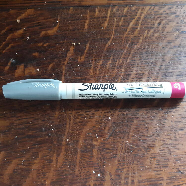

Clean the emblem and use a little bit silver paint to repaint the letters. if you use a magnifying glass you will see that it's going to be a nice emblem again.. and easy now it's off!  Use a very small brush.. with little paint at the time.

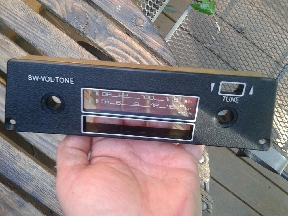

This is the best I found for silver, the radio. They use a chrome coating on some interior pieces too. The interior emblems that I painted on the horn pad and console were this "silver" oil based Sharpie I found a hobby shop. Thank you @psdenno for the proper direction you laid on me.

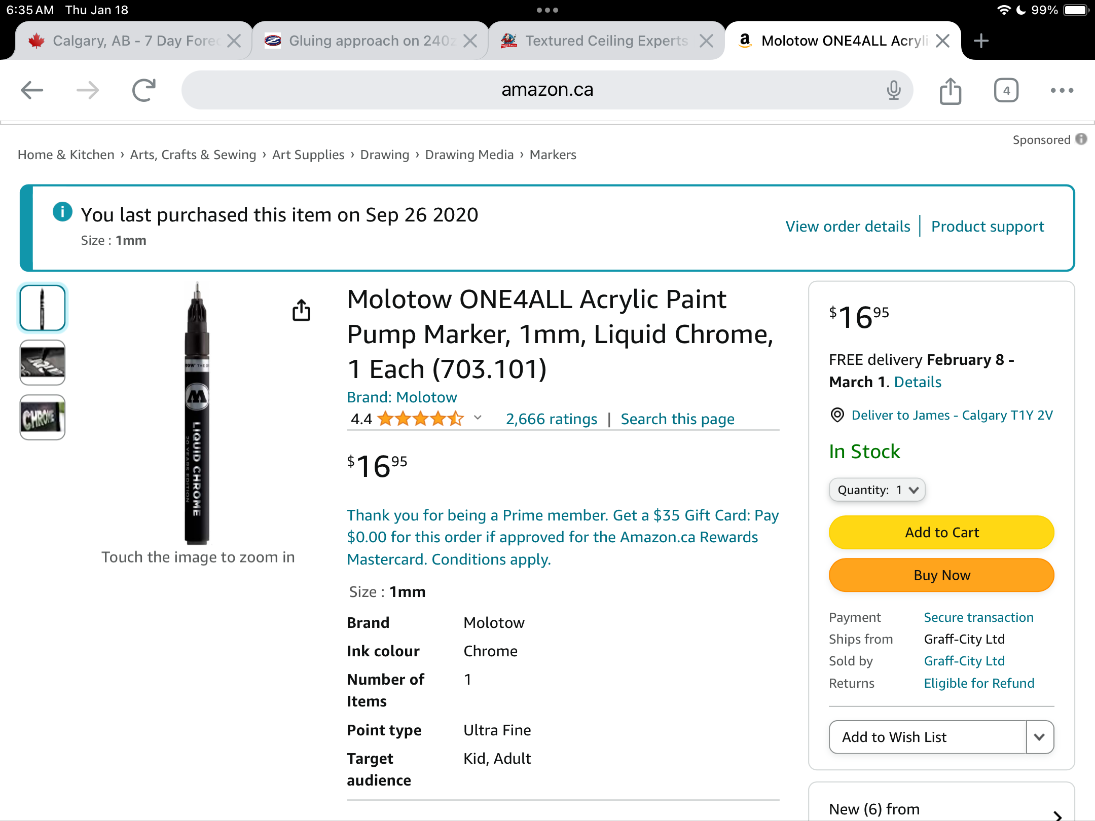

I like these chrome ink pens that I got from Amazon. I got a 1mm and 4mm. The ink lasts well, I’ve had them for a couple of years and they keep working every time I go to use them.
